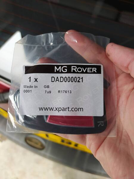

This had been annoying me for a while.
Unfortunately it was a shite fit and even after careful filing it is only about 60% stuck down.
I managed not to make a mess of it though which was at least something.

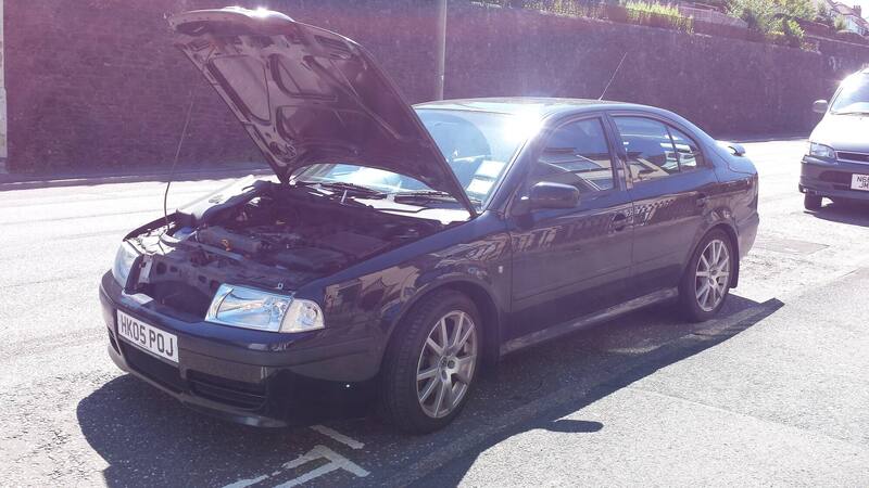

I don't think I've introduced this one - runs perilously close to being a boring modern in my book but I've had it 18 months and love it.

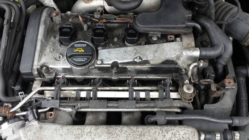

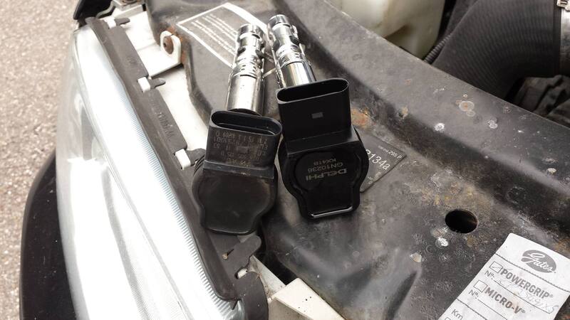

My 2005 Skoda Octavia 1.8T VRS has done about 9,000 miles in my ownership so far and has been brilliant - covers just about every car need I can think of, it's spacious, comfortable, quick, fun and reliable.  Even decent enough on fuel.  It does suffer from a few typical VAG overcomplications - the central locking on the driver's door was dead when I got it, that turned out to be a hideously expensive module that had to be replaced but in general it's been marvellous, I have no intention of selling it which is remarkable for me this long into a car's stay.  It's in amazing condition considering the mileage, too.
It has been running a bit rough of late when cold and I've noticed a bit of hesitation around 2,000RPM - this deteriorated into a full on misfire when starting from cold and I guessed it was the coil packs.  I took them out to investigate and found 4 OEM VW ones with 2009/2010 dates on them.  A quick clean with some electrical contact cleaner actually did give some improvement but it didn't last so I bunged in 4 new OEM-grade Delphi ones from ECP, despite some reservations as a multimeter test showed all 4 had perfect resistance across pins 3 & 4 - there's another test between one pin and the tip but I couldn't get it to work.
Easy job - if it weren't for the bits bolted to the top of the engine it'd not even require tools.  But did it work?  Yes!  Runs perfectly now, wish I'd done it ages ago.  I think it'll probably need a cam cover gasket soon by the look of it, although the plastic engine cover provides a handy fix by hiding that particular issue.
Next job will be another needlessly complicated gizmo - there's a secondary air pump which only serves to pre-heat the cat when starting from cold for emissions apparently, it's riveted together and over time the rivets fail, so starting from cold provides 45 seconds of high-pitched screaming which is getting more annoying as it degrades.  The fix is apparently either replacing the rivets with bolts or taking it out and stuffing a resistor in the plug so the EML doesn't come on.  I will try option 1 before I resort to bodging with option 2.
Literally the same issue as I have on my 1.8t AUM estate. I investigated the SAI solenoid, but it's a bugger to change, so I'm probably going to try changing the pump like you. Will follow with interest.
Make sure you have plenty of worm drive clamps to replace the shitty VAG oetiker clips.
On the plus side, the engines in these are good enough on emissions to be ULEZ exempt.
