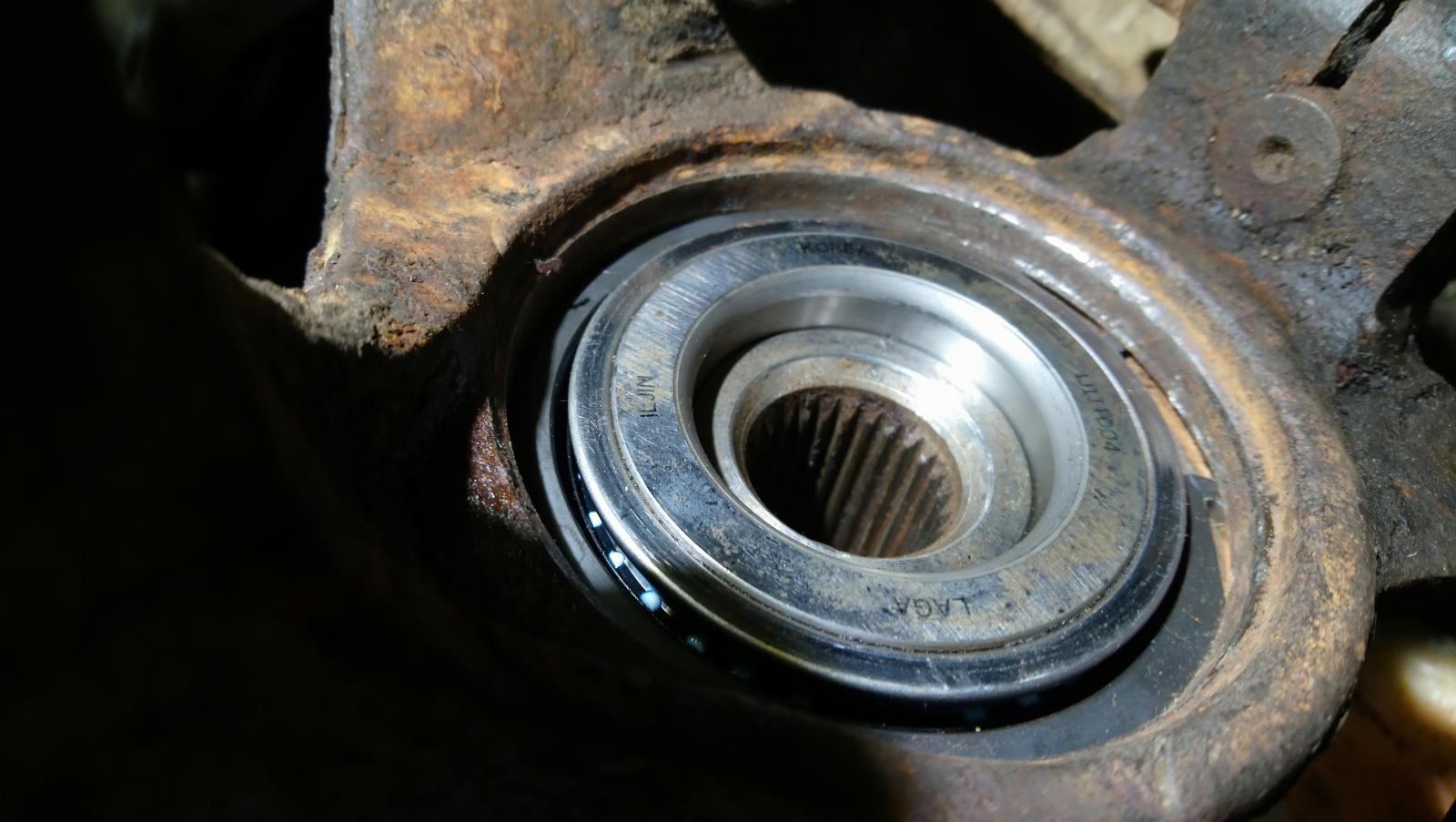

Might have a wheel bearing on the way out on the Princess. Difficult to tell. Low 'wubwubwub' sort of noise, increasing and decreaseing in frequency in line with changes to speed. It's also vibrating through the passenger floor at certain speeds, not through the driver's floor or controls. Sometimes have a bit of vibration through the pedal under heavy braking too. The last checks I did a few weeks to a month ago didn't highlight any play or grittiness so it's something that's only just started to happen. I'd turn the radio up if there was one fitted. I was a bit dubious of Mike's diagnosis of wheel bearing when we were out today but other mechanically minded folk have suggested the same on describing the symptoms to them.
The rears were easy enough to do when I did them back in 2013, and they should still be good, so it's probably a front one if it's any and hopefully they'll not be too nightmarish to do. Getting close to MoT time again, and looking due for an oil change and a brake fluid flush so I guess we're heading for a Spring service soon.

After checking the Princess over, the front passenger wheel bearing has a small amount of play in it, all other corners are fine.  Probably worth doing both front bearings rather than doing one and waiting for the other to fail.

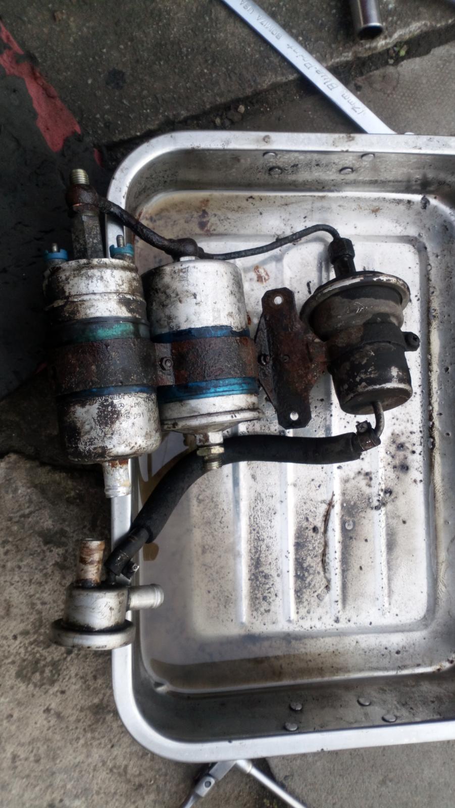

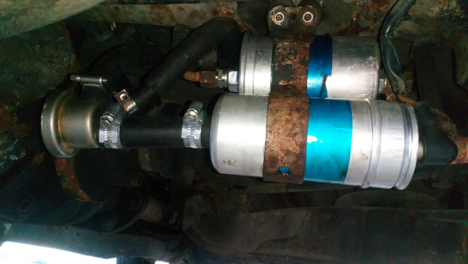

As some of you may have seen I got a dog dick red (Cort 16?) Merc sec over Christmas but all has gone quiet since, mainly cos fuck all has happened. On collection it coasted to a halt halfway home, then recovered an hour later. This was it's first ruh out since 2003 and didn't build confidence. I replaced the repaired fuel pump relay but wasn't convinced this was it then the weather stopped play until Saturday. On Saturday I tried to change the fuel pump, shit out because 1985 steel pipes  and got changed to go out. And, - nothing, no fuel pump. Then 5 minutes later it was fine, at least this time it was on the drive, not the A19.

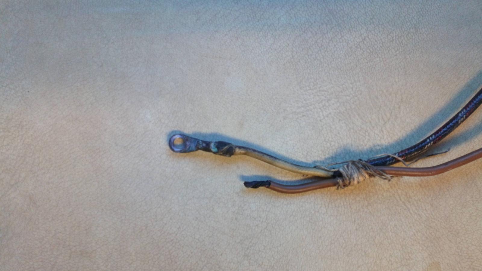

Today I changed the pump and filter, the only thing I found was the wiring past it's best before, a bit green where crimped and black and stiff when I stripped it. Here's hoping.
The pump, filter and accumulator drop out as a unit. They are straight onto a short 15 mm bore pipe out the bottom of the 90L tank. A little planning is best!
Shiny new pump and filter before cover goes back on. Motor Factors do not stock 15mm bore fuel hose.
Manky wiring.
