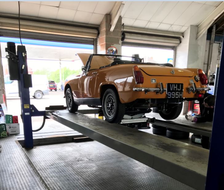

Having had the MG Midget MOT'd a couple of weeks ago I renewed the insurance today. Didn't go with Lancaster as Adrian Flux were £35 cheaper, with better cover.
I'm not a fan of the 40 year exemption and will choose to have mine tested as normal.

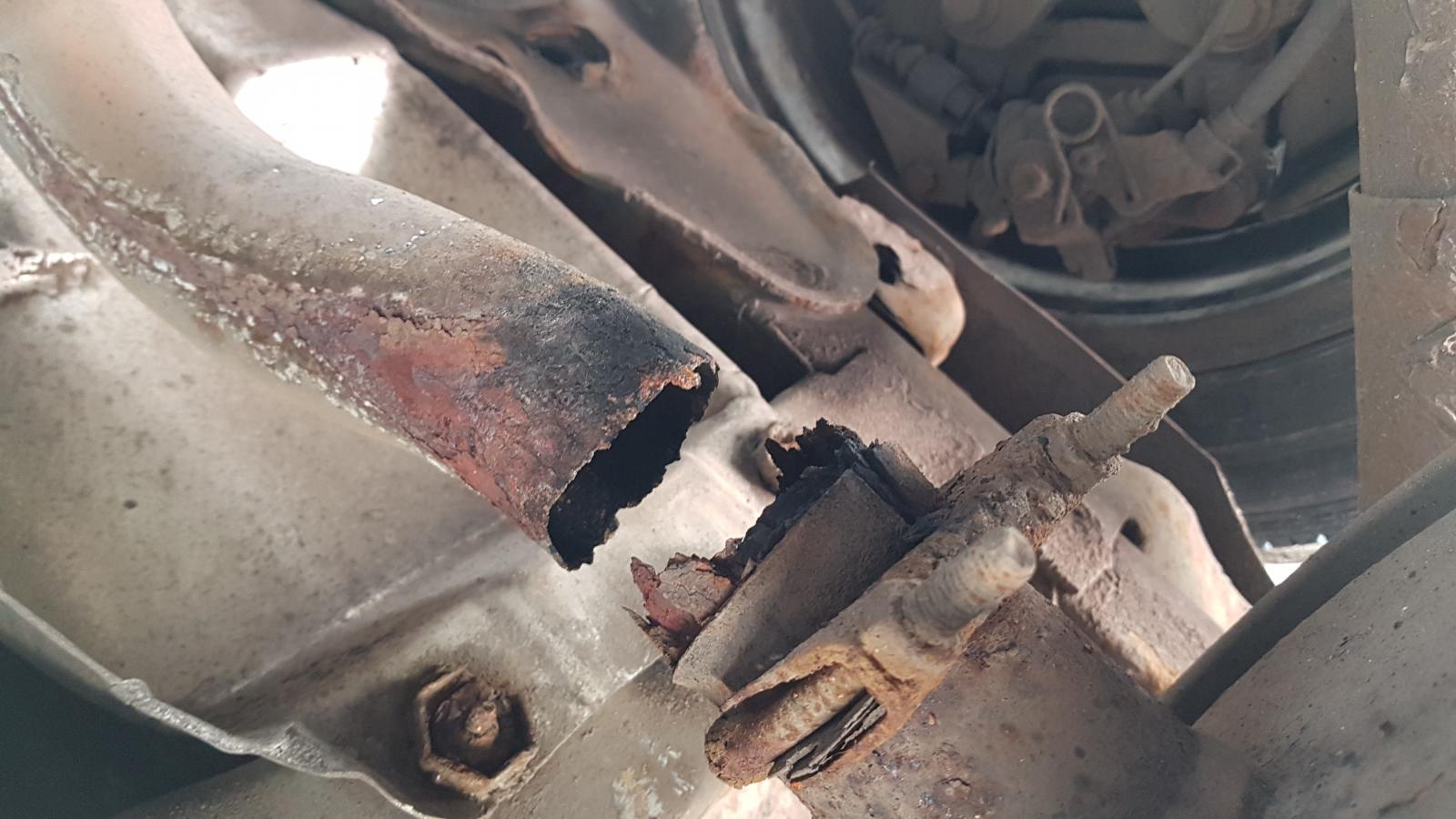

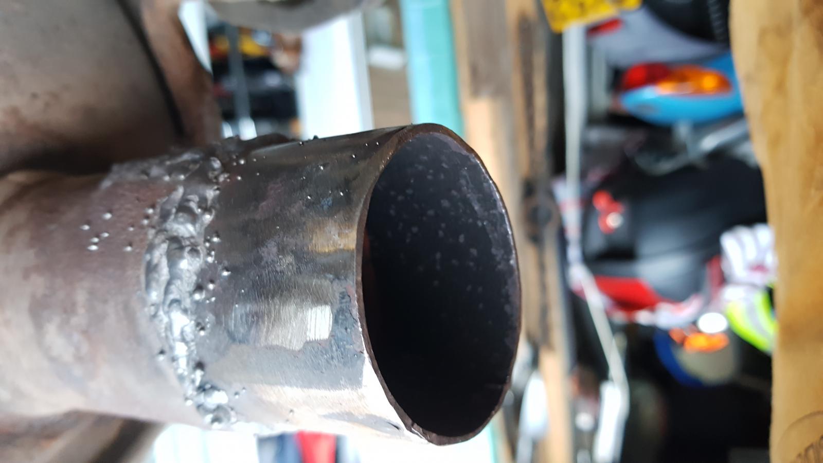

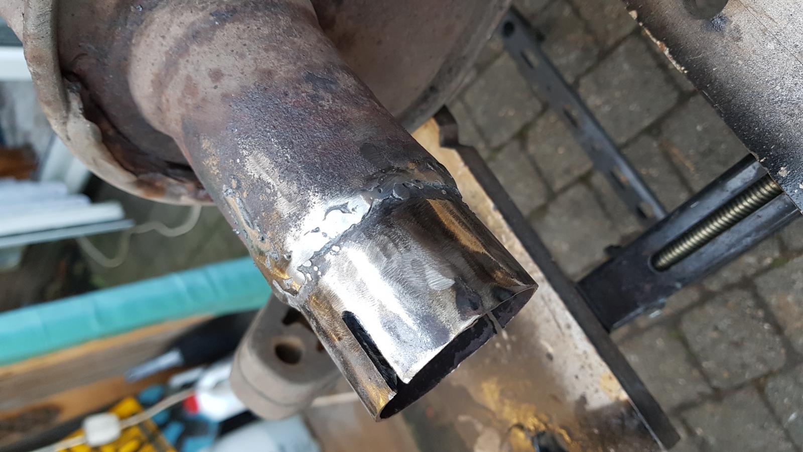

Grabbed 5 mins to try and fix the rusty backbox back on the companys sharan 7 seater.. welded pipe in to sleeve over the rusty bit, just waiting on a new clamp

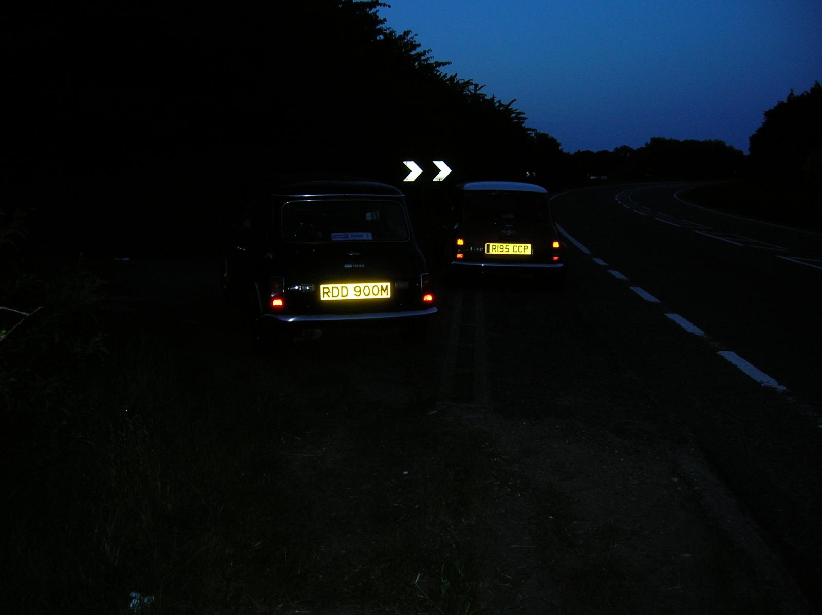

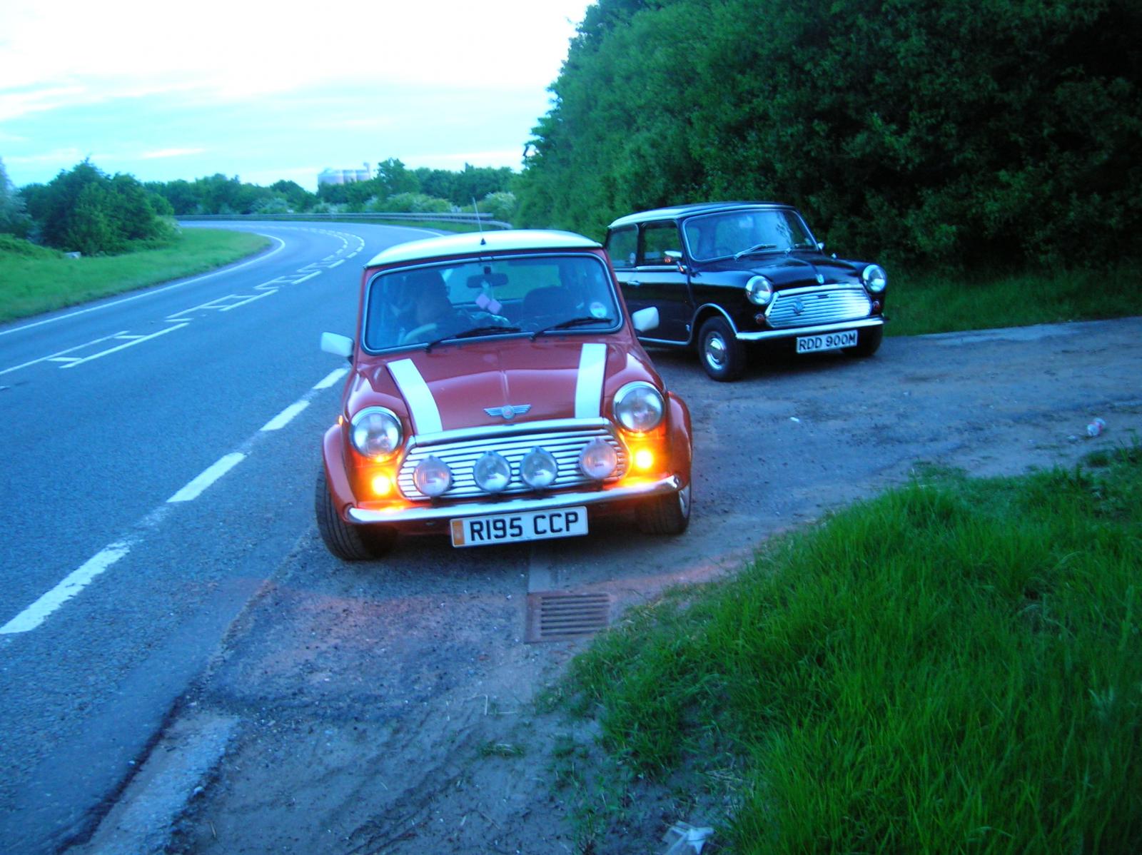

after bigging up the black mini on sunday evening, our journey home on monday turned into a complete 'mare.... it seems i really iinxed it!
so, we left Gravesend about 8.30, car both running really well.
up to cambridge services about 10am, and on to just pass stamford for 12.30-ish, so far, so good....
then on towards homeworld. get to the Newark junction, the balck mini started to miss-fire. decinding that it was wiser to get off the motorway we dived down the sliproad where the car finally died. now, as we knew the petrol gauge told lies, we thought that i musta ran it out of fuel. indeed dropping the contents of the petrol can into the car, all seemed well, so, we made our way into the town centre and filled them both back up.
£6 later, it seems that the tank wasnt as empty as we thought.
ah well, not to worry. so back to getting home, only maybe a mile outta town this happened.
yes, FTP.... the black car had lost power and if it did start, it wouldn't rev, like no power whatso ever. shit.
still not the end of the world, as there is recovery included in the insurance., so, at 14.30, we called the breakdown, we couldn't fix it.

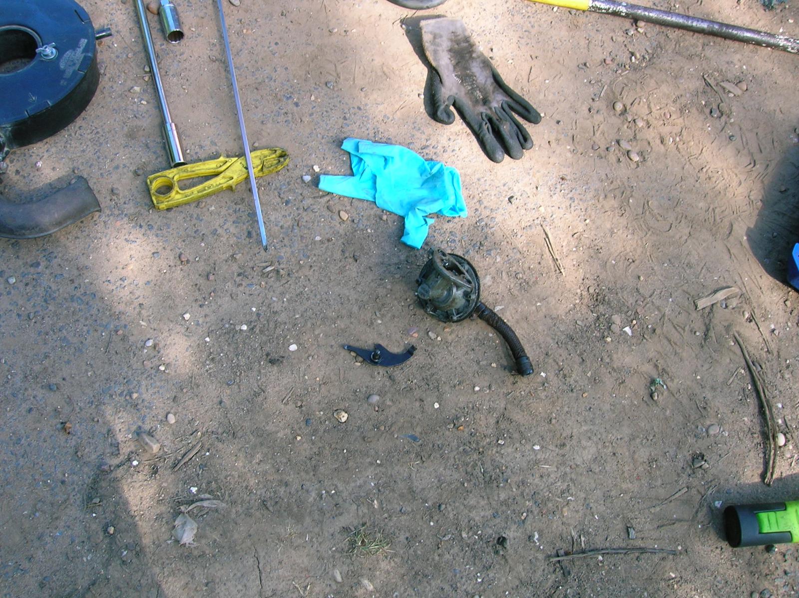

an hour or so later, a chap arrived. he too found that while the car had a healthy spark, there wasn't any fuel. examining the petrol pump revealed this
that pump is shagged. the end of the operating lever is missing as is the return spring. and there is no sign of them either. not under the car, anywhere obvious. we assume that they are missing, presumed somewhere in the block or gearbox (we think, fuck!!!!!)

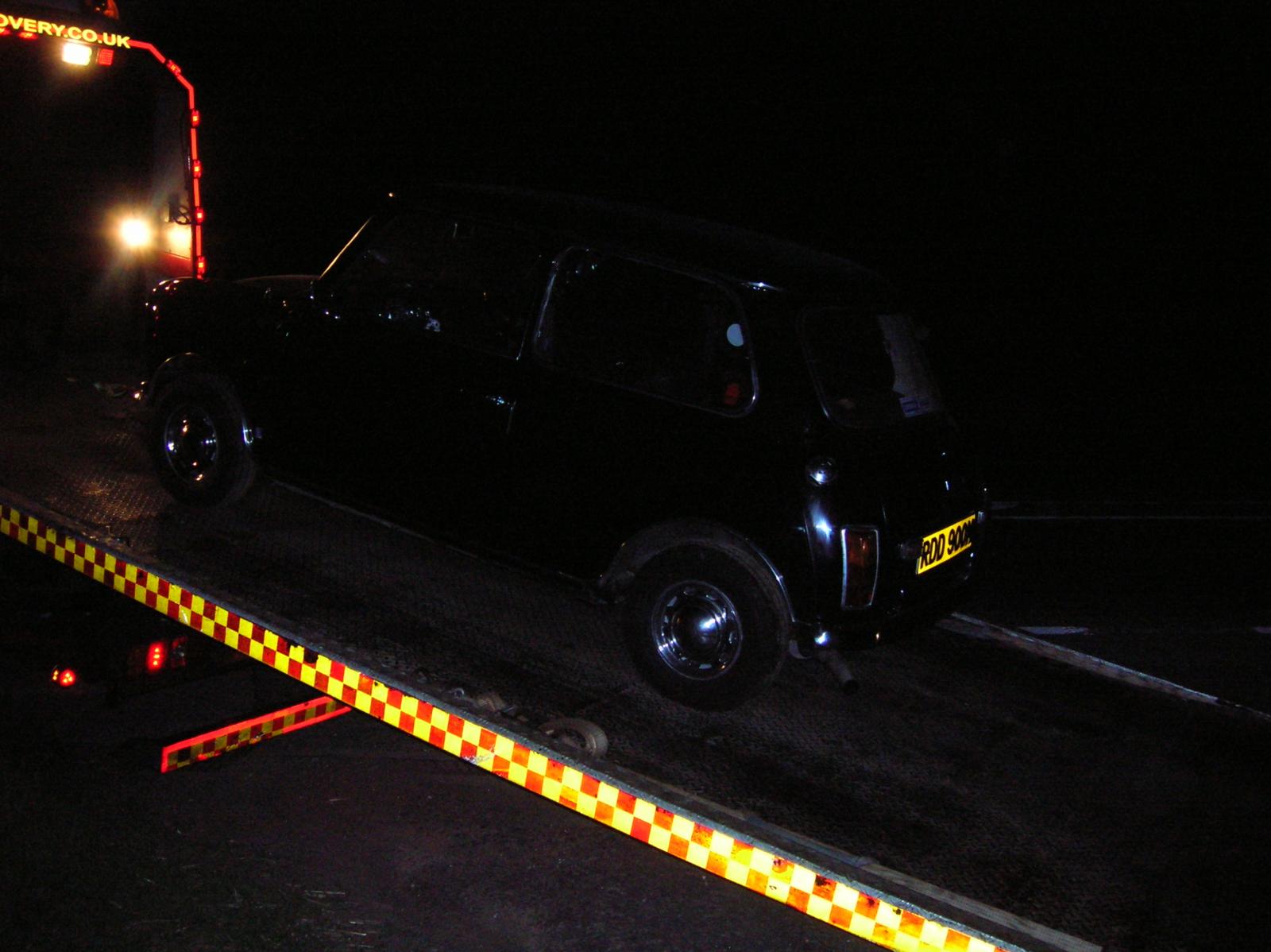

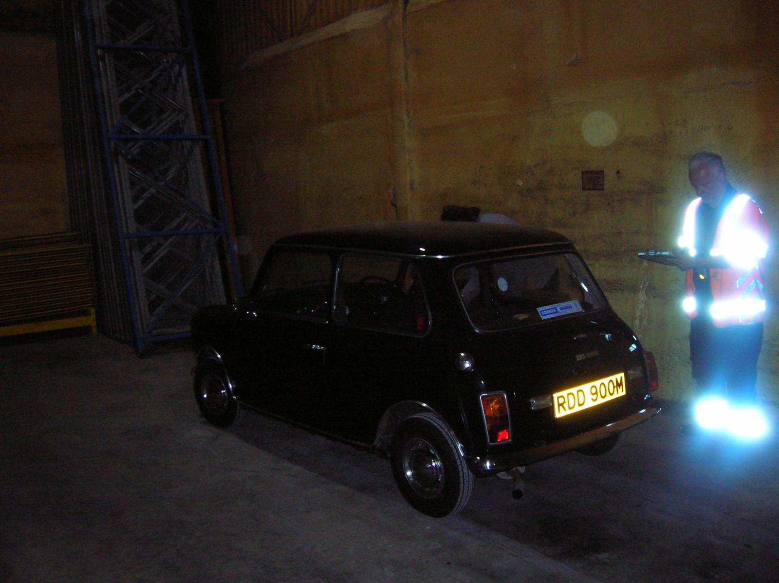

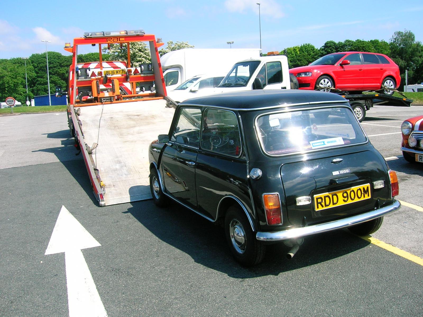

eventually (at around midnight) a very pleasant young man arrived and we get loaded up. but he can only take u up to Blyth Services on the A1M (about 30 miles away) cos his truck is registered as a wrecker and has no tacho fitted, so he cannot travel more than 60 miles from base, plus his firm is only contracted to cover Lincolnshire
arriving there at 1am. now thing get really peachy, see its the RAC, and they cannot get us on for forward recovery until 6am at the ealiest.
so, a night at the Travelodge it is. at least well have a bed to sleep in, and i can get a shower. i stink. my hair is a state and the sticky sweaty ness of the day is clinging to me like a second skin. and the RAC are paying. what a carry on....
a new day, and a new trial to get home. a shit. shower and some sleep, lets see what today brings. check this out, the new jeep thing, now that is one of BL's finest greens i believe

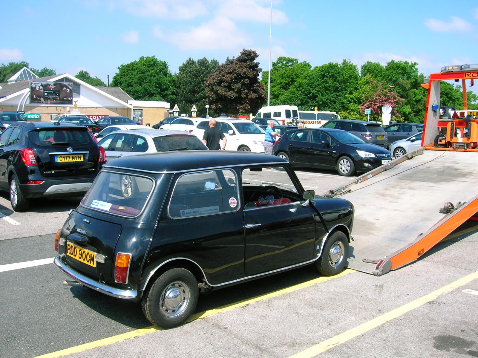

1130 and this very nice chap arrives, again we load up, and head off on the 78 miles back to Pickering
arriving about 1.30 to unload
yes... back where we started nearly 6 months ago.  to the very same spot (almost)

That's shit is that ! I can't recall Mini engine/boxes well enough to recall if they have a deep sump which would be good news as those bits of errant pump could sit in that for decades without bother. I think I would be tempted to get a new pump and carry on and smile while whistling bravely!
I just had an interesting conversation with Paul of Specialist cars (who was good enough to get ALL my stuff out of the heap of shit and deliver it back to me) about Bentleys... I guess now he no longer has a vested interest in keeping me in the fold, the truth can be told. Bentleys are crap! Apparently they see countless cars like mine that are always going wrong in expensive and unusual ways, it seems to be the later cars that are the most bother! Arnarge (the one after mine) is even worse and is one to avoid... like the plague as not only are they unreliable, parts availability is terrible as some are BMW and some Bentley and some VW! They have one in at the moment that is totally off the road because the oil pressure sendor/sensor has failed. Part is not available and there is no date when it will be available! This is on the cars that ran to 2012 with the old RR V8 and nothing else will fit.
Why didn't you just put it on a tow rope? Am I missing something - like it's an auto? Even then, towed gently...
we didn't tow it cos well, we didn't have a tow rope!
the car is a manual car, but even when its been pushed around free wheeling with the engine switched off then the differential and the gears inside the gearbox are all spinning away to themselves as the wheels turn. all the clutch does is split the engine from the transmission, it doesn't stop the gearts inside from turning.
as we have lost a pice of metal about 1/4 inch square, we were worried (and still are a bit) that it had fallen through the engine and got caught up in the gears and that underneath, and wreck the gearbox.

99% sure these have a magnetic sump plug. When I used to change the oil on my metro the sump plug would look like a shiny porcupine with all the shards stuck to it.  Whip it out and have a look. With a bit of luck the missing bit will be there. It's a massive ball ache separating the gearbox from the engine on these. Fingers crossed!
