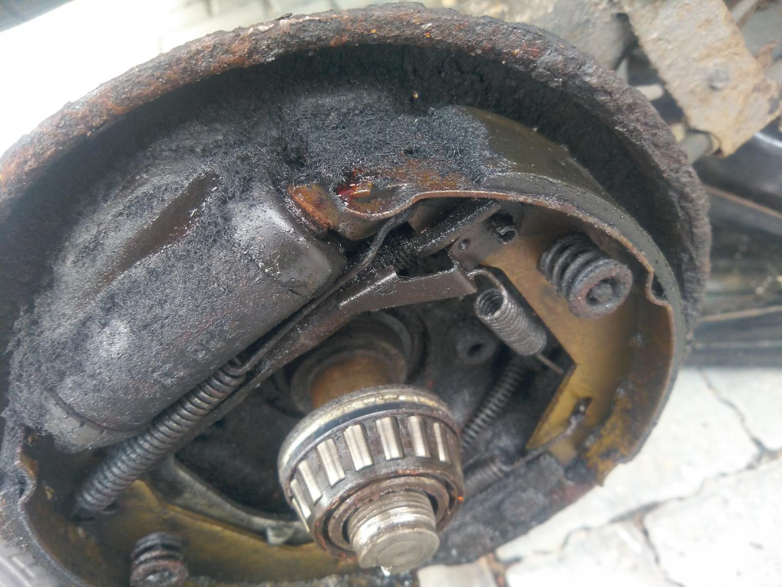

Then I whipped the rear brake drum off to have a look and see if I could see what the issue was there.
Aye, I think that would explain the
Offside rear brake recording little or no effort (3.7.B.5a)
Offside rear parking brake recording little or no effort (3.7.B.6a)
Rear Brakes imbalanced across an axle Axle 2 (3.7.B.5b)
.  The cylinder must have been leaking for some time as everything is absolutely covered in fluid.  So I'm going to order a new cylinder in - not hugely expensive and doesn't look like too much of a twat of a job (famous last words I know).  What I'm not sure of is whether the brake shoes will go again with a good clean up, or whether they're so saturated with brake fluid that they'll never generate any friction again.  I also need to order a new hub nut as the one on there is absolutely mullered.  I managed to snap the tip off one of my Halfords Advanced screwdrivers knocking the staking out, which I wasn't too impressed by.
Other than that and getting the C4 through its test, the only other fettling I've done this weekend is to have a play with the Lexmoto bike - I bought a smoll inline fuel filter in the week, and fitted it yesterday in an attempt to stop the crap from the tank getting into the carb.  It appears to be working, to an extent at least - I had the bike running for about 10 minutes yesterday, having borrowed the battery from the Spacy.  It's a bit reluctant to idle off choke and it doesn't want to rev either, although it could be made to rev briefly with the old hand-over-air-intake trick, but it sounds healthy enough.  I think the carb needs to come off for another clean really.  The lights are all working and it's charging OK, so once it's running right a part worn rear tyre and a strip'n'clean of the brakes and it should be nearly ready for the road.
You will need new brake shoes, the fluid will have soaked right through the lining. Cleaning/burning/etc the fluid out of the surface will only work until the surface layer is worn off. Sorry.

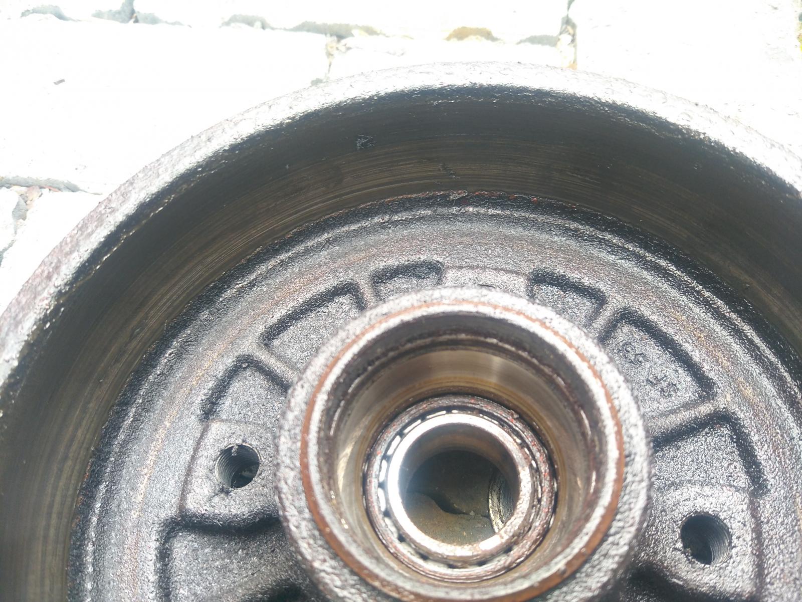

Um... when I've taken the rear drums off old Peugeots, the bearing hasn't stayed on the stub axle like that. It's meant to be pressed into the drum.
No, I think that's ok. The outer race is pressed into the drum. That's the inner.
It probably is ok. I've personally never seen one do that though.
I think that's mainly because when I've been taking the drums off it's been to replace a fucked wheel bearing!
It happens a lot with Peugeot / Citroens. They are not supposed to come apart like that but it will be ok as long as the ring that holds the 2 inners in place is removed and discarded. It is like a little sprung metal band and will be attached to either of the inners or fall out on it's own. It may well already be missing though as they do get thrown away when this happens. Don't even try to refit it as you will spend hours and just end up messing up the bearings.

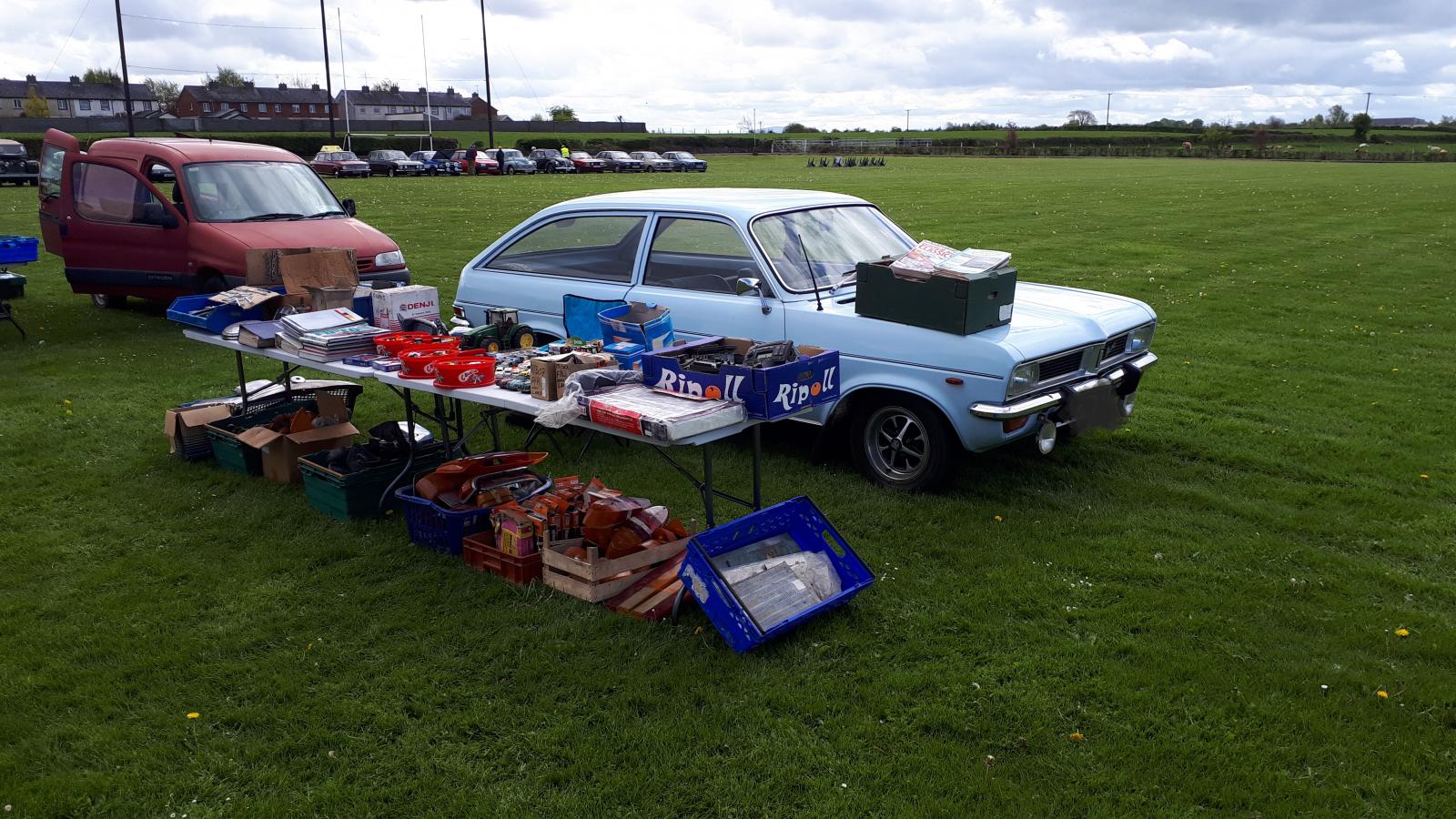

Had an Autojumble stall at a local-ish show yesterday.
Amazing the amount of automotive tat you can squeeze into a Viva.
The overladen and underpowered car did the 70ish mile round trip without missing a beat.
