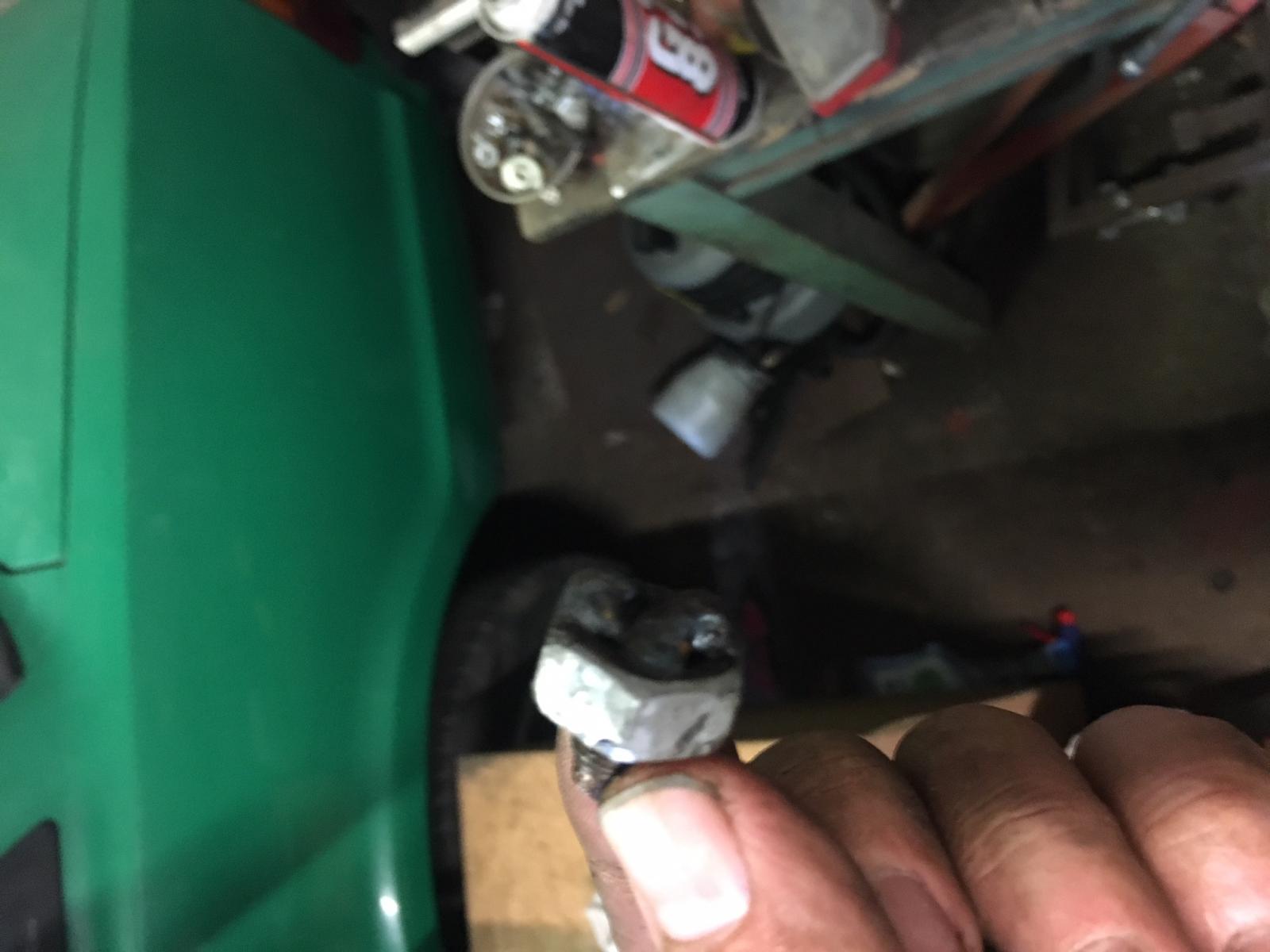

I finally won the war I've been fighting against this seized bleed nipple for the last 3 years.
I filed it down and hammered a big m12 nut onto it then welded that to the bleed nipple. That did it.

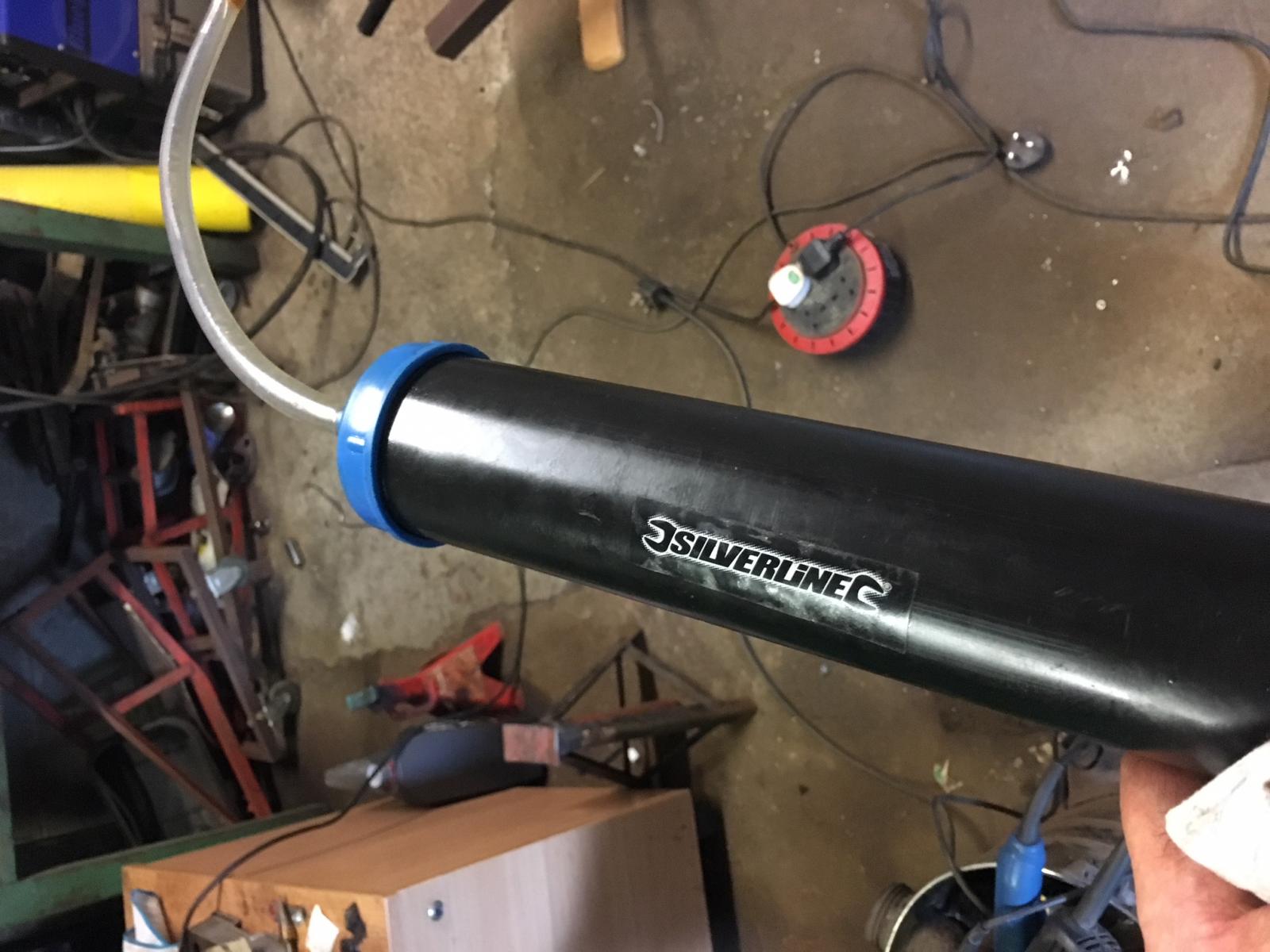

I bought this weird penis pump device to change the gearbox oil on the cortina. When I checked it the oil was minty fresh but 1/4 of a litre down so I topped it up
using this. It then immediately came in handy again bleeding the brakes. I just stuck it on the bleed nipple and pulled the pump and it drew threw fluid until all the air bubbles had gone. Good result, it only cost about 4 quid on amazon. I now have slightly less shit brakes.
I've got one of those, never thought to use that for bleeding brakes. Thats a brilliant idea. The MR2 needs done, will give it a shot.
I had to put a smaller hose inside the big hose it came with so it fitted over the bleed nipple but it worked a treat.
