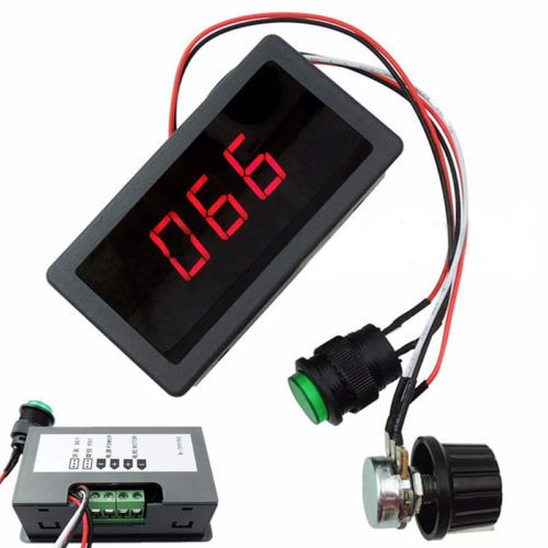

Next step is to source and mod in a motor controller. Current draw from the motor is pretty low, so pretty much anything will do the job. I'm thinking of one something like this:
https://m.ebay.co.uk/itm/DC-6-30V-12V-24V-MAX-8A-Motor-PWM-Speed-Controller-With-Digital-Display-Switch-P-/253116251484
Turning the knob will vary the speed I assume from 0-100%. I'm hoping that it'll be possible to linearly work out the percentage duty cycle to wire speed and then graffiti it on the front of the unit.
