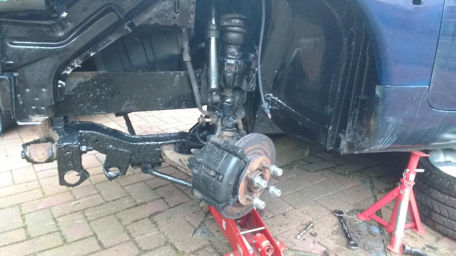

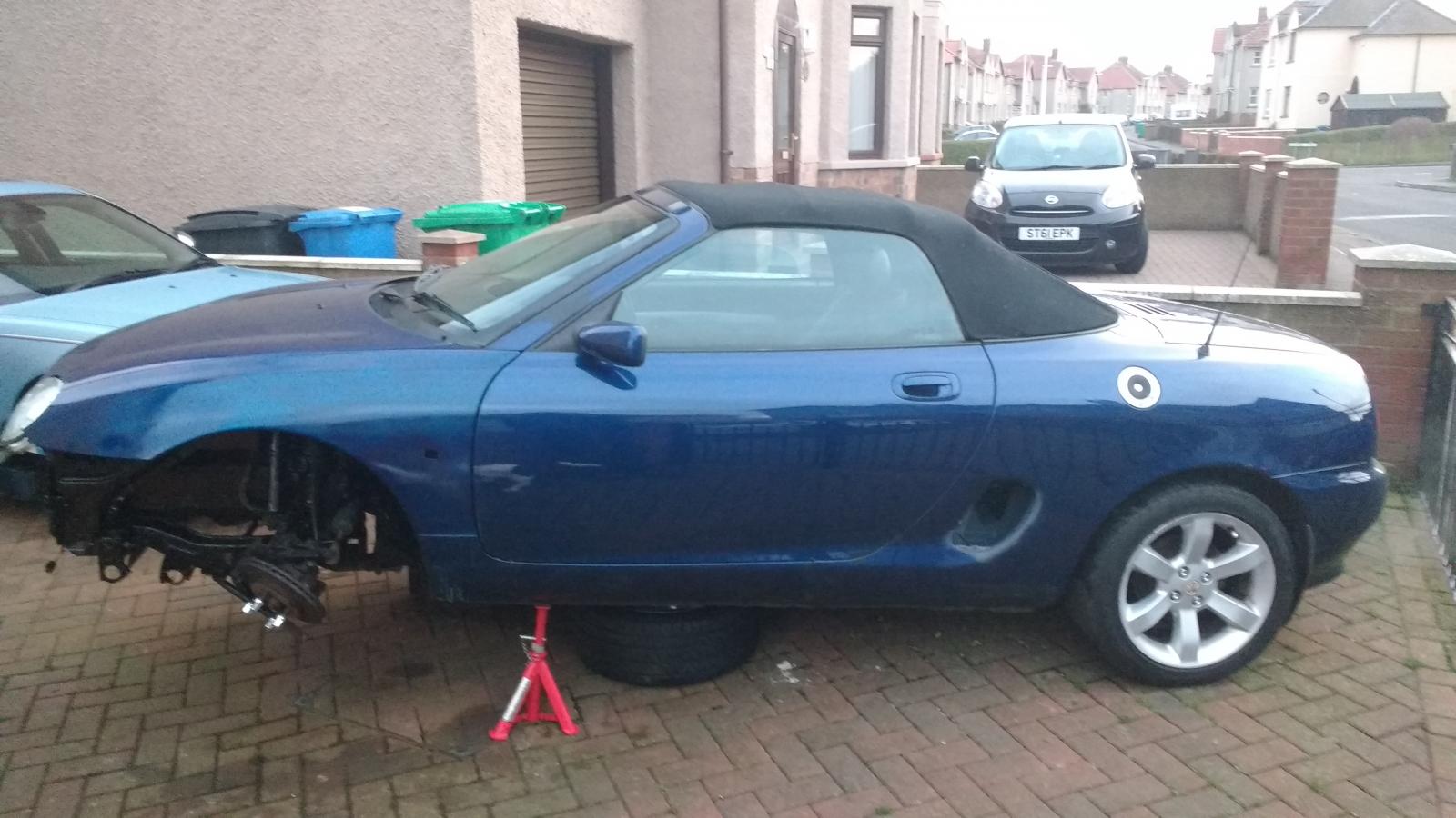

Spent a rather pleasant day MG fiddling. Dropped the front subframe to remove the rotten wishbones.- will post a pic of these later..which passed an MOT in June. Only snapped 3 subframe bolts which needed drilled out and retapped. Bit of a mad idea having to drop the subframe to get the bolts out..
Threw some paint on the passengers silver replacement wing. Bought 2 tins of halfords tahiti blue (which is an excellent match by the way) but on taking the lid off the 2nd tin the nozzle broke off and covered me in JRJ pearlecent. :(  Will need a few more coats then clearcoat. Have got 2 wishbones and a rear track control arm on their way to me, as well as 2 NEW  Genuine ABS sensors from Reamer bros, which were less than half the price of anywhere else strangely! Nearing the end of the mechanicals on it, just front discs and pads to go then it can go on the road- I can make it prettier later when the weather improves.
Todays injuries - I nutted the subframe and drew blood from ma heid. Thumped that bit at the bottom of the thumb when removing the bottom balljoint bolt with a BIG hammer, that's throbbing a bit, metal in the eye from drilling upside down and a metal skelf in my other thumb. Not too bad.
Today's findings. The bolts that hold the subframe to the body are identical to the bolts that hold the hood frame to the car. I had these in stock!

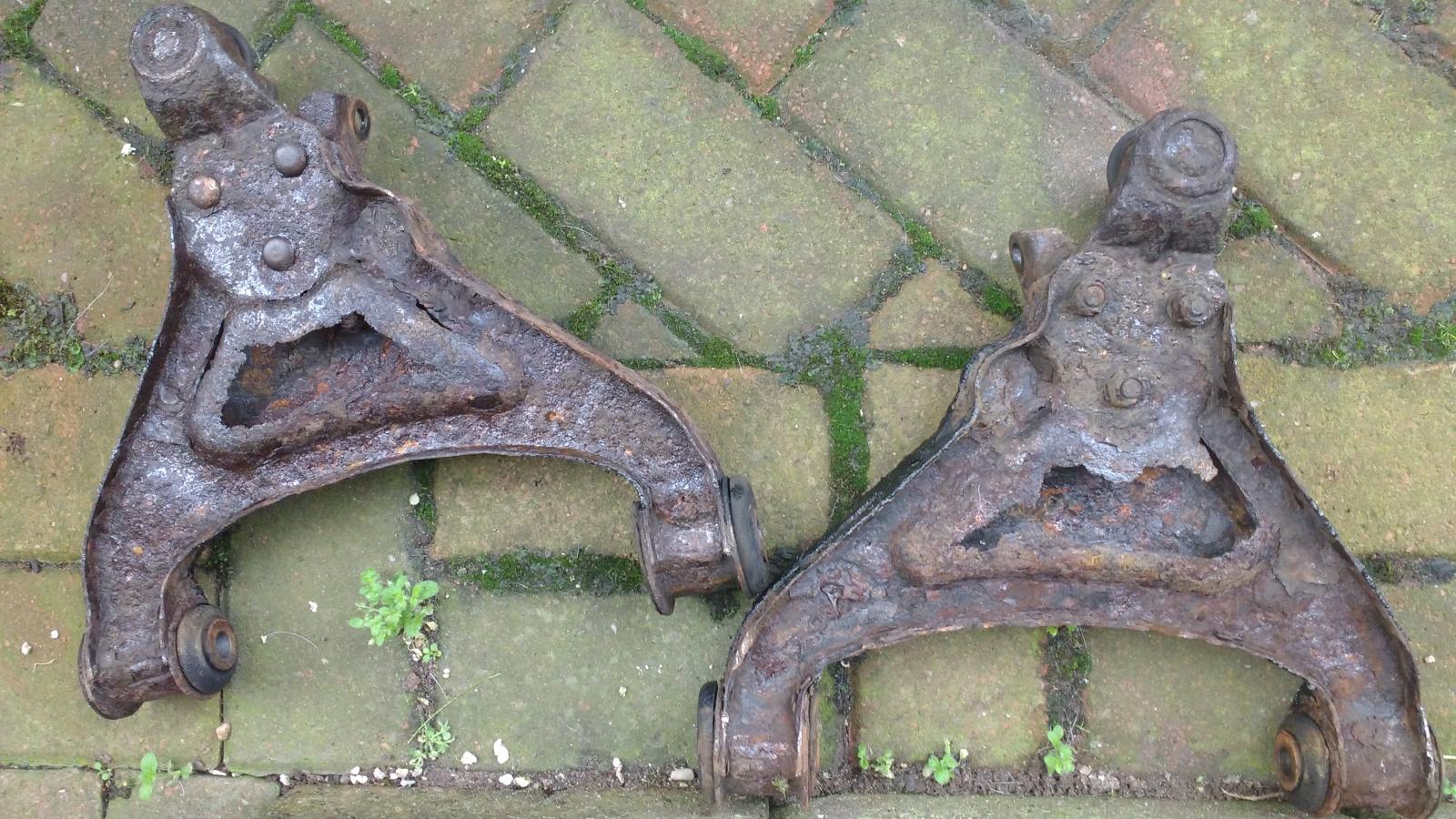

Here are the wishbones, which passed an MOT 6 months ago. I must have been too strict as a tester if this is acceptable.
Rust never sleeps and 6 months is well out of the MOT scope
I know, but they really are just crumbly. And one of the ball joints has quite a bit of play. Seems a bit much for only having done a few hundred miles as it's been parked up since Sept. Add that to rotten brake discs, ABS bulb missing, seized rear caliper, hole in the subframe, bald rear tyres knackered track rod end and a bent rear track control arm it has really been through the wars in 6 months..
I'm a tester so know MOT's are only valid on the day of test, but come on. If this is what can happen in 6 months from a decent MOT, imagine if we had gone to two yearly tests...

The rust story on the MGF is similar to the rust on my MG ZT rear suspension. Passed the MOT last year then collapsed soon afterwards . Was an advisory admittedly, but even so....
Rust never sleeps of course, but the MOT standards do seem a bit slack . I would rather a car failed the test before something fell off a few months after a pass.
