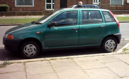

Here's a 'library pic' of the same colour and trim - it looks like this now, just covered in moss.  The wheeltrims look bloody awful:

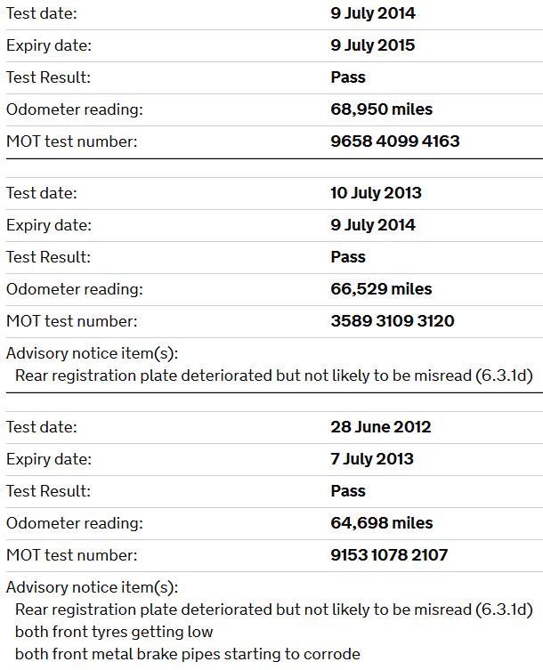

Non-interference is good, I'd heard about the floorpan (and boot floor) so will jack it up for a look.  The recent MOT history looks suspiciously light on advisories (although my aunt refers to her garage as 'The Mitchell Brothers' so who knows):
2011's MOT was failed on excessive play in the o/s rear radius arm bush, so let's assume that was sorted.  2010's MOT advised on corrosion on the inner and outer sill edges, but no mention since then.  I'm hoping she's kept the receipts.  I do believe it's had a head gasket (surprise surprise) at least once; these low-spec ones don't have a temperature gauge.
