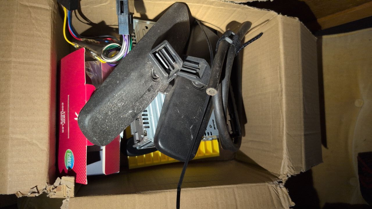

Rear view mirror
Found two in the loft

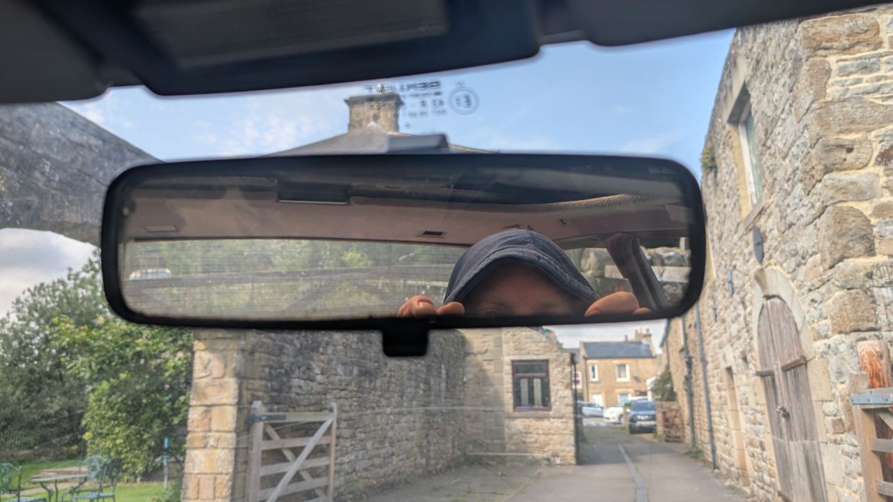

Mirror replaced.

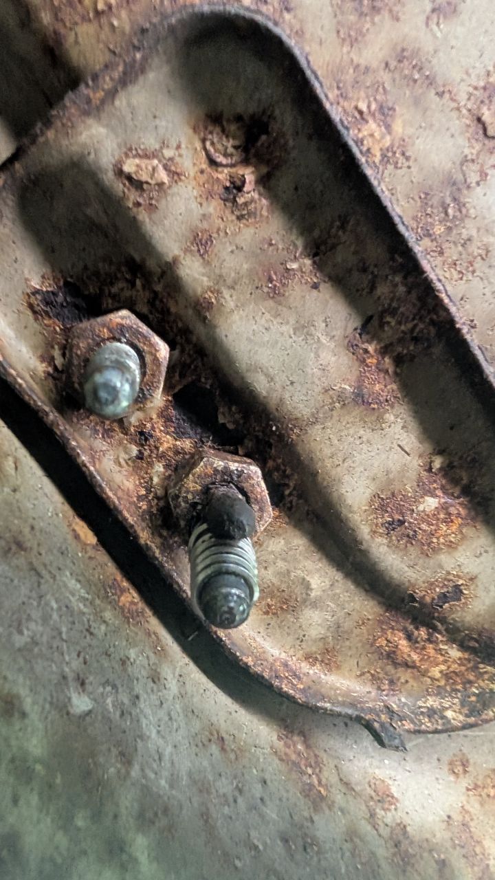

Christ almighty this seat is a bodge.
One bolt too small, not rated, into a plate on unknown metal bolted to the floor.
Two correct, finger tight.
Two oversized hence blocking the seat.  Heads inaccessible because the seat bolts to the rails are in the way, and can't be moved because the spot welds have been ground off.
FFS 😂

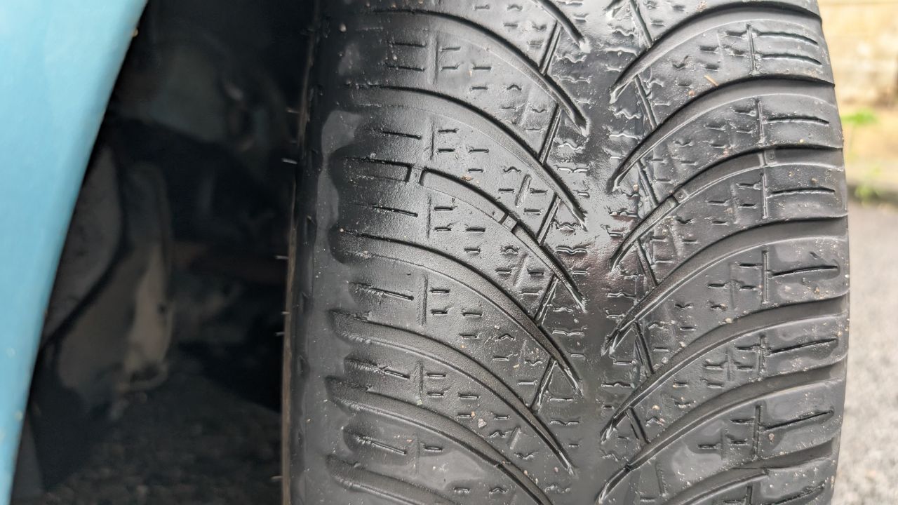

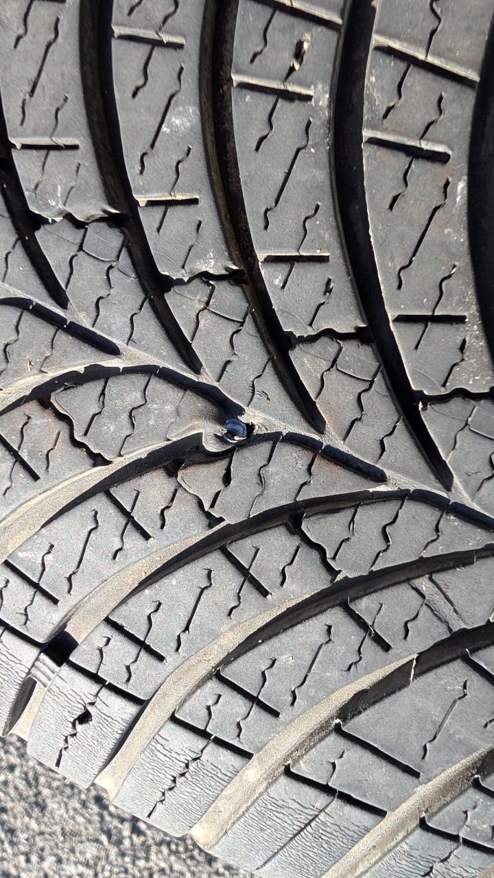

Kwikfit are near to mrs_l1s work, but they refused to fix the puncture and declared the front tyres unsafe.  Quoted £550 for three tyres.
These are the fronts, at 2mm.  The inner edges are a bit more worn.
PXL_20250910_155800535_MP.jpg.073bc72b29aba1efc1d45ca7ae0b50d9.jpgPXL_20250910_155808151.jpg.aef32c51f008305ae3e6214a24a82bc6.jpg
The other rear is at 3mm, so have ordered a full set for £435 fitted from Halfords TOTD.  Eleven months and 19k
Not bad on mileage TBF, are you inflating them to more than suggested pressure? Seems odd to wear most in the middle.
Wear is on the inside edges.  They've been at 38 most of their lives but have realised they're more comfortable at 33
Been a long day, I did read inside edges but my eyes were looking at the middle of the tyres in the picture for some reason.
  • loserone changed the title to 🚨L1's♦️🦁 shenanigans. MOT time, 3/5 down, EV eats tyres in under a year!
Wonder why one looks worse than the other

sounds like the pressures killed the tyres
  • loserone changed the title to 🚨L1's 🇫🇷 shenanigans. EV eats tyres in under a year!
Could be right, that one was a teensy bit lower, it'd take a few minutes more to change pressure as the temps rise.

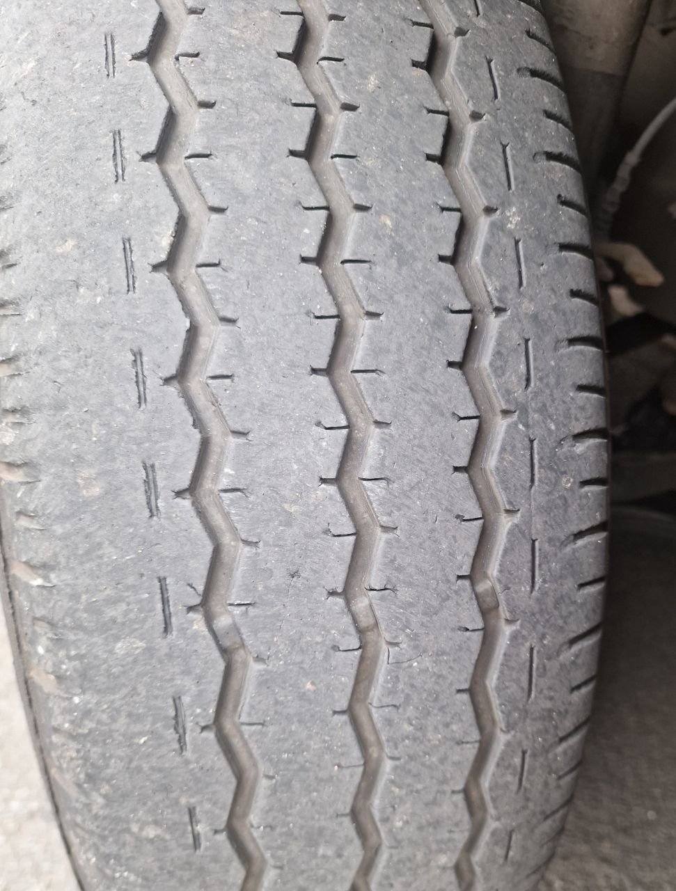

You need van tyres, 50k on my Vivaro's factory Continentals. I think they might be made of stone given the abysmal levels of grip and glacial wear rate.
The absolute max I've had on my various transits and relays etc is 15k. Mostly changing them around 10-12k fronts only. The rears never wear out. It's always the nearside front outer edge that wears. I wonder if it's the weight I carry?
I've recently swapped the front two to the rear. These are 12 months old and about 12k miles. The rears were still like new.
