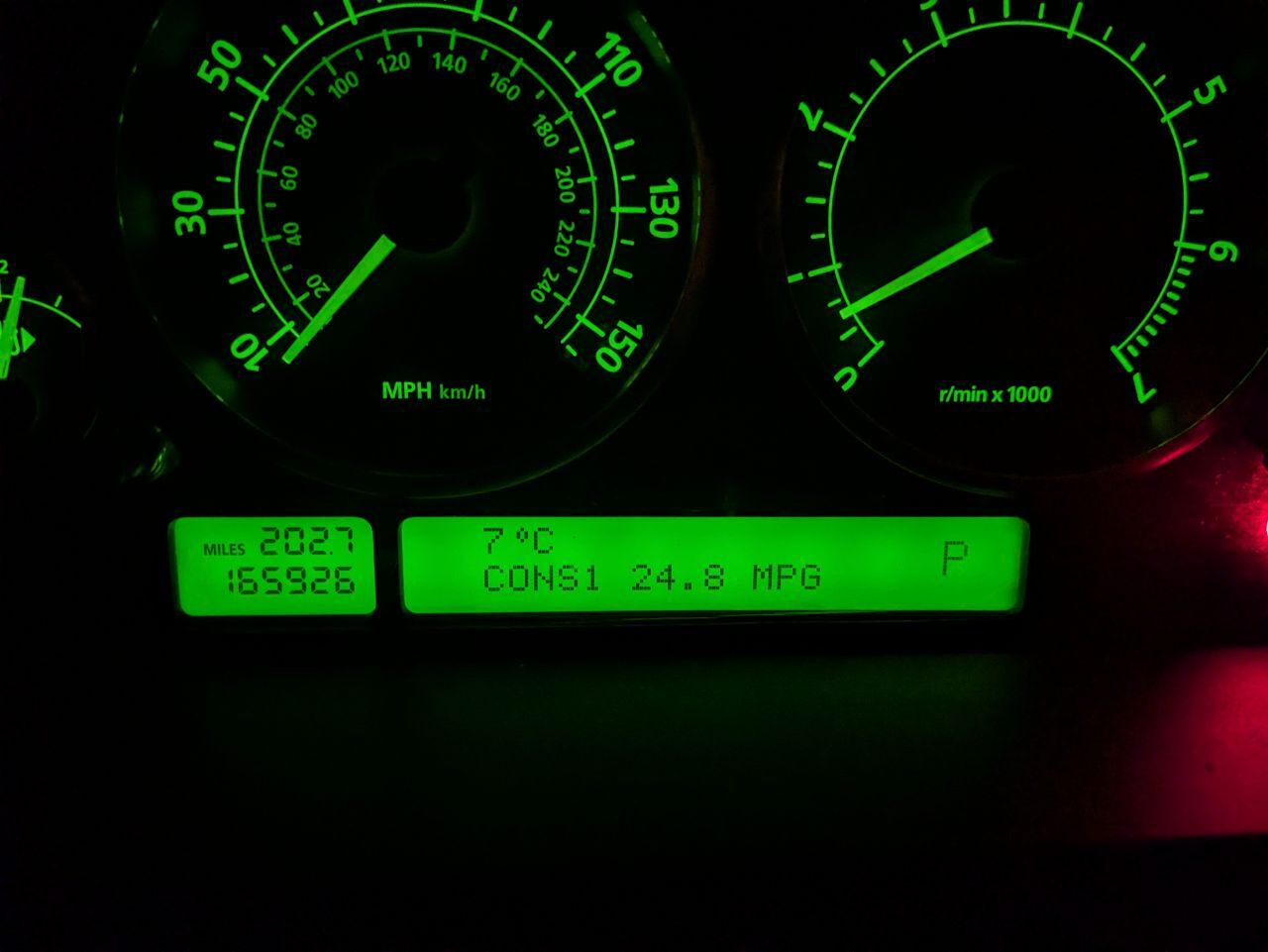

Lovely to meet you briefly yesterday, impressive fuel economy figures on your way home!
Now what?  Is 4 cars enough?
Great to meet you too! Still smitten with the L322. I doubt I'll ever see these figures again though 😂PXL_20260131_184714923.jpg.79728e7fdc43eefdde0b61373e43ef19.jpg

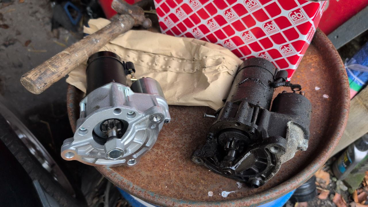

The 205 wasn't starting after being sat over Christmas.
Pretty sure it's the starter solenoid sticking but no amount of smacking it with my 1.4 205 starter motor custom made hammer made it work (I have been here before).
So elected to buy a £55 starter from eBay and stick it on.
The old one is pretty minging but I might clean it up and keep it as a spare.
All good, back up and working but no charging.  FFS.

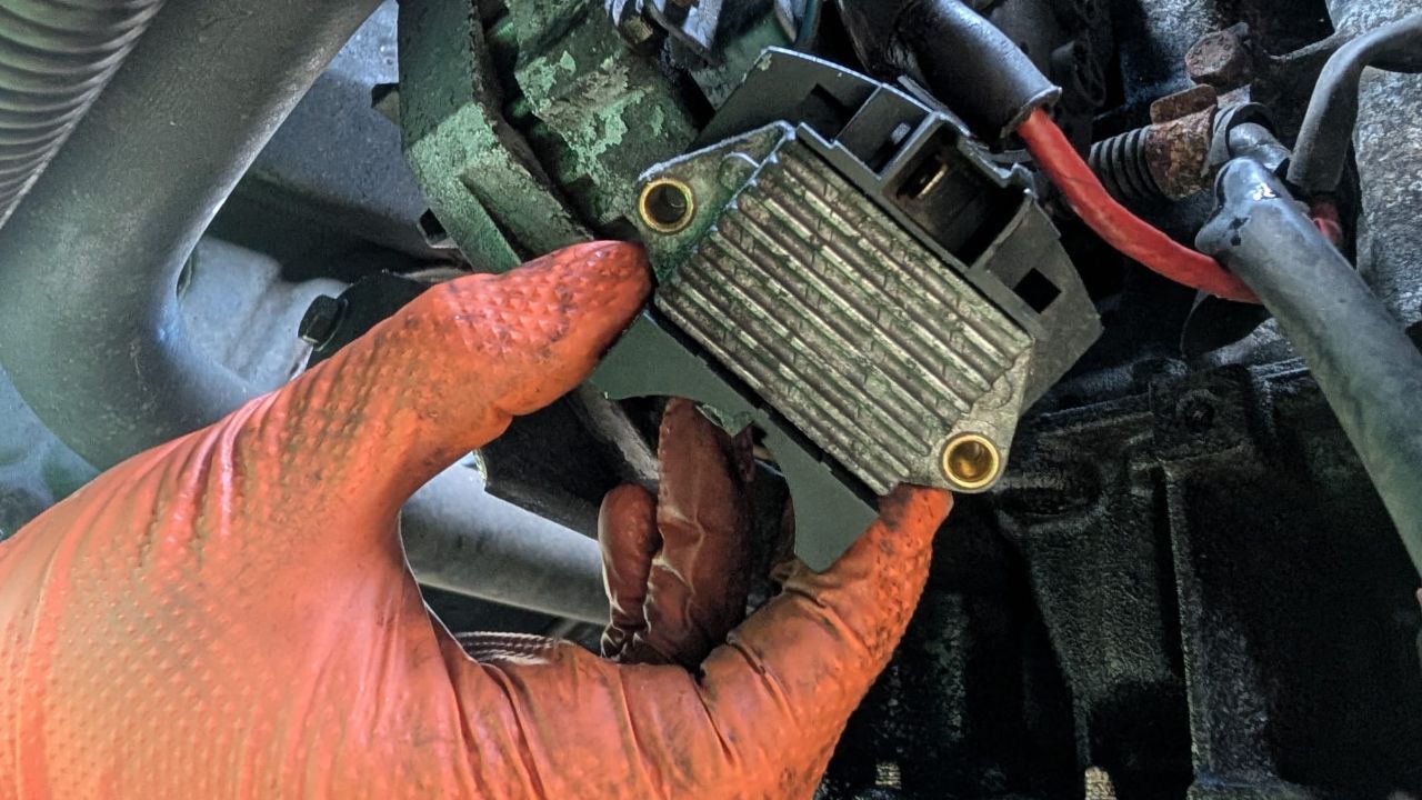

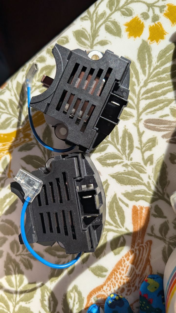

Figured rather than buy a new alternator I'd try a regulator pack first.
Here's the old one.

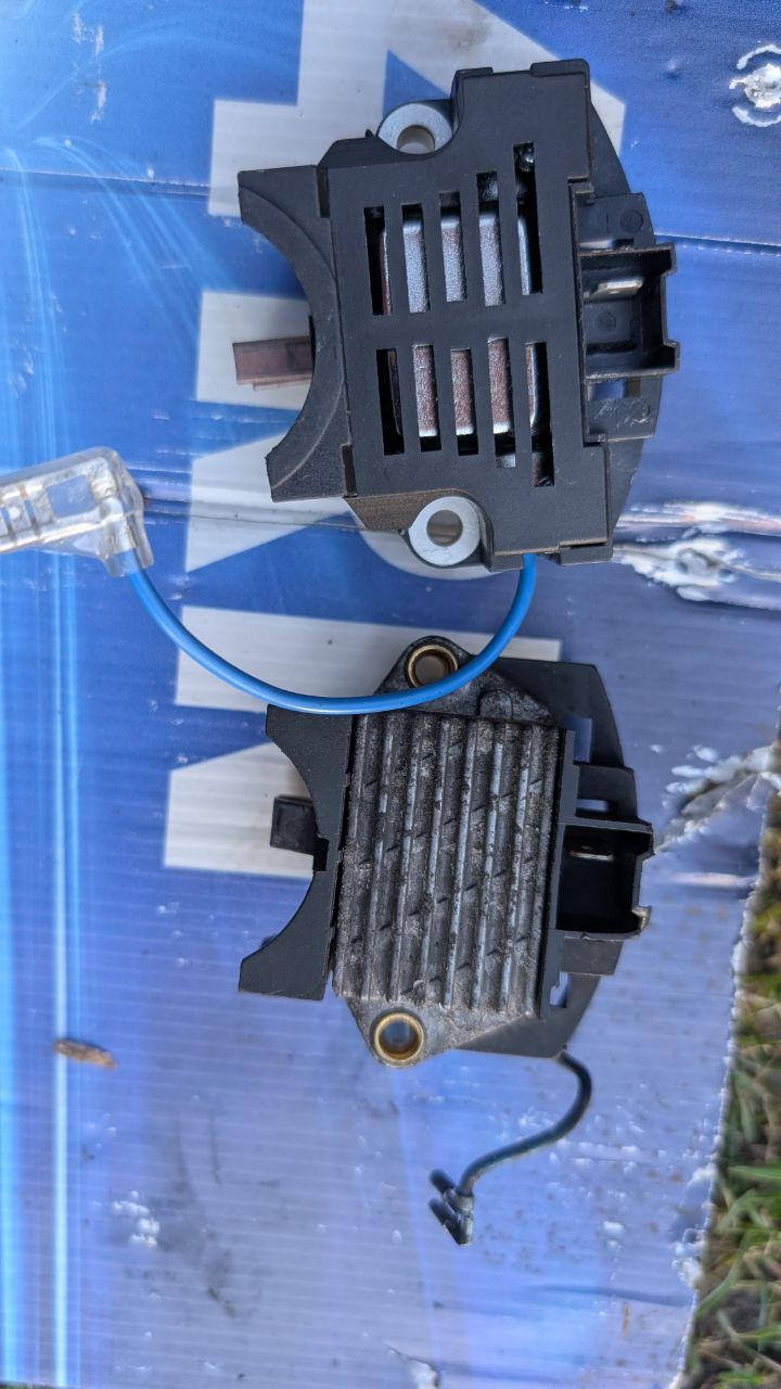

They sent two packages of the new one.  Odd.
Guess I have a spare
Side by side with the old one.  Does it work?
No.
A quick sanity check and realised I'd connected the alternator to the wrong terminal on the starter like a muppet.  Fixed that and went to pay @Jimbob McGregor for an hour he spent on the l322 before it left the pasture.  Drives lovely, got home with the battery charged up and went for reverse

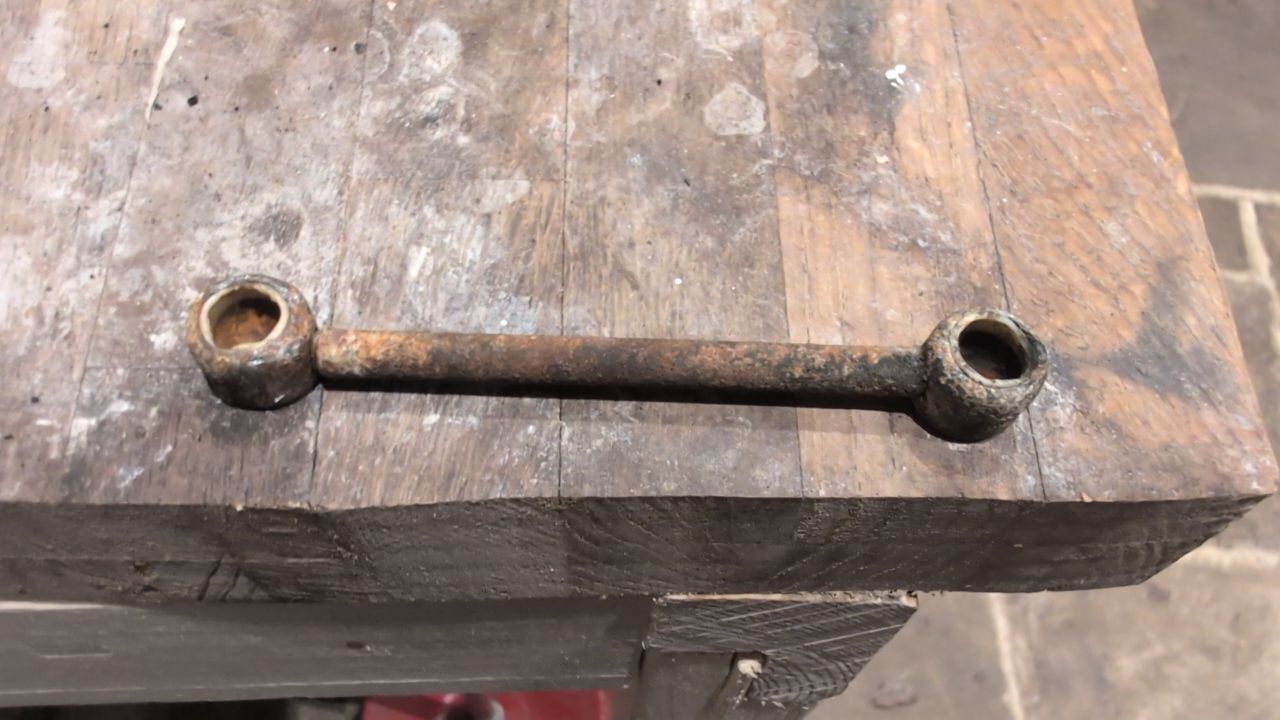

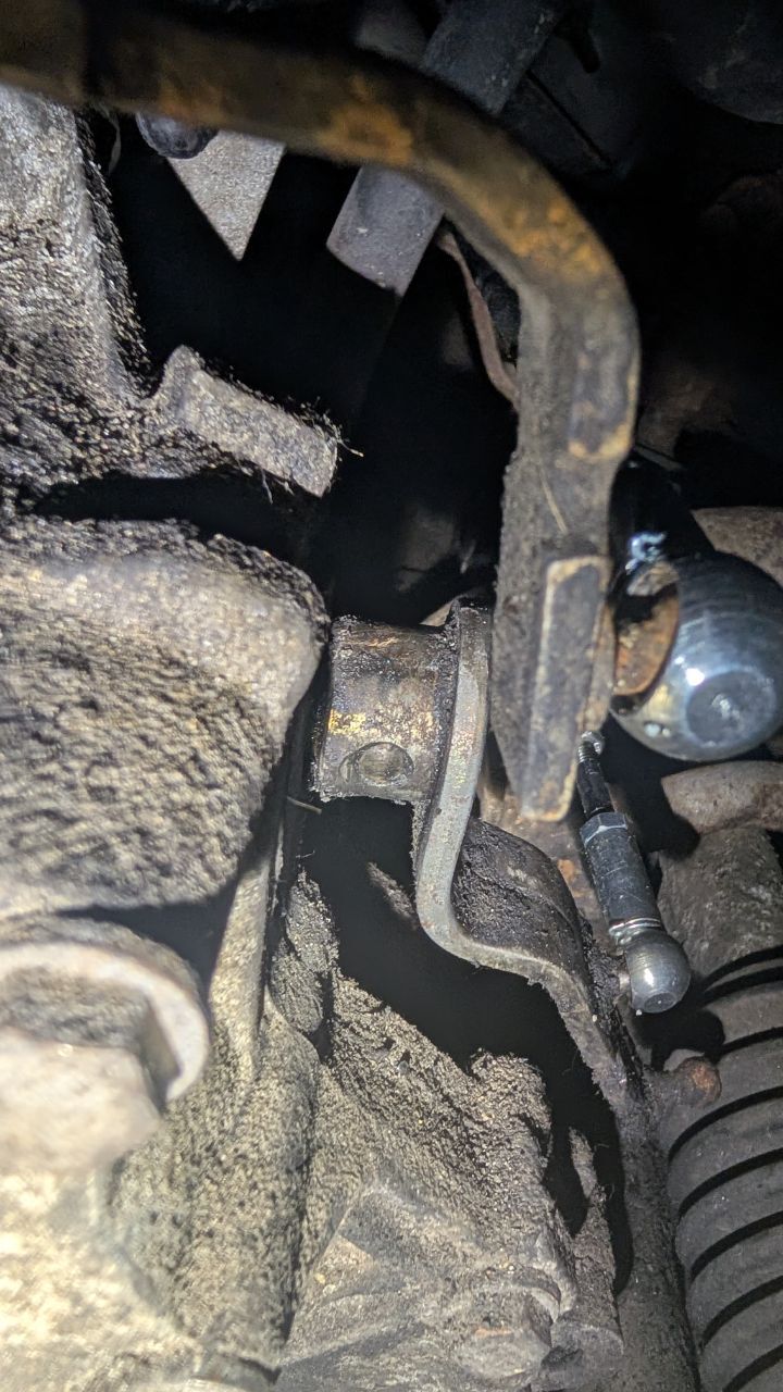

This bit is supposed to look like this
But instead looked like this.
Pushed the car round the side and popped the linkage off.
Used my pro* welding station in the utility.
Now all back together and fixed*.  What next?

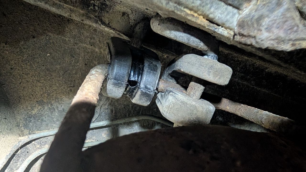

Exhaust rubbers.  The top one died and the exhaust was hanging low.  The other seems OK though.  How much of a cheapskate am I only bothering to replace the broken one?
Wise move actually, as pattern part rubber is shite, if you replace them all at once they all will fail again around the same time.  Drag out an OE rubber as long as you can IMO.
This way means there's a spare in my door pocket too.
Agree with the above, pattern exhaust rubbers of that type are poor, if old ones still work ok leave them be. If it aint broke..

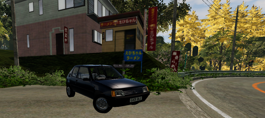

Art imitating life, or something.
Sorry, L1, I've taken your car to Japan.
Let's see it in Japan then AC.

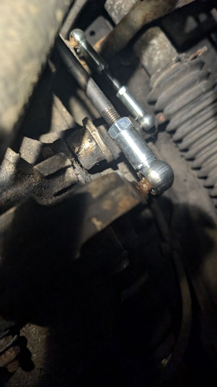

With the 205 gear linkage woes, I’d recommend these guys for new ones. Used them a load of times, decent quality stuff. Specialise in French stuff, and they really like 205s:
https://bakerbm.com

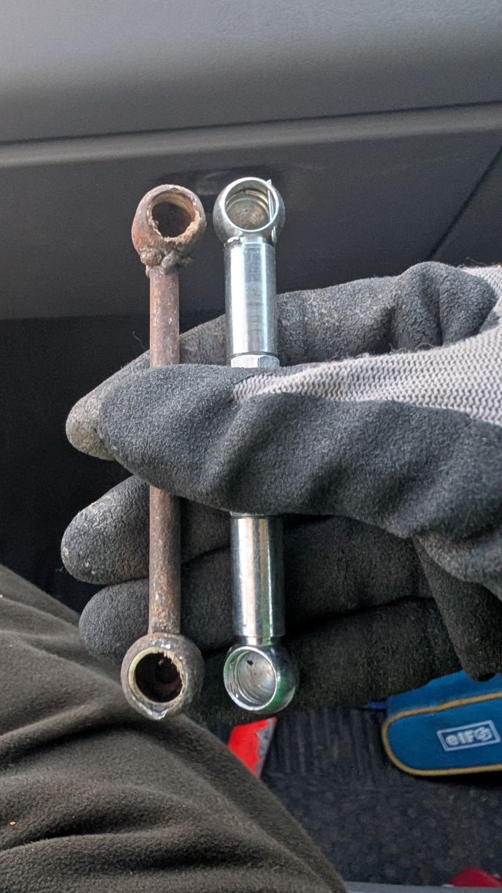

That's a very easy way to spend £120 instead of three minutes welding.
Without casting aspersions,  I can weld like you.
I'd get it done properly or it may* fail again.
Yeah that's fair.  I did give a good walloping with a hammer but it's not ideal
The welds crack.
Ask me how I know.
I make them from 8mm ball joints with a security clip and threaded bar, they dont come off again unless you want them too
https://bakerbm.com
These guys only do GTI stuff.  For the MA box only Pug1off make em.
In unrelated news
Forgot the GTI has a BE(?) box. Keep thinking they share the MA with the 106/Saxo/AX.

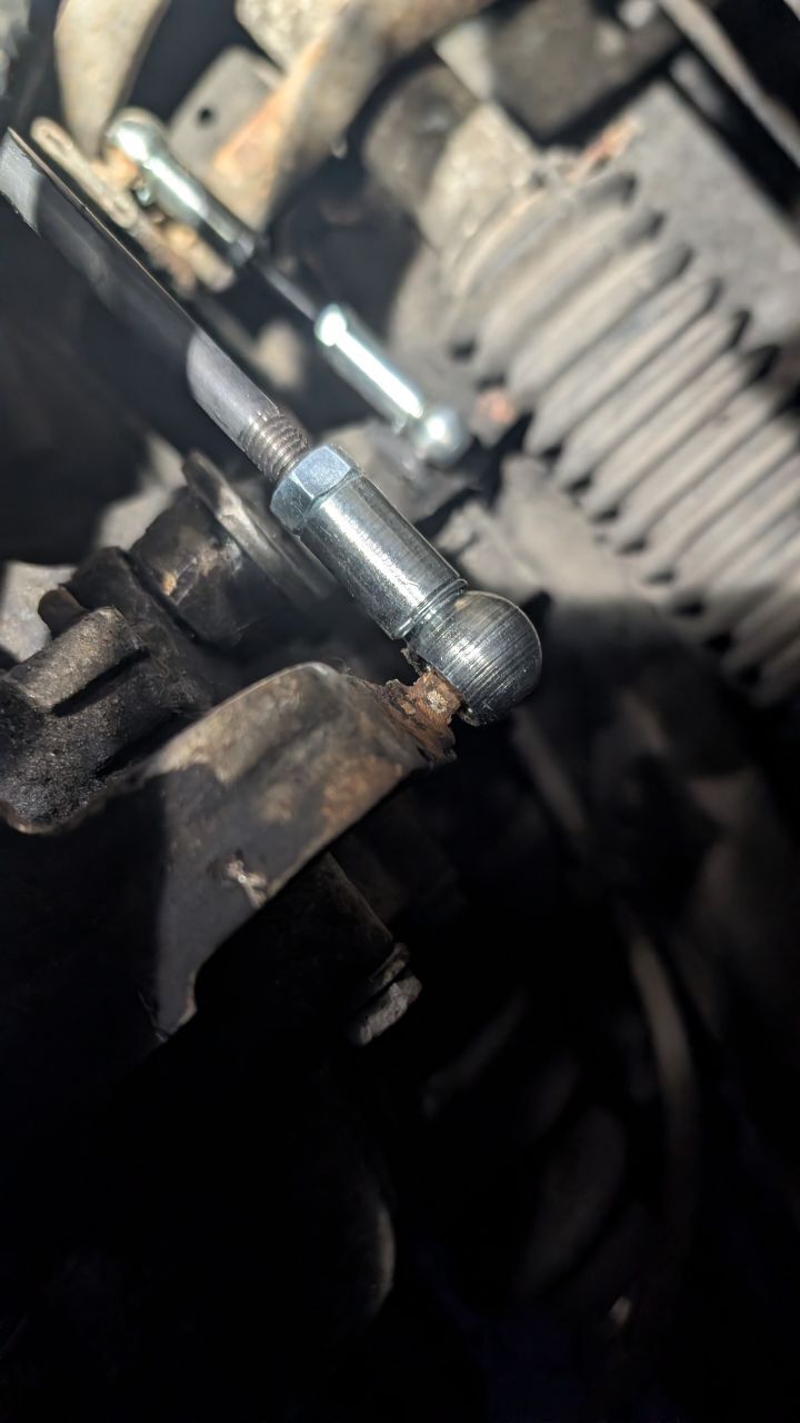

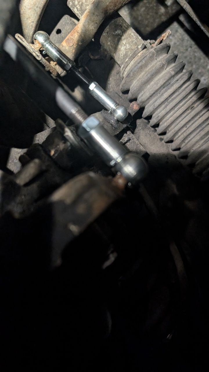

Fitted a couple of things.  The selector fork thing seems to be where most of the slop is but it's still an improvement.
