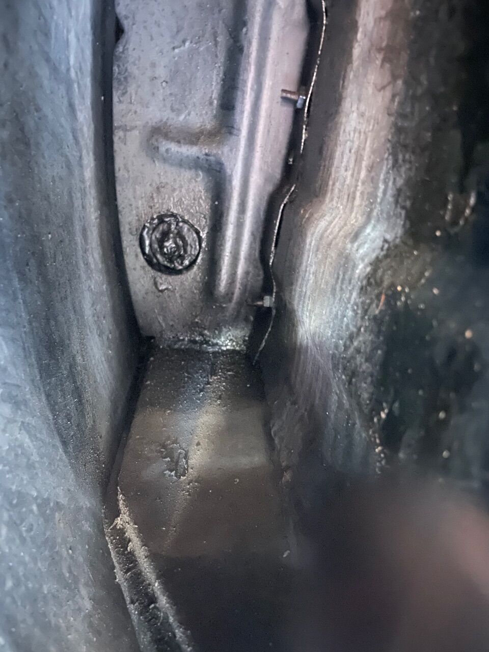

next i unbolted the OSF inner arch/ bulkhead closing panel to have a look…
Looks decent- so i then blasted some dynax s50 into it, managing to also coat the inside of that double skinned hinge mount, and making sure any seams were given a good going over as well… photos got gradually worse due to the carrier solvent being in the air/ and also having wax on the camera lens- mid way through
I also looked at the headlamp area @chadders and cleaned up the whole inner arch and in this area used dynax UB which is a “firm film” thats more uv stable and resistant than the pure cavity wax…

It's looking pretty good underneath there, I think that you’ve got a real bargain.

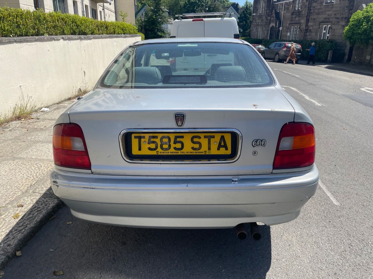

Here it is- it is - in its slightly battered glory, with fully functional a/c and parking damage…
wierdly the damaged/ missing repeater has been replaced with an audi type led one that blinks across
  • HMC changed the title to HMC NEW £500 Rover 620GSI automatic
I was wondering how you got an automatic rover 600 for £500 then i saw the bodywork 😂
But what of the (knackered) “wood” ?
Its actually real (knackered wood)
A relatively easy fix then.
