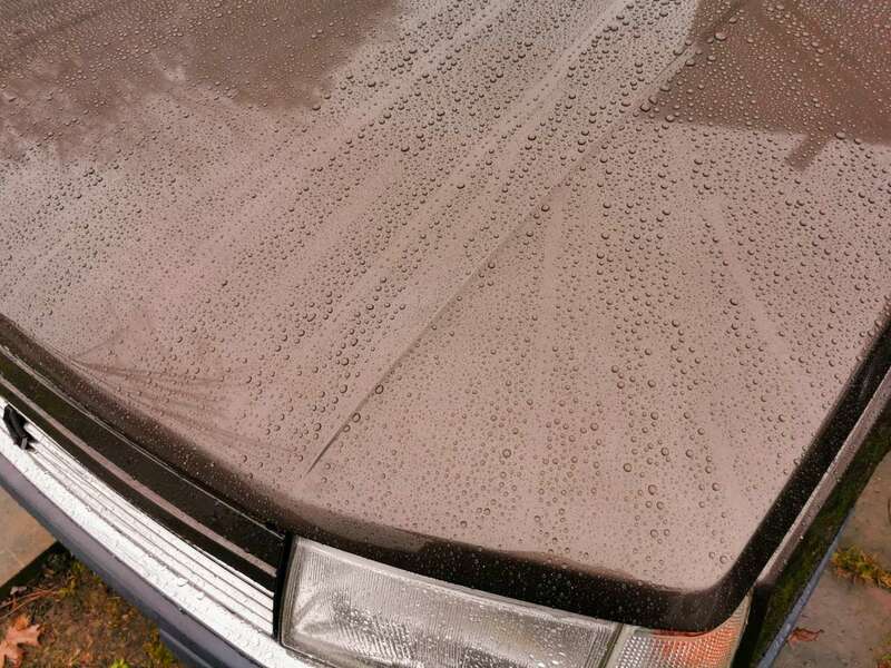

I only did the bonnet, but I wanted to see how the paint would take the a polish/wax.  Still feels quite rough to the touch as there's so much ingrained crap still in there - really wants a good machine polish/clay treatment, but that doesn't surprise me in the slightest given how absolutely disgustingly filthy it was.
Does look better in the rain now though!
Have to wonder how many years it is since water actually ran off it like that.

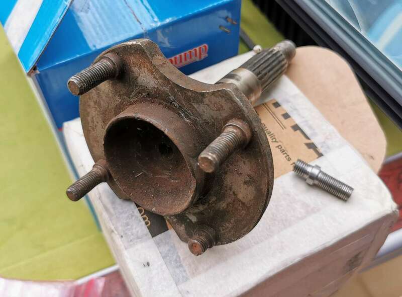

A parcel arrived this afternoon with something which I think will be quite useful.
Which hopefully in conjunction with the newly made stud in the background will hopefully be an opportunity to put the wheel stud issues I've had with TPA behind me.  Will see if I can get the new hub at least cleaned up and stud fitted to it at the weekend - not really expecting to have time to get it fitted to the car, but we'll see.

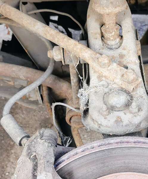

Bad news: The drop links and anti roll bar bushes I had sourced are wrong.
Drop links are about an inch too long and the wrong shape.  Anti roll bar bushes are for a 22mm ARB, the one on the car is 24mm it looks like.
Can't say I'm massively surprised.  I knew finding parts for this car was going to be a bit of a trial and error game going in.
They replaced both of the lower ball joints and one baggy track rod end and reset the tracking.  There is still a very light knock/rattle there but it's very minor.  Plus I know where it's coming from now so it's a minor "that wants sorting" issue rather than being worried the whole front end was about to come apart.  Something must have had a bunch of play taken out anyway as the really heavy knock that you could feel through the whole car has gone.

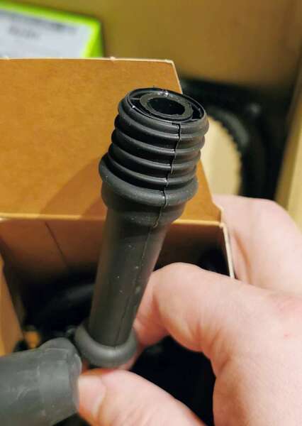

A box arrived for it this morning too.
Quite a few things in there, but most notably at the moment are a new set of HT leads, new rotor arm, spark plugs and distributor cap.  That will hopefully evict our occasional miss (which never appeared again today).
The HT leads are notable for having ends which are actually compliant...I actually thought the outer boots were plastic on those currently on the car.

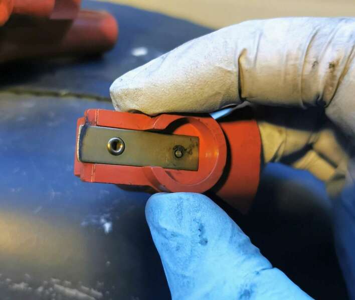

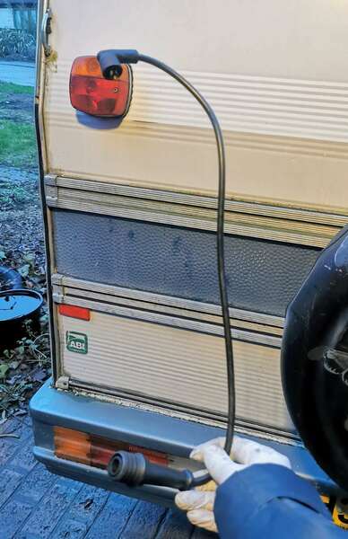

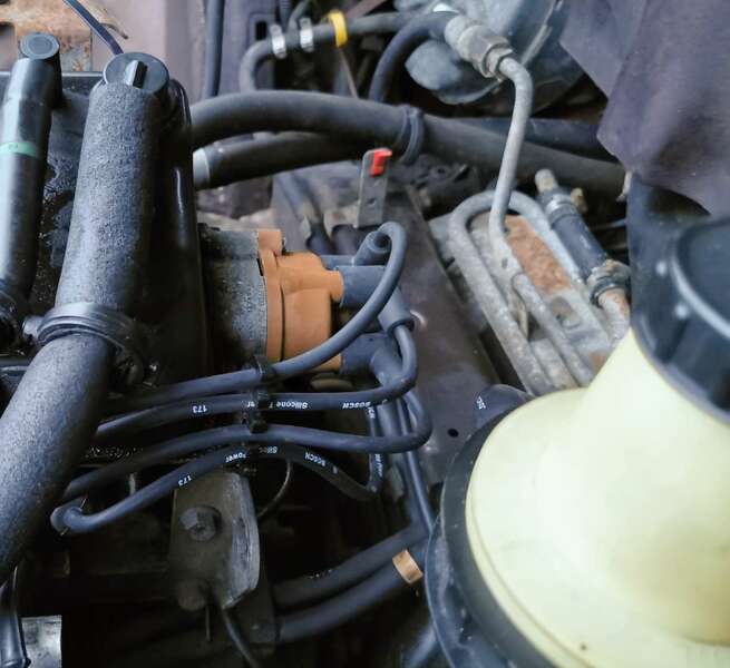

Spot the difference?
Not really obvious I know.  There's a new set of HT leads, new distributor cap and rotor arm installed.
New cap and rotor are both Ducellier branded - ones on there bear no maker markings whatsoever which never exactly gives a great deal of confidence.
This looks like it's been in there for a day or two.
I rather get the impression that's been on there for more than a couple of thousand miles.
The leads definitely have seen better days...I'm pretty sure these are meant to be flexible...
Given I know the insulation on these is compromised (I've managed to get a right belt off them while in the vicinity) there's only one place for these and that will be the bin.
Haven't found an obvious date code yet, but I suspect they may well be the originals.

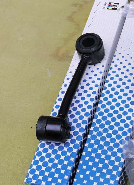

My next challenge is to track down the correct drop links.
This is what Autodoc sent, and what a few places seem to be trying to send.
These are 152mm and have a little bend to them.
These do not match the car.
Which someone helpfully gave me the original Renault part number for over on the French Car Forums: 7700766869.  Which has allowed me to find that they should in fact be 131mm.  Found plenty of places listing them...nowhere with stock.  Well not quite true.  Found three places so far which have.  One in Italy, one in Turkey neither of which ship to the UK.  Last one is in Russia, which obviously isn't much use right now.
If anyone knows of someone who might have a couple sitting on a shelf somewhere feel free to let me know.  I suspect that re-bushing the originals may well wind up being the way forward though.

Any way the bushes out the new ones could be fitted in the old ones?If they're not bonded in, might be a possibility. Or cut a bit out the rod and join it back together, welded inside some thin tubing for reinforcement.
I need to double check they're the right size first.  Most places seem to think the ARB itself is 22mm diameter rather than 24mm which is actually on the car.  Plus I've no idea if the outer diameters match.
Regarding making a cut and shut link...don't know.  I don't want to fall foul of it being declared an unsafe modification at MOT time.  I'd be more inclined to re-bush the originals if it's possible.  Even if the original bushes are bonded in I'm sure that can be dealt with, and you'd think that out of the squillions of polyurethane bushes that are made these days we'd be able to find something with the correct dimensions to get pressed in there with enough digging.

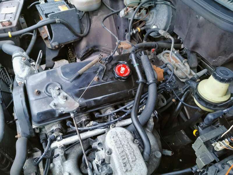

Only had about ten minutes to spare today between other jobs but threw the new spark plugs in.  I hadn't seen until I started the job that they're taper seat plugs, so very glad they came out fine.
Obviously haven't been in there very long at all, but checking shows the ones which came out are the wrong heat range, so I'm glad to have replaced them.

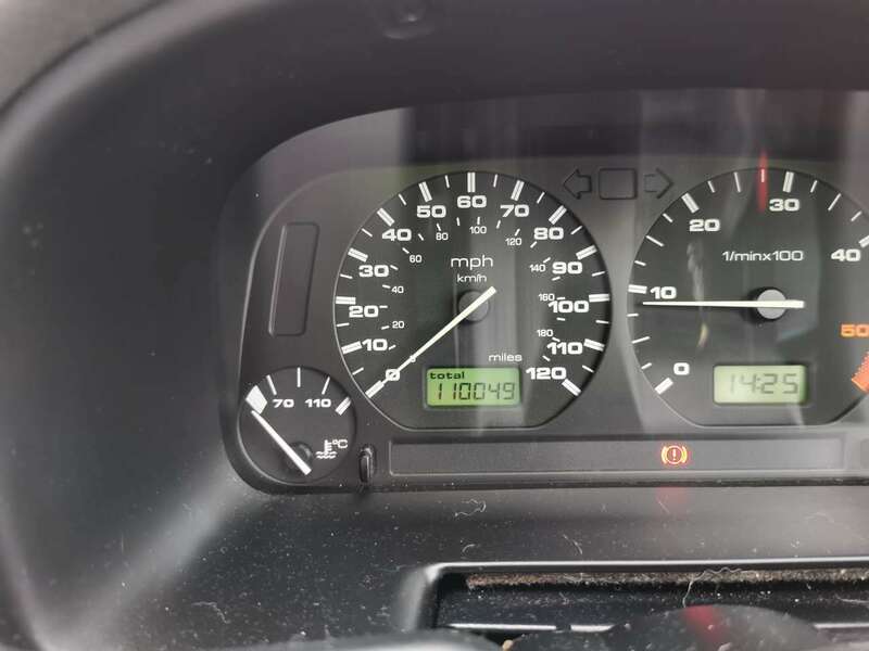

Noticed this afternoon that unnoticed by me the Caddy ticked over 10K miles since I picked it up while we were out yesterday.
It was something like 50 miles shy of 100K when I got home from collecting it as memory serves.

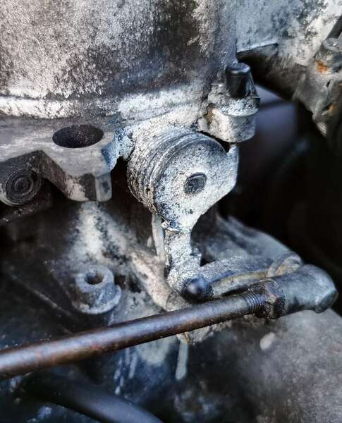

This is the horrible stuff I was talking about that's been slathered all over pretty much anything that's meant to move on this car, including the door locks.
I'm sure at some point it had lubricating properties, but it's like fully set candle wax now and can be removed in chunks with a screwdriver.  Wouldn't surprise me in the slightest that if this is removed and replaced with something with actual lubricating properties that the door locks started working normally again.
I don't *think* getting the latches out is too difficult on this car.  Hoping that's the case, after which point I'll probably pretend they're a carburettor and dump them in the ultrasonic cleaner to cook for an hour or so to get rid of the old grease.

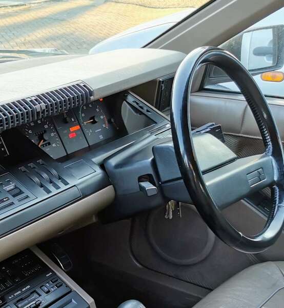

Here's a sight you're not going to see very often given that there are only two of them left on the road. A lovely slab of brown (I don't care if the brochure and the DVLA say it's bronze, it still looks brown to me) to brighten a dull day.
Renault_25_E404LRP_Buckingham_2023-01-12.thumb.jpg.3ea1f89ed066dc7061a0ac05b884490c.jpg
  • Like 12
Car has only been that far from home once so far too!

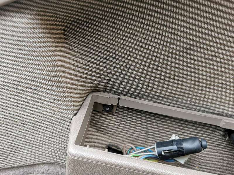

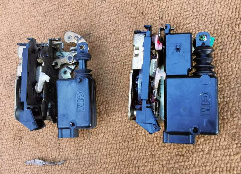

Today has been moderately frustrating.  The weather very much hasn't helped.  When I started out it was a bit chilly, but skies were clear, it wasn't windy and weather forecast said I had a good four hours until there was a 30% chance of rain.  Yeah, 40 minutes in heavy rain arrived which then turned into sleet.  Right at the point where I couldn't abort the job I'd started so just had to put up with it.  I was soaked through and frozen to the core by the time I got back into the house.

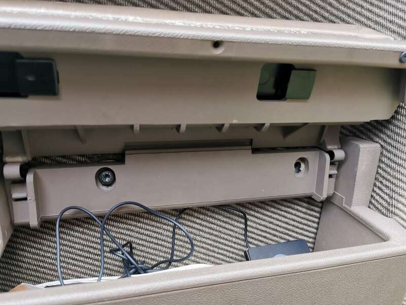

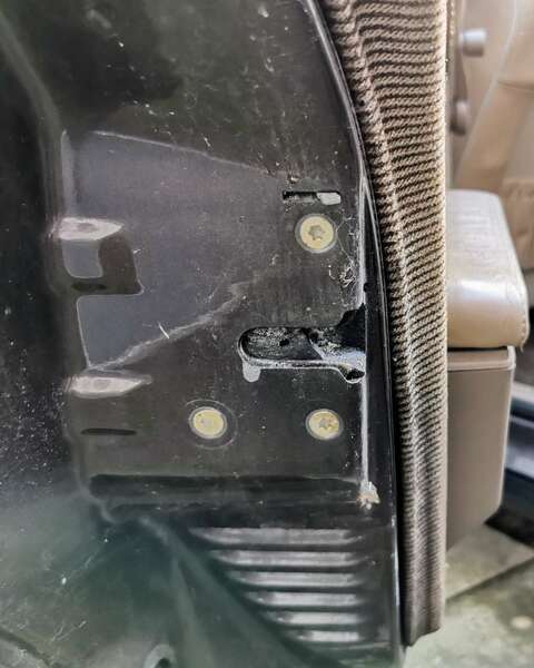

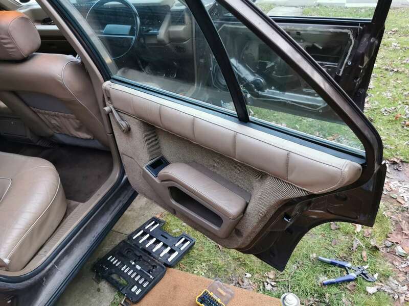

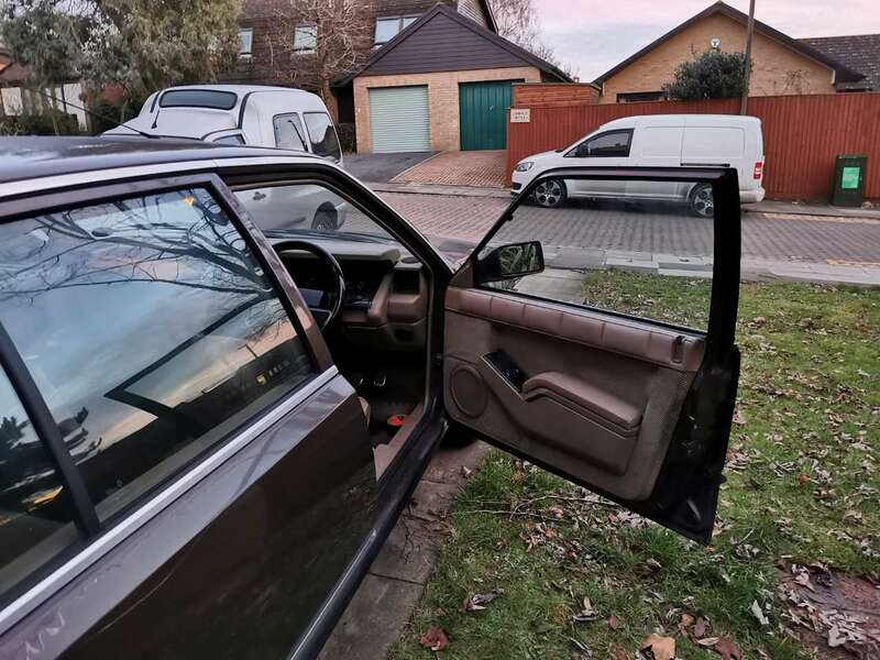

Today's target was the driver's door on the Renault.  Having it deciding randomly whether to latch or not depending on mood was less than ideal.

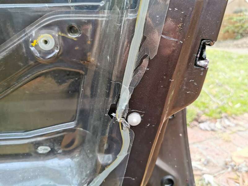

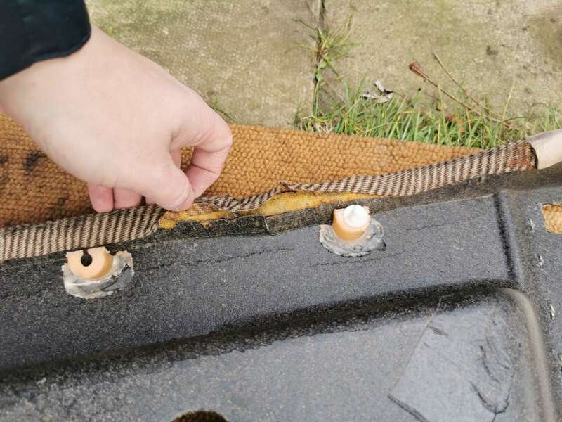

Someone had at least had a go at getting into the door before.  Evidenced by two screws being missing - one here visible and one other down at the bottom of the door pocket.
Evidently they didn't get fully in, apparently being flummoxed by this little plastic nut.
Annoyingly they managed to crack the plastic.  The only really awkward bit was getting that blasted mirror adjuster out of the control panel, that's a right faff.
Once that's out it's pretty easy to get into.  The trim clips are even a pretty sensible type that pop out pretty easily.
Sadly there was evidence of someone having tried to use brute force to get in without having removed the armrest, having broken the backing of the trim panel in a few places.
This will need addressing at some point, probably with some fibreglass resin, but that's not a job for today.

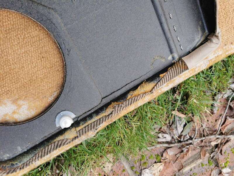

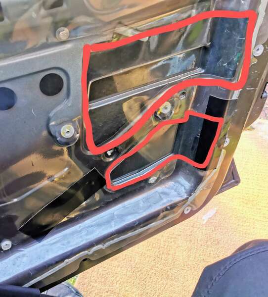

Whoever had tried to get in had also managed to smash a bit of the waterproofing panel.
That's an easy fix though.
The panel was held in with a mastic type compound which is still compliant and sticky.  This is helpful as it meant that I could just pull the panel partly back to get to the lock and shove it back in place afterwards.

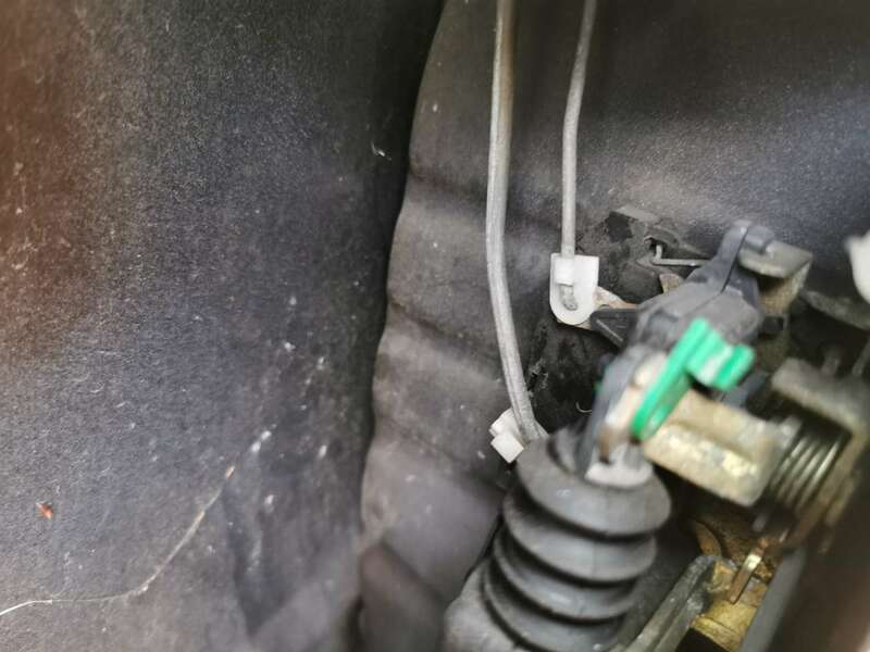

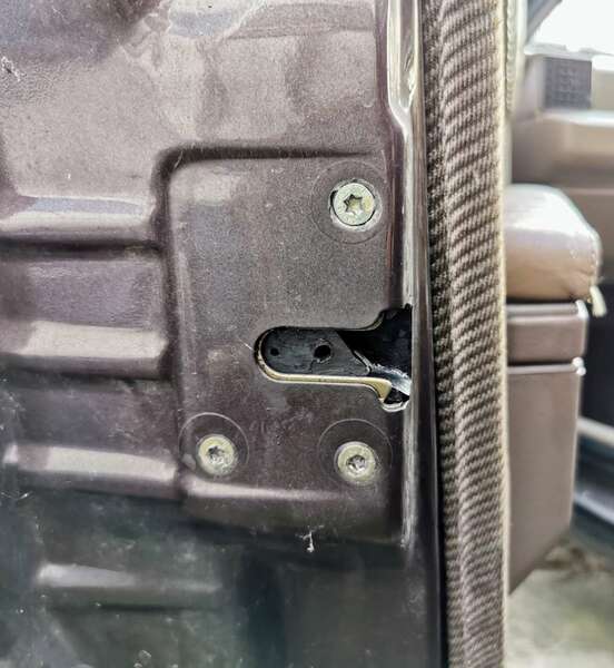

Getting into the lock itself and getting it out was actually very simple.  There's plenty of room to get in to remove the linkages, and they're secured by little clips that just need to be turned through about a quarter turn then the rods can be pulled out.
Here's the access you have to work through in the vicinity of the lock...which is so much better than any other car I've tried to get to anything inside the door on.
The three T30 Torx screws actually holding the lock in were wicked tight.  I was getting seriously worried that they were going to strip out before they cracked off.
This is the point at which the sleet arrived so there are no more photos.

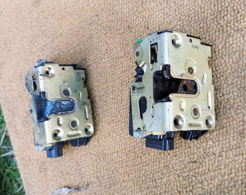

Basically I took the lock out, emptied about two cans of carb cleaner through it to flush out as much of the old crusty grease and crud out, the re-greased it.
The action was definitely better than it started, though the latch pin still seemed to have a lot of drag on it.  Though when reassembled... it's worse than when we started.  The door now needs a wicked strong slam to fully latch.  Well it's kinda worse...in that you need to slam it silly hard to fully latch, but it does now consistently latch the first safety position rather than just bouncing open.
...So I need to pull the whole lot apart again and try again.  I reckon I need to get the latch itself more thoroughly cleaned to see if I can get it to move more freely.
There is no adjustment on the latch or striker, so it's one of those "it works or it doesn't" arrangements.
Given the weather forecast I suspect this might not be happening for a little while.

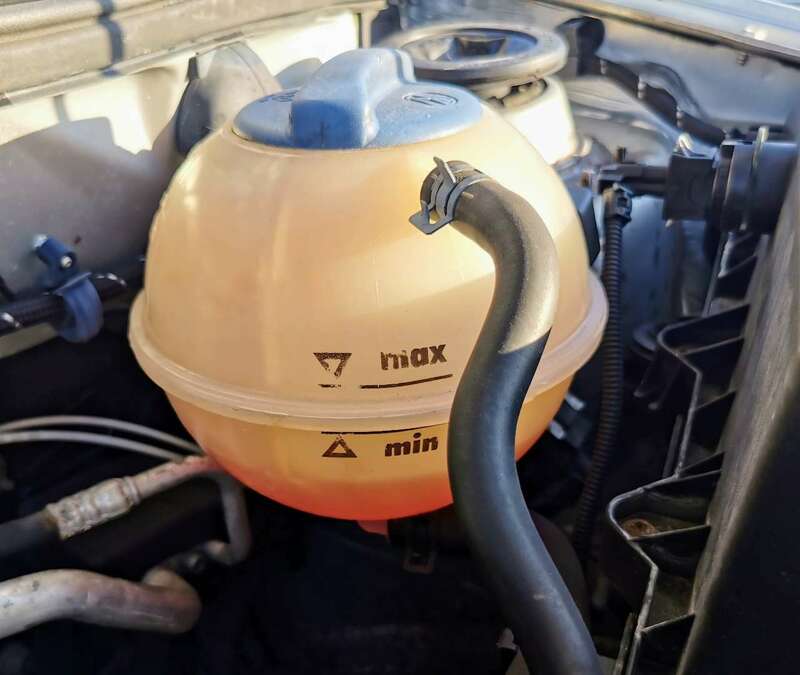

Well that's moderately concerning.
That coolant level hasn't moved a millimetre in the last 12 and a half months and 11K miles...yet has dropped a good 2" in the week.  I can't see any obvious leaks, and there's no mayo/signs of oil level increase which might suggest head gasket issues.  I'll need to have a more detailed dig around the engine bay at the weekend.

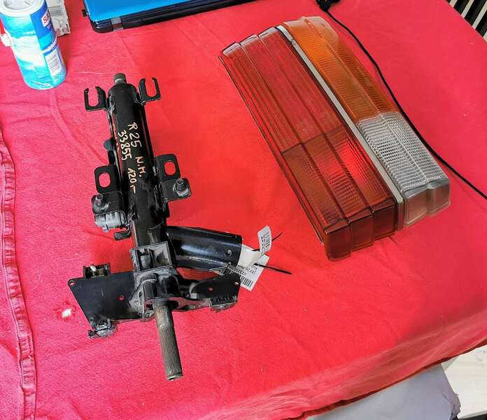

A substantial looking box arrived this afternoon.
Which somewhat usually in my experience for a box from a car dismantler turned out to contain a couple of items that were exceptionally well packed.
After nearly an entire recycling bag of unwrapping later the contents were revealed.
The steering rack was a bit of a shot in the dark as they were listed specifically as LHD - though visually I couldn't see any obvious differences - and at €35 I was willing to take a gamble.

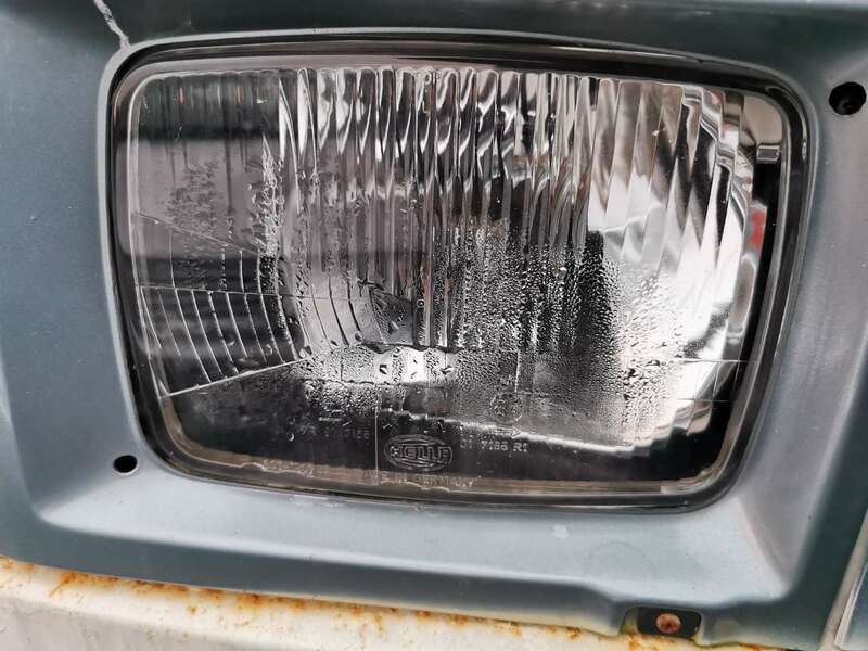

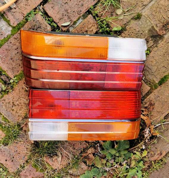

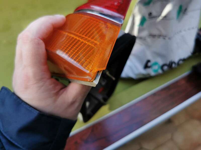

The tail light on the car had a pretty substantial crack in the top so obviously needed replacement.
What I hadn't realised was quite how knackered it was!
Yeah, that had seen better days.  New one looks far better.
There is a tiny chip out of the one corner but it's not massively obvious once on the car and is definitely a huge step forward compared to what was on there.
It wasn't in the photo the seller listed though, so I'll give them the opportunity to replace it if they wish.  I'm not particularly worried either way.  This is far better!

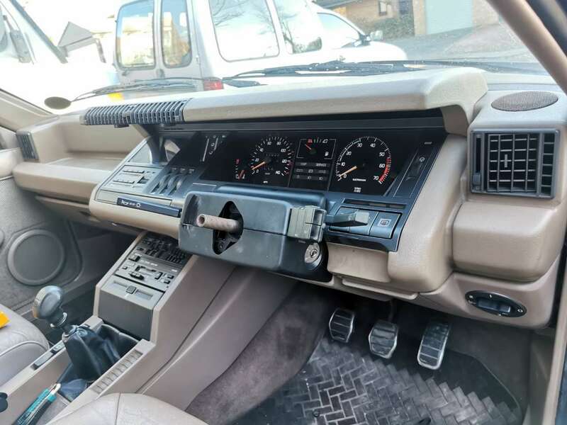

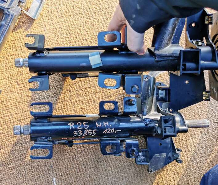

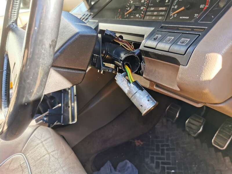

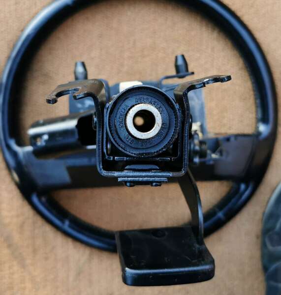

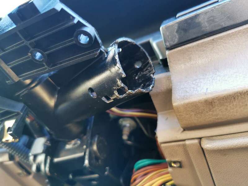

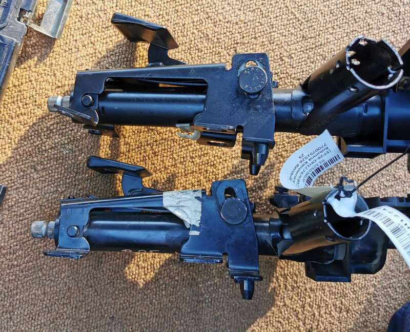

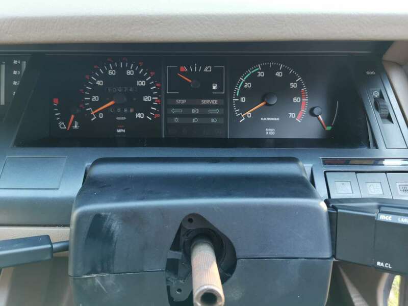

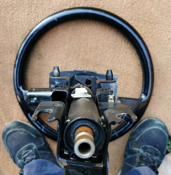

Next task... steering column.
The one this car came with had been damaged by a previous (as far as I can tell eventually unsuccessful) attempt to steal the car.  The take away message from that seems to be that Renault steering locks are formidable adversaries if you don't have the keys.

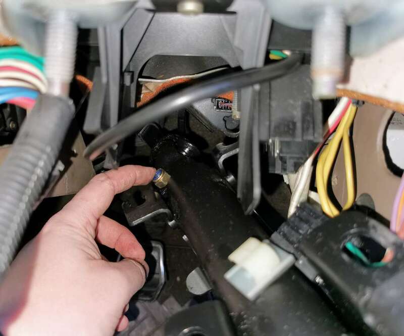

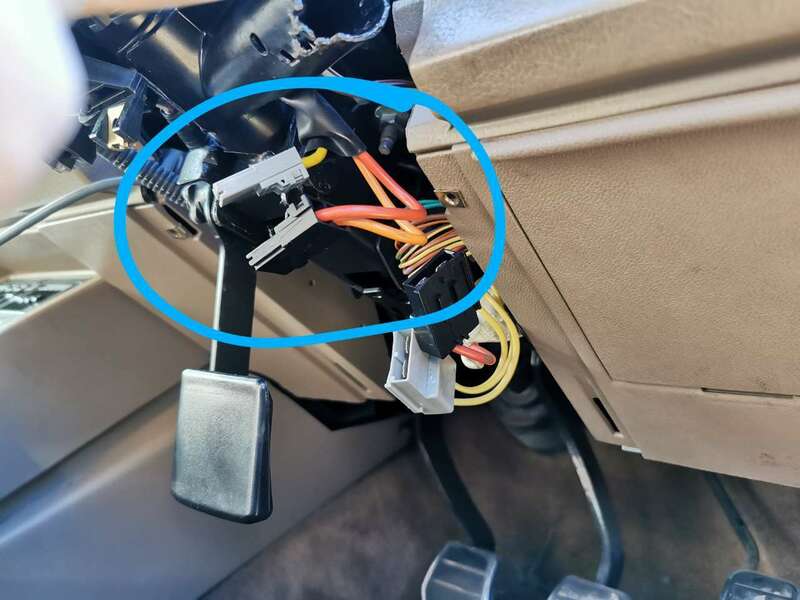

I meant to take more photos, but the process is basically:
[] Remove steering column top and bottom cowl (two screws - one in my case as the offside one wouldn't go in because the ignition barrel was the best part of an inch too far forward).
[] Remove lower dash cover.  Two screws in the top edge then it unclips downwards.
[] Unplug and remove the indicator and wiper stalks, two screws on the underside of each.
[] Remove the ignition barrel.  There's a position between the accessory and ignition positions marked by an arrow at which the retaining pins can be pushed in allowing it to just be drawn out of the housing.
If you're smart (unlike me) you realise that the wiring connector is actually a few inches down the wire and don't waste ten minutes trying to work out how to separate it from the barrel for no reason.  It's these two beefy looking connectors down here.
Renault even have helpfully staggered them in such a way that they don't try to bind up on each other during feeding through the housing.

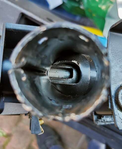

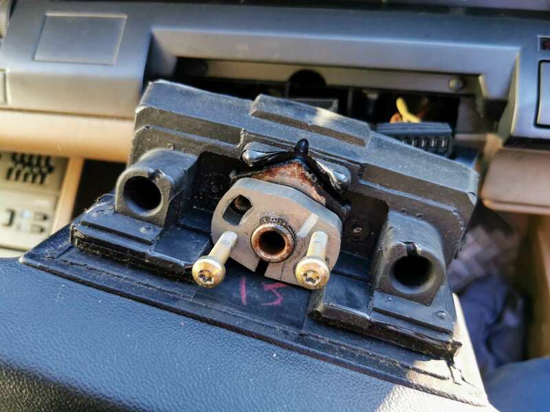

With the ignition barrel out precisely how much of a go at taking it out someone had had before.  What a mess.
[] The sensible next step (I missed this initially) would be to undo and remove the pinch bolt holding the upper and lower column together.  Note the body of the bolt also acts as a safety device locking the two together as well as the tension - so it does need to be totally removed.
I forgot about this step so wound up having to do it while the whole lot was hanging off the car.  Oops.
This also shows you a glimpse of the violence this column has been subject to.

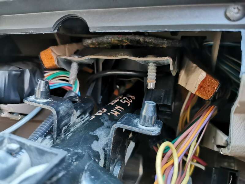

Note the bracket that the rear column mounting bolts (well...they're studs that nuts attach to actually).  This should be LEVEL and FLAT.

[] Once that pinch bolt is out, then the four 13mm nuts holding the column on can be removed.  At which point the whole assembly should just drop out.  There was one little plastic clip guiding a cable over the top of the column, but that was the only other thing I found that needed to come off.
[] I actually chose to leave the steering wheel attached to the column as it gave me something to get hold of to manhandle the assembly by.  It's quite awkward to hold onto otherwise.
Though it would normally be important to crack the steering wheel to shaft join before removing it from the car as it can be a bit of a struggle.  Except here it isn't!
Renault have been really considerate here - in the block that secures it, they have provided two threaded holes into which you screw the mounting bolts to act as a puller.  I like that.
What I didn't like was that I then utterly failed to get that bloody circlip off.  A set of circlip pliers is something I lacked, and I couldn't get by this time.  I decided to just come back to that later - putting the wheel back on could be left to literally the very last step without causing any problems.
So, column off, let's take a look at things.
New next to old.  Aside from some slightly more flexible looking mounting holes (the donor is off an earlier car), they look to be identical.
This is good, as the replacement was specifically listed as for LHD cars (I've not seen a RHD one listed since I got the car).
While the sheet metal I'd seen bent in the car wasn't massively substantial (and I was able to more or less bend it back into shape with my much abused Saab toolkit pliers), the column itself is quite beefy.  Nevertheless, it's taken a heck of a beating.
Looking up the column from the base makes the scale of the damage really obvious.
The top of that column should be level.
Yeah, there's only one place for this, and that's the scrap bin.
The metalwork under the dash has been more or less bent back into shape.  It's never going to be perfect, but it's a lot better than it was.
To to more with that would require at least the instrument panel to come out.

With everything bolted/screwed back together this was the result.
First thing that's obvious is that the ignition barrel is actually in the cutout in the cowl, whereas it used to be displaced about an inch forward and down.
It is still clocked very slightly anticlockwise, but only a tiny bit.
"Before" photo for reference.
Now it should have been a simple matter to swap the wheel over, I just needed to grab a set of circlip pliers.  As I was passing by Halfords while running other errands in the afternoon I thought I'd grab some there.  This turned out to be a mistake...the only ones they had were cheap and nasty in the extreme.  I wasn't exactly filled with confidence by the packaging!
Yes, that is a Halfords tag stapled to a nameless OEM card package...and the tool in it broke the first time I tried to use it.  So my steering wheel is still in the boot, which is frustrating!
Hopefully get this finished off tomorrow afternoon though.  Will be nice to have a steering wheel which actually rotates around the centre and doesn't press itself into my left knee at one point in each rotation.  I'm also no longer slightly worried that the wheel is about to snap off in my hands due to the trauma the steering shaft has been subject to.

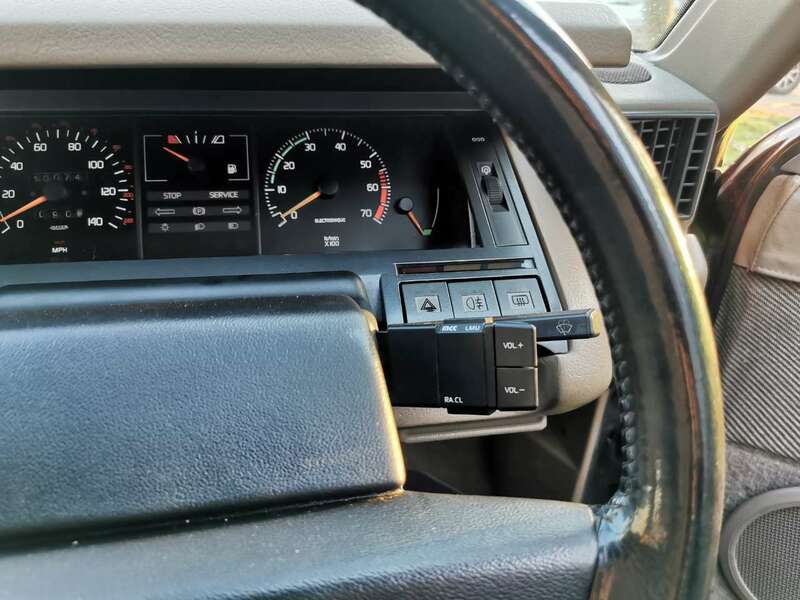

Notable from the driver's seat is that I can actually see the switches to the right of the steering wheel now.
These were always totally obscured behind the windscreen wiper stalk before.
Getting the wheel actually straight was a right faff.  It's still clocked very slightly off centre, but I can tweak that when it's convincingly above freezing.
How badly bent was the actual steering shaft?  Well about this badly.
That was recorded in landscape...thanks YouTube.
I don't want to know how much force that took...well actually that's a complete lie.  The engineer in me is really curious to know how much force that took.
Here's the state of the keyway the steering lock locates in.
Having the steering wheel actually rotate around its own centre and only moving in one plane rather than two really does make driving the car rather more pleasant.

Yeah, I hadn't *planned* on taking this door apart again today.  The driver's window deciding not to wind up again however had other ideas.
I think there's a dirty spot on the motor commutator as it occasionally "skips" while winding, and it managed to stop on exactly that spot.  Once I'd stripped the door down far enough to figure out exactly where the motor was and highly technically thump it, it started working again.
Because French.  Also "exactly the sort of issue to expect on a car that's not been used regularly in forever."

Well I've just spent another couple of hours faffing about with the sticky door latch on the 25.  On the plus side I've figured out why it's being a pain.  On the negative side the basic summary is that it's stuffed and I need a new one.
The striker plate itself has a plastic coating on, this has started to peel off and has bunched itself up in the middle of the locking mechanism.  Which is assembled in a way that really isn't friendly to the idea of being dismantled.  Even if I could get it to bits to fish out the bits of plastic I don't think it will work properly without it as part of the "ramp" used to release the catch is moulded into the plastic rather than the metal.  I know this as it was one of the loose bits I was able to fish out of it - opening the door now requires a carefully aimed shoulder bash from inside the car.  It's still a git to get to latch too.
Yeah, that's going to be a nice and easy part to find in 2023 I'm sure!

I've no idea what other models they may be used on - the latch mechanism annoyingly has absolutely zero by way of makers marks or part numbers on it.  Only thing which has is the central locking actuator - and that's the part number specifically for the actuator which is just bolted onto the latch.  Figuring out what the part number actually is would probably be half the battle.
Front latch.
Rear latch.
Well the bolt spacing is the same...has to be worth a look.
Pulled things apart.
Front on the right, rear on the left.
The core components are the same - though some different bits tacked on for handling locking.  However I reckoned we could make it work.
Fitting the rear latch in the front (after bending the little lever for the child locks out the way) was pretty easy.  The only thing I couldn't easily hook up was the rod from the key barrel.  I can live with that, central locking still works from either the passenger door or button on the centre console.  In the rear the only thing I couldn't hook up was the lock plunger - again I can live with that as it will still lock/unlock with the central locking.
Ideal?  No.  However far better than having a driver's door you need to slam with 90% of your strength to close and have to bodyslam to open.
So let's put everything back together.
...and take them apart again.  The rear window refused to wind up.  It went down absolutely no bother, but just made a "sproing" noise straight out of a Loony Tunes cartoon the moment I tried to wind it back up.  Cue half an hour of fighting with that.  Eventually got it done.
Then after another 45 minutes or so got the front door back together.
Photograph doesn't quite show how much I was running out of light by that point.
That's more accurate!
I'm pretty knackered now, and long term do still need to find a replacement lock - at least before the end of July when the MOT tester will want to actually open the offside rear door...but for now it means the car is actually usable, so that is a big step forward.
