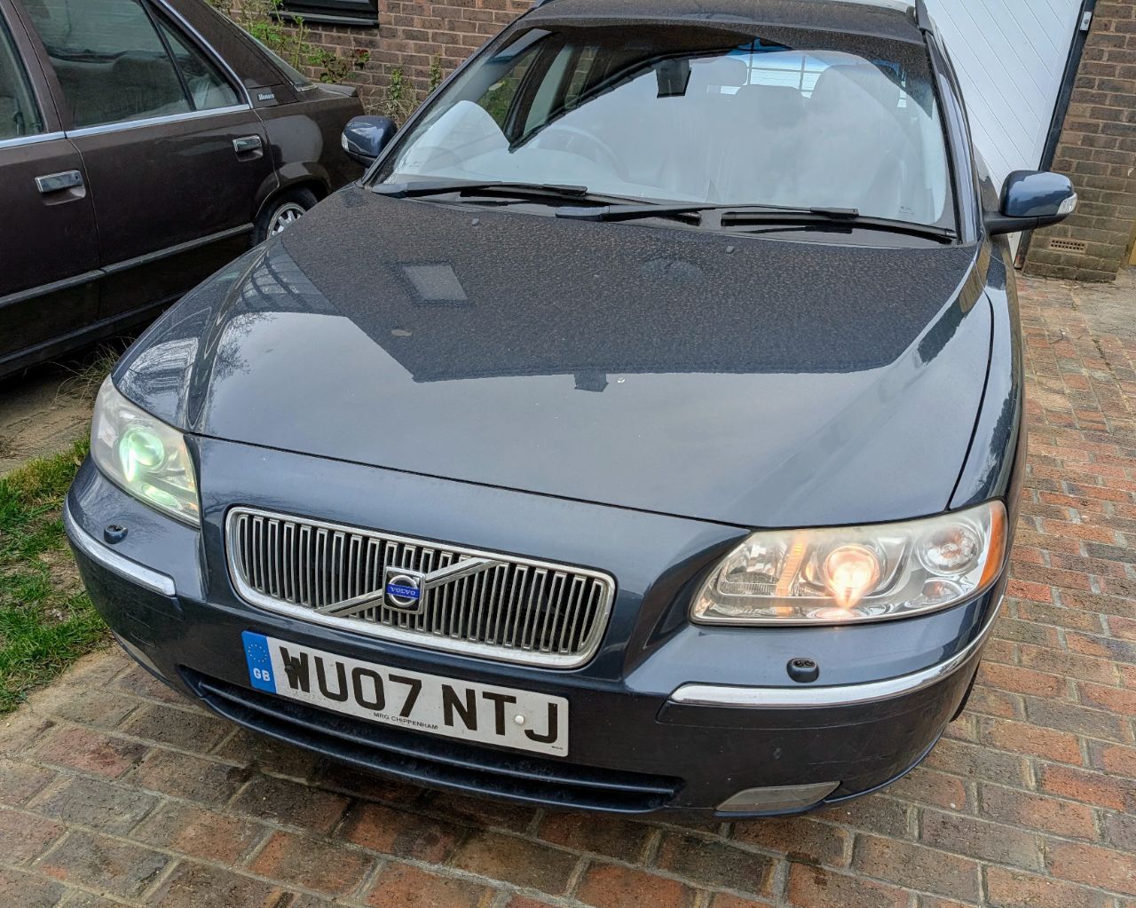

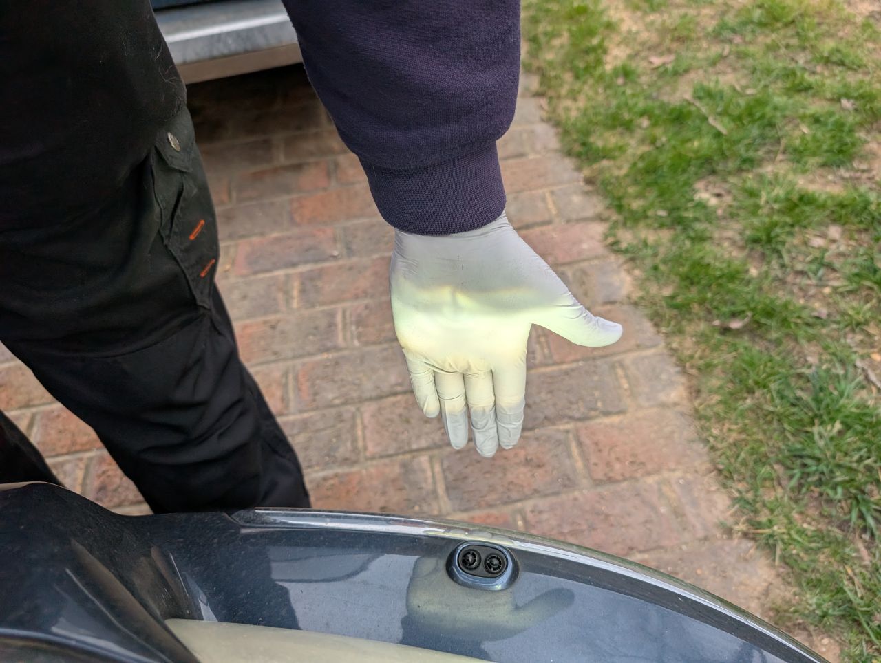

Well this isn't ideal.
Camera absolutely doesn't handle colour balance well here...offside headlight is a neutral ~4000K white.  Nearside one today has turned distinctly pink/orange tinted.  Whereas the camera has made the nearside one look normal and the offside one looks green...I gave up after fighting with the camera for about five minutes.  You're just going to have to trust me.
Good side.
Not good side.

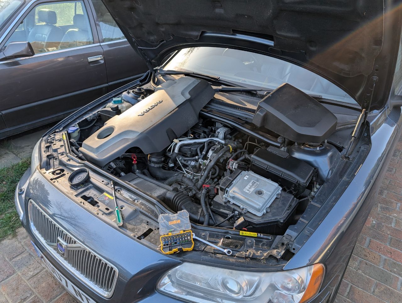

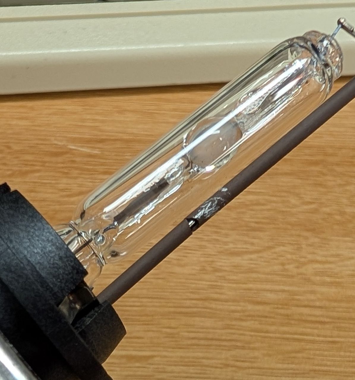

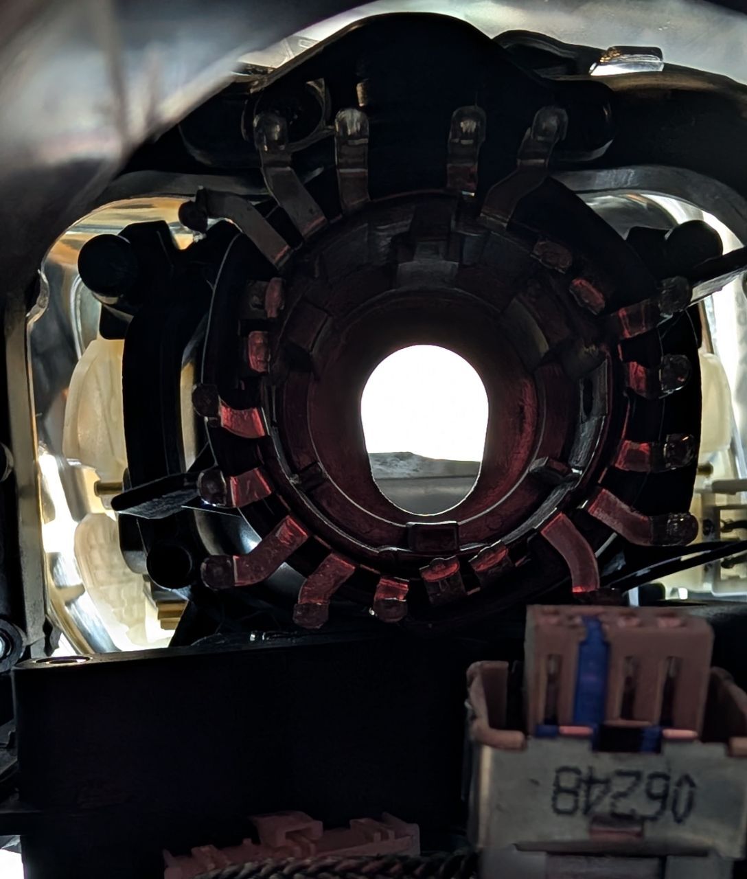

Guess it was only a matter of time before I had to mess with this nonsense.  Especially given they run whenever the car is running, because Volvo.

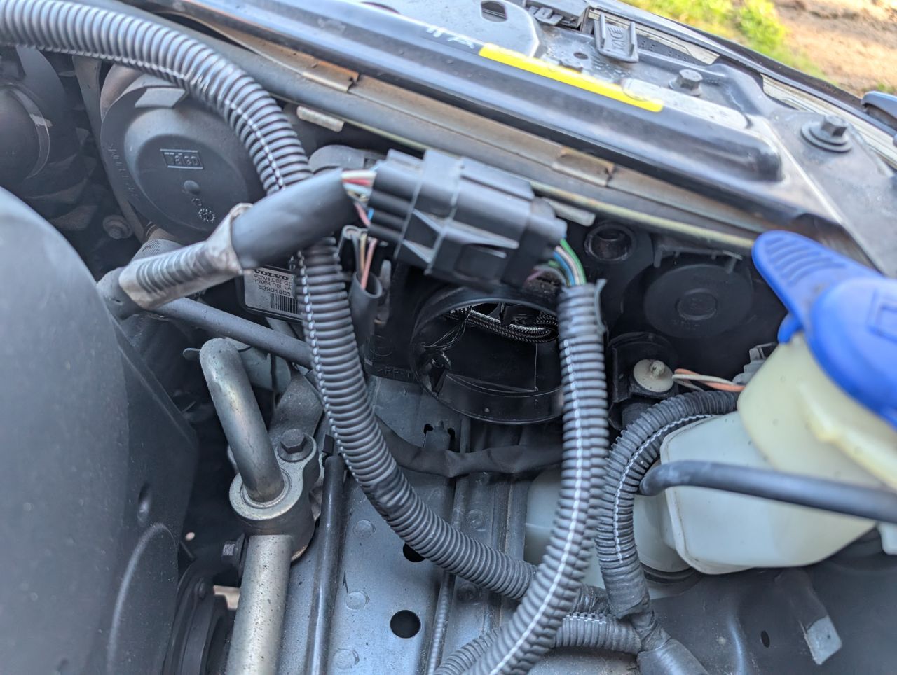

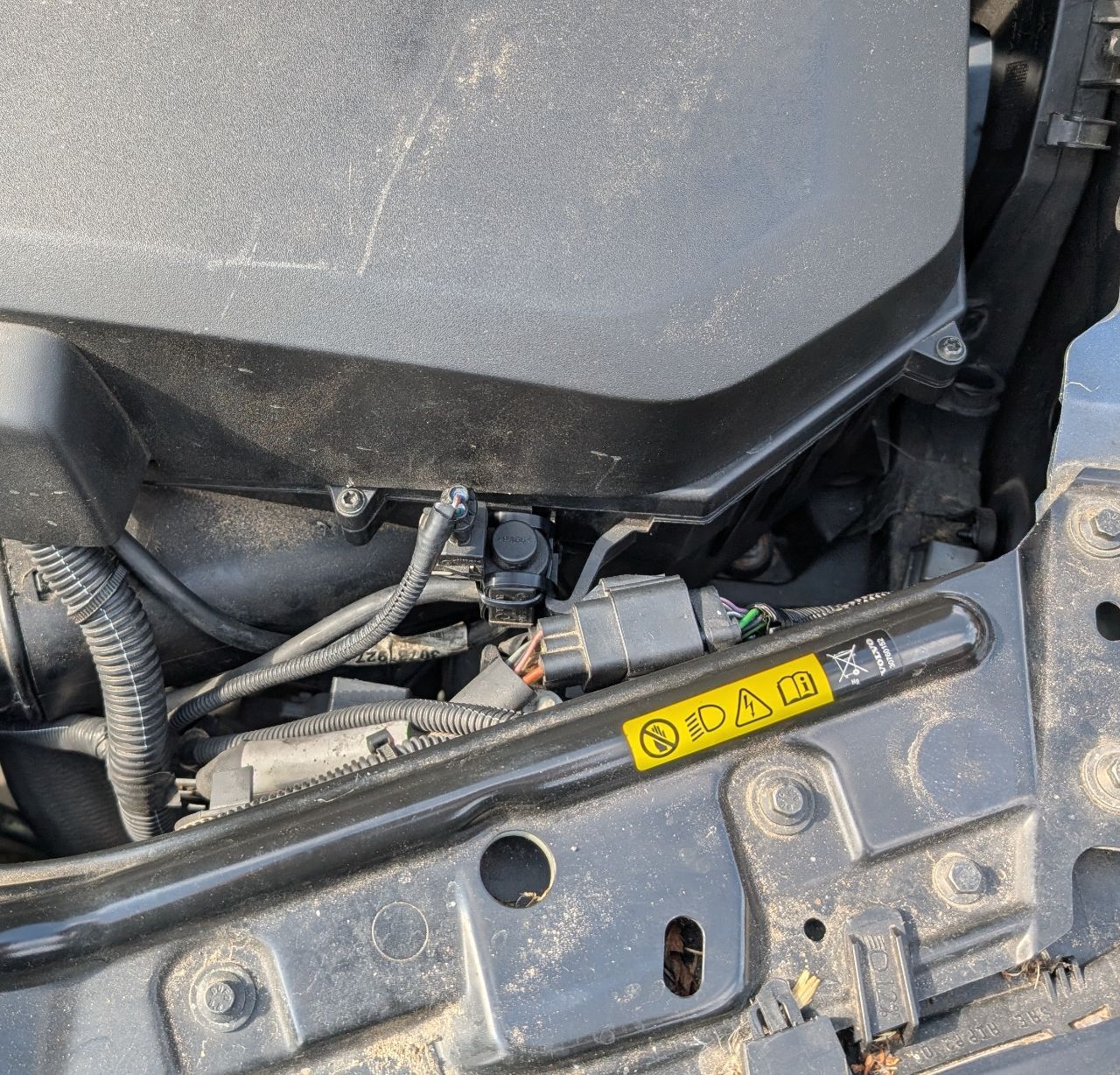

Oddly, they're not actually to hard to get to - though the air box/ECU on the nearside is precisely close enough to just make it really ANNOYING.

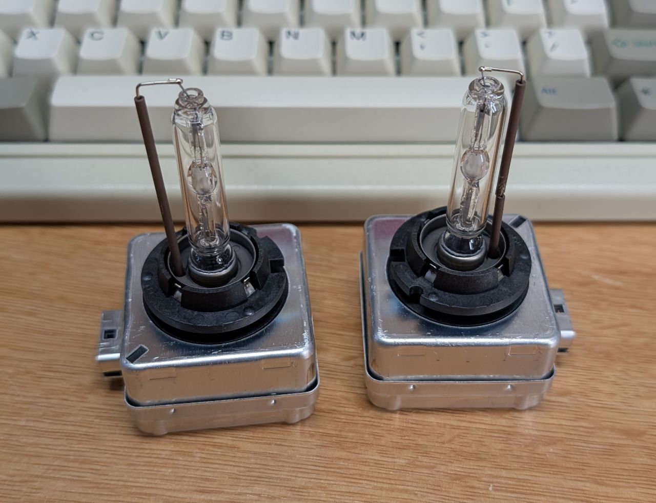

2006 date codes on these, so they are entirely likely original to the car, in which case they've definitely done their time.
I'd been pondering changing them anyway on ages grounds as the headlights really didn't seem as bright as I'd have expected - I've only driven the car a few times in full darkness, and had expected better so I reckoned the lamps had aged a fair bit.
Pretty sure I didn't cause this damage when removing the lamp, which makes me wonder how long this has been like this.
New pair hopefully here tomorrow - and I'll find out precisely how much MORE in the way the air box is when trying to get the locking collar of the nearside one back into place.  Given the general decline in quality of HID lamps over the last 10-15 years with the march towards everything being LED, I find myself doubtful that the replacements will last anywhere near as well as the originals have.

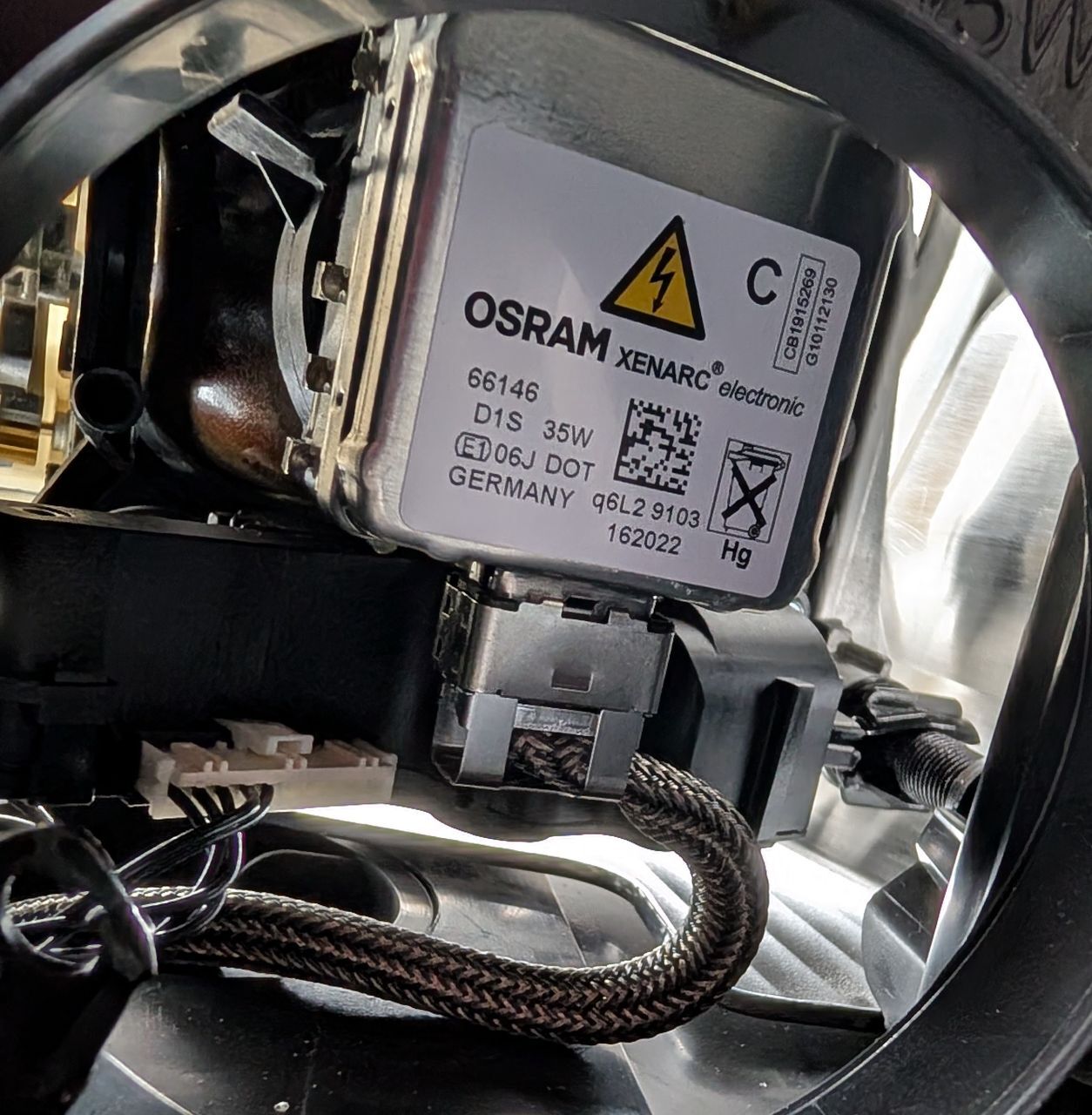

Replacements arrived today.  Shown here during the standard customs inspection.
Failed inspection on account of being too boring and not edible.  Better put them in the car then if they're not allowed in the house!
Shiny.

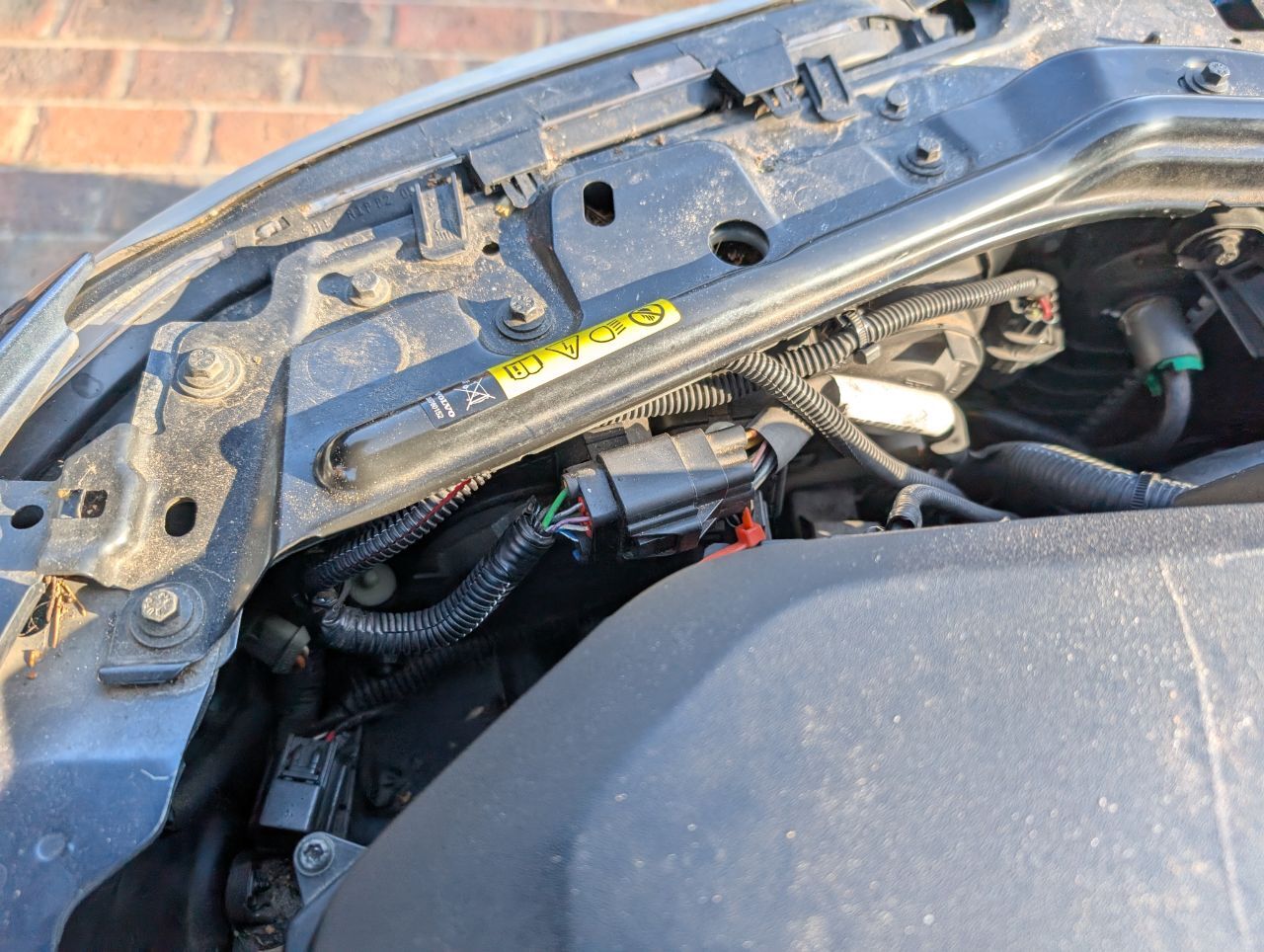

The driver's side is really easy.  You can clearly see where the access cover is off below.
Passenger side, not so much.
Of course this is the one which wouldn't just slot straight in as well isn't it.

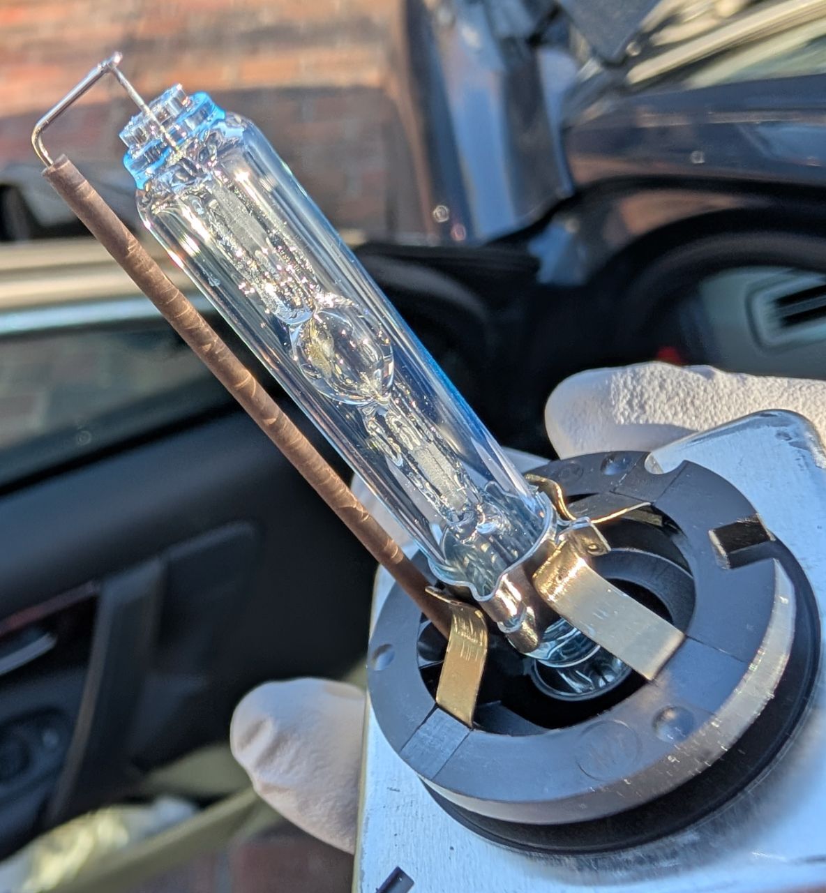

Eventually I resorted to getting a camera involved.  It turned out that two of the springy "fingers" which connect with the square ignitor housing (I assume for RFI containment) had been bent over.
Given how wicked tight the locking collar was to release on the old lamp and tell tale scratches in that area, I reckon it's been like that since square one.  With them bent down slightly it slotted straight in and the locking collar clicked into place with an entirely reasonable amount of force.
Much better.
Both lights are now the same colour.  Definitely better than they were - definitely had a distinctly greenish tint before.
Be curious to take the car out after dark to see if they're noticeably brighter - kind of hard to tell just sitting in the driveway.  Really do need to get the lenses properly polished up though as they no doubt aren't helping, and do let down the look of the car a bit.  Job done for now though.
Now just to wait a couple of weeks for the skin on my right wrist to grow back!

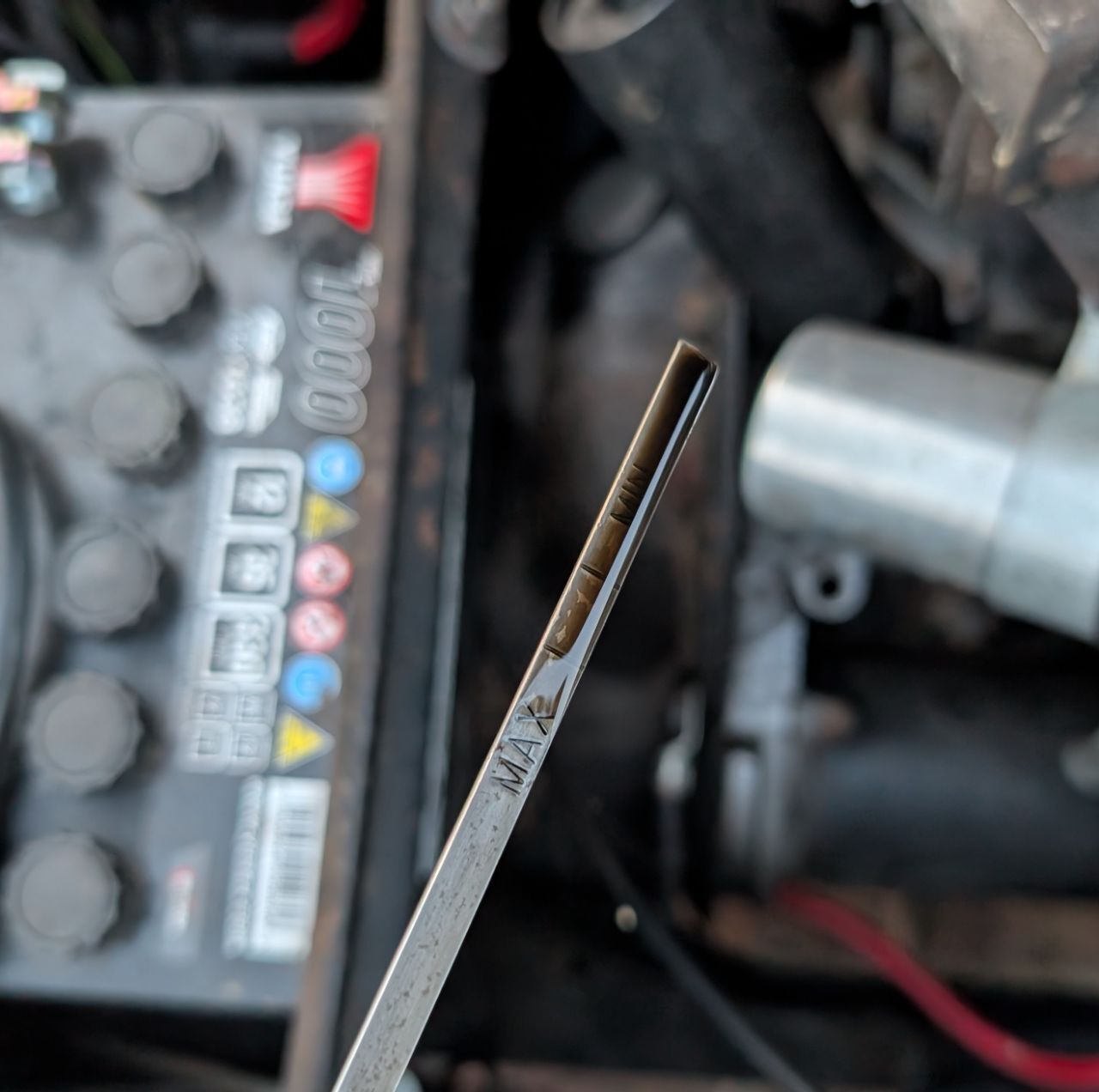

Level hasn't moved visibly on the stick since then I'm glad to report.  That's actually pretty much on the max mark when you take into account the slope of our driveway.
She definitely is still leaking a bit from the flywheel side of the engine, but it's reduced enough that it's not actually using an appreciable amount, just marking it's territory a bit when you park up.

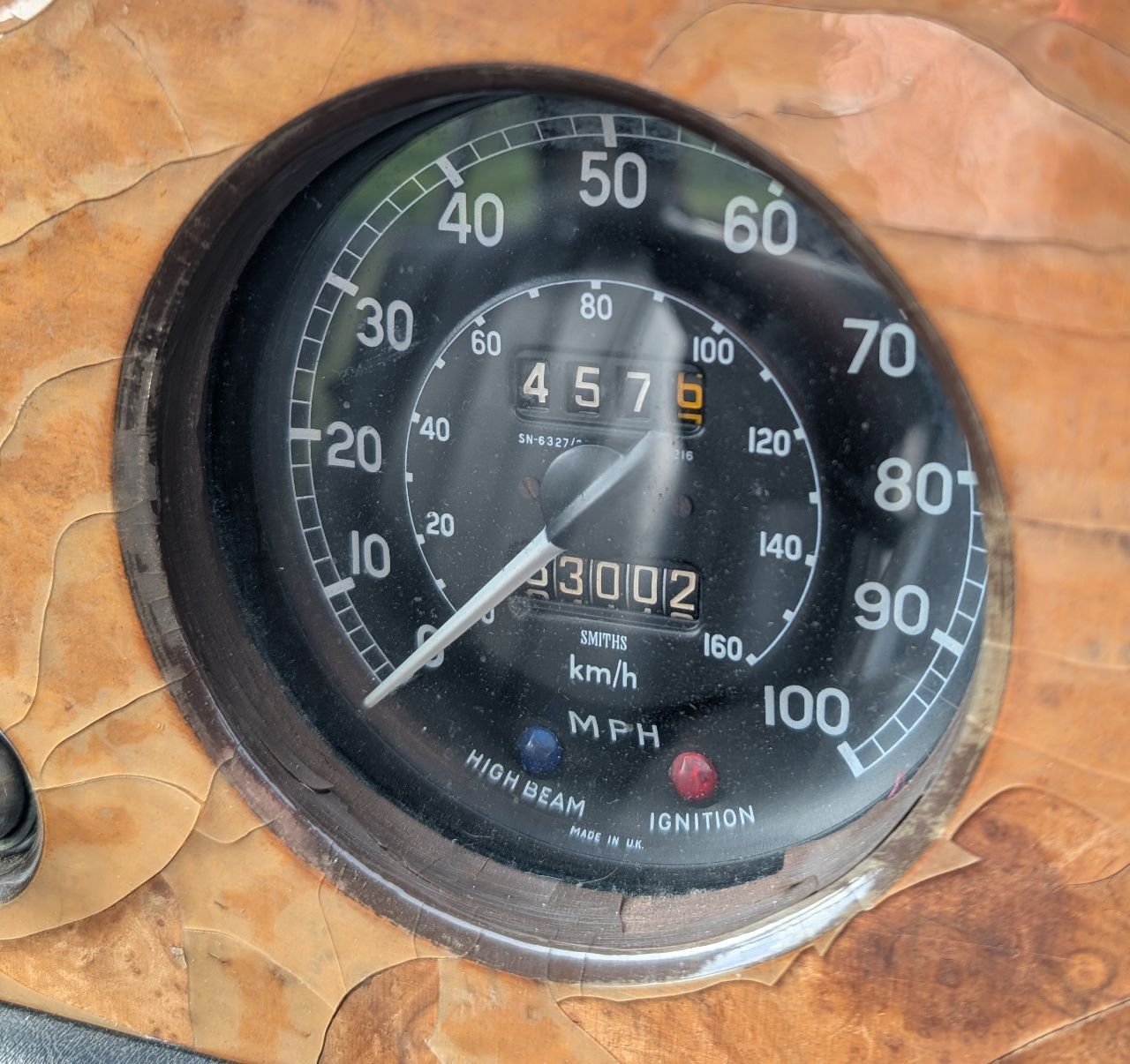

Actually just ticked over 83K on the odometer today.
I'm having to sit on my hands to not pull the speedometer out to lube up the trip/odometer gear train - that's 90% likely to be responsible for the speedometer essentially showing a +/- 20mph moving average at any moment.  I haven't looked at how much of a pain it would be to get out to work on, as I know if I do that I'll end up doing it.  Then I'll also end up trying to hunt down all the rattles and buzzes behind the dash, and that way lays madness.

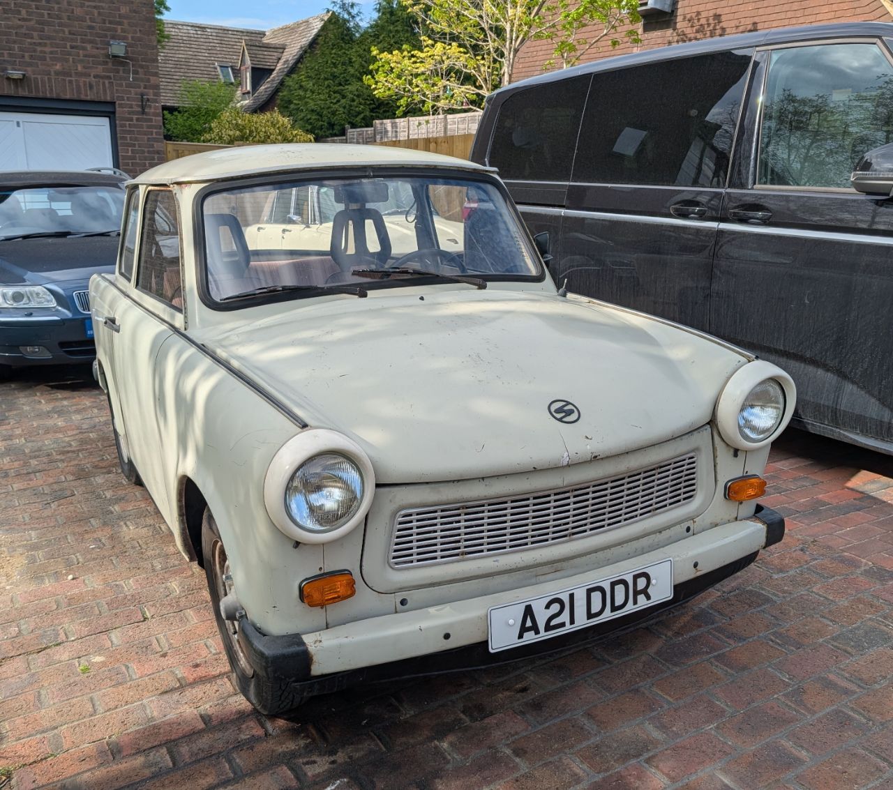

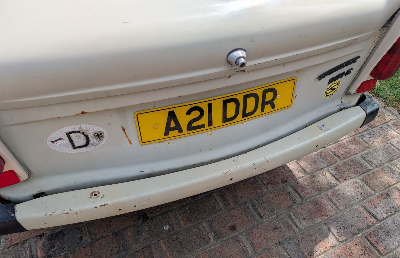

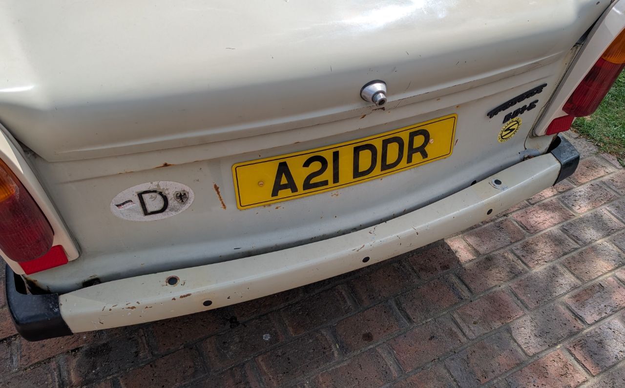

After a couple of weeks away with @Andyrew the Trabant returned home today.  While I have very much enjoyed wafting around in the VP over the last couple of weeks I'm happy to have this buzz box back.
Will definitely miss the VP - though I do need to do a bit of clean up where I first parked it before we'd addressed the oil leak!

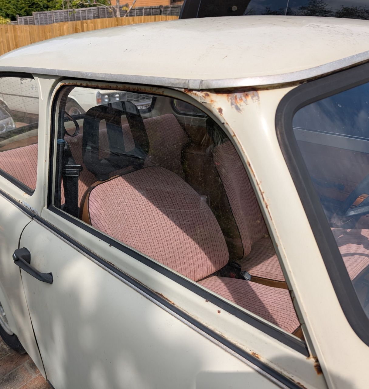

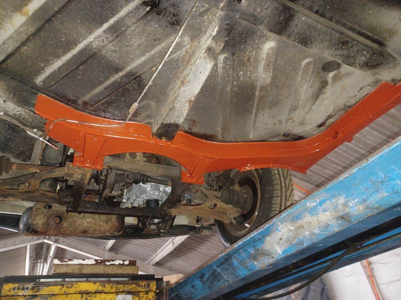

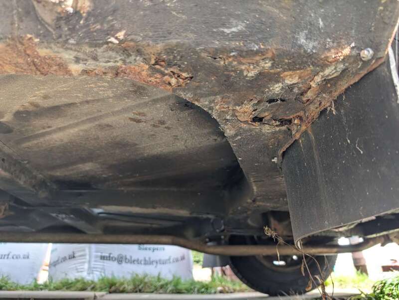

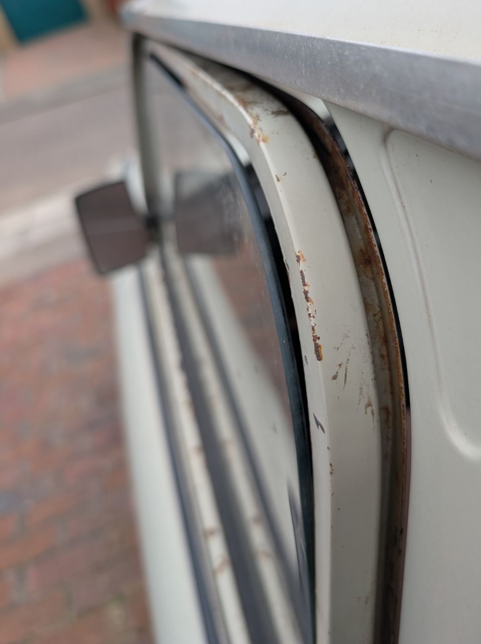

The time away for the Trabant had been to investigate and deal with this crusty bit of the offside sill just behind the front wheel.
As we all know what you can see is always just the tip of the iceberg, and this turned out to be no different.  A fair chunk of the bottom of that sill turned out to be rotten, and further grot was found in the front crossmember.  Repair work here shown just before it was painted over with underbody sealant, allowing you to both see quite how much metal was replaced - and the quality of the workmanship.
20250412_181850.jpg.062f01e0a132e2b874d167eb4101db4c.jpg.2935dba3428078e992982c98c69db32d.jpg
Some lovely fabrication work and welding there.
There are a few other areas which will want further attention in the future, but all well clear of prescribed areas and nothing that I'm imminently concerned about.  However I knew this was seriously important structurally (especially given that basically the whole front of the car hangs off those two big mounting points to the cross member) so needed sorting sooner than later.  Just a shame that nobody aside from me and my usual MOT tester will ever see the work done here!

Something that did get noticed shortly after I did the engine swap was a crack in the front exhaust pipe just after the heat exchanger/expansion box.
While this has been sleeved to help hold it together structurally in the meantime it needs changing.  It was looked at while the car was on the ramp and deemed to be too far gone to really do anything with - I'd seen how paper thin it is around that joint so that was fully expected.
I did speak to a couple of places locally about having a system made up in stainless but they really weren't interested.  I did consider just buying the middle section that's gone as the rest of the system does still have at least a bit of life left in it yet - but instead just pushed the button on a new 38mm system.  Which should help get the most out of the better carb and overbore on the engine itself.  I also don't like pissing about with exhaust systems so don't want to be replacing one pipe now and having another bit go six months or a year down the line - hopefully this will be something that won't need to be touched for a good few years once it's all on there.  Given we've got a fair few uprated parts on there, it just seems a bit silly not to add the last bit to get the most out of it as well.  38mm doesn't *sound* like a big exhaust bore - but the stock one is 35mm...This is a really small engine!  Should make a noticeable difference at the top end I expect - apparently the baffling arrangement in the heat exhanger/expansion box up front is quite different to the stock one as well so flows considerably better.

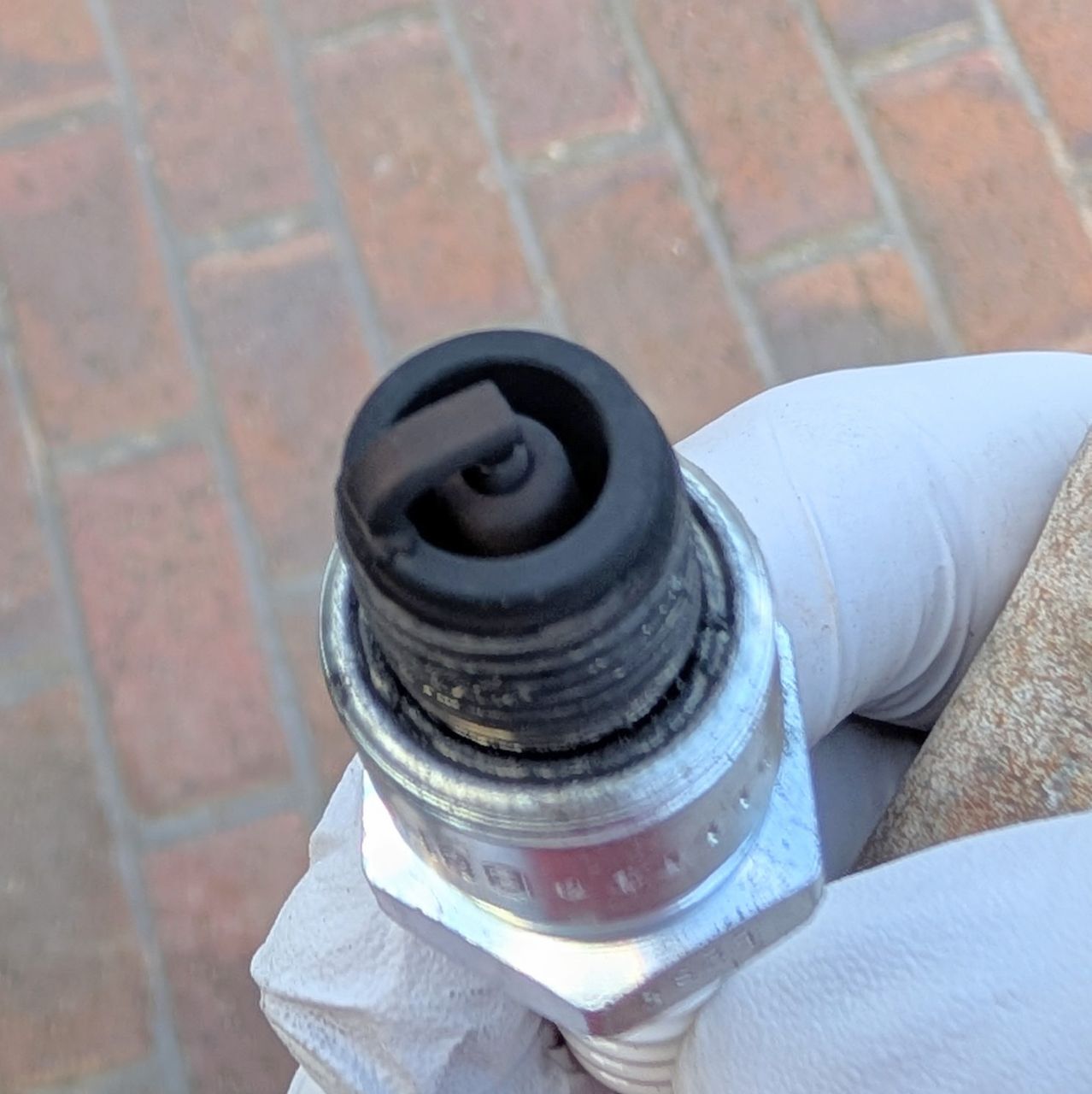

I did check the plugs when I got back today - and it looks like I am now running a little too rich I think.  Camera has made this look a little darker than it really is.
Which is good - I was aiming to go a bit too far that way then back off a notch on the slide setting in the carb to find what's probably the safest setting for the engine.  With two strokes being what they are I'd always rather err on the side of rich than lean.  A fouled plug is far easier to deal with than a melted piston.

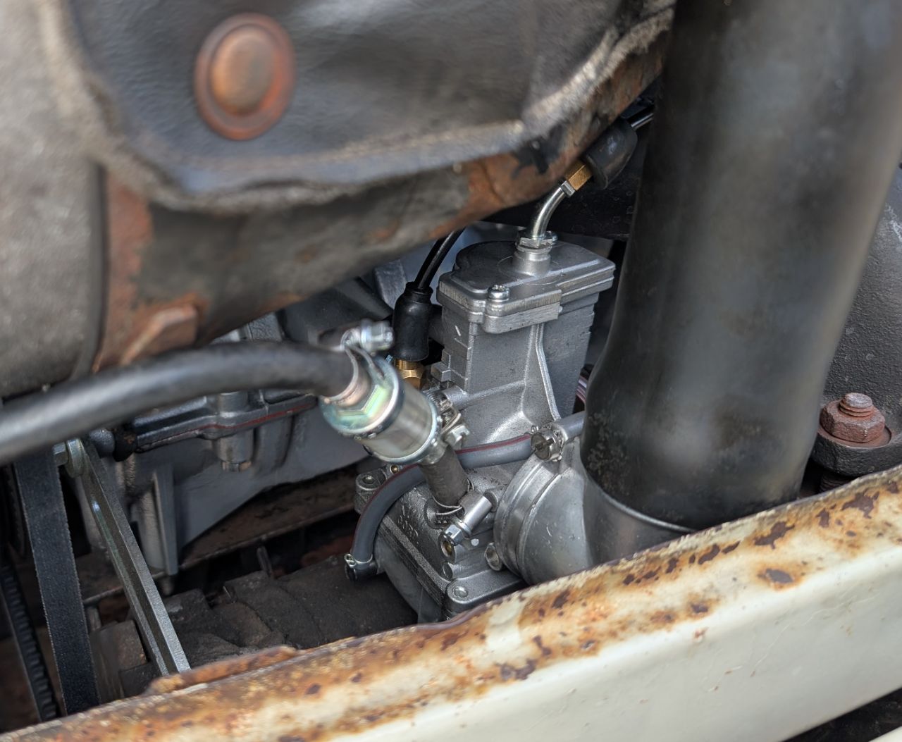

Had planned to go tweak the carb on the Trabant today (going to knock it back one notch), but as soon as I went to get the tools out the weather laughed at me.

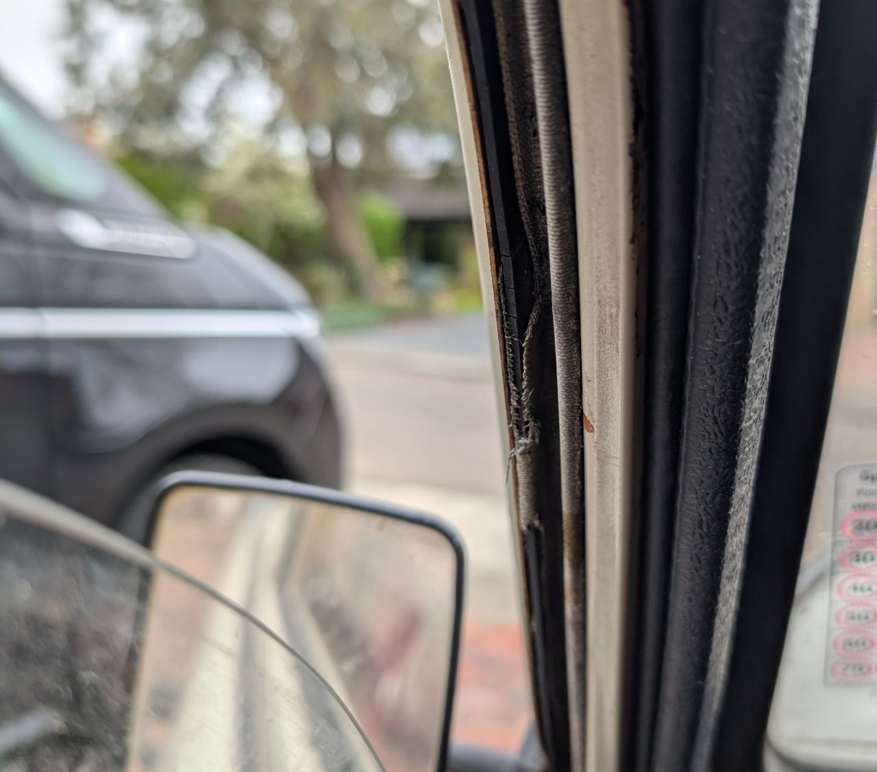

This was my chosen target.

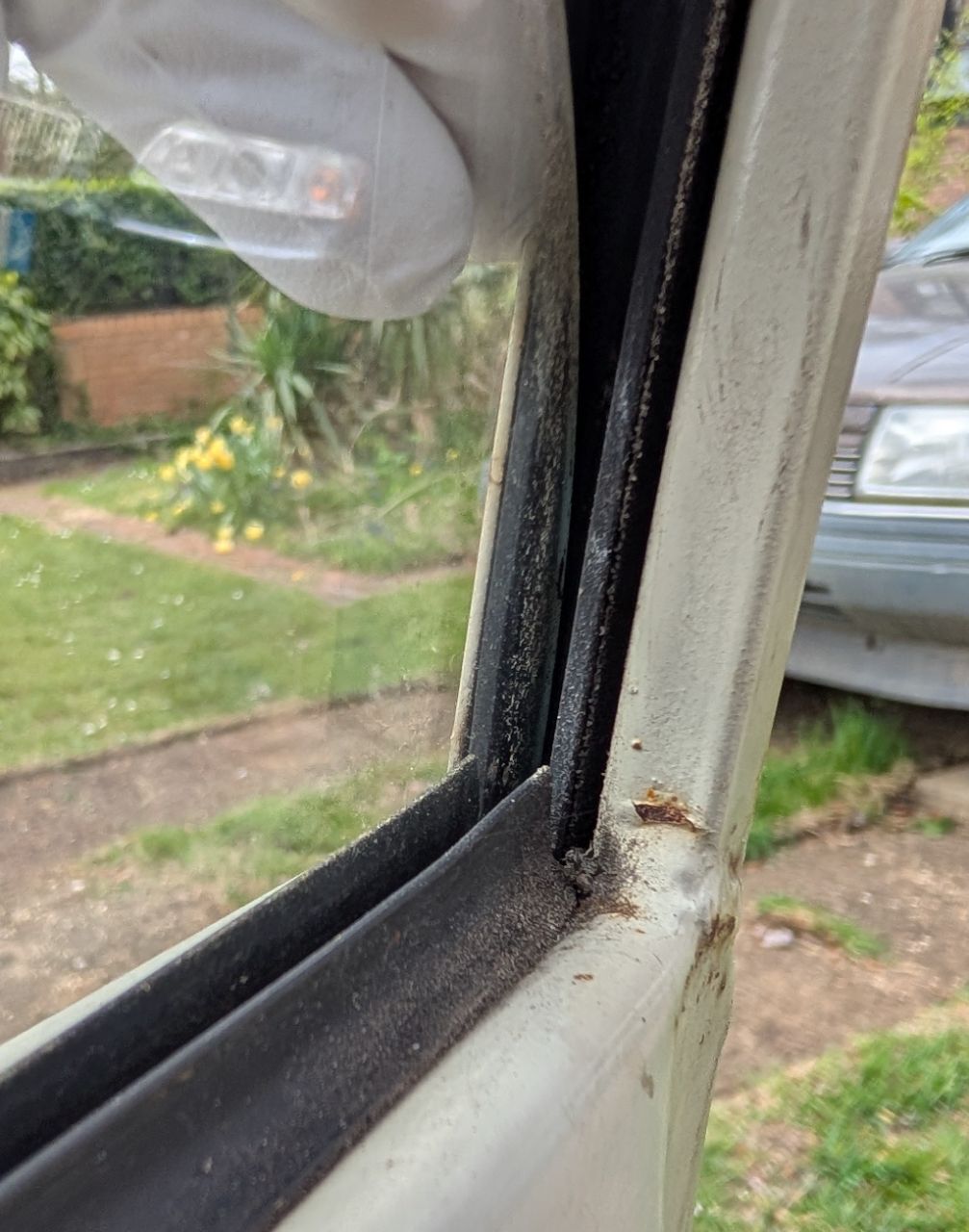

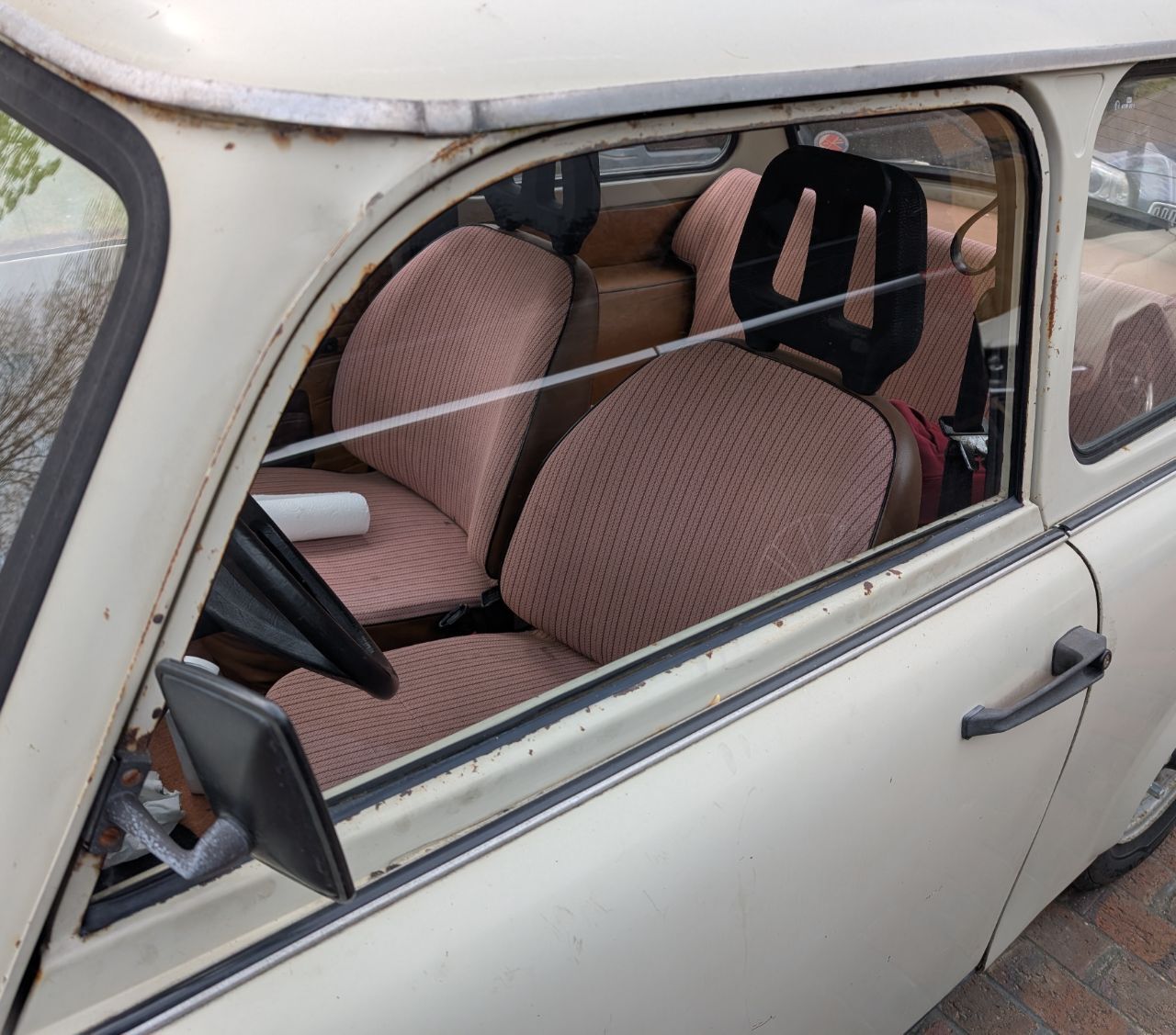

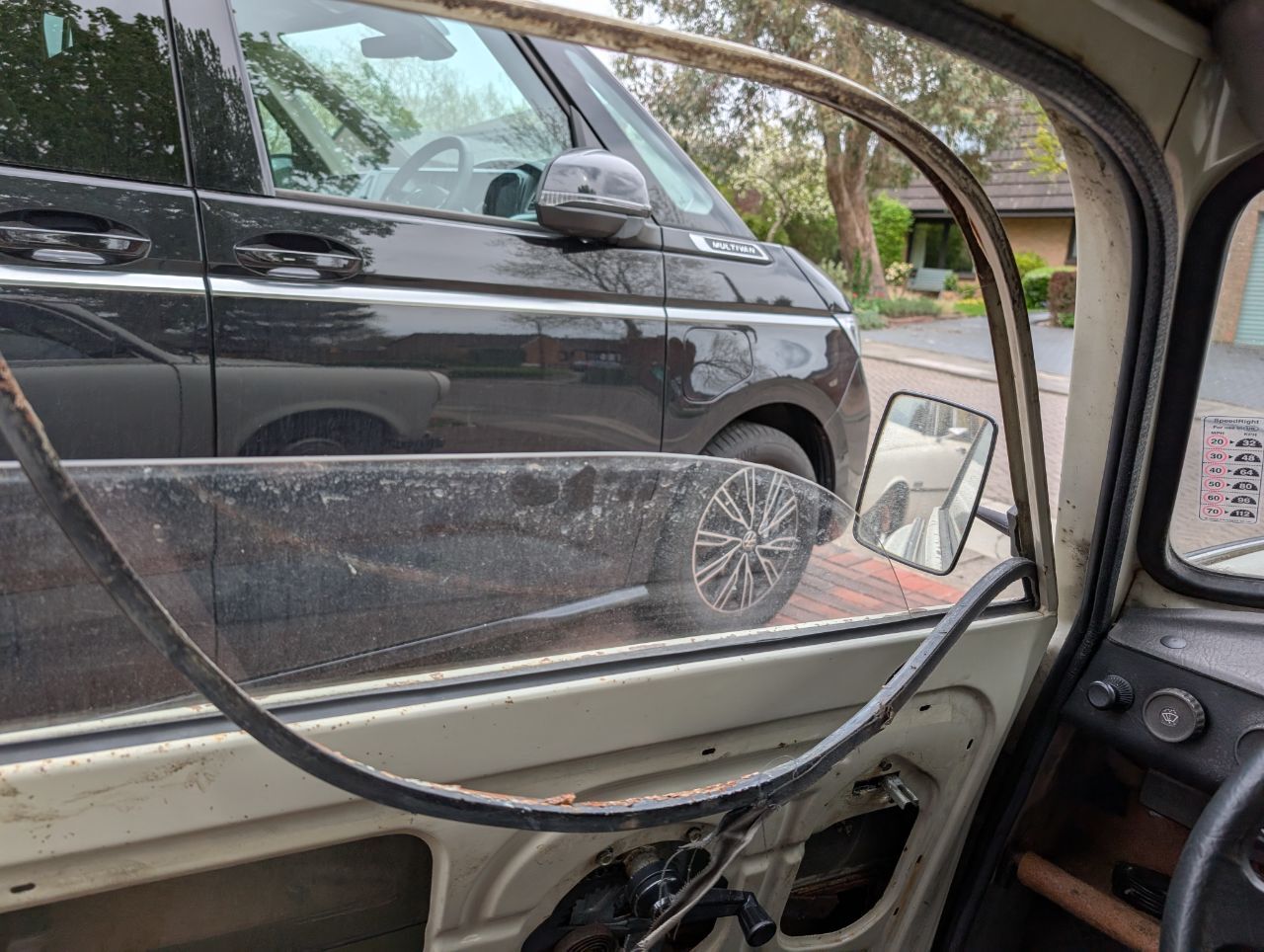

The window seals are utterly knackered.
This resulted in two issues.  One being that the glass could wobble around a bunch and it rattled incessantly.  The second was that because it could wobble around so much that while you could open the window just fine while driving, if you tried to close it in motion the glass would do this and jam.
I actually bought a full set of window seals only a week or so after I got the car (this includes windscreen, rear windscreen and boot lid as well) however I've been largely ignoring them.
I'd been putting this off as every time I've changed window seals before and it's generally been an utter pig of a job.

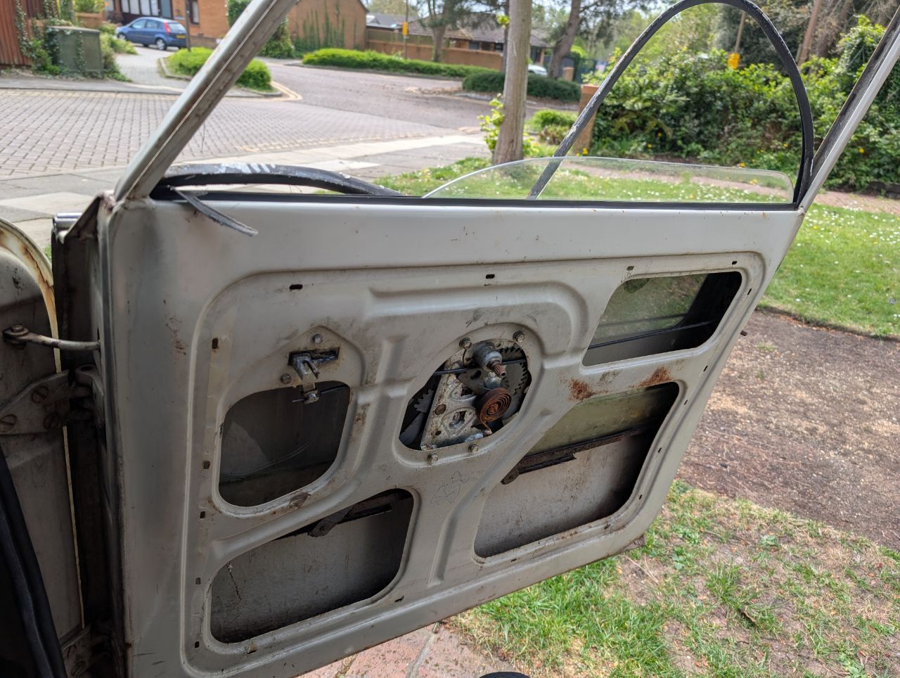

Let's get into it.
Should have known the Trabant would be different.  Can you see any difference?
Time spent: About 30 minutes.  Tools required: One flat blade screwdriver.
That's basically only needed to dig the old seal out and to help push in the new wipers into the groove they live in.  I've only done the outside wiper so far as I want to attack the top of the inside of the door top with some cutting paste to try to remove some of the black grime from there and I know it will end up all over that, so doing it AFTER that cleaning makes more sense.  The actual window seal just slides into the channel and follows it around.  No need to remove the window glass, pull the door apart of anything.  I didn't even really need to pull the door card off (which also only needs a flat blade screwdriver and five minutes to remove).  I made a point of cleaning and greasing the window mech itself while I was in there though as it was a good opportunity to do it.  Also hoovered all the usual crud that was in the bottom of the door out.
The difference when closing the door is ridiculously obvious, it really shuts with a solid thump now rather than rattling.  It's a minor thing but not having the door continually rattling right in my ear will be a big quality of life improvement.
Also noticed that the passenger side wiper arm was closed to making a bid for freedom - the grub screw was loose, so that's been tightened up.  Will get the passenger door window done tomorrow.
It will be strange driving the car without the doors rattling so much.  The interior itself is actually surprisingly rattle free to be totally honest so it will make a lot of difference.  Replacing the broken clip on the ashtray will get shot of the next most obvious one.

Okay, first up.  Here's where I had the metering needle on the carb set.
Judging from the plugs this was running a bit too rich so I've knocked it back by one notch.
I'll read the plugs again after a few miles.
Definitely a good thing this carb isn't any bigger!

Passenger door was attacked like the driver's one yesterday.  You can see here how slack the glass was in the old seals.
Everything was pulled apart as yesterday.
New ones fitted.
The wiper seals at the base of the window on this side are in good shape so I left them alone.

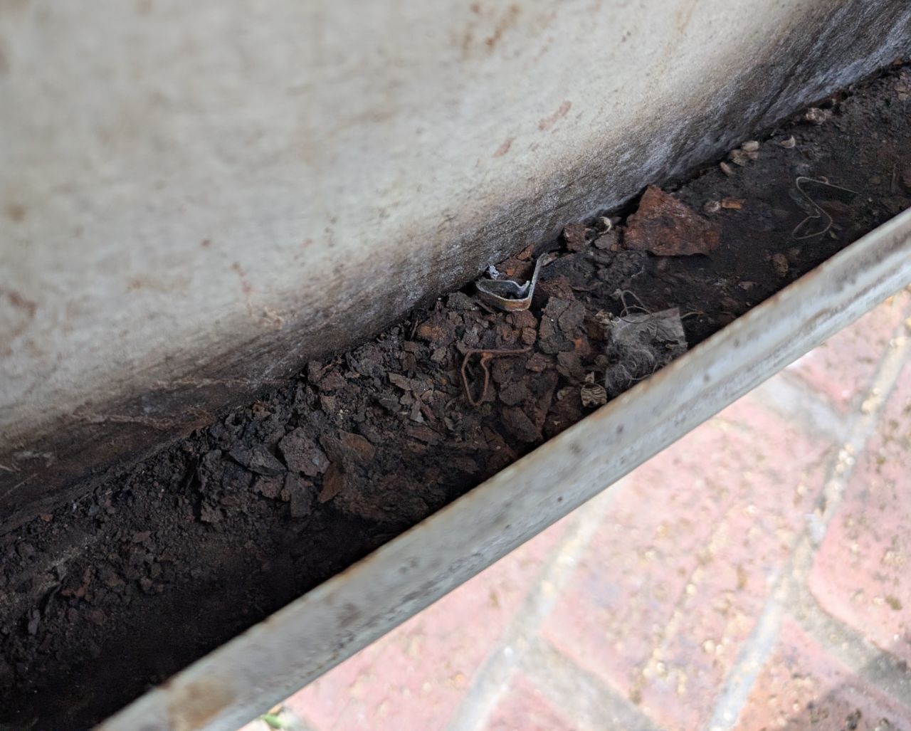

I also took the opportunity to hoover all the detritus out of the bottom of the door.

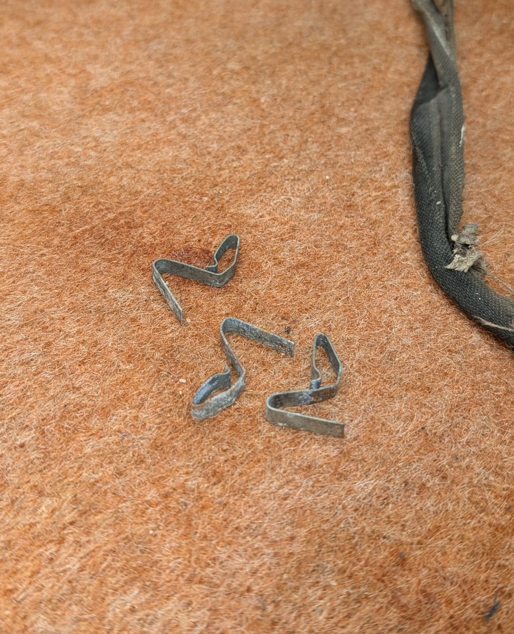

Which somewhat surprisingly included three usable trim clips.

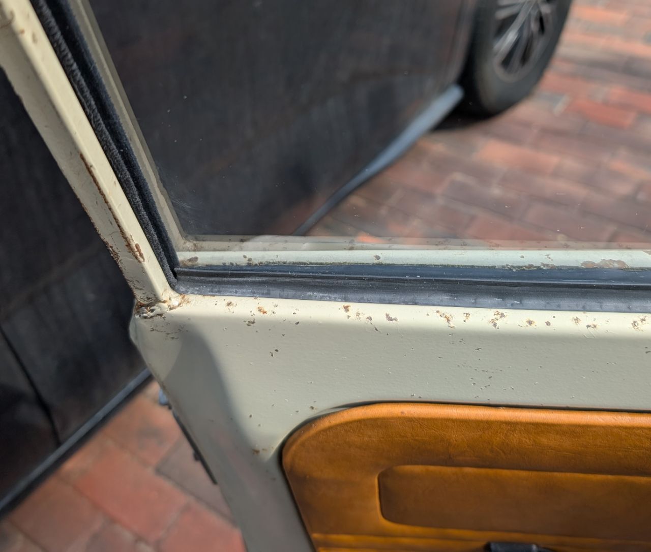

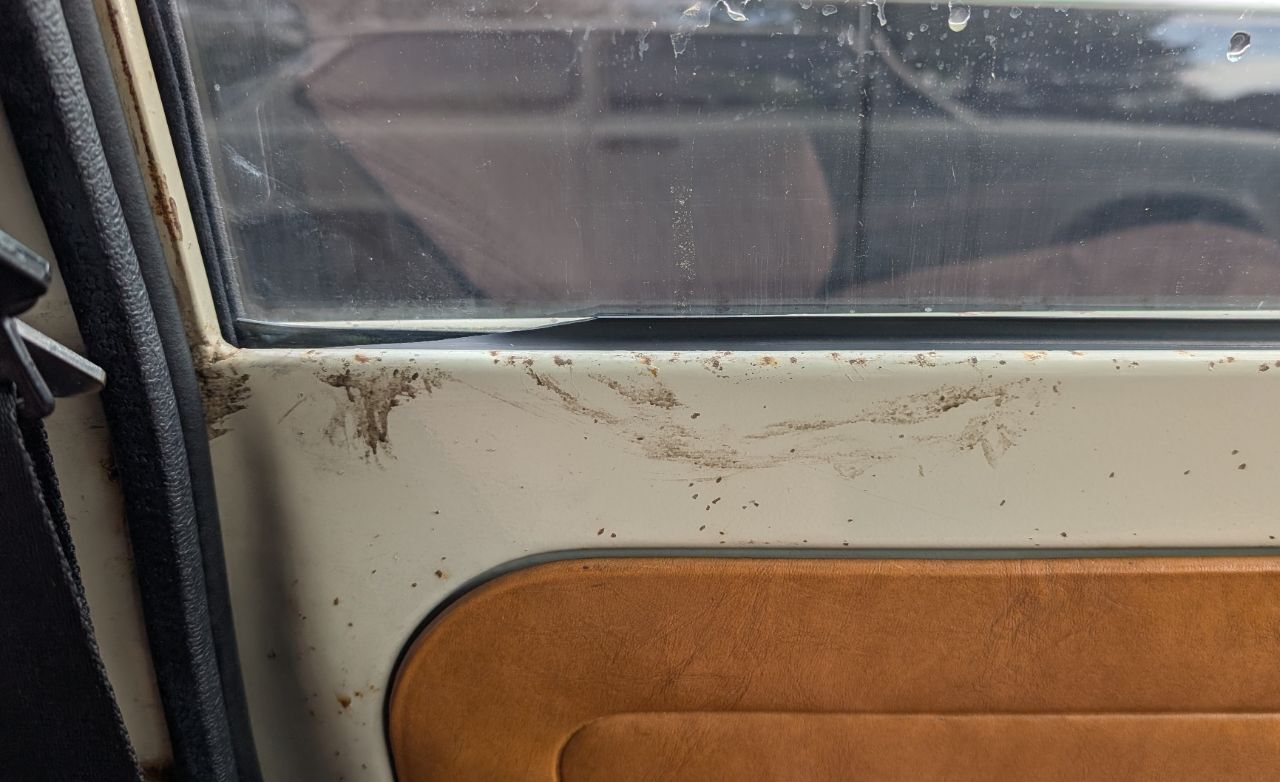

There has been a horrible smear of paint or something on the top of the inside of the driver's door since I got the car.
This has defied all efforts to remove it with normal cleaning products, so today I hit it with some cutting paste to see if that would do anything - it finally did but took a fair bit of scrubbing.

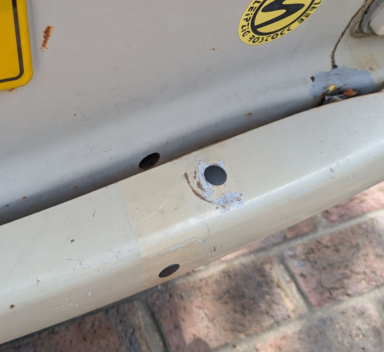

Minor details seem to be the order of the day this weekend.  Like the holes in the bumpers which originally held additional lights or something like that.
Much tidier.
Same on the front.
Oh, and finally wiped that oily handprint off the front panel and bonnet.
There's a local car meet on tomorrow afternoon here which I'll probably head over to.
Oh - and for everyone whose teeth were itching because of that red cable tie on the Volvo - here you go.
I've been meaning to sort that for the last six months!

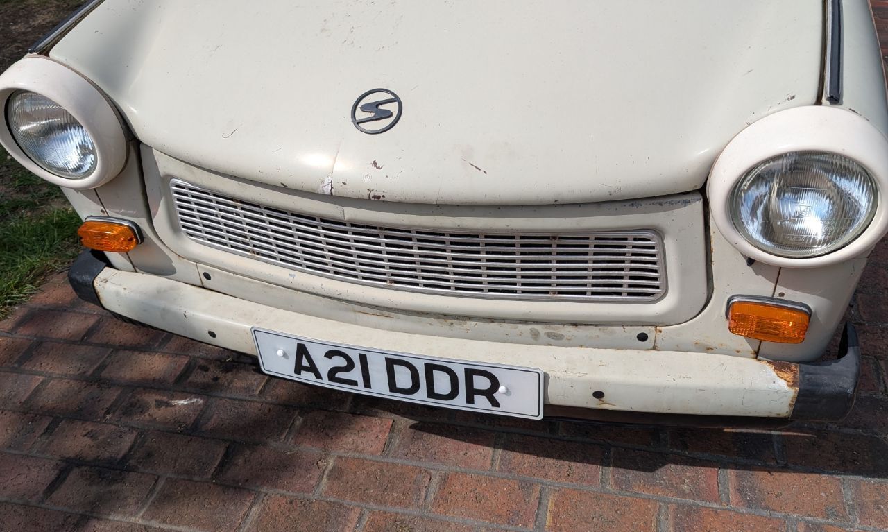

Holes may well have been for fog/reverse lamps, yours should have a fog lamp being post 1980?
There has been a rear fog on the car at some point - but it was very much not factory fit.  Just the wire and switch taped into the dash was left of it when I got the car.
I will probably fit a reversing light at some point as the lack of that does sometimes become a challenge in busy car parks.  Fog light I'm not so bothered about to be honest.
You may not be bothered about a fog light to the rear (or high intensity rear light) but the car being post 1980 it is both a legal requirement and an MOT failure point.
Noted.  Guess I'll get one refitted then.  I do have a period correct one in the box of bits.
It's common with Japanese import MX5 to have one fitted but pushed up discretely out of the way in use.
