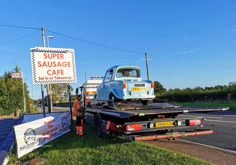

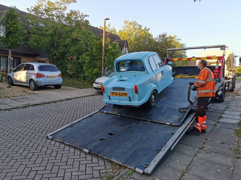

Hey look, a recovery truck...
Brief (seriously, like fifteen minutes) truck ride later...
We're home.

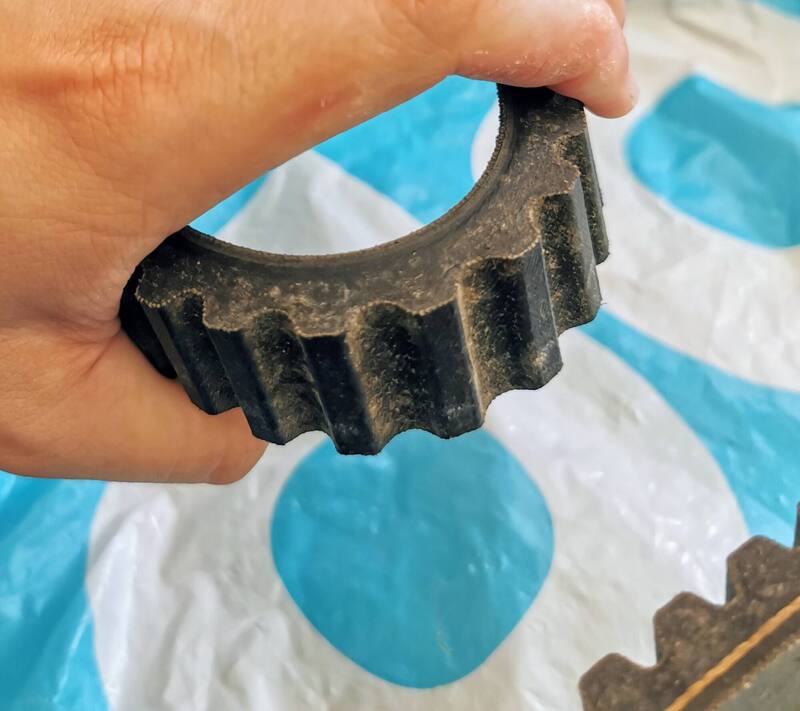

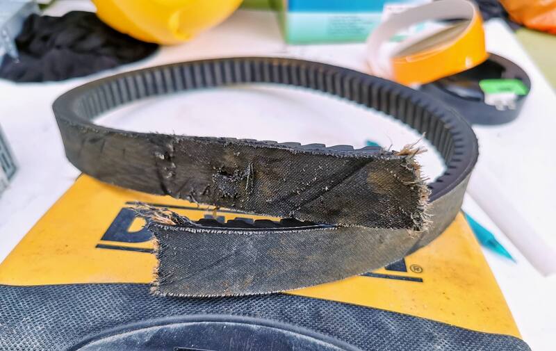

Looking at the remains of the belt I'm sticking with my original theory of just a knackered old belt that decided that it had had enough.
No sign of any damage other than the clean break at the one point (the gouges are just where it was sitting against the still rotating secondary pulley I think).

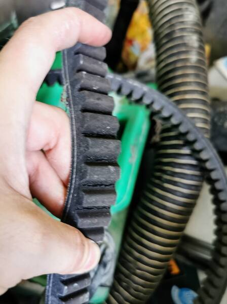

Taking a closer look shows this to be in waaaaaaaaay better shape than any of the belts I got with KPL.
Should be able to make a start on getting that installed shortly.
Changing the CVT belt on an Invacar is pretty simple.  I think the manual says you're meant to remove one of the pulleys, but if you back the tensioner all the way off there's just enough slack to walk the belt on without removing things.

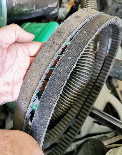

Now having a good new belt on hand to compare to I'm able to confirm that both of these are only really fit for the bin.
Aside from being as perished as the one which just went pop they're obviously used and well worn.  The new belt is 1 1/4" wide, whereas these have both worn down quite considerably, the widest is barely an inch.
The better of the two can stay on as a "limp home backup" but that's the closest to actual service it will get.

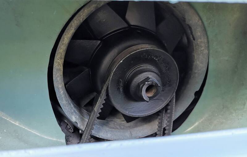

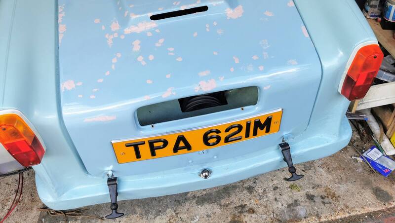

The new belt seems to be working well.  The only issue to surface was the cooling fan air intake grill making another bid for freedom.
This is the third or fourth time it's attempted to get itself sucked into the fan.  So I'll be making some improvements to the usual attachment methods... usually it is retained simply by four screws hooked through the mesh.  Think some suitably large washers and a few bolts will do a better job.

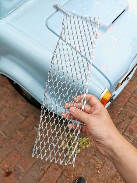

So yesterday we had one small issue in that the grill on the engine cooling air intake fell off.
Given that's the only thing stopping people from sticking their fingers in here, this was something I considered sorting to be a high priority.
Originally it was held in simply by the ends of four small stubby self tapping screws poking through the mesh.
Given this is the third or fourth time it's done this I figured it was time to improve on this arrangement.
Problem solved.
I will need to go and trim one edge of the washers at some point as you can see it through the grill if you look closely in person.  At least the grill won't be going anywhere on its own again though so I don't need to worry about things getting sucked into the fan while driving.

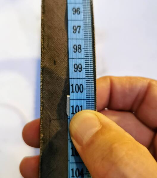

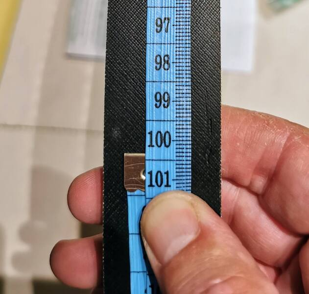

This arrived this morning.
Along with this new oil pressure switch for the Jag - which was ordered a full 24 hours before the belt.  How Rock Auto get stuff here this quickly I've no idea.
This meant that I could finally get some actual measurements relative to the original Invacar belts, which I'd been wanting to for a while.  I'd hard a few mentions of the HP2020 being slightly longer so wanted to see how how much longer it was and whether it would be possible to take up the additional slack with the tension adjustment.
First up, an original Dayco 43-5639.
So let's compare that to the HP2020.
Unless I'm seeing things, those belts look to be as close to the same length as to be identical according to this tape measure.
How about width.  I measured the new belt I fitted a couple of days ago at 1 1/4" wide. How does that compare?
So it's fractionally narrower, but not by much at all.  The wear limit width wise according to the manual is 28mm.
So not a problem it looks like.  The slightly narrower starting width means we might not get quite as much life out of the belt, though at this point we're still trying to figure out what normal belt life actually is.  To be honest if it lasts a year of normal use and is an annual service item...it's a £30 current production part.  I can deal with that.
Of course this is theory at this point...while my measurements show that the HP2020 is all but identical to the NOS Invacar CVT belts, it may well behave quite differently in the real world.  My plan at this point is to get the HP2020 installed at some point shortly so I can get some real world testing done.  It looks really promising though.

it would be interesting to measure up one of the DAYCO STY801 belts kicking around in the ol spares stash and see if those are the same, they are also a Model 70 belt, but not a part I can find in the parts catalog curiously enough, even tho STY801 is clearly a DHSS stock code, the stock code for the belt is listed as STY301 in the DHSS parts manual, which was also listed on the label of one of the belts that was still in its wrapper, should have grabbed a picture of said label as it included some supplier info
tho given how similar STY801 and STY301 is I wonder if it was some sort of typo on DAYCO's part? none of the STY numbers even remotely get close to 801, the last being STY646, which is the "passenger carrying is forbidden" plaque if your curious LOL
56 minutes ago, PhilA said:
Thought the transmission was after the belt on this?
if I understand things correctly it goes engine-centrifugal-clutch-gearbox-forward/reverse-Pulley-belt-pulley-triplex-chain-diff :)
