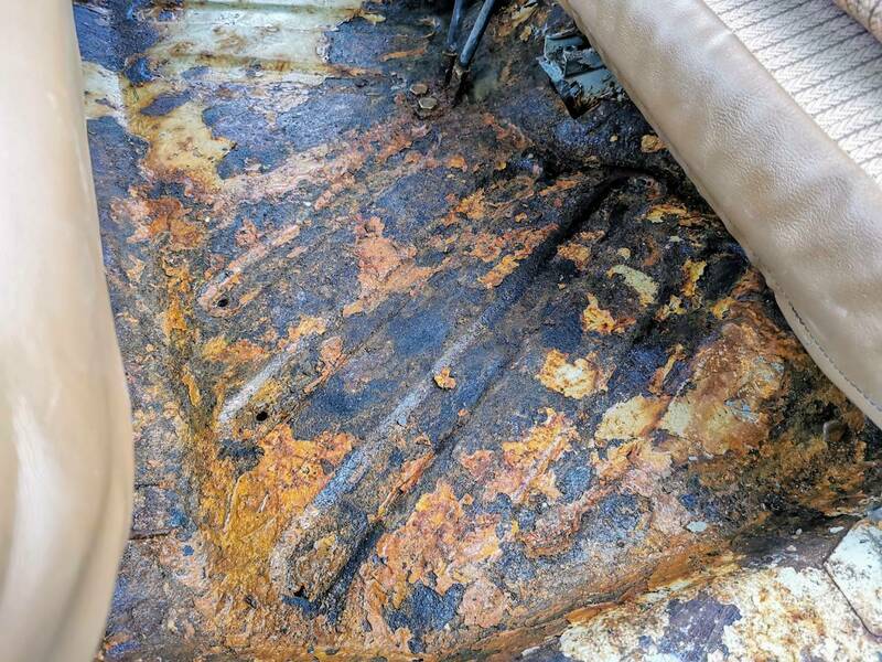

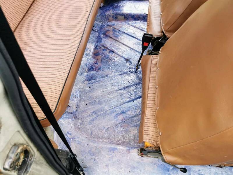

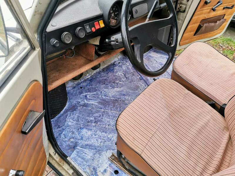

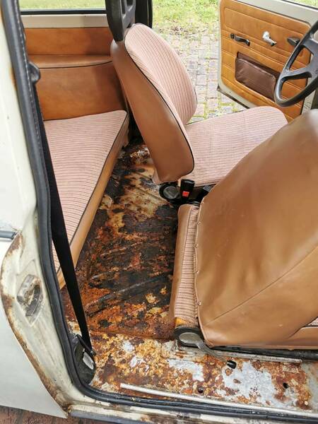

Carpets were removed again a day or two ago, and today I went after the rear cabin floor with a screwdriver and the vacuum cleaner to get rid of at least a decent chunk of the flaky paint/rust/sealant.
Will probably still go at it with a knot wheel on the grinder or at least manually with a wire brush before I drown it in Vactan.  While I'm sure the metal has been thinned in places it still seems perfectly solid.
It's hard to see in the photos, but someone has bent the floorpan on the passenger side upwards at some point in the past, presumably by jacking the car in the wrong place.
I'll have a shot at seeing if I can convince that to straighten out again before the carpets and such go back in.  Doesn't need to be perfect, but is quite impressively bowed up at the moment.

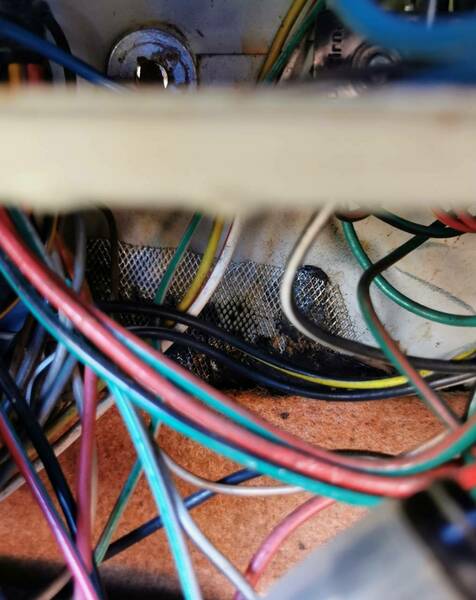

I have found quite a lot of random wires floating around already, either just flapping in the breeze or at best taped up, so I think a proper rummage around under the dash to track down any remaining spaghetti and ensuring it's removed, reinstated where it should be or safely terminated is the next step there.  I can't see anything that looks out of place under the bonnet or in the boot which would explain a short so I think a decent visual inspection under the dash is a good starting point.
A wiring diagram would be useful to help identify and random wiring, and so far has eluded me.

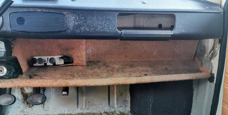

Posted (edited)

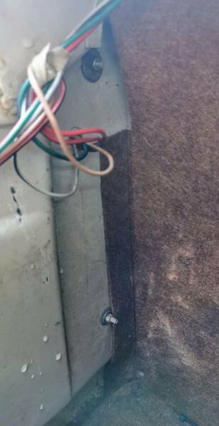

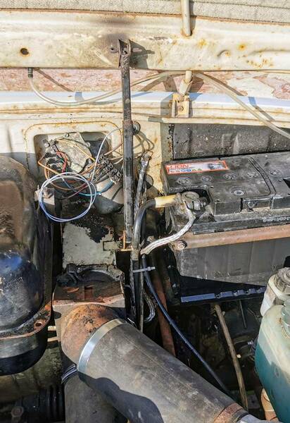

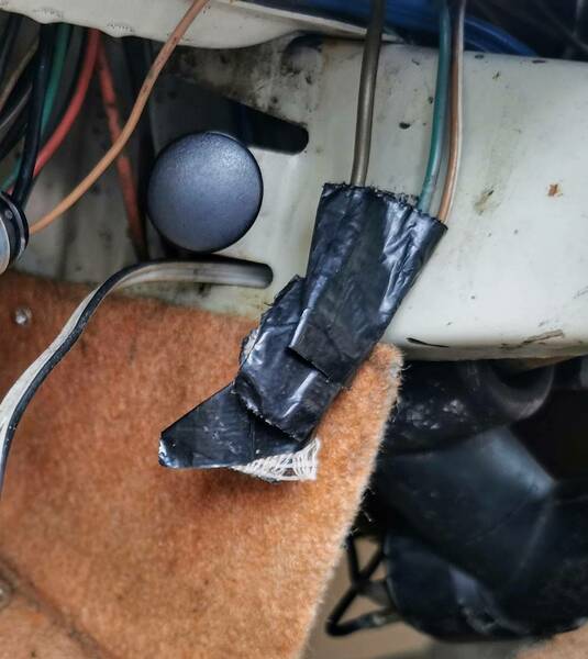

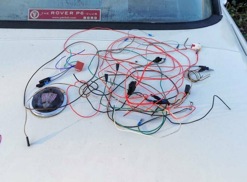

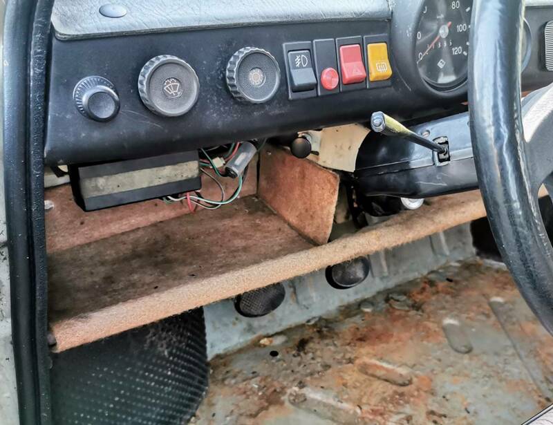

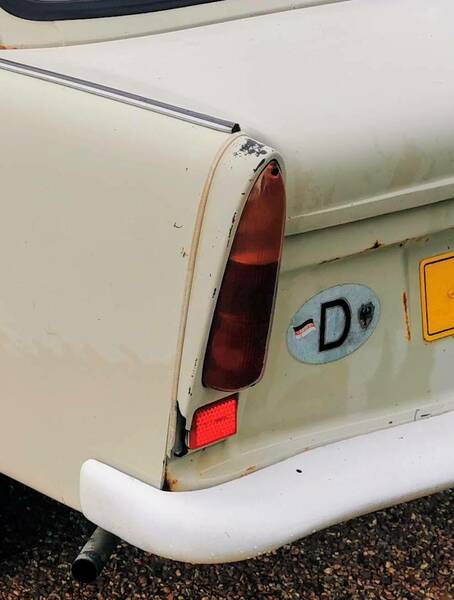

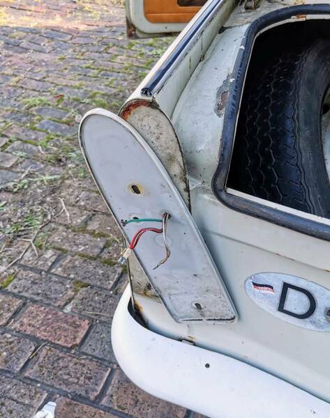

Has to be said that electrical pruning in an older car can often be quite satisfying.  This is what was evicted from under the dash in the Trabant this morning.
Including quality workmanship such as this tail that was just sitting on the dash support rail above the fuse box...note that this is the UNFUSED side of things too.

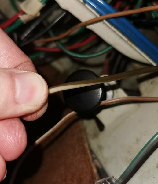

We're now down to two mystery wires rather than I think five that we started with.
One is this grey/black one which is part of the ignition switch loom.
Which a little bit of detective work found to be the feed to fuse number 5.

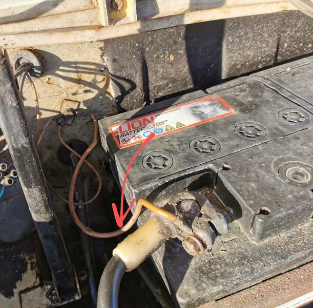

Which apparently is for the front left parking light circuit.  That wire SHOULD be connected to terminal 30A on the ignition switch though, which is closed to the battery feed (terminal 30) only when the key is in the P position.  There was also a two core white and black wire floating around connected into the indicator switch which according to the diagram should go to the headlight switch - which is what would enable the parking lights when you turned the light switch on with the indicators set to signal left.  However that's clearly been hacked about as it was nowhere near long enough to reach to where it should go.  For now I've removed that as it's not functionality I need, noted it and can reinstate it later.
A black and red wire that was floating around in the cabin was traced to a terminal on the wiper motor.  Which looks like it should actually be on terminal 54 on the wiper switch according to the wiring diagram I have.  Whatever it's meant to be doing, the wipers currently work just fine - though I can reroute that to the right location in due course.  That leaves a single brown (ground) wire on the right hand side of the dash - I just need to try to figure out what's on the opposite end of that to find out if that it's meant to be grounding actually exists.  Wouldn't surprise me if that turned out to be our missing ground that was causing the back feed between the headlight/indicator circuits.
Now onto the remaining trio on the left of the steering column.
The grey/green wire is part of the dash lighting circuit, and simply appears to be unused here.  The brown and white I have traced out as winding its way over to the loom running into the right hand headlight (on which all three filaments work) so I need to investigate that.
EDIT: The thought which does spring to mind is that some H4 headlight equipped cars had an indicator light on the dash to show if the headlights were adjusted to the fully laden height adjustment (there's a lever underneath the light unit to switch between high/low beam height), which this car doesn't have the light for on the dash. As my wiring diagram is for an older model that circuit isn't shown.
This leaves one remaining mystery wire which is the heavy one towards centre frame.  I can't quite decide if that's a solid brown or solid grey...it's a kind of browny-grey.  My gut feeling is that it's actually brown as neither of the variants of the wiring diagrams I've seen show solid grey as being used.  So is most likely another ground that's been left floating.  Shouldn't take long to confirm that with the meter.

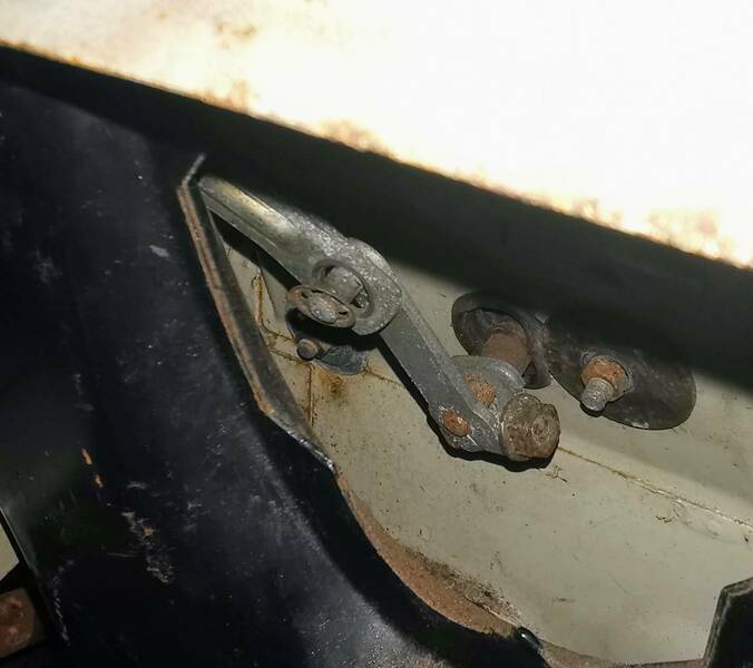

Probably the largest single time sink today was spent going over basically every millimetre of the offside indicator wiring that I could access with a microscope (okay, not literally but you get the idea).  While tracing that I had to get up close and personal with the wiper motor, especially as the wiring had all come adrift of the clips which should keep it clear of the linkage (so it was a prime suspect area for my short - no dice there sadly as that would have been too easy).  This meant that it was really clear why I had miles and miles of play in the wiper linkage.  Take a look at the photo below of where the linkage attaches to the motor and see if you can spot anything amiss.

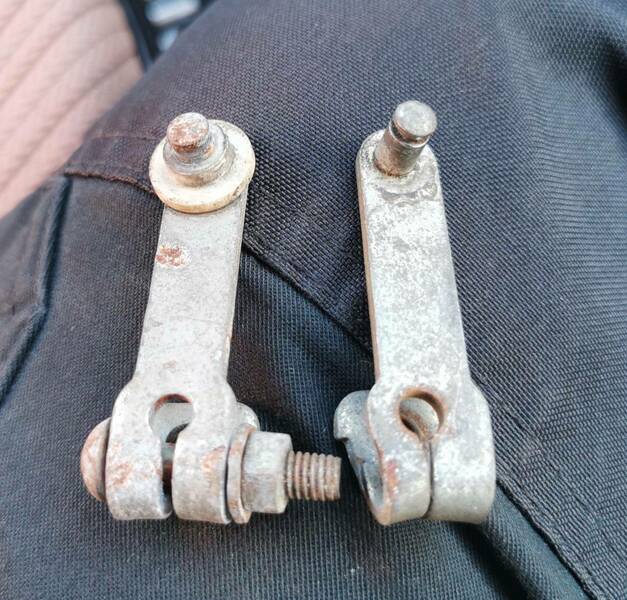

The 1/4" void which clearly should contain a bush of some description seems like a likely candidate...not to mention all of the mounting bolts being less than finger tight.
Helpfully the box of random Trabant bits did contain a little bag of assorted bits of wiper mechanism, which very quickly allowed me to find exactly what I appeared to be missing.
Motor arm off the car is on the right, one out of the spares box is on the left.
With that arm fitted, a spring washer to keep things together and the original locking washer (which was precisely as fiddly to refit through that gap as I expected) there is now a vastly, vastly reduced amount of play in the linkage and it's nearly silent rather than clanking loudly every time the wipers change direction.  I'll fine tune the wiper position on the screen somewhere down the road.  Apparently I failed to take a photo of the reassembled contraption so you'll just need to take my word for it that it did go back together.

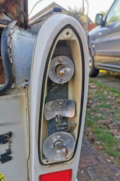

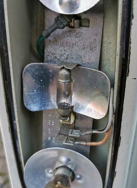

Tracking down likely sources for the intermittent short I was seeing on the offside indicator circuit was next up (having initially been sidetracked by the wiper linkage), which I spent quite a long time on.  The wiring all looked to be in good condition, and I couldn't find any traces of chafing or anything anywhere which would likely result in a short.  Inspecting the tail lights was quite a surprise...and I think shows another big difference to Lada etc where the tail light innards are about the cheapest things imaginable and are an endless source of frustration.  The reflectors could do with a clean and the brake light bulb could probably do with changing as it's a bit blackened, but otherwise this looks absolutely fine.  No reason to expect it to cause problems otherwise given how solidly built it is.
I basically spent about an hour and a half poking and prodding things with the meter, wiggling wires, connecting and disconnecting things to see if I could pin down where it was.  I never really did find a smoking gun to be honest, but after I disconnected the front light assembly the short disappeared and I wasn't able to provoke it into returning.  That's the light which I was already suspicious of as it was badly corroded internally.  My decision to swap it out was then accelerated by the positive connection breaking off.  I guess if it had bent prior to it actually snapping off that could have been causing a short...hard to say for certain.  However with the one spare I have fitted I've not been able to make that problem reappear, nor during a half hour test drive.

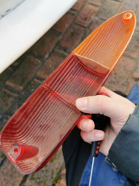

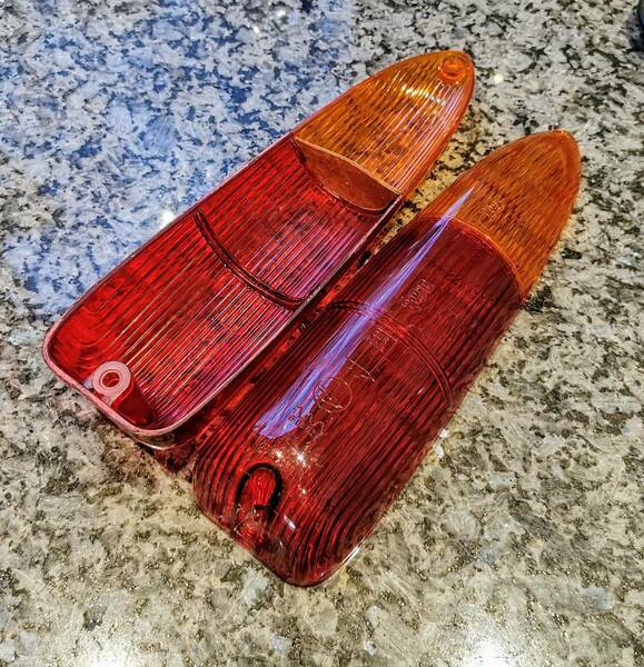

Car does look a bit silly with mis-matched indicators...but at least they're working again!
That spare is a bit crusty inside as well so they'll both be swapped out when the new ones arrive.
I did note that while the short had gone that we still had a somewhat erratic flash rate, and definite interaction between the indicator and the headlight circuit.  That to me just screamed "dodgy ground" based on prior experience.  Sure enough, when I checked the ground point in the middle of this photo, it was floating at nearly 2V when the indicator was lit.

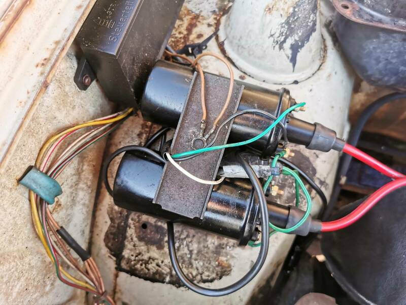

Cleaning up everything and putting it back together did away with that stray voltage, - but am still not a fan of the arrangement.  As that bolt is also holding down the coil bracket, you can't crank it down massively tightly as you'll crush the coils.  I had a hunch this probably was the location of the grounding problem given that that fault according to the previous owner only appeared after the electronic ignition was fitted.  As that grounding point is shared between the headlights, indicator and ignition circuits, it had to be prime suspect.
I'm going to drill an additional hole in that plate to mount the grounding lugs to, then run a jumper to the inner wing.  Those brown wires aren't long enough to just re-route to somewhere more sensible.  I also want to replace that horrible looking taped together mess in the coil feeds, so I'll be revisiting that probably tomorrow.
Now the indicators are exactly as bright as each other, flash at the same rate and don't interact with the headlights any more at least.
The body to battery ground strap is also getting changed tomorrow as I noted when connecting it back up today that there's evidence of it having got quite warm in a couple of places.  While I appreciate there's not a huge amount of electrical equipment on this car, it still looks a bit on the thin side to me anyway.
Cheap and easy thing to upgrade anyway and I've already got a suitable one in stock.
The pile of removed wiring as of today amounts to this much.
Which given how basic a car this is, is pretty impressive!
I'm not saying for certain that we've fixed the short given the intermittent nature of it making it hard to say for definite without having found an obvious smoking gun, however so far it's looking at least hopeful.
Definitely have deleted a bit of spaghetti in the cabin over the last couple of days.
Not having to fish my way around it when reaching for the choke and fuel valve will be a nice change.

[] Improve grounding arrangement to ignition coil bracket.

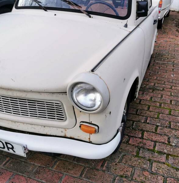

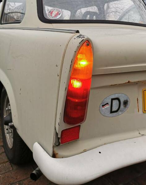

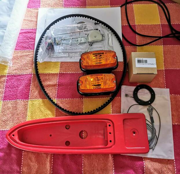

A package arrived early on this morning containing some more goodies.
New indicators were the first to go on.
Yes the one nearest me was a little squint there, I've tweaked it a bit since I took the photo.
The older style ones probably do suit the style of the car better, but these are streets ahead in terms of actual visibility to other traffic especially off to the sides, so will be staying.  The older ones will be packed away safely with the spares in case someone wants to restore them and use them in the future.

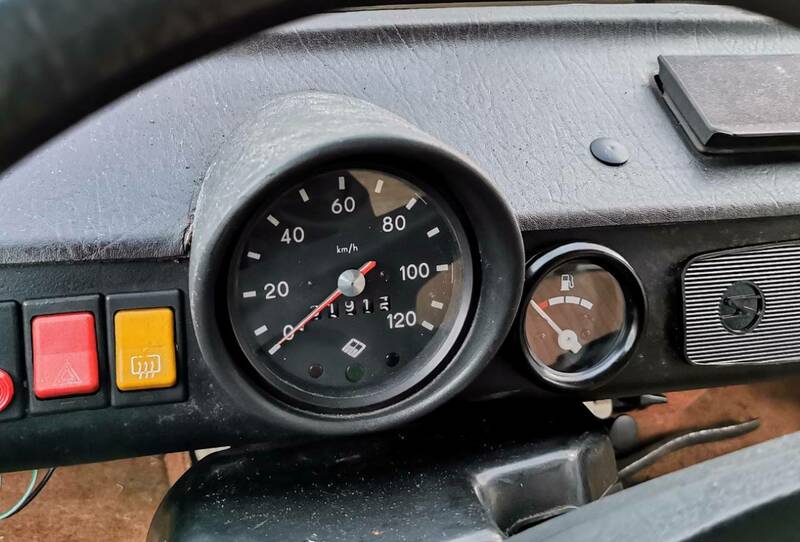

Have got 50% of the other main item in that parcel fitted now as well.
Yes...BOTH dials there are cockeyed.  I had totally failed to notice that until I took a photo.  I'll fix that tomorrow.
Hopefully get the sender fitted tomorrow as well all being well.  Gauge itself is wired up and working.  I *will* have to pull the face off that though and go after the gauge with some model paint to make the colour of the pointer match the one in the speedometer though...that not matching is just going to bug the hell out of me, and makes it look so obviously aftermarket.  At least if the colours matched it wouldn't jump out at you so much.
The illumination is waaaaaaaay over enthusiastic as well, so I think needs the lamp wattage reduced from the 5W that I think is in there to probably a 1W lamp which would be plenty.
Obviously I'll keep the original fuel consumption gauge with the car, but personally given I quite frequently find myself having to jump in the car and do several hours of running around without forward planning the journeys it's nice to just be able to see how much fuel I've got!

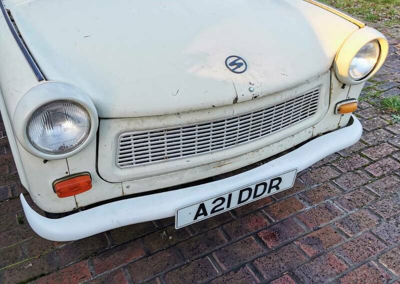

Hard to tell, but both headlights have now been replaced with ones having a proper beam pattern for UK roads.  They've been adjusted to look vaguely sensible based on the beam on the fence across the road, when I next have the Rover running I'll shuffle cars around and do a more precise job of the beam adjustment using the garage door.  They do actually provide some light on the road now which is an improvement.  The amount of light actually output has probably doubled as well given the bowls of the old lights were absolutely wrecked.
Still surprises me that given the car's been in the UK since 1999 that nobody bothered to put RHD headlights on it till now.
Something I need to investigate when I get a chance is whether the bearings in either my alternator or more likely cooling fan are making a racket.  It's always hard to tell from video, but there seems to be a lot more mechanical noise from mine than a lot of these cars at idle, and it sounds more like something that's belt driven than internal to the engine.  Though as said, it's hard to tell from a video and it seems that there was a pretty big variation from one unit to another in terms of noise anyway even when they were new.  Pulling the belt and running the engine (obviously only for a couple of tens of seconds at the most) will at least confirm if it's coming from the engine itself or an external rotating assembly - the fan is probably my favourite based on where it sounds like the noise is coming from.  Easy to test at least.

Couple of little things today.
Added a dedicated ground to the plate holding the ignition coils in place as it's also used as a star point for the offside headlight and indicator.  I wanted to actually move it to another location on the plate so you could tighten it a bit more, but clearance is an issue so I just left it be.  Sure the majority of people have zero problems with it and I'm just doing the usual and creating an overkill solution.
I also did what I could to tidy the coil wiring up a bit, though it's always going to be a bit of a rat's nest I think.
I think part of the issue with the ground is that the original coils were plain metal rather than painted, so made a better contact between the two halves of the bracket helping to act as one big connector rather than these ones being painted.
Had a nose around underneath the dash to see if I could see any direct evidence of where the water is coming in on that side.
Will need to pull the shelf out to investigate that black paint splodge, but my money is on the seam sealer between the various panels having failed (it seems to have gone brittle in a lot of places), so that's most likely to blame.  There is a water trap outside right above the wheel arch in the engine bay (I've re-sealed this area now) through which a seam does run.
Suspect some more chipping and re-sealing is in my future.
Closer inspection of the old body ground wire revealed that it had definitely got warm in the past.
It also made crunching noises if you bent it, and measured a solid 10 ohms on the meter, so was definitely stuffed.  New lead is way, way too long really but is what was in the garage.  I'll swap it with a shorter one at some point.

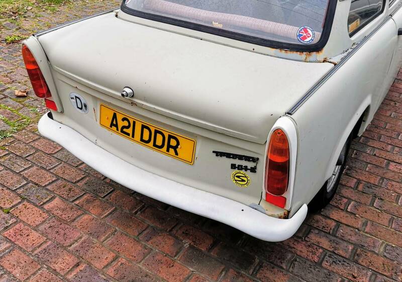

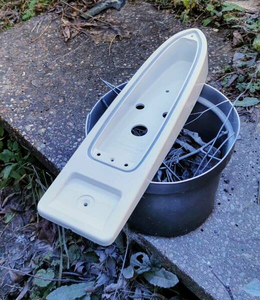

The new tail light moulding has had it's first couple of coats of paint.
Unfortunately the colour is far too bright a white so I'll need to try another option to find something that's closer.  Just shows that the swatches on the cans don't mean a thing as the one on this is very distinctly cream.
I do need to actually look up what colour this is anyway - pretty sure it's Atlas white, Papyrus is a deeper beige.
I also addressed the nearside tail light looking very cloudy compared to the other side - that was simply because the inside of the lens was filthy.
With the exception of one running light bulb in the offside rear cluster all of the lamps I've found in this car so far have been Narva branded, so either original or replacements from someone's stash of Trabant bits most likely.
Found it quite difficult to get all of the ingrained grime out of the grooves but it's a lot better now than it was.
Rosie's definitely Papyrus Weis (I bought some rattle cans years ago from TrabantWelt that were a good match), and looks the same colour as yours?
Mind you, who's to say how consistent the paint was over the years anyway?!  Mine has faded since 2009 when I bought the beast, which won't help with colour matching either.

Interesting, the comparison swatches on Trabantwelt make Papyrus look much darker, but that definitely looks to be the same colour as mine.
No real problem using the stick on beam deflectors, I just know it's the sort of thing that would bug me on my own car.
Leave it (and the other one) soak in a bucket of warm, to start with, water, with washing up liquid for a couple of days. They should easily clean up then in a fresh bucket of water using a paint brush.
Ford Ivory White looks a much more acceptable match.
It's not absolutely spot on, but I think is close enough for the intended application.
I'll probably repaint both rear light surrounds so they at least match each other, probably the headlight trim rings as well (one of those is a bit scruffy), so even if it's not a perfect match it should at least make the car look consistent.  The factory match between plastic/Duroplast/metal parts wasn't exactly great from new anyway.

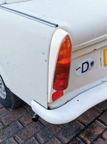

Bit of additional afternoon tinkering - albeit brief.  Apparently I slept funny last night and have royally pissed off my neck and left shoulder, and have been slowly seizing up more as the day has gone on.
The tail light lenses were chucked in the parts washer.  Any resemblance to a domestic dishwasher is entirely coincidental.
Predictably they came out looking like new.
Hard to tell in a photo, but they had always looked a little cloudy on the car before but that's not the case at all now.

While those were being washed I was busy dumping a little over half a litre of Vactan over the floor.
I probably should have hoovered it out again first as there was still quite a bit of loose crud floating around that I'd dislodged over the last few days, but I'm not too worried about it.  The surface finish isn't important to me as it will be under two layers of carpet, and there will be a thick protective layer (probably several) getting painted over this anyway.
Ideally I would have taken the seats out before doing this, but unsurprisingly the bolts aren't even vaguely interested in moving and I was inclined to just declare discretion to be the better part of valor there and leave them be.  Either snapping a bolt head or captive nut off the seat base mountings doesn't sound like my idea of fun.  Somewhere in its future this car will probably want a new set of floorpans as given the visible pitting on these they must be pretty thin in a few areas, but that's not an immediate problem so long as my MOT tester doesn't actually poke any holes in anything in April.  This should be a step towards stopping it dissolving from the inside out as it's clearly slowly been doing for years anyway.  Plus the ongoing efforts to try to track down and cure the actual water ingress itself.

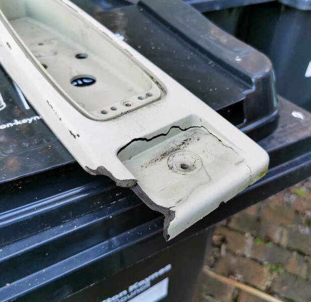

Let's look at getting that smashed rear light surround changed.  It looked like it should be as simple as removing the lens from the light, unplugging the wires, removing two nuts from inside the boot and the whole lot coming off.
We all know jobs like this are rarely as simple as they look though...
Oh.  Maybe in this case they are!
Here's where the wires go in case you're doing this job and forgot to take note.
Red and black one goes to the terminal on the back for the brake light.
Back together in less than ten minutes.
Before:
After:
Yes the paint match is a bit off, but I think it's fine - especially if I match both of the surrounds and maybe the bumpers to be the same it will look far less unintentional.  The steel and plastic panels have faded to notably different shades anyway so things are never going to be perfect no matter what I do unless I respray the whole car.  A bit outside our scope at this stage.
Looks far less scruffy than having a chunk missing out of the corner anyway.
