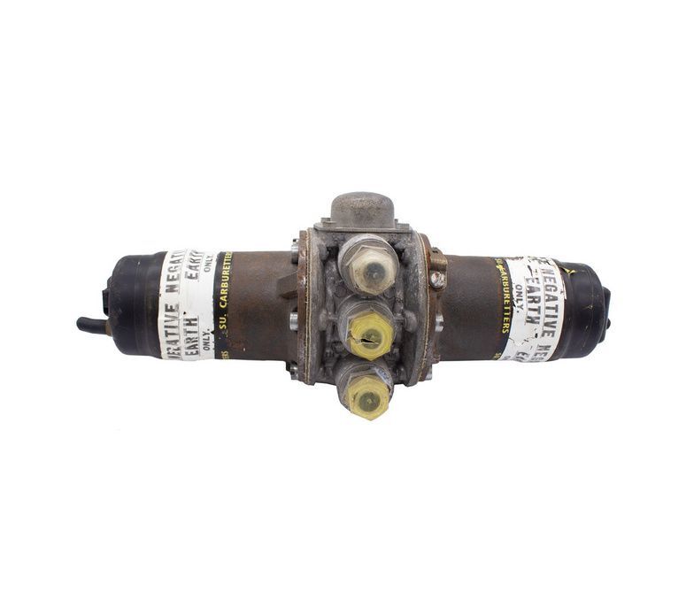

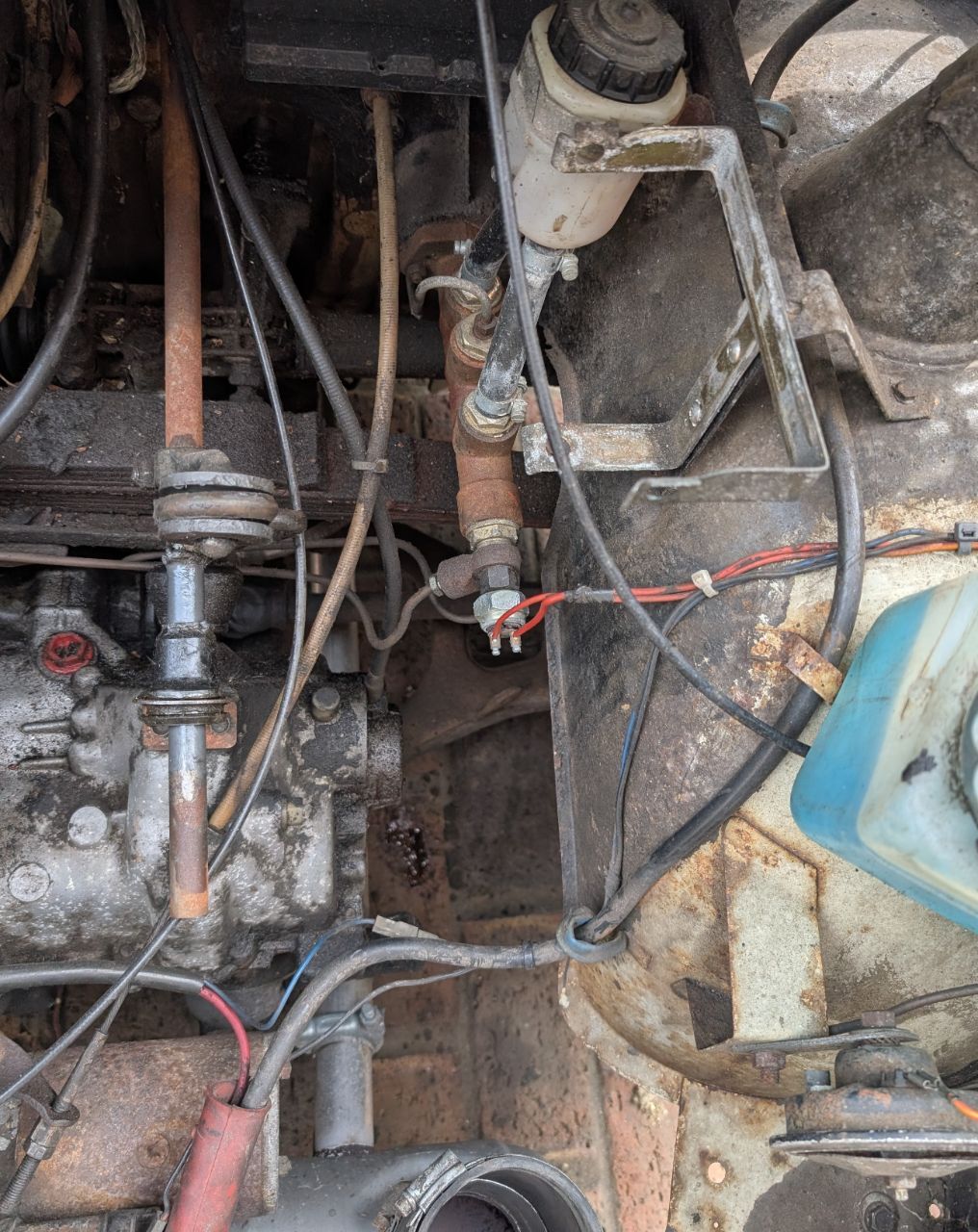

You're P4 fuel set up must be different to mine then...
I have a solenoid valve (inoperative in my case) sat on top of the tank by the offside wheel.  In normal operation, fuel is pulled through this valve from a pipe extending inside the tank, to about an inch off the bottom.  When the solenoid valve moves into 'reserve' position, it just pulls fuel along a slightly longer pipe running side-by-side with the first.
The pump is singular, I wonder which setup is standard?
Well done on the Trabbi, I've had mine since 2009 so fully understand how they get under your skin!  They're also just so good at what they do...
Yours is a 100 isn't it?  In which case it will be different.  The 95 and 110 were the only ones which used the double ended pump if memory serves correctly - all the others used a single pump and a solenoid valve to select between main and reserve.  Whereas this uses a completely electrically separate pump built into one housing which looks something like this.
Quite a smart idea given that the only real weakness I've ever found with old pumps like this is that the points can fail - this gives you not only reserve fuel, but essentially a reserve set of points too.  Of course the fact that nobody ever uses the reserve setting does mean that there's no guarantee that it will work or not full your carb with gunk when you do use it!  I do like systems with built in redundancy though, so would really like to see it reinstated.  Just not at four hundred quid!  I did see one somewhere for £250 odd, but that was NOS, so I'd need to budget a rebuild kit on top of that which is another £50 or so.  Still way too much for something I really don't need right now.  Maybe in six months time if the car has been behaving itself well and I'm putting decent miles on it on a regular basis I'd reconsider - but at the moment we're concentrating on stuff actually in front of me, in terms of bigger spends anyway rather than the odd £50 here and there.

Yep, mines a 100.  That pump set up is fascinating, and like you say, essentially a whole back up pump too.

My 80 (a 1959) had the twin pickup/solenoid affair. It also had a mechanical pump on the side of the block like the Land-Rovers that used the same engine.
I think Rover dropped the solenoid when they stopped making the 80 and went back to an electric pump. The 1962 100 that I broke had two electric pumps in the boot, and all the pipework and wiring was clearly factory ( and a proper plumber’s nightmare).

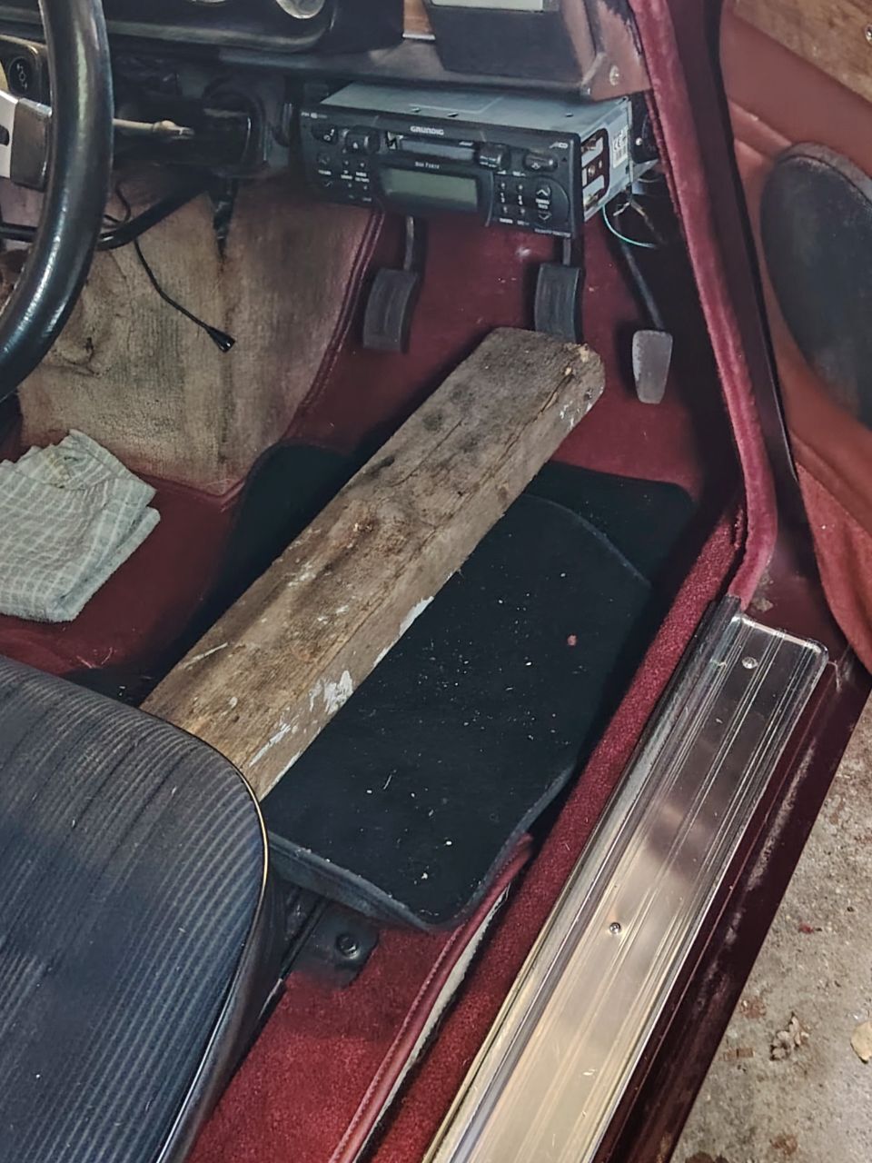

If no one is around when I'm testing brake lights a suitable length of timber wedged between the seat and pedal does the trick. If the 3x2 is a bit short a book or an anything makes up the gap and prevents potential seat damage.
On 18/04/2026 at 08:26, auntiemaryscanary said:
Good to hear it's minimal work/expense to get it through the test.
This. Exactly this. I have a special stout piece of wood (fnarr fnarr, I thought I'd get that in before any of you lot did) that lives in a corner of the garage for exactly that purpose. It works on all three cars.
I'm not clever enough to keep a piece reserved - I have to go scrabbling through the off-cuts pile every time!
I do have a bit of PVC pipe in the garage which has generally served that purpose in the past, it's too long to work in the Trabant though and I've never got around to finding something the right size.  Or just reverse park in the spaces right out the front of Toolstation now and then and look at the reflection in the shop frontage...Which realistically is far more likely to happen.
One of the things that my old man drummed into me, that I find myself doing without thinking about forty years later, is to always register/check that the brake lights are working when reversing somewhere in the dark.
On a variation of the stick theme, I have a large hammer that’s the perfect length to wedge the Land-Rover’s brake pedal down with. 😃

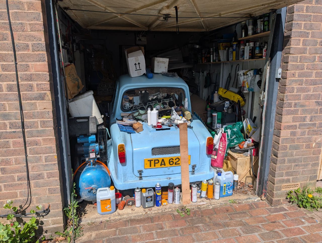

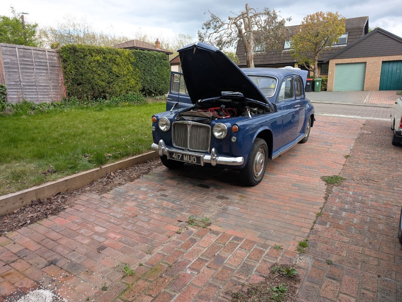

Got a little bit of time today to tinker with cars.
First up was doing something about this disaster area.
About sodding time she saw light of day again.
Aside from checking oil and putting air in the tyres that's as far as we got.  The battery hasn't survived the winter of being left stone flat because I forgot to disconnect it (again).  I keep saying I'll get a socket installed for a battery tender but it keeps not happening.  It did apparently take a charge, and will sit at a healthy enough looking voltage off load, but collapses immediately as soon as you try to pull any load whatsoever above a couple of amps.  There is an isolator switch in play, but the one thing it doesn't disconnect is the clock - and over the course of a few months that's enough.
A replacement is on the way.  Hopefully here in the next day or so.
I need to double check my records, but I'm pretty sure the oil was changed very shortly before she was last parked up so it will likely be left well alone.

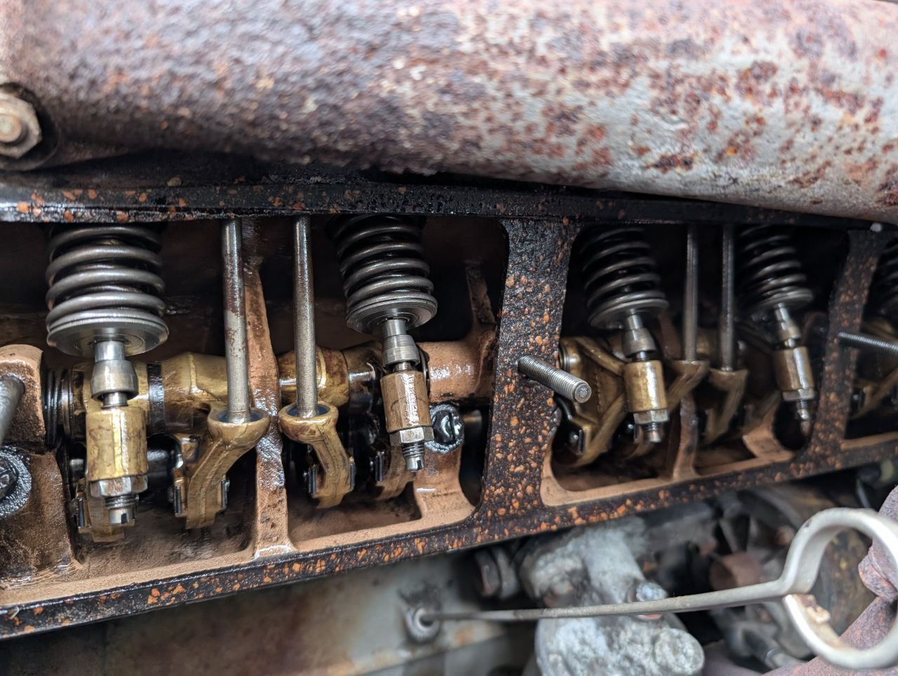

The next item on my to do list was to set the valve clearances properly.  Exhaust first as they can be done cold.  Which given the proximity of the exhaust manifold I am eternally grateful for!
They were all a bit on the loose side aside from no 5 which was spot on, but not horrifically so.  A new gasket went on as well.  The old one wasn't leaking but was obviously past its best and very well squashed.
I didn't have time to get the engine fully up to temperature and do the inlet side today, but dipped into a couple of other things.

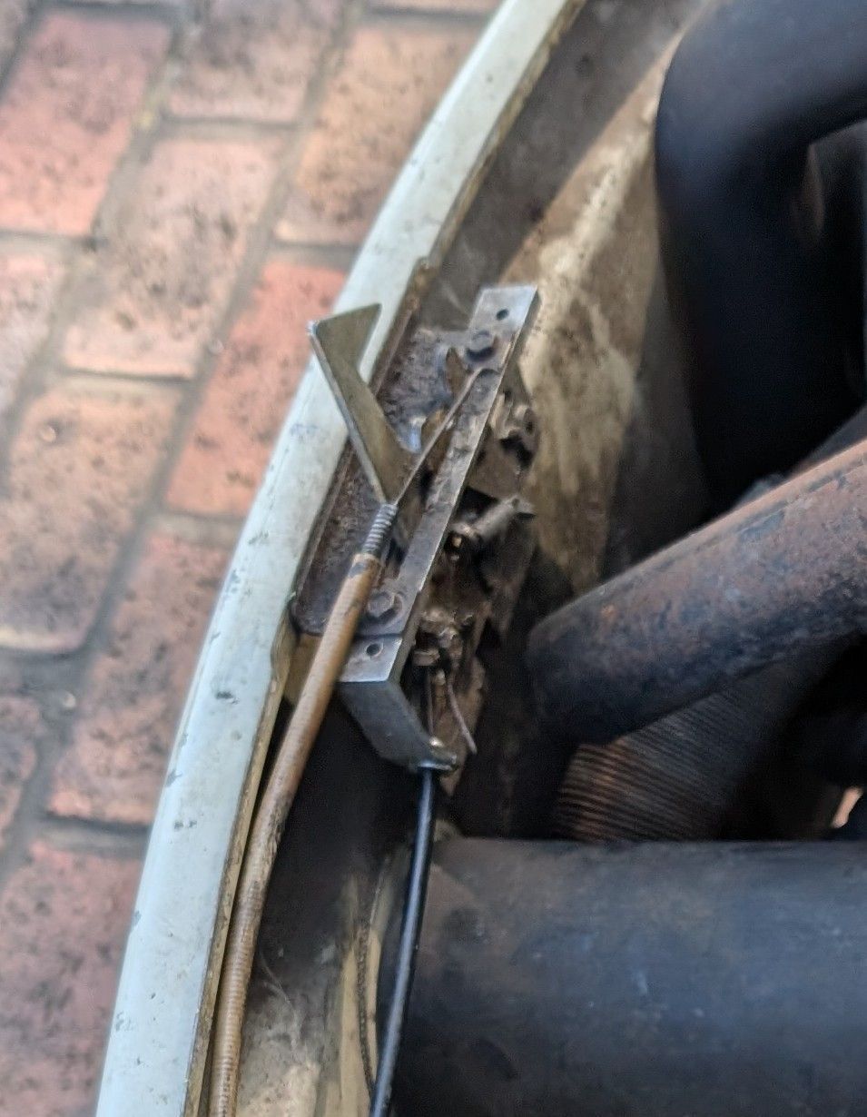

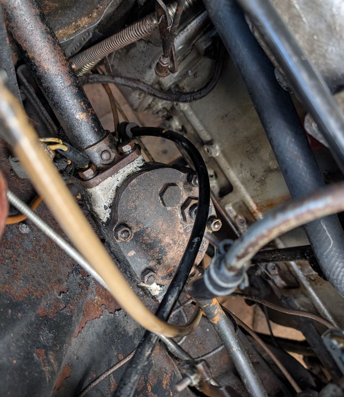

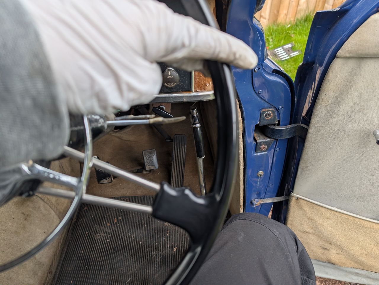

The frankly absurd amount of free play in the steering definitely needed to be addressed.  You had this amount of dead travel before hitting any semblance of resistance beforehand, never mind the wheels actually starting to move.
It really was more of a general suggestion of where you wanted the car to go rather than a control.  There's a reason it's done about a mile and a half since it arrived here!  This was it!
I both tweaked the adjustment on the box a little and topped up the oil in it.  I suspect I may have over compensated a bit with the adjustment, but I'll double check the procedure in the manual shortly.
Confirming that I could get the adjuster locknut to crack off was my main mission there really as I remember that being so tight on my previous one was so tight that I simply couldn't shift it.  Getting the excess free play taken up now though will make tracking down any slop elsewhere in the system far easier now though.
It has also moved!

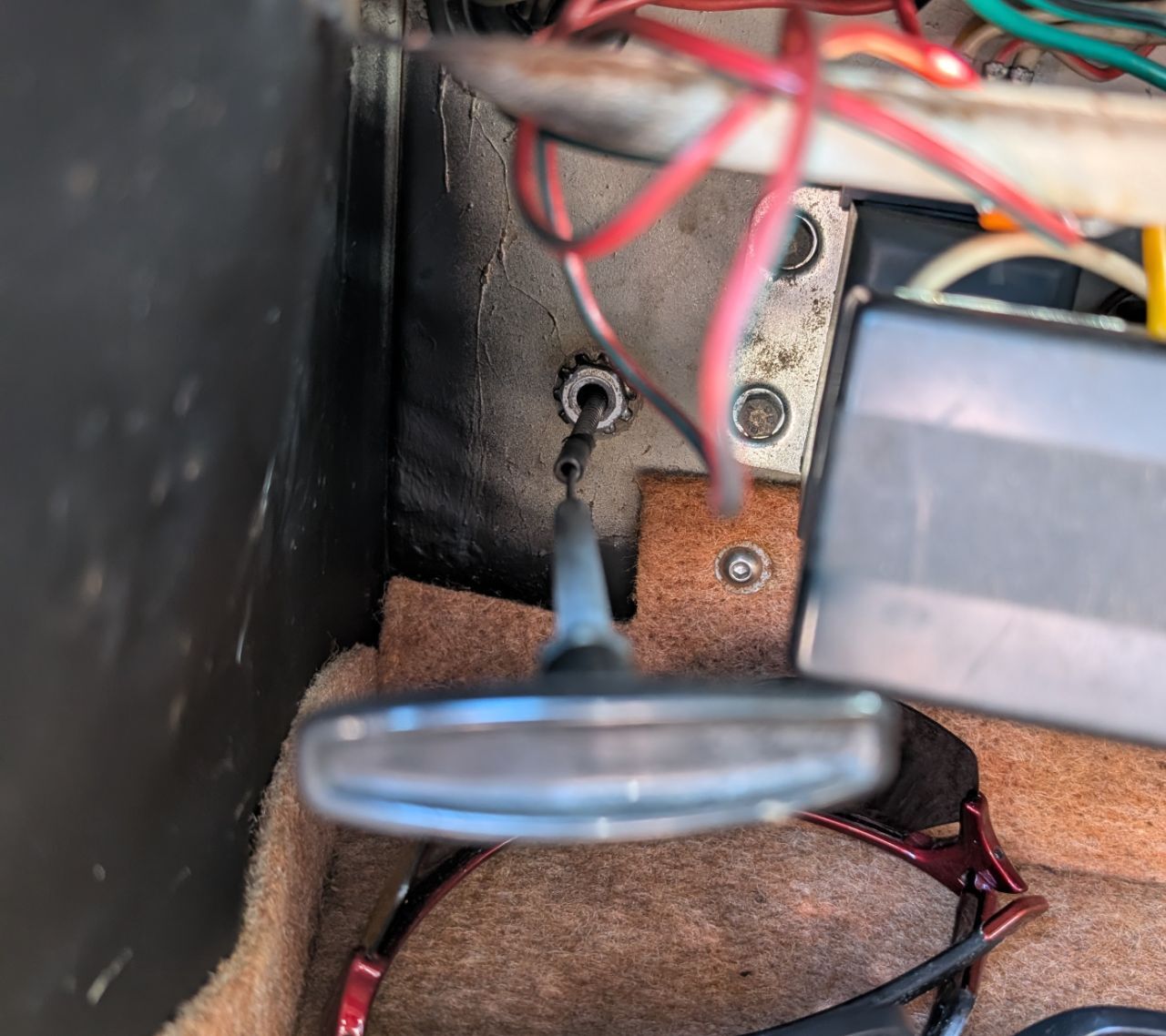

This has highlighted that the brakes - or at least the offside rear brake - are binding quite substantially.  Also the handbrake control actually does nothing.  It's just the one that's dragging that's making it seem like it's working.
Speaking of the hand brake - that very prominent looking brake light on the dash, with the lens that focuses it riiiight at your eyeballs, yes it is as bright as it looks in the photos.  It literally projects a beam onto the head lining if your head isn't in the way.

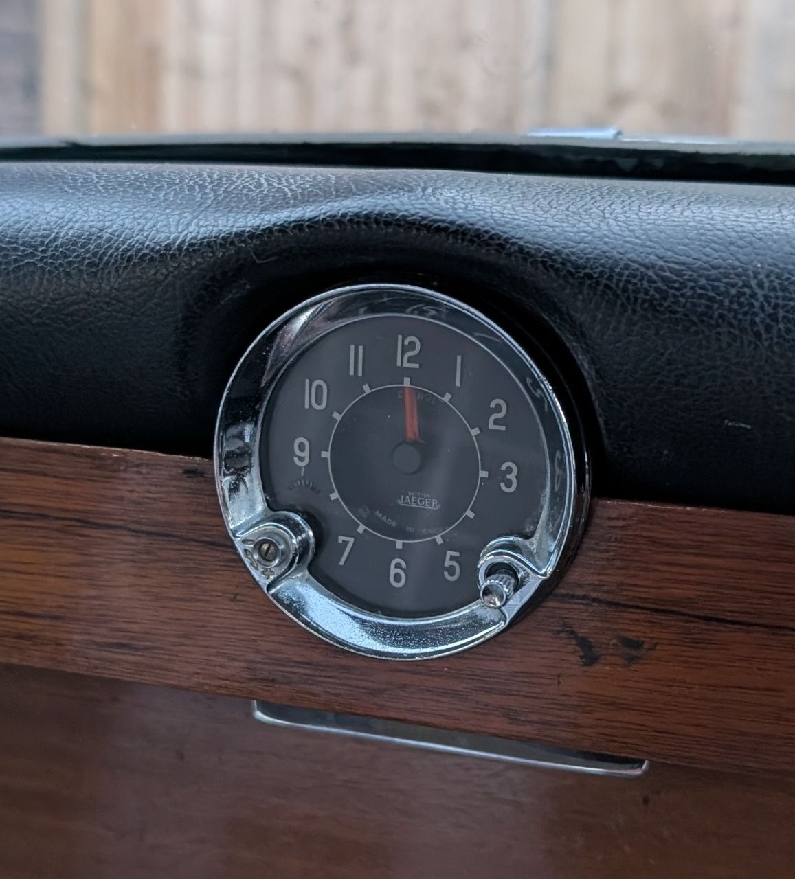

Also swapped out the wrong clock...
For the correct one...
It still doesn't work but at least matches the rest of the instrumentation so there's not a mismatch bugging my OCD.

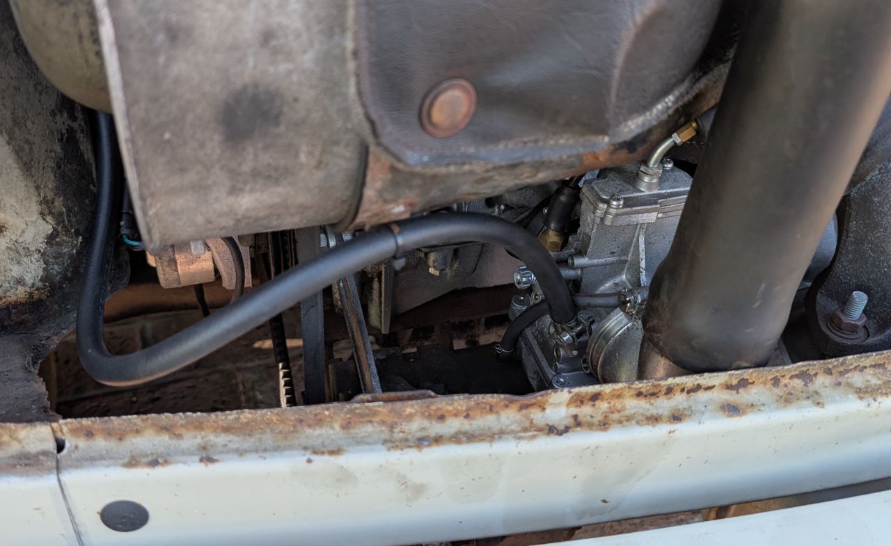

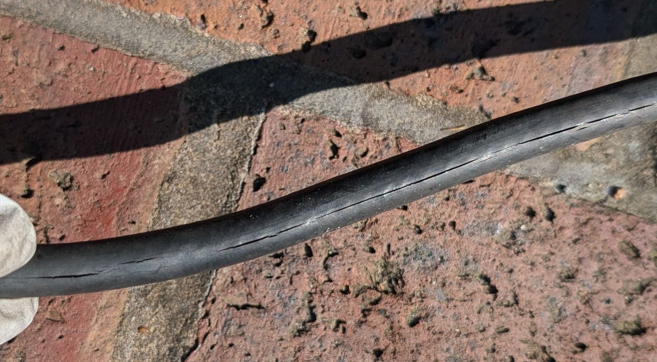

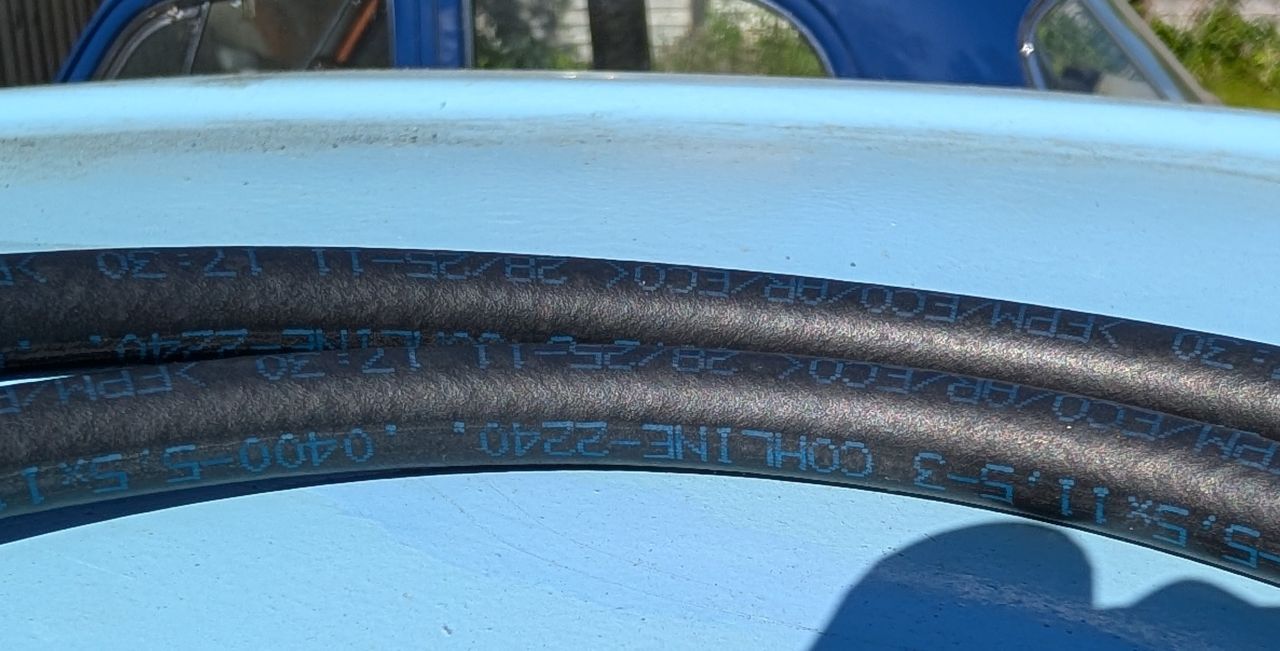

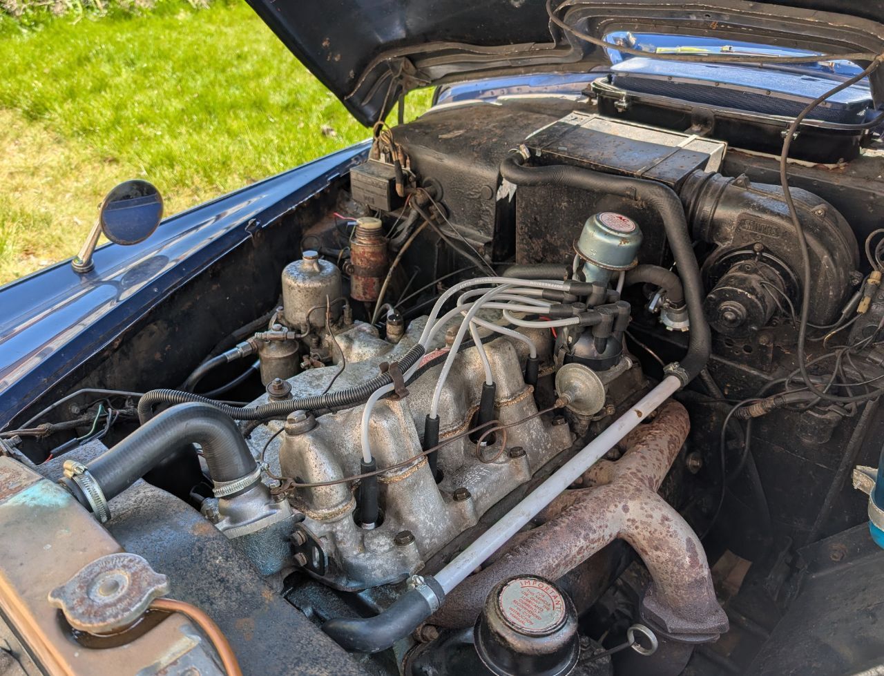

Quick and easy job done before lunch today.
Before:
After:
I'd really like to go back to the factory HT leads setup at some point, but this is a vast improvement for now.  No more day glow red, the king lead actually reaches the coil and the rest of the leads don't keep trying to make friends with the exhaust manifold.  Tidied up the LT leads between the distributor and coil as well while I was there.  They were about half a mile too long and made of several leads joined together with spade connectors before.  Now cut to length properly and loom wrapped.

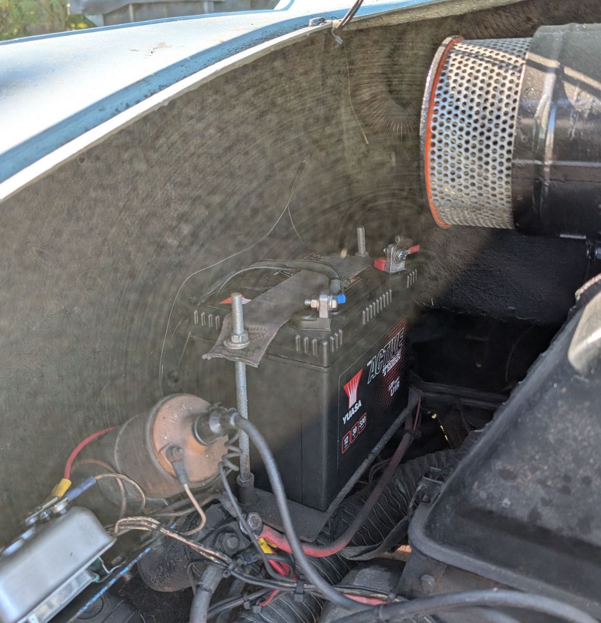

The battery that I was hoping would turn up yesterday finally arrived late on this afternoon.
That was quickly chucked into place.  Excuse the horrible glare from the sun.
I also installed an actual matched set of bolts for the terminals this time...there was definitely evidence of me having used what I had on hand when I hooked this up originally - most likely in a rush - just using whatever random collection of fasteners I had to hand.  Uh huh.
One bolt that is actually bigger than the hole in the post and one roofing bolt.  Kwality with a K there you idiot.

Quick and easy job today on the Trabant - fitting the new brake light switch that turned up on Friday afternoon.
Predictably a quick and easy job.
We now have properly working brake lights again.  They are a good deal brighter than the camera makes them look.
Noticed a couple of drips of fuel from the carb while I was there, which of course required looking in to.  Initially I thought the carb was flooding over - right up to the point I moved the fuel line a bit.
Ah.  That's sub optimal.
My usual rule is that any fuel lines I find are replaced with Cohline hoses which are fully ethanol safe on sight.  This one got missed however simply because I didn't have any 6mm line in stock.  Because I never wrote it down I promptly forgot about it.
Sure enough this is R9 rated according to the text printed on it, but the whole thing is shot.  I've temporarily stuck an offcut of random fuel hose I had laying around to replace the bit that's actually failed, but the whole lot will be changed when the new hose arrives on Tuesday or Wednesday.  The hose clips will be changed at the same time, and that screen filter will be ditched.  There's already a pretty fine screen in the fuel valve, and if we've got all new line between that and the carb having an additional one is just redundant and an additional potential leak point.
I do wonder how long that's been leaking.  It was just very gently seeping down the side of the carb before I moved that line.  Thing is that because I turn the fuel supply off whenever the engine is stopped I likely wouldn't have ever seen more than the odd drip - and that's mostly going to evaporate pretty quick.  I've never been aware of any smell of fuel though, and it really can't have been that obvious or the MOT tester would have picked up on it.  Goes to show you can't be too careful though of things that are pretty well hidden from view.  You really can't see any of this from above or below without pulling things off.
Don't forget about old fuel lines folks.  Also buy good stuff from the likes of Glencoe - the so called fuel hose they sell these days in the places like Halfords is absolute junk and will be disintegrating in next to no time.  I'd also trust anything from Amazon or eBay about as far as I can throw it as their is a ludicrous amount of counterfeit material on those platforms now.  Yes Cohline stuff is expensive - but it's fit and forget and is far cheaper than having your car burn to the ground.  Absolute bargain in my book.  It's also so much more pleasant to work with than cheap hose as it's actually compliant so will go around corners.

Other job I did was to pull the float bowl lid on the Rover's carb and replace the gasket for that, which was absolutely wrecked and I'm pretty sure if where the weeping issue we had there was coming from.  I didn't get any further than that as I was both running out of time and was absolutely getting eaten alive by midges so was well and truly ready to beat a hasty retreat inside by then.  I've never known anything like that in direct sunlight.  They were just absolutely everywhere.

There we go. New line from the tank to carb. All three or four feet of it.
This is what the old line looked like.
Replaced with proper stuff.
It's pricey compared to random crap off eBay, but a hell of a lot cheaper than a car fire and means I only need to do the job once.  If it IS being sold as cheap as random unbranded line, it's fake and shouldn't be trusted beyond a get-you-home type fix.
Earliest job I used this for was in 2019 and that line still looks brand new.
You can still see the shiny bits hiding in here just about if you look close enough.

The inner core of the bonnet release cable has pulled through the ferrule into the cabin.  In fairness it's been gradually getting worse for months.  Irked I forgot to order a replacement along with the brake light switch.
However...you may remember a year or so back I put a new engine in this car.  As the carburettor was switched for a Mikuni at the same time I had to change the throttle and choke cables.  Now I'm me...so of course they didn't go in the bin.  Those cables were perfectly serviceable and I knew full well could be really useful when I least expected to need it, so were hung on the wall in the garage.

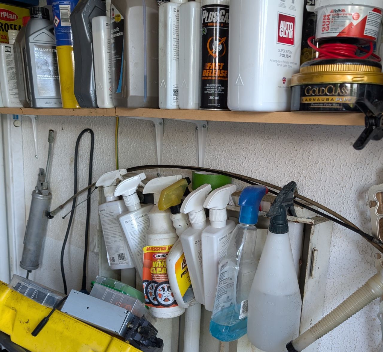

Turns out the choke cable is identical to the bonnet release cable.  Which honestly doesn't surprise me on this car.  Why have two different cables on the bill of materials when two identical ones will do.  Only difference is the knob that's screwed on the one end.
That should do just fine.
I'm pretty sure the bonnet release cable on the car isn't an OEM cable anyway purely because it uses an oddball fastener size whereas basically everything on the car is usually one of four sizes.
That will do.
I will make a point of ordering a spare next time I'm getting parts in though.
Surprise surprise this all took about an hour, including figuring out how to get the bonnet open when the cable decided to disintegrate.
While I had the 6mm fuel line out I also replaced the bit of line between the PCV housing and the air intake on TPA as that's been slowly turning more and more to solid plastic for several years now.  Something I inevitably found myself cursing every time I came to remove the air cleaner as it was nigh on impossible to get off the stub.  Hopefully that won't be a problem going forward.
the stuff on REV resolutely refuses to budge, so I just flop the air-filter assembly off to one side :)
does remind me I do need to replace/double check a couple lines on REV, the main run was replaced with good quality Nautilus Fuel Master ISO 7840 A1 Fuel Hose, back in 2019, but I think a couple random bits of regular fuel hose might of snuck in, when the new fuel tank was fitted and then the fuel pump serviced etc
(I do regularly check said lines of course, they look fine, but as you say, certainly something worth proactively doing something about!)
interestingly one of the changes of the Model 70 Mark B, was the change from a flexible plastic fuel line, to a metal fuel line, always wondered why this is? what was the thinking behind the change not sure I have seen any where this still survived fully intact, but it explains the short remaining run of metal fuel line in REV
and more curiously also this was not something the Ministry retrofitted to earlier cars either, there was always a separate parts listing for flexible plastic hose for the Model 70 Mark A and ridged metal line for the Model 70 Mark B, so I am all the more curious about it!
but I digress!
but I digress!
The plus side is that the Cohline hoses are about half the price of marine grade ones - but I have a reliable trustworthy source for it rather than a random eBay shop which has always vanished by the next time you need it.
Happy to chuck a metre or so of this your way if you need it.  I grabbed four metres of it, but I use 6mm once in a blue moon so that will probably last me the next 20 years.
Can't remember what size the fuel lines are, but the breather line is 6mm!
