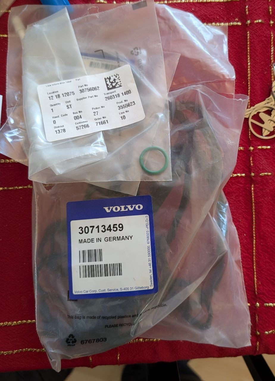

Second attempt at an O-ring for the Rover's head has arrived.  It looks and feels exactly the same as the previous one, but that really doesn't mean anything!  Not really much I can do aside from fit it and cross my fingers.  Getting a custom run done is going to run well into the hundreds of pounds it looks like so not something I'm really inclined to do with how little free time I currently have.  If things were less hectic I'd be more game for it and make my extras available for folks through the owners club at cost price just to be helpful.  I just don't have the time at the moment though.  So let's cross our fingers this one is better quality.

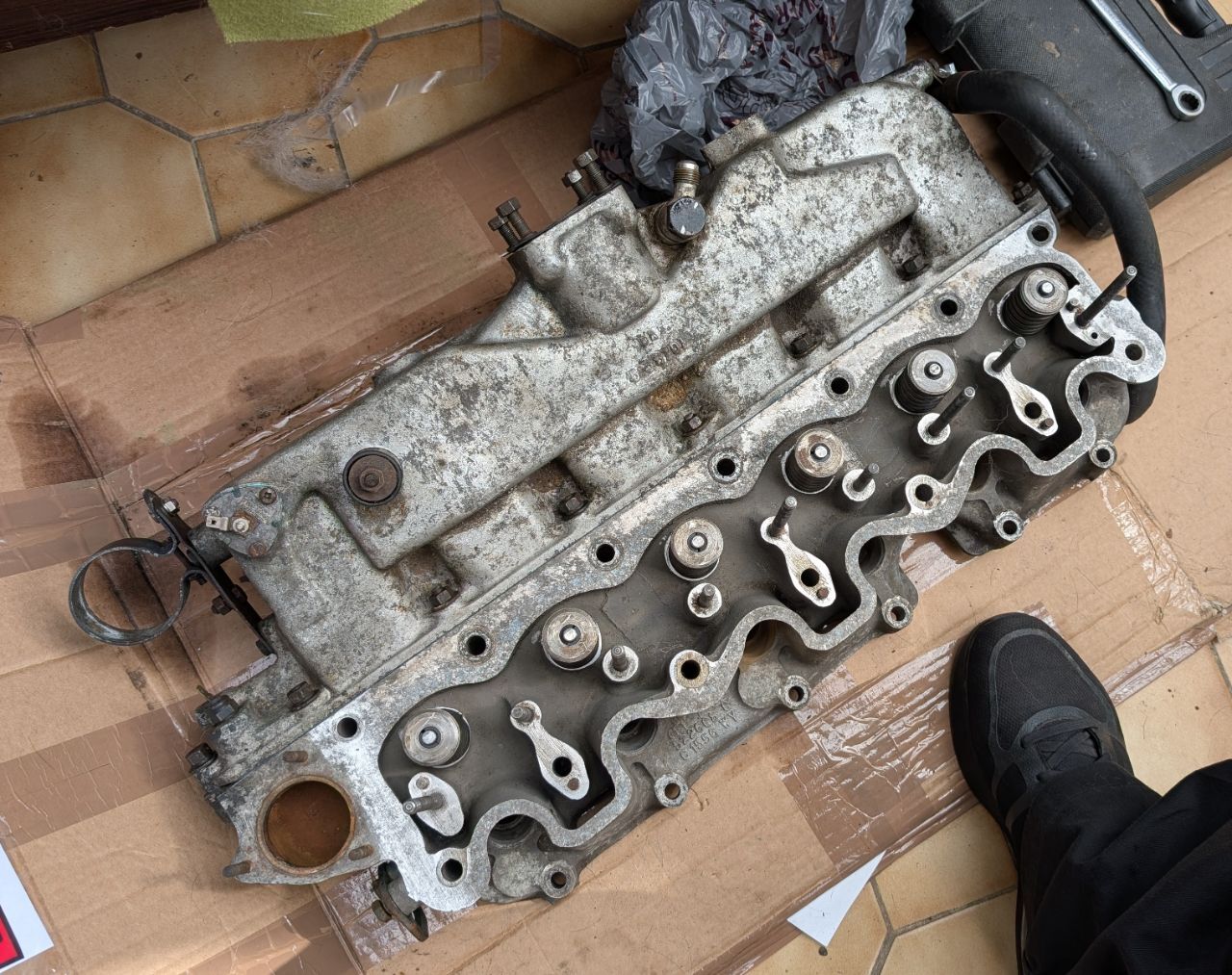

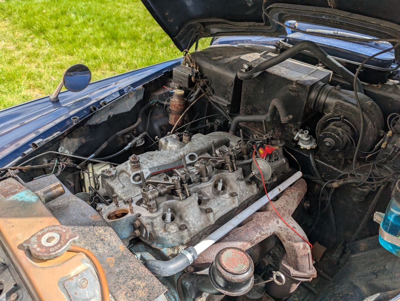

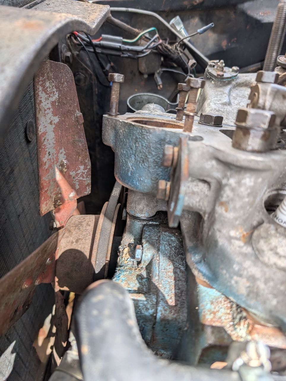

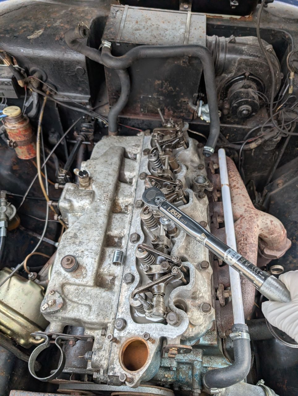

Okay.  Free couple of hours.  Let's get the head back on the Rover.
The most difficult aspect of this is caused by the fact that the top of the block sits at an angle and there aren't any dowels or anything that locate the head - so trying to manhandle the head into place, line the gasket up and secure it all at the same time while the head tries to slide off.  Sticking a couple of bolts in at the upper edge and hanging the gasket off it makes it a bit easier - but it's still kind of awkward to manhandle the sandwich into place.
Reassembly is the reverse of removal basically.
It was all going well. Distributor back in, and was about to start on the carb when I realised something.  I'd missed a small, simple but critical step hadn't I?
Excuse me while I find every curse word I could think of.
I get the impression that forgetting to put that bastard O-ring in place before fitting the head is kind of a right of passage if you work on these engines with any regularity.  I am not the first to forget it and definitely won't be the last.
Incredibly annoying though!
So I need to pull the blasted head back off again to put that bloody thing in place.  Thankfully I bought two head gaskets last time in case I needed a backup... I'd planned that to be for in a few years rather than...tomorrow, though.

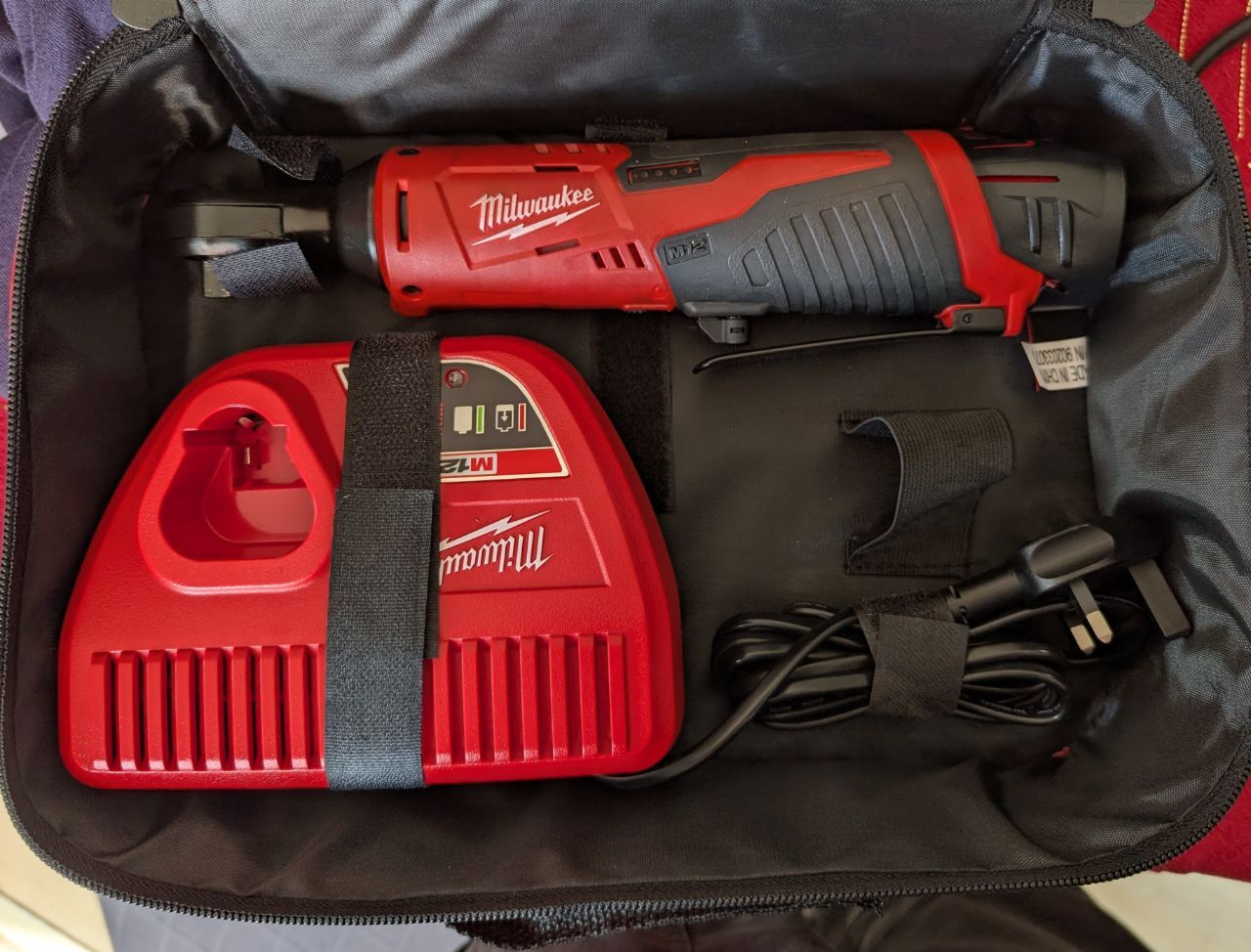

I am totally buying an electric ratchet before I go back to this.  I am now thoroughly fed up of fitting/removing and refitting this damned cylinder head!

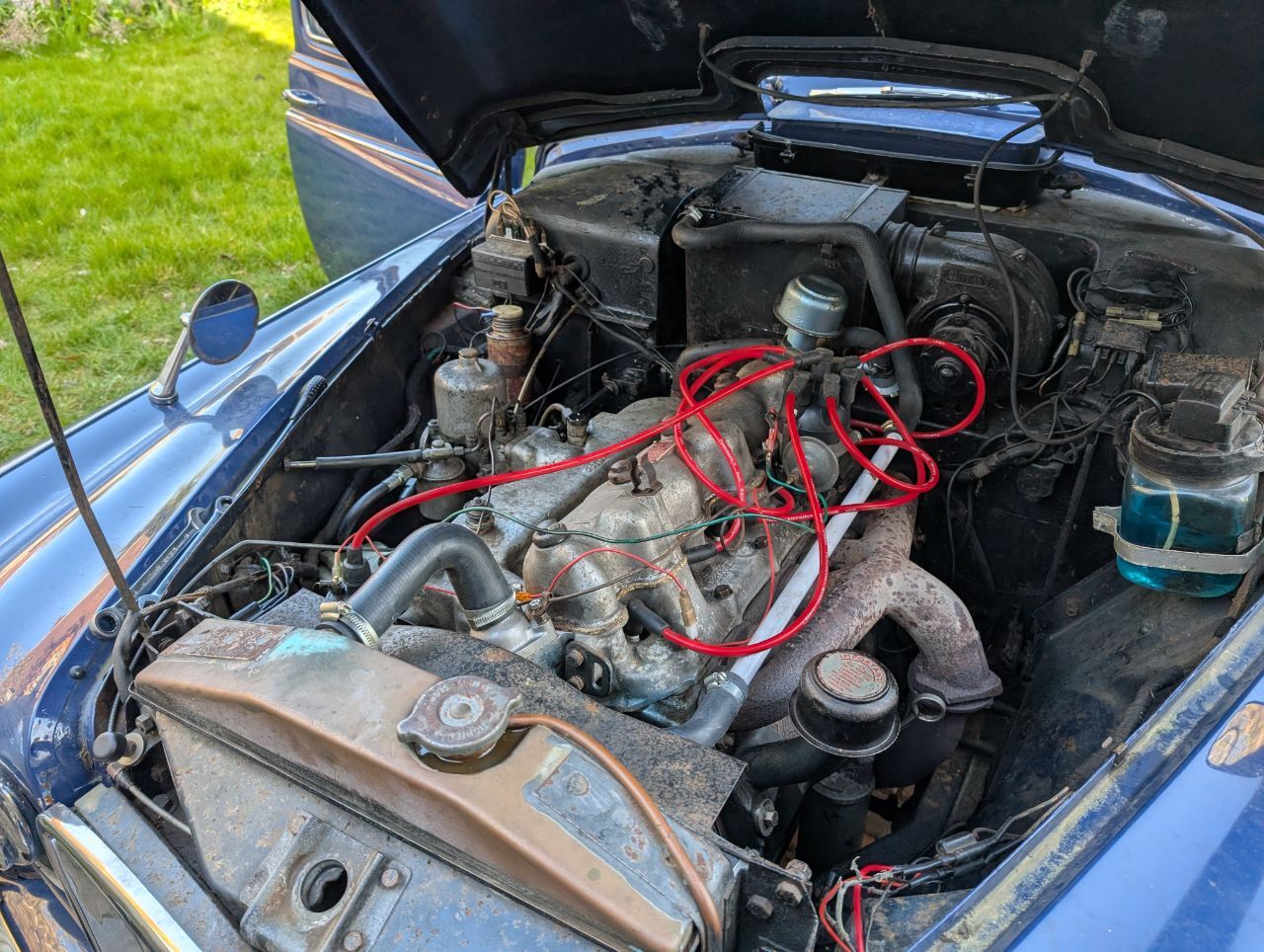

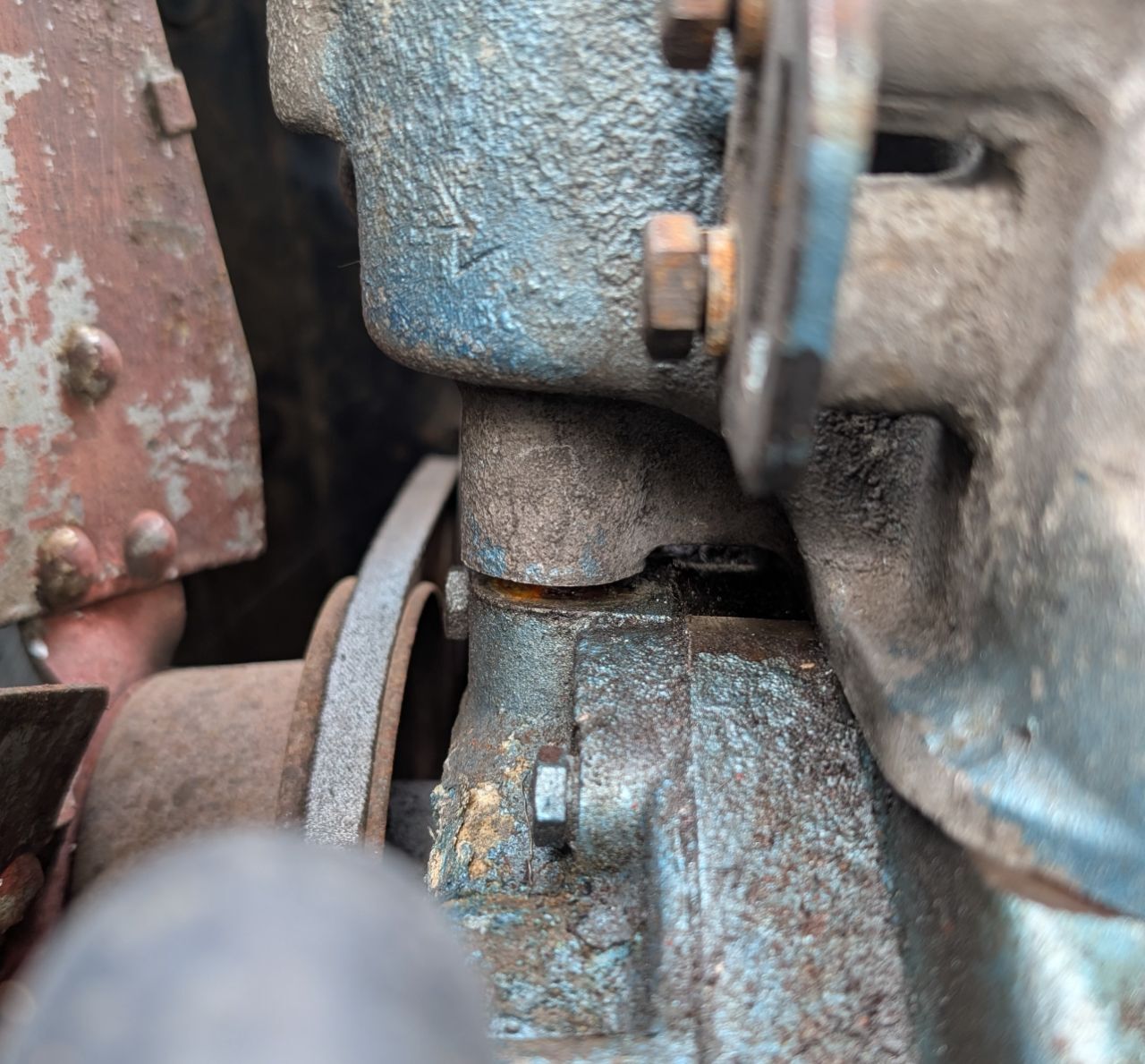

We are officially now back to where we were a couple of weeks ago.
With one major difference.
It looks like it's sitting off centre, but that's just how it is.  It sits snugly around a post, so there's no wiggle room in terms of positioning.
Out of time today so didn't get as far as reattaching the additional bits needed to run the engine, but at least the head is back on.
It better bloody not still leak after this!
Much as I dislike how over used the term is, the power ratchet really is a game changer.
Especially when dealing with stupidly long threaded things like the nuts that hold the rocker shaft in place.  I reckon it probably saved me somewhere in the region of 15-20 minutes - which on a job that took an hour (including a 10 minute period of head scratching looking for the new spark plugs) that's an appreciable amount of time.
Kind of kicking myself for not getting one sooner...as I expected I probably would!

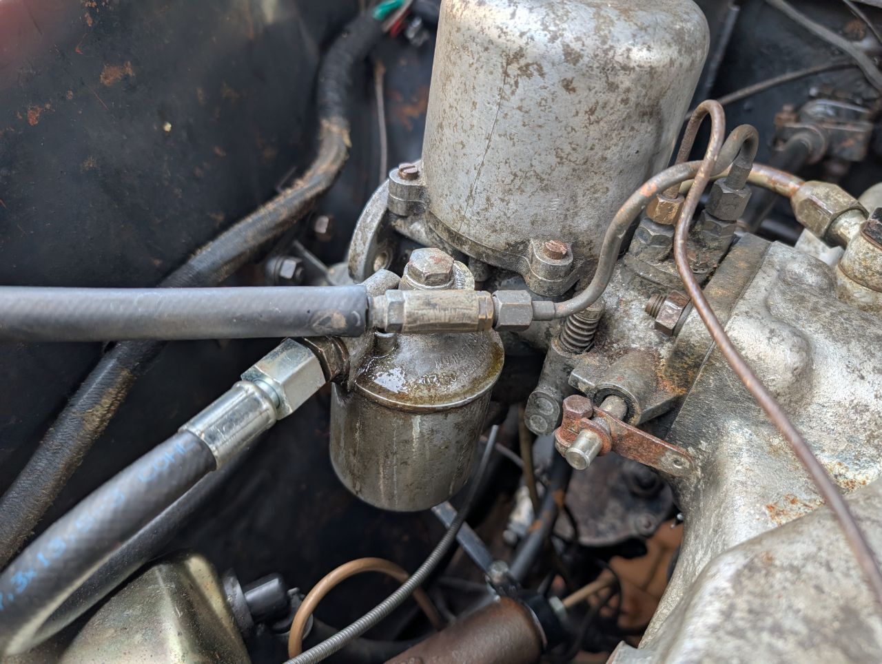

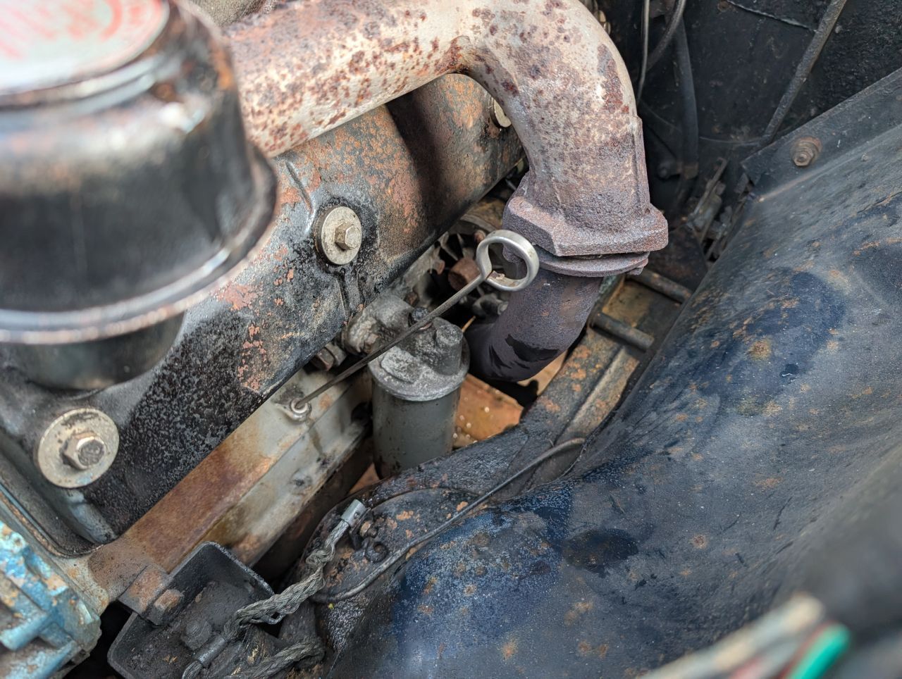

Does anyone make a spin on oil filter conversion for these engines?
I only ask because this is the second time I've pinched the damned seal putting a new filter element in and ended up with several pints of oil liberally distributed all over my driveway before I could kill the engine (and get an almighty belt from the ignition system as yanking the king lead off was the nearest available option).
I even *thought* that I should probably make sure the drain pan is under there just in case...however never got as far as actually putting the damned thing there.
Edit: Using a search engine not fully of Google AI BS and ignoring half my search terms, looks like I found one.
https://www.flexolite.co.uk/products/fa059-rover_p4_-_bolt_down_into_filter_bowl_-fa059
Will probably order one of those shortly.  I'm all for originality, but this is an area where we've come up with better solutions to the problem and will just be a nice quality of life upgrade at service time.
Getting the existing housing back into place is a giant faff as the chassis rail and exhaust downpipe are right in the way.
Second time round we got it sealed.
Nobody will ever know...
A spin on filter will really make this far easier.  It's a right faff to get this filter together.  I'm pretty sure my previous P4 had a bolt that went up through the bottom of the canister up into the housing, so you could do it all from underneath.  This one, the (quite short) bolt threads down into the canister from the top.  So you need to try to hold everything together with about one and a half fingers against the rather strong spring in the canister and somehow use your third hand to get the bolt started.  The canister really wants to tilt when you're starting it off, which is what had happened the first time.
Small environmental catastrophies aside, the oil now appears to be staying inside the engine.  It's five litres of 20W50 mixed with what was left in four random bottles in the garage, which was enough to get it to about 3/4 on the dipstick.  It will be getting changed again after a couple of hours run time to hopefully get the last of the moisture and emulsified slime out of the engine.  I'll properly refill it with 20W50 at that point.  Wasn't worth wasting a bunch of good oil for a sacrificial fill.

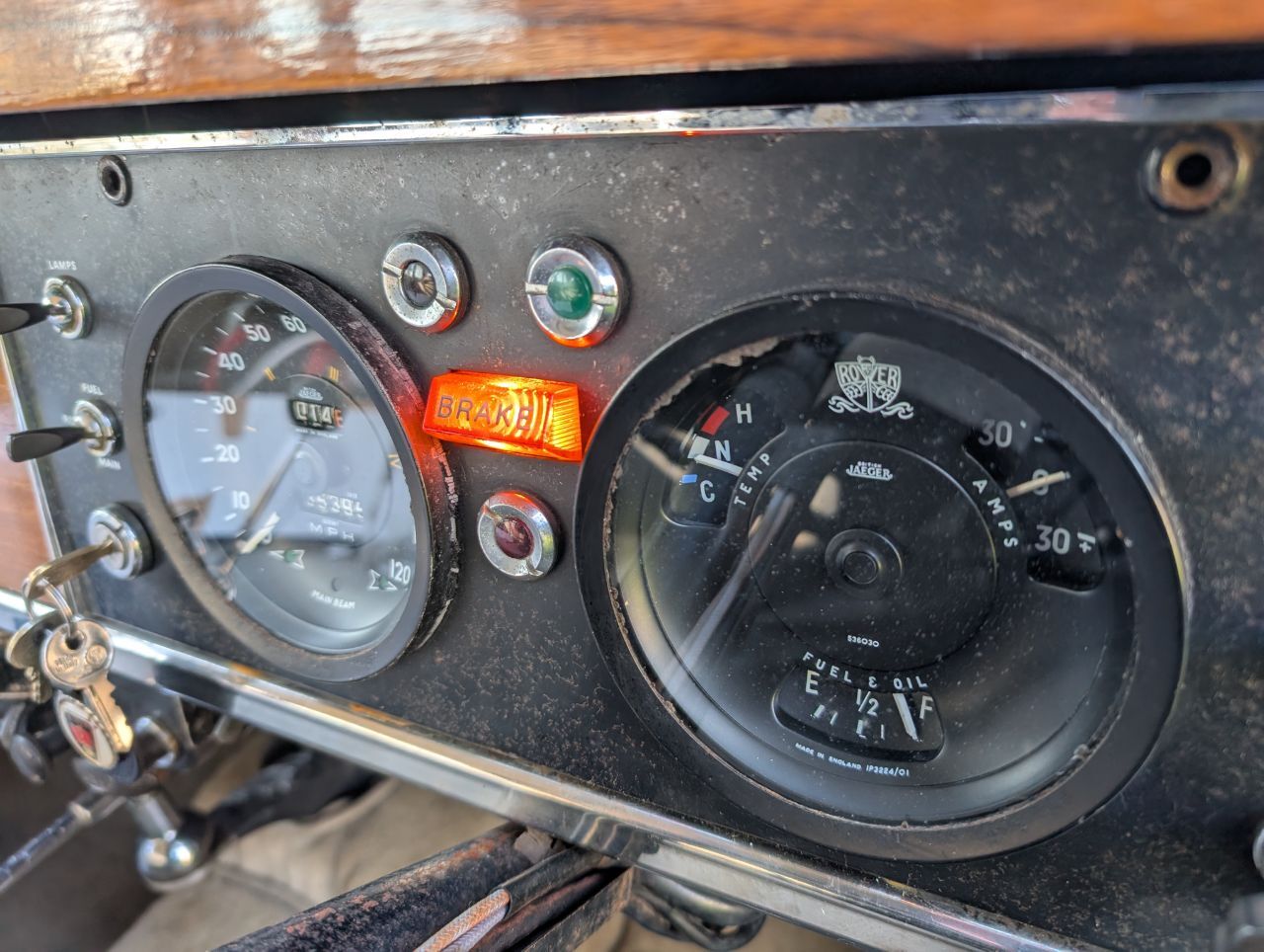

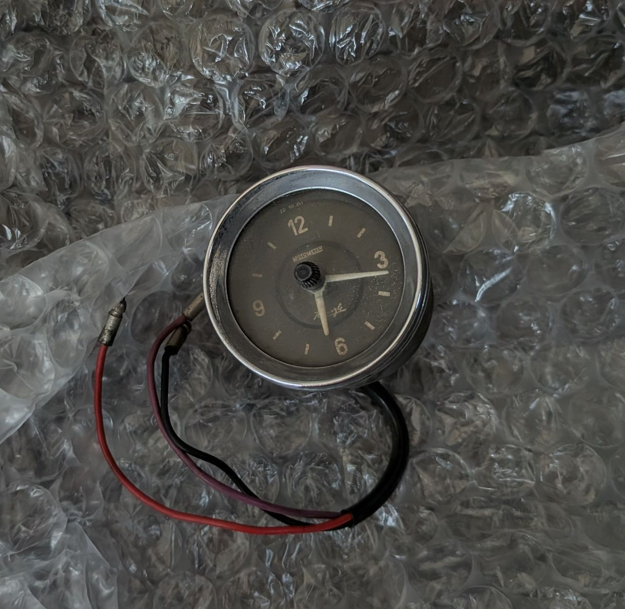

Also a replacement clock of the correct type for the car.
Needs to be serviced and I'll need to figure out if it can be converted to negative earth or not.  The one in the car is both the wrong type and the innards of it have melted.

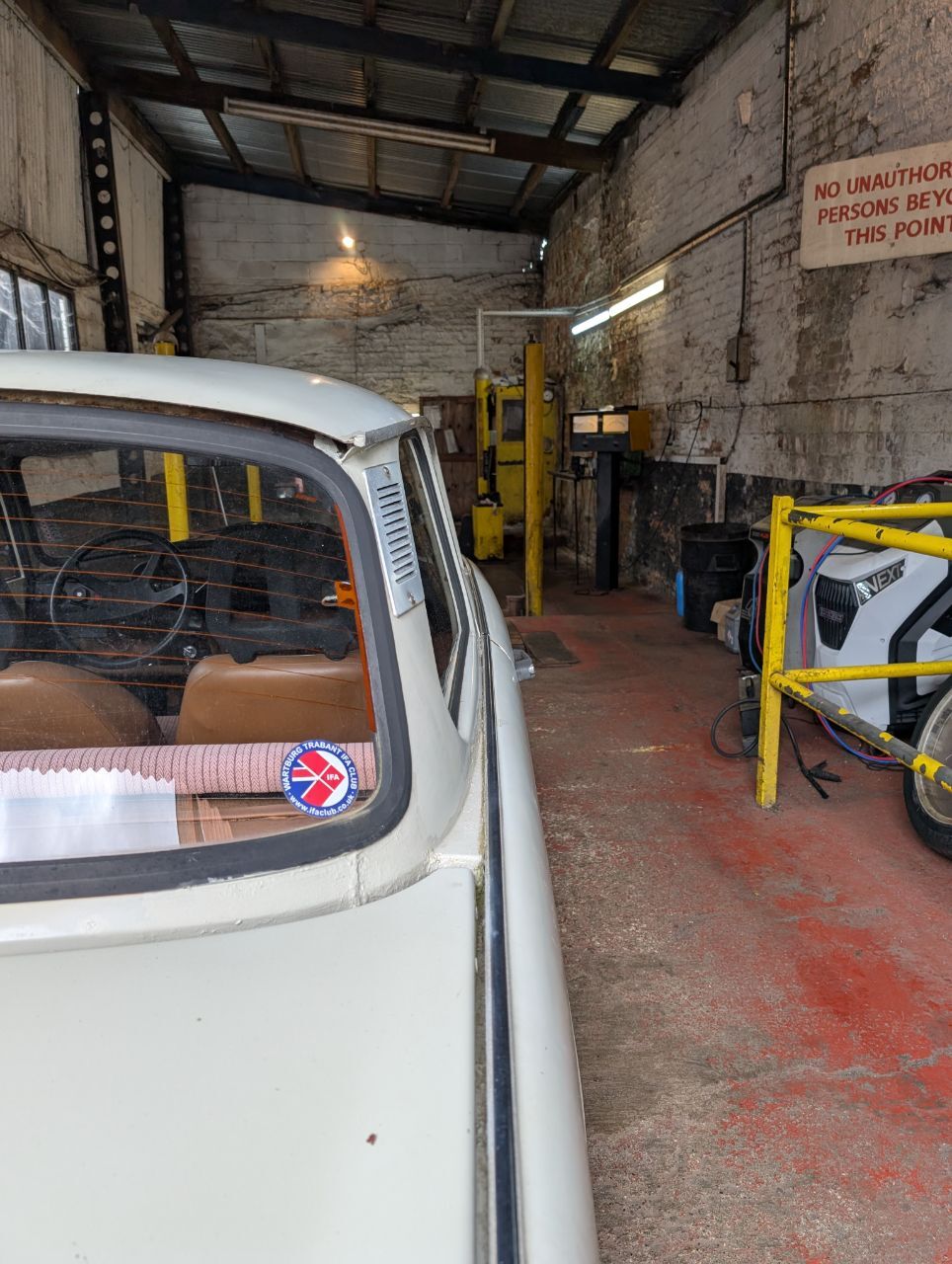

In we go again.
Third test in my ownership, which very rarely happens!
Result: Fail.
However it's a really easy fail - brake light switch has died.  We tested the theory by bridging it and yes it is just the switch.  New one has been ordered.  Should be the work of a couple of minutes to swap it out.
I'm absolutely happy with that result to be honest.
Good demonstration of why exempt vehicles getting a test is still a good idea.  I check all the other lights reasonably frequently, but the brake lights are more of a faff without a helper so I tend to rely on checking the reflection when backing into the driveway - which only really works when it's dark!
