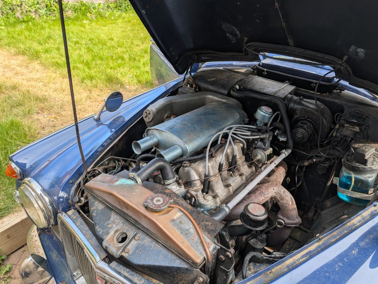

Despite the day being absolutely DETERMINED otherwise I did manage to get a bit of time this afternoon on cars.
The Rover has now had the valve clearances set properly.  Intakes were a mixed bag of tight and loose which honestly didn't surprise me.  Sounds a lot happier.  Even if my fingers weren't - doing adjustments on an engine that's fully up to temperature is so much fun.

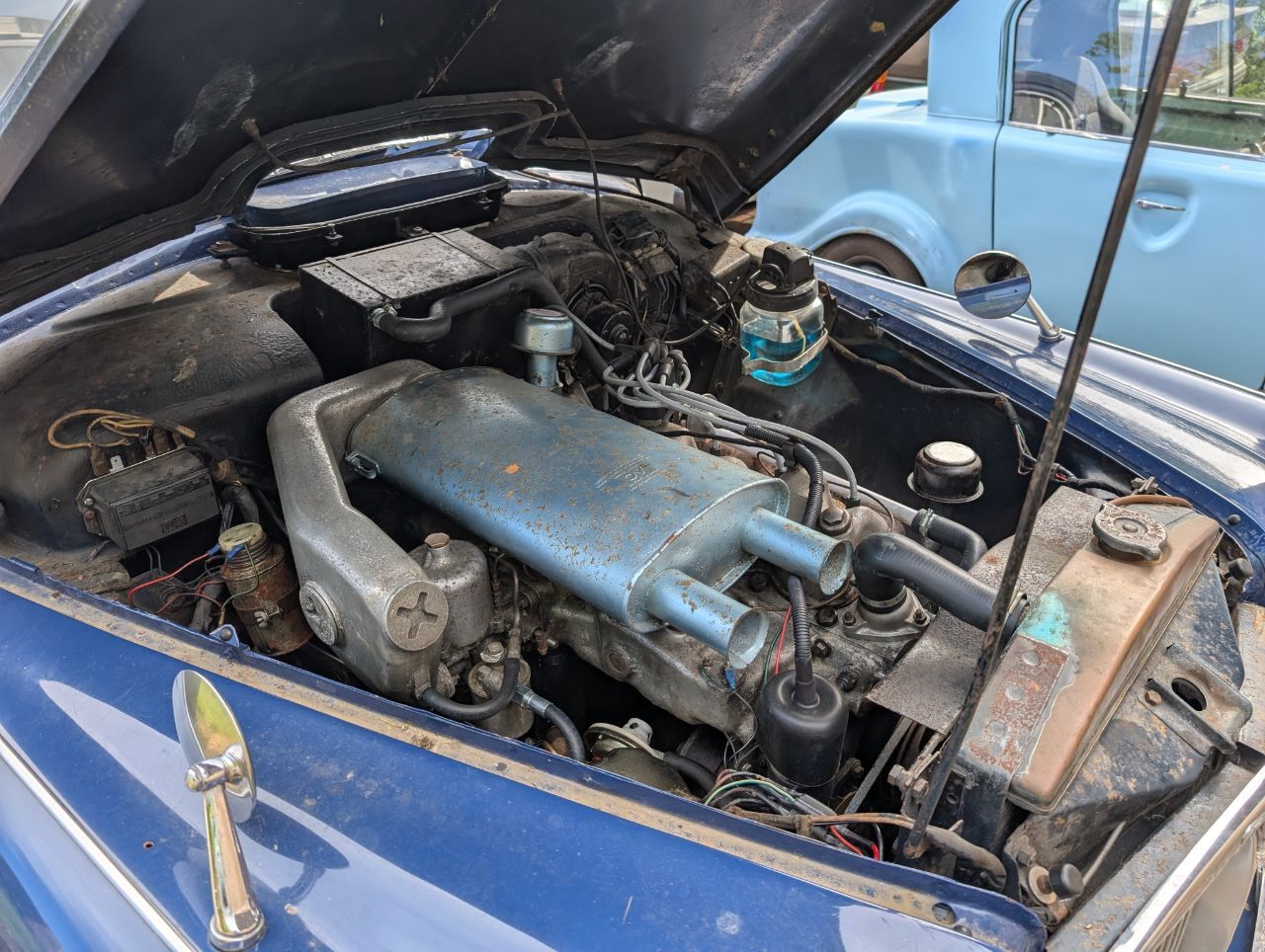

Quite a milestone has been achieved in that all of the bits of engine are now back in the engine bay rather than the boot.
I am having to sit on my hands to stop me seeing if that air intake duct would polish up nicely...
Only thing I found that I'd forgotten was the bracket for the return spring on the carb.  Which is no big deal given that said spring is currently MIA anyway.  Honestly the return spring on the linkage does a fine job anyway.  It's primarily there to ensure that if the linkage slips that the throttle plate will still return to the idle position.  The one that was on there when the car arrived was far too strong and made the pedal really heavy to the point it was really hard to have any fine control over it.  I'll chuck the bracket back on (it's about five minutes work) next time I'm in the area and keep my eyes out for a suitable spring.
We then went out and drove around our neighbourhood (so never more than a couple of hundred yards from home!) for about half an hour probably driving the neighbours mad with conspicuous straight six noises.
Findings.
[] Engine is definitely running far more smoothly.
[] Coolant temperature stayed right where it should be.  Even once we were done I could remove the radiator cap without there being any noticeable pressure there.  Previously this would have resulted in a foamy brown geyser if the engine had been idling for about ten minutes, never mind under load.
[] Steering is waaaaaaay better.  It's still vague, but it's vague rather than "bloody terrifying" as we started out with.  I reckon the wheel alignment could maybe do with a slight tweak to improve the self centring a bit, but it's entirely driveable now.  It was legitimately alarming as it was.
[] Brakes definitely need attention.  There is definitely something not right.  They do stop the car, and pretty evenly even.  There is just way too much travel in the pedal and the rears are dragging.  Handbrake is also totally absent.  That's the next major thing on my to do list.

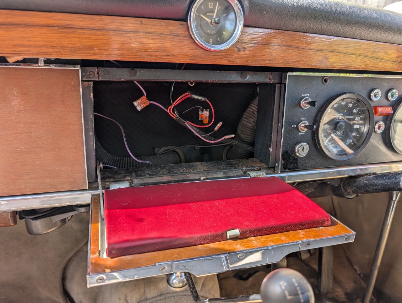

[] Centre glove box lid needs a latch.
Preferably before it gives me yet another heart attack by dropping open as I release the clutch.
I need to make a tweak to the arm which limits how far it can drop to stop it hitting the gear lever when in 1st or 3rd.  There wouldn't originally have been a cover here as that's where the radio was, but I actually quite like the idea of being able to completely hide a modern double DIN stereo with properly integrated navigation etc behind that door.  Seems a nice balance of quality of life improvement while being able to completely hide it away like something in Lady Penelope's Rolls Royce when it's not in use.

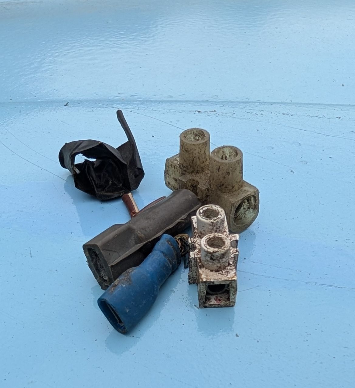

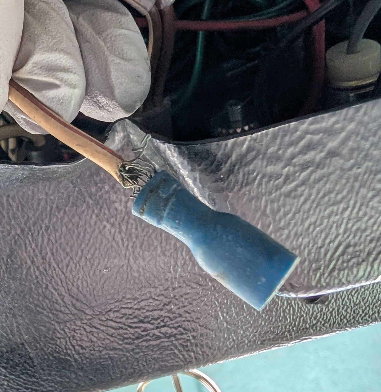

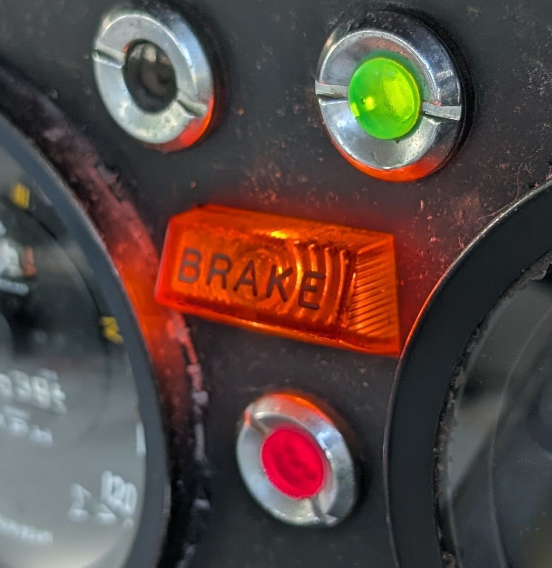

Not going to get much time this weekend it looks like, but did sort the intermittent brake light on the dash yesterday.  It worked maybe one time in five.
This wire just being stuffed into the terminal rather than being actually connected had a lot to do with that I suspected.  It was just floating around in the engine bay when I got the car.
New terminal was crimped on attached to both wires and it now works properly.
Now I just need to make the actual brakes work properly.

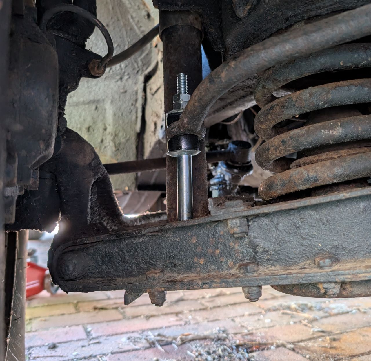

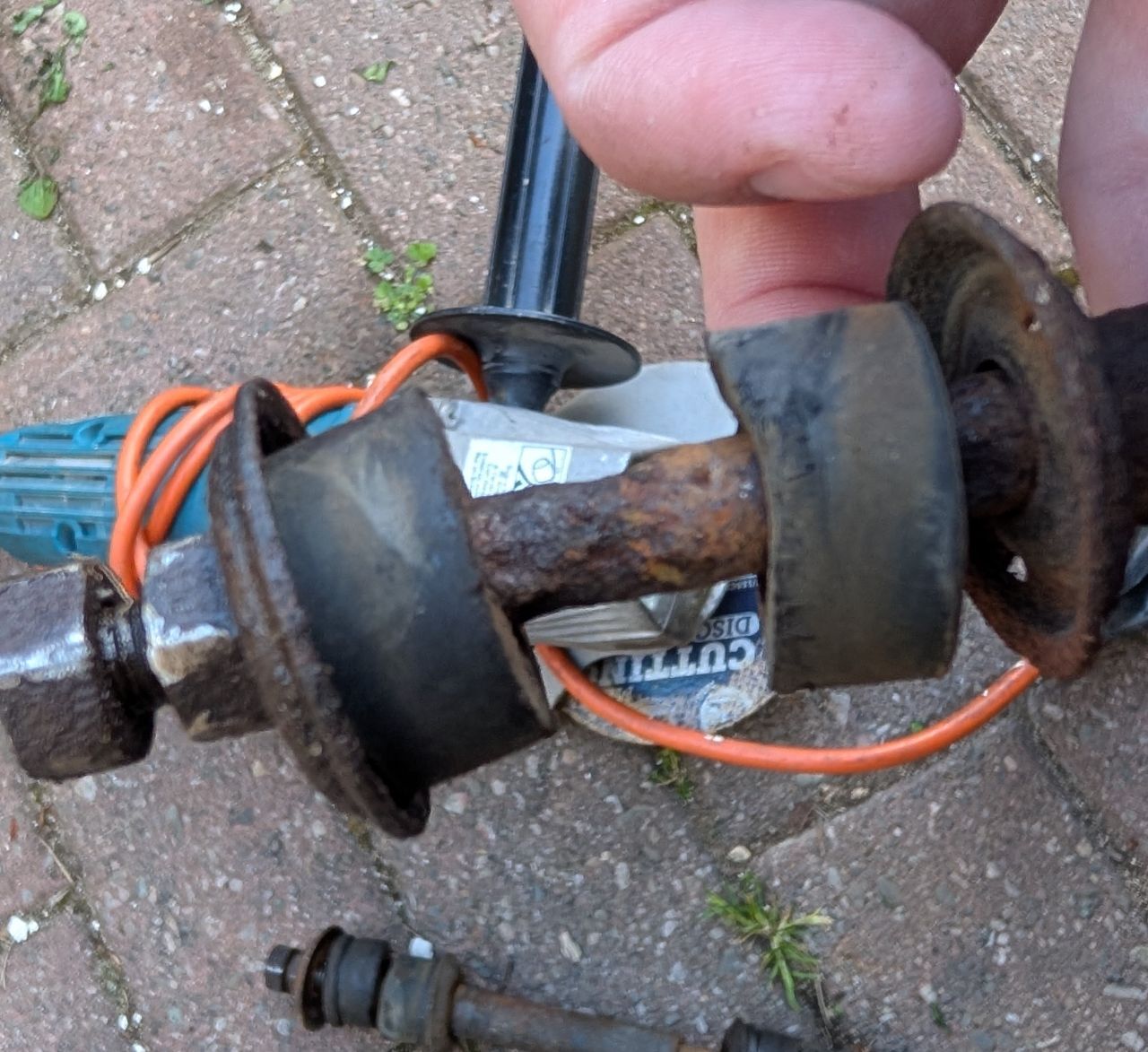

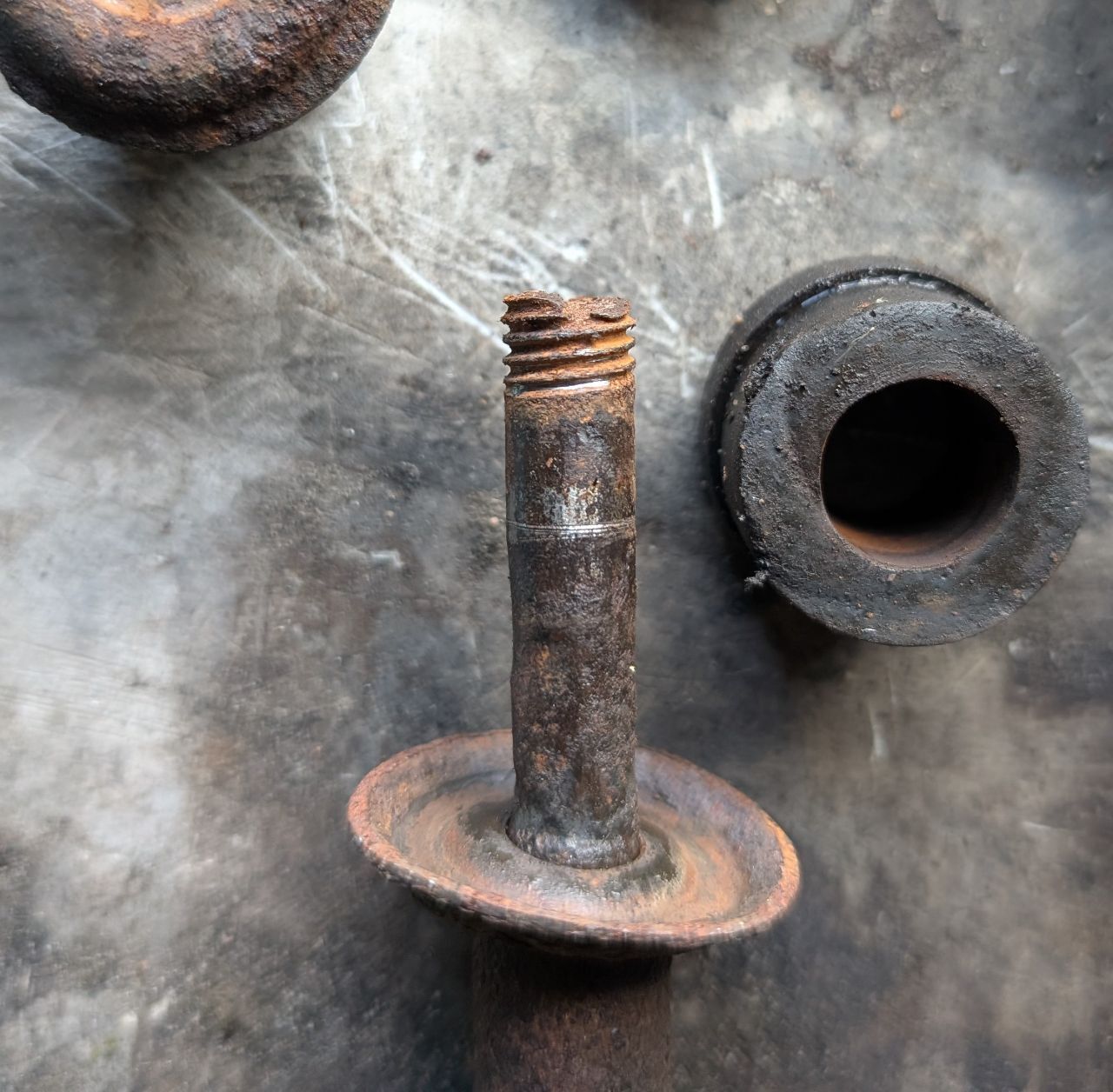

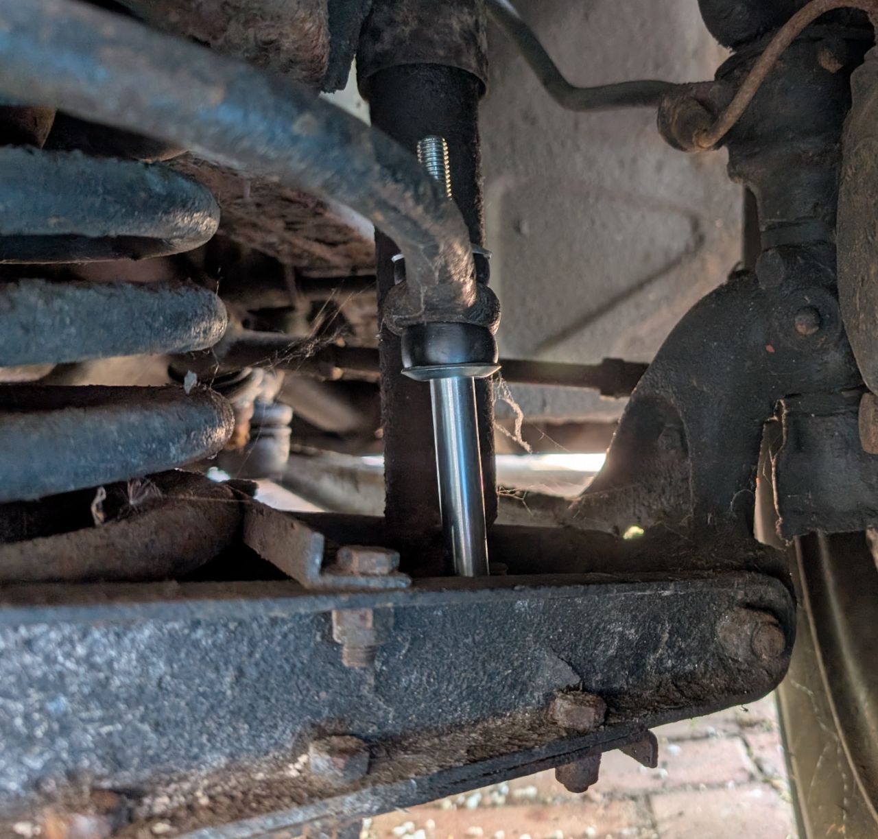

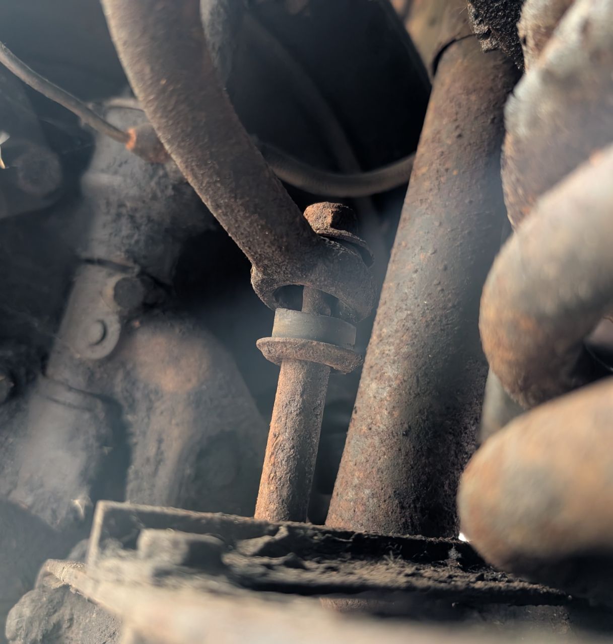

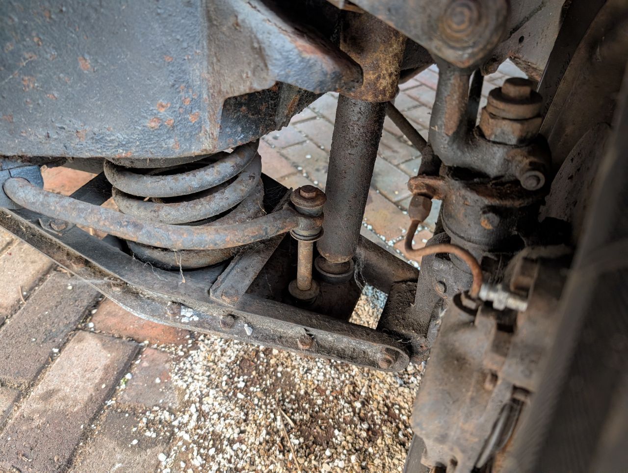

I think we may have found something responsible for the god awful clonking noise from the offside front of the Rover.
The entire upper drop links bush having escaped maaaaaay have something to do with it.
The nearside one is all there but has about 1/4" of play in all directions.
Discovered while I was in the area that a whole bunch of the bolts holding the spring seat into the lower arm were basically finger tight.  Yep.  I stand by my previous comment that I need to go through this car end to end to find nonsense like that before something critical falls off.

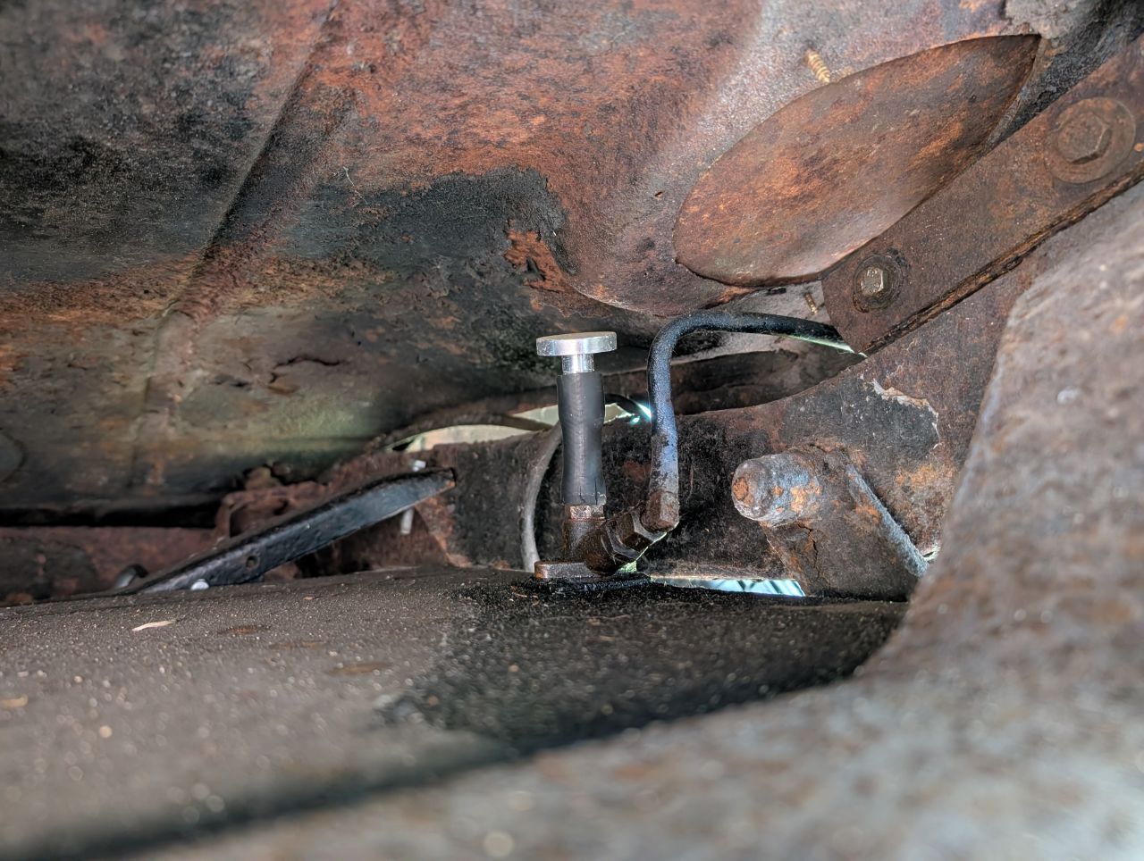

Also have ascertained that the reserve fuel pickup line is plugged - albeit not very well.
I'll need to get in there with some non-decomposing fuel line and clamps at least.
I am hiiiiighly suspicious of that loose looking bolt in the background as well.  I didn't notice that in person and am not sure what it's supposed to be holding in place...it obviously needs checking out properly.

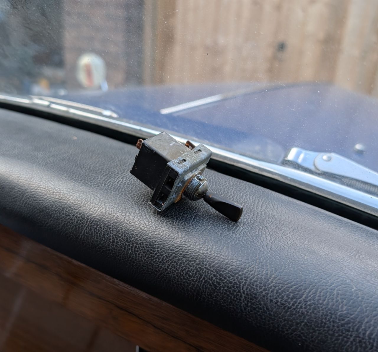

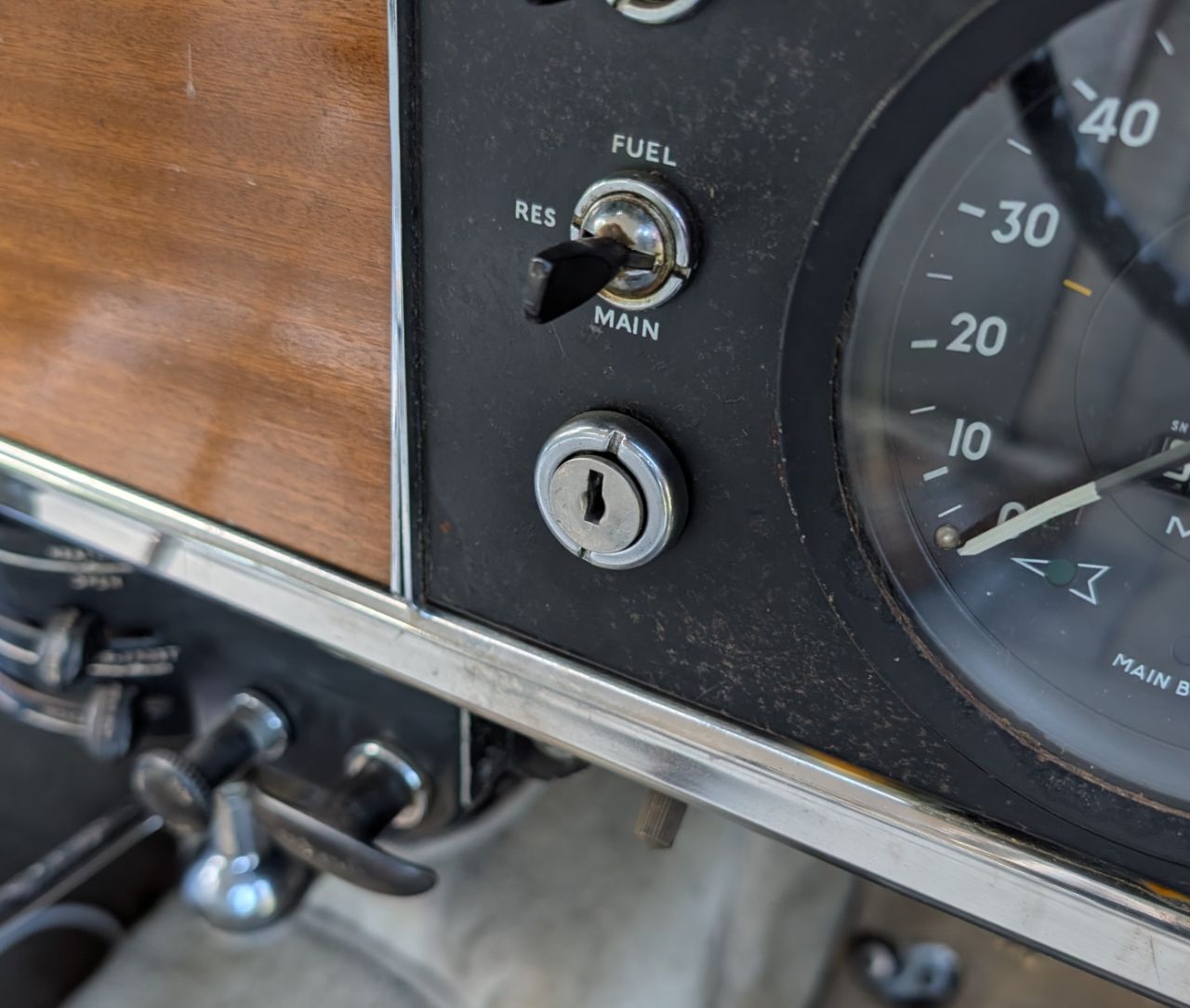

Speaking of wiring etc, pulled the fuel/oil level switch out today so hopefully I can pull it apart, clean it up and get it working again.
While I was poking around behind the dash I also sorted out the wobbly ignition switch.
Can't really tell from the photo but the issue there was that the nut behind the panel was too loose so the securing ring was running out of threads before it clamped the thing against the panel.  Wish all fixes were that quick and easy.

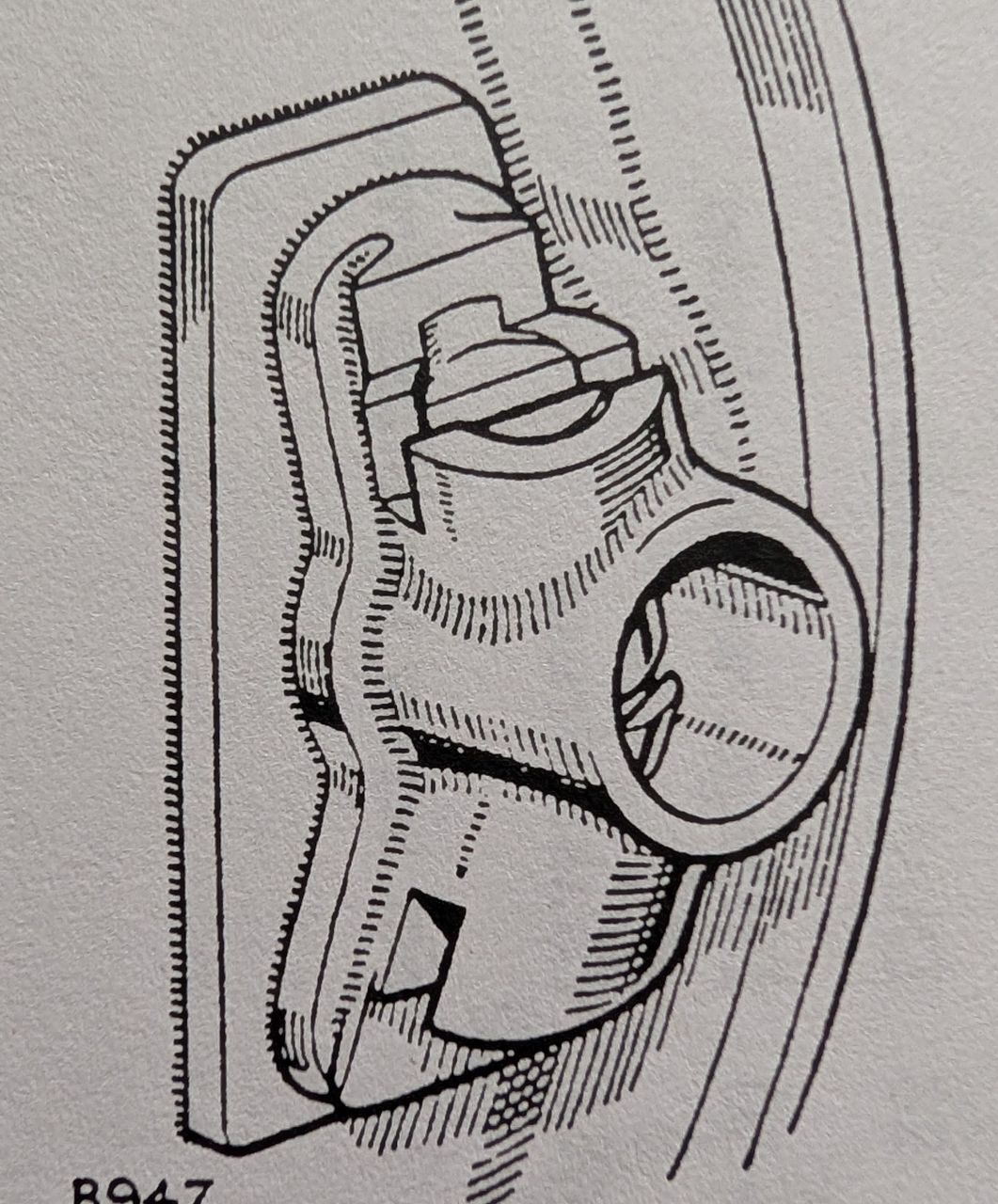

Your centre glovebox appears to have the original latch, have you tried bending the spring bit further down to improve it? It that doesn't work I think I have another spring bit in my spares you can have.

The latch is on the door of the glove box, but there's no corresponding striker for it on the dash as the cover is a later fitment filling the hole left by the removed radio.  I'm probably going to keep this arrangement as it allows me to completely hide a modern head unit behind the door, so I need to sort that.  For now though a firmly wedged piece of card will do if a proper solution isn't forthcoming.  Or just chuck the radio back in for a couple of weeks I guess as it's only a couple of screws.

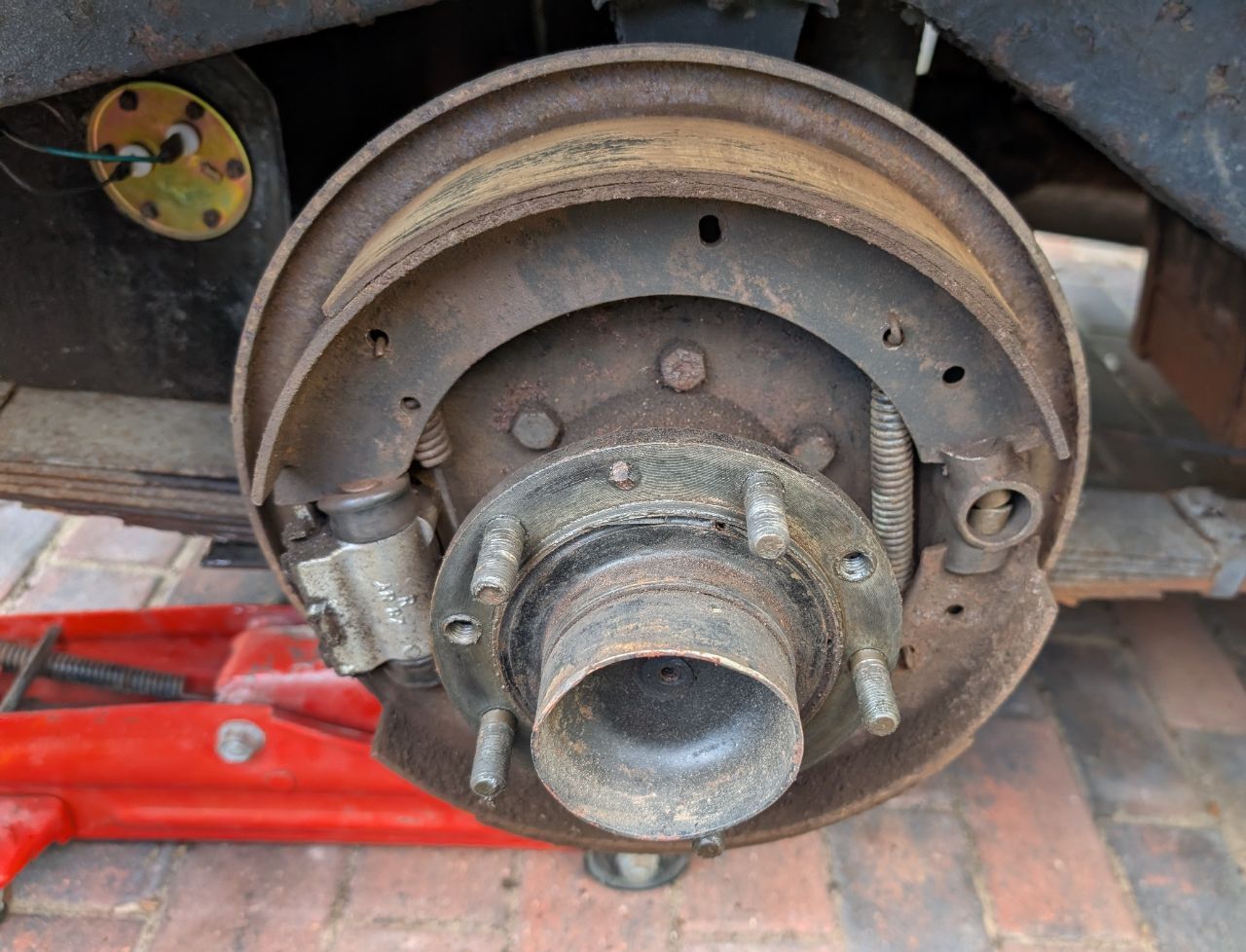

Brakes are.  I got stuck into those today.  Offside rear off - pleasantly bodge/disaster free.
The adjuster was wound all the way off.  I thought this side was binding, but the drum just slid straight off once I pulled the retaining screws out, so I look to be wrong there.
Handbrake mechanism and piston all moved freely so all looks good there.  The drum could do with a good clean up but I'm not doing that dry as asbestosis ain't fun, and the shoes are a bit glazed.

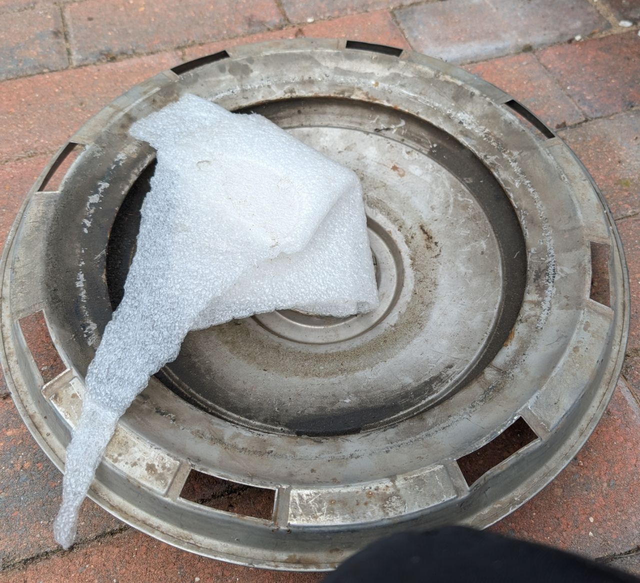

Other side did present an immediate surprise when I popped the wheel trim off (in addition to it smacking me in the face).
Apparently the cup shaped bit in the middle of the hub has come loose here and this was a solution to stopping it from making a racket.
This is simply labelled "extension piece to aid wheel changing" in the manual, so looks to be non critical.
I did for a fraction of a second have a moment of wonder of "Jeezus, is that foam holding the half shaft in?!?" but thankfully it seems to be innocent aside from stopping a rattle.
This side I couldn't get the drum retaining screws out - I'll need to get the impact driver out and give it a shot as I didn't want to risk stripping the heads with a normal screwdriver.
In contrast to the other side, the adjuster here was wound on waaaaay too tight.  About a turn and a half off got the wheel rotating again, so it was adjusted about right then left alone.
The handbrake still does precisely nothing - though everything seems to move freely, hopefully just needs adjustment.  Ran out of time before I could get to that at lunchtime.  Maybe later.
Pedal definitely feels better based on driveway testing - though the pedal itself and its linkage to the master cylinder also needs adjusting.  As does the one for the clutch - see also my comments about a lot of things just having been seemingly chucked together to get the car driving to sell.  I've doused everything in that area in Plusgas again as I remember the adjusters not being impressed with the idea of movement when I last tried.  Probably wouldn't be the worst idea to bleed the brakes either (if the bleeders will move...) as there could well be air in there - though it doesn't feel like it to me - the brakes *feel* fine, the pedal isn't spongy, there's just too much free travel before it does anything.

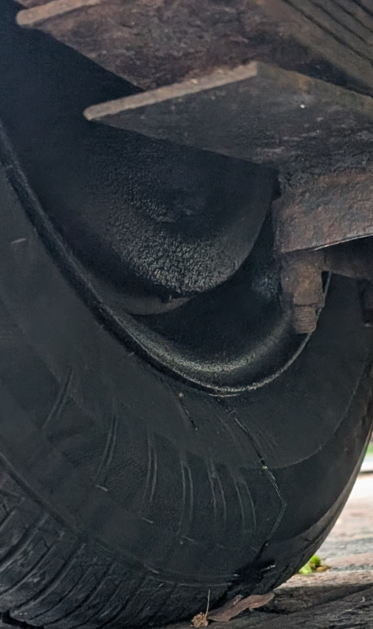

That suspicious loose looking bolt I found the other day but the offside rear wheel apparently is just way longer than it needs to be and is tight.  So whatever it's holding in place (fuel tank?) isn't going anywhere.
Hoping I'll get half an hour later to tweak the handbrake adjustment and see where that puts us.

These came off.  Surprisingly they did just unbolt even if they weren't exactly enthusiastic about it.
I was fully expecting to have to take the grinder to them.  I don't think the bushes had been doing anything for a good while based on the fact that a good half of the actual shaft on the drop link had been eaten away on both sides.
The "bushes" on one actually just seem to be random bits of rubber that were vaguely the right size too and are way too soft as well.  It appears that the top had broken off the same one and someone rather than change it just tapped the very top of it and jammed a metric 17mm nut on there!
Guessing that may be why it didn't have the original bushes in - as there wouldn't have been enough length available to get the nut on.
Much better now.
The locknut for the nearside needs to be retrieved from where I dropped it into the spring seat.  There's a lovely void in there to capture things - I managed to drop a socket in both sides and spent several minutes fishing them back out.
This seems to have got rid of the horrendous clonk from the offside and sproinging noise from the nearside at least when rocking the car by hand.  Haven't road tested it yet though.  Drop links were definitely dead and needed to be done though so wouldn't have been helping anything.  ARB mounts themselves look fine though.

Increasingly looking like the Rover will just be staying where it is over the weekend.  Had a little more time to investigate the brakes this afternoon.
I've found two problems with the offside rear.  The handbrake return spring on...what I'm terming the actuator block (the thing bolted onto the wheel cylinder that works the handbrake) is missing.  No 24 on this diagram.
Which I'm sure won't be helping things.
I'm also pretty sure that I have the wrong pistons in the adjuster as they do not sit parallel with the end of the barrel like in the illustrations in the manual.
No idea if they're just swapped around top to bottom (failing to picture in my head if they're identical or not) or if there's a mishmash of parts from each side in there.  Guessing between these issues that's likely why I'm having such a hard time getting the adjustment right.  The handbrake does operate on this side (in terms of it stopping the wheel rotating by hand anyway) but unsurprisingly isn't keen on releasing until you poke it given that spring is missing.
Still haven't got into the nearside - the drum securing screws *really* don't want to come out.
Also noting that there's a leak at the nearside rear wheel so likely I've got a leaky axle seal.  That will be fun, never had to change one of those before.
It smells like gear oil and feels too slippery to be brake fluid to me, so pretty sure it'll be a stuffed axle seal.
Given I've most likely got oil contaminated shoes on the nearside, the offside ones look pretty worn and I need to take everything to bits anyway it seems - just going to order and fit new shoes.  Given the discs look like hell, going to just change those as well.  Ones on there might clean up, but if I've got to pull it apart I'll keep them on one side and potentially they can be future spares.  Likewise going to change all the flexible lines as they're definitely not in their first flush of youth and I'm not convinced at least one of them isn't at least partly swollen internally as the brakes seem to be slow to release.
I *am* going to have a go at bleeding things though to see if that at least improves the pedal action - and if I'm changing hoses I'll obviously need to get the bleeders loose anyway so may as well make a head start on that.  Realistically though, unless it causes an absolutely miraculous improvement, the car isn't going anywhere until I've been through the system end to end.  There's absolutely no excuse for taking chances with brakes.  Hoping for a quick fix by adjusting things (even though they clearly were well out of whack) really was wishful thinking.
Would have been nice if it was that easy, but it is what it is.  A bunch of new hardware on there will at least mean I know everything is tip top then.
I think they should be flush with the adjuster fully unwound, or the heel of the shoe won't back off all the way - but that may only be an issue with new shoes. Tha missing handbrake spring is more of a problem
IIRC they are handed. The slot that accepts the brake shoe is not in the same plane as the ramp at the other end, and they do need to be fitted the right way round.
Aaaaand the Trabant has decided to manifest a vibration/rumble at speed.  Great!
Of course it has immediately decided to deluge on us and won't stop until after I'm out of time to investigate.
Had a quick look this evening and not really found any smoking gun.
There's definitely a bit of play in the nearside rear wheel bearing, and I noticed when looking that there's actually a pretty decent buckle in the same wheel.  Also spotted that there's a bit of play in the steering on the nearside though I need a helper to see if I can pin down exactly where that is.
Will get the hub nut nipped up on the nearside rear tomorrow (it is a bit loose though still held in place by the locking tab) and see if that helps.
I guess the worrying possibility is that it's something in the gearbox letting loose, but it feels more like it's something from the back than front to be honest so I don't think it's that.  So watch this space I guess.

Only had literally ten minutes to look at anything today.  Sticking my head under the dash in TPA I think may have revealed a likely candidate for electrical power randomly dropping out.
Two very crusty chock blocks, one of which is only actually connected by a few strands of copper oxide - on the main supply to the ignition switch.  The other crusty connector is on the line to the starter.
I'm honestly baffled as to why those wires were even cut.  It's all of a couple of inches from the end...so seems unlikely that it would be to replace dodgy terminals, and if they wanted to splice in something needing a feed from there... there's a spare terminal on the back of the ignition switch anyway so you could just plug a spade terminal on there.
Shouldn't be too bad a repair, assuming there's actually wire there to connect to anyway.  Hopefully that will put an end to our random electrical drop outs.
  • Zelandeth changed the title to Zel's Motoring Adventures...Volvo, Renault, Rover, Trabant, Invacar & A Sinclair C5 - Updated 20/05...
Turns out those choc blocks weren't even tight...so likely were doing very little.
However our fault persisted - there was a fault in the splice between the two wires in the factory spade connector.  So that then also got snipped out.  I didn't bother recreating it as they go to a twin terminal on the ignition switch so I just have them each their own spade there.
I then also noted that the Ignition switched line looked like this.
This is what ended up in the bin.
We do now at least have a working ignition system again - if it remains reliable remains to be seen.  I do have my doubts about the switch itself.

Bit later in the evening I did a bit of poking around on the Trabant.  The only real thing I'd noticed was that the nearside rear hub nut was a touch loose.  I think it has been for a while as I didn't want to over tighten it originally in case it was a taper bearing (it isn't).  Whereas the correct procedure is to do it up fluffing tight and then lock it.  Which is what I did - albeit somewhat awkwardly as I *still* don't have a socket big enough for the hub nut.
Then took it out for a spirited test drive for about half an hour.  Definitely didn't notice the very distinct noise/vibration from last time we were out.  It honestly sounded like I had a wheel with loose nuts or similar, it was quite obvious.
Guessing that there was just enough slop there that combined with the buckle in the wheel (which I wasn't aware of being a recent issue) was allowing things to shimmy a bit.  Slack taken up and normality has resumed.  Doesn't seem that anything is getting excessively warm - whole 2C temperature difference between the two.
Drum on this side was 34C, other side was the warmer one.
Hopefully that'll be the end of this one for a while.  I do want to get these wheels changed to match the front though.
