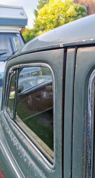

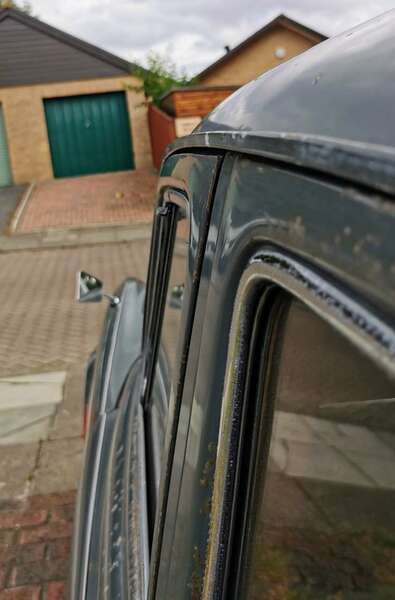

Also had a look at the passenger door.
The issue is clear to see here.
The top of the door sits the best part of 1/4" too far out.  Which now I've noticed a very distinct gouge directly above the trailing edge of the door and paint flaked off the gutter I almost wonder if the door top has been bent by someone breaking in (or attempting to).
The whole upper edge sits too far out though, which means that most of the leading edge sits proud of the gutter.
The result of this being absolutely horrendous amounts of wind noise.  It is honestly quieter with the passenger window open than closed.
Here's the driver's side for comparison.
That door has dropped slightly through wear so doesn't contact the seal along the top edge very well, but it doesn't make an undue racket.  The passenger side is horrendous though.
There doesn't seem to be any adjustment range left in the hinge setup, so I think a bit of brute force may well just be needed here to convince the top of the door to sit closer to where it's meant to.

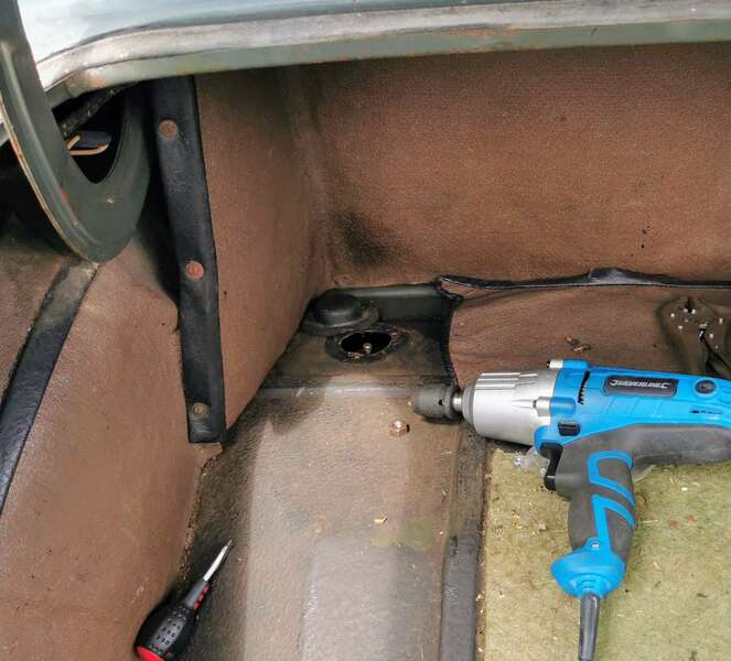

Things I discovered yesterday:
1. Those doors are bloody sturdy.
2. The bottom hinge isn't actually bolted to the door.
I suspect that may be part of my issue.

The passenger door on the Rover I discovered only had one loose bolt in the lower hinge rather than three.
Having properly secured it down there has definitely helped.
Still sitting a bit further out at the top edge than it should be, but a lot better than it was.  Wind noise is still far worse than the driver's side, but is less deafening than it used to be.  So progress.

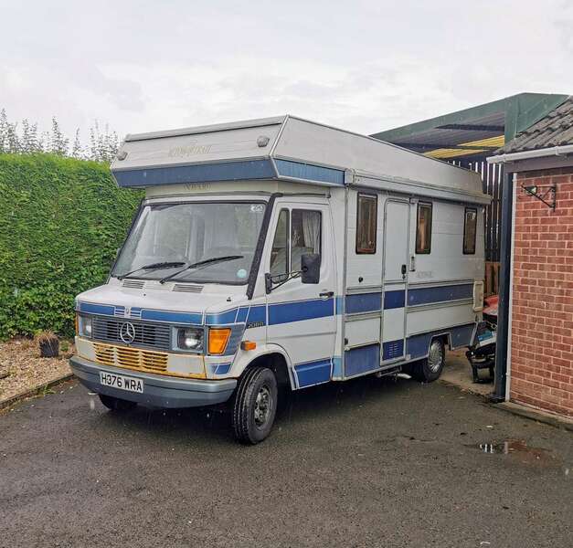

The van has been delivered to its new home with @RichardK as of yesterday.
Very much mixed feelings, though I still think moving it on was the right decision logically.  I just hope she behaves half as well for him as for me.  Really hasn't been a needy vehicle in the last five years at all.
Having a covered but well ventilated area to live long term I think will definitely help the odds of the van continuing to exist too, given the whole water ingress being the biggest killer of coach built bodies like this one.

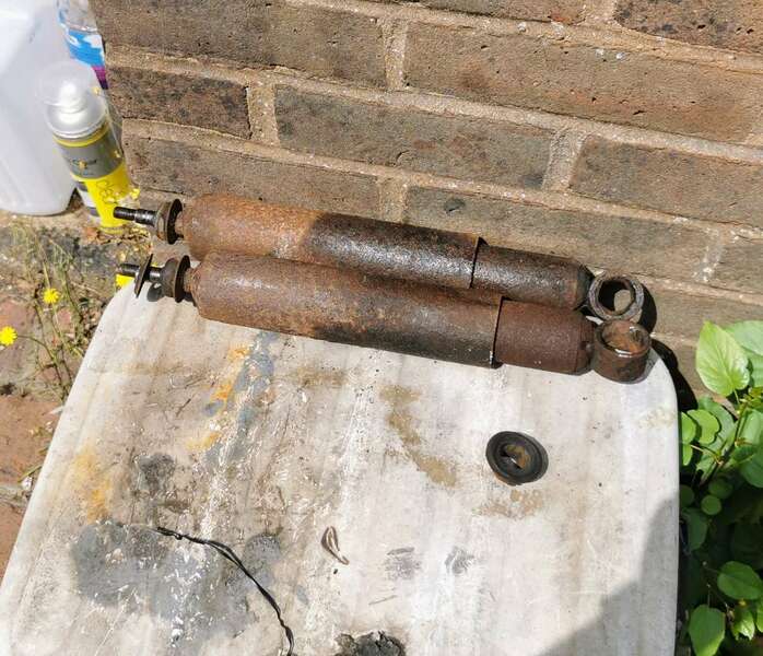

I've also got one of the shock absorbers on the Rover swapped.
Got to be one of the easiest cars to do this job on.  Only slight headache has been the whole upper housing spinning on the nearside one, but I've found the vice grips now at least so can deal with that next time.
The one which came off is utterly knackered.  Providing absolutely no damping whatsoever in one direction, but is virtually impossible to move in the other -  if I stand on it, it will compress over the course of about a minute.  So that won't have been doing anything any favours.  It feels based on the old fashioned "bounce test" that there's a lot more movement on this side than the other.
Will hopefully get the other one done tomorrow and will see if that's helped the ride at all.

Other damper now done.
How did I get anything done before I bought an impact gun?
Impact spun the nut straight off without having to bother clamping the top part of the shock in place or anything like that.
Again it was a ten minute job.
Just like the other side this one was providing absolutely no damping in one direction but far too much in the other.
This hasn't fixed the issues with the ride being horribly bouncy, but has definitely helped.  So the springs are definitely binding up I reckon - really isn't anything else involved which can affect things.  The feeling is that things are over-damped, it's like driving a HGV without any cargo on board.  The springs themselves could well just be tired as well.  I haven't *seen* any cracked leaves, but I've never had the rear jacked up with the wheels off yet.  That might be a job for the weekend if time permits.

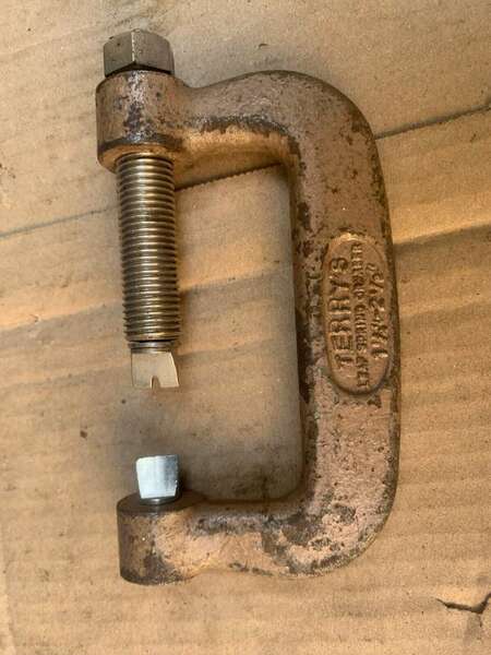

1 hour ago, Tigerfox said:
You need one of these spring greasers
Every day's a school day.  I never even knew such a tool existed until now.
I have one somewhere. If i can find it I will lend it to you.
The one in the photo is on ebay at present
Spring greaser - added to the mental list of cool tools I may never need!!
It separates the leaves so you can insert grease? New one on me as well.
Wow, I never knew about leaf spring greasers either - did you end up buying them? I have often pondered if I should be oiling mine but couldn't think how to introduce it between the leaves so just resorted to spraying them in GT85.

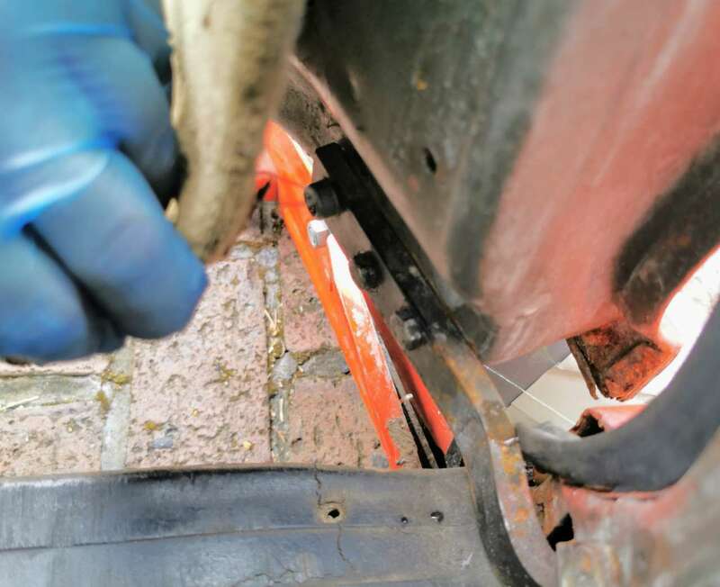

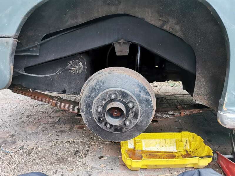

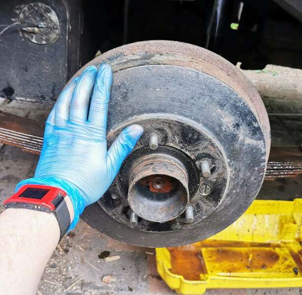

Later in the afternoon it was time to take a closer look at the springs.
Those are some chunky brake drums.
At one point in time these wraps around the springs would have been useful.  Sadly that time is long past and they were simply holding in a considerable amount of mud, grit and rust.
So I've scraped all the crud off and given everything a good slathering with engine oil and have left it to soak.
Nothing broken I can see at least.  It really does need to come apart to be properly cleaned and greased long term though.  If we could get it to something resembling an acceptable state in the meantime though that would be nice!
By the way, yes there is an axle stand just out of shot under the frame.
Service manual for mine shows a shirt/tie clad engineer using what looks like a Hydragas unit to forcefully squeeze grease between the leaves.
C clamp with a hole through it and a grease nipple would probably work as well.
Does the leaf pack have a couple holes underneath on the lowest leaf? Would look like it's for drainage, but that's a grease point usually.
Nothing like that on these.  The manual specifically mentions splitting things to clean and lubricate.  One of those tools to separate the leaves enough to pump grease in though should be a decent compromise.
