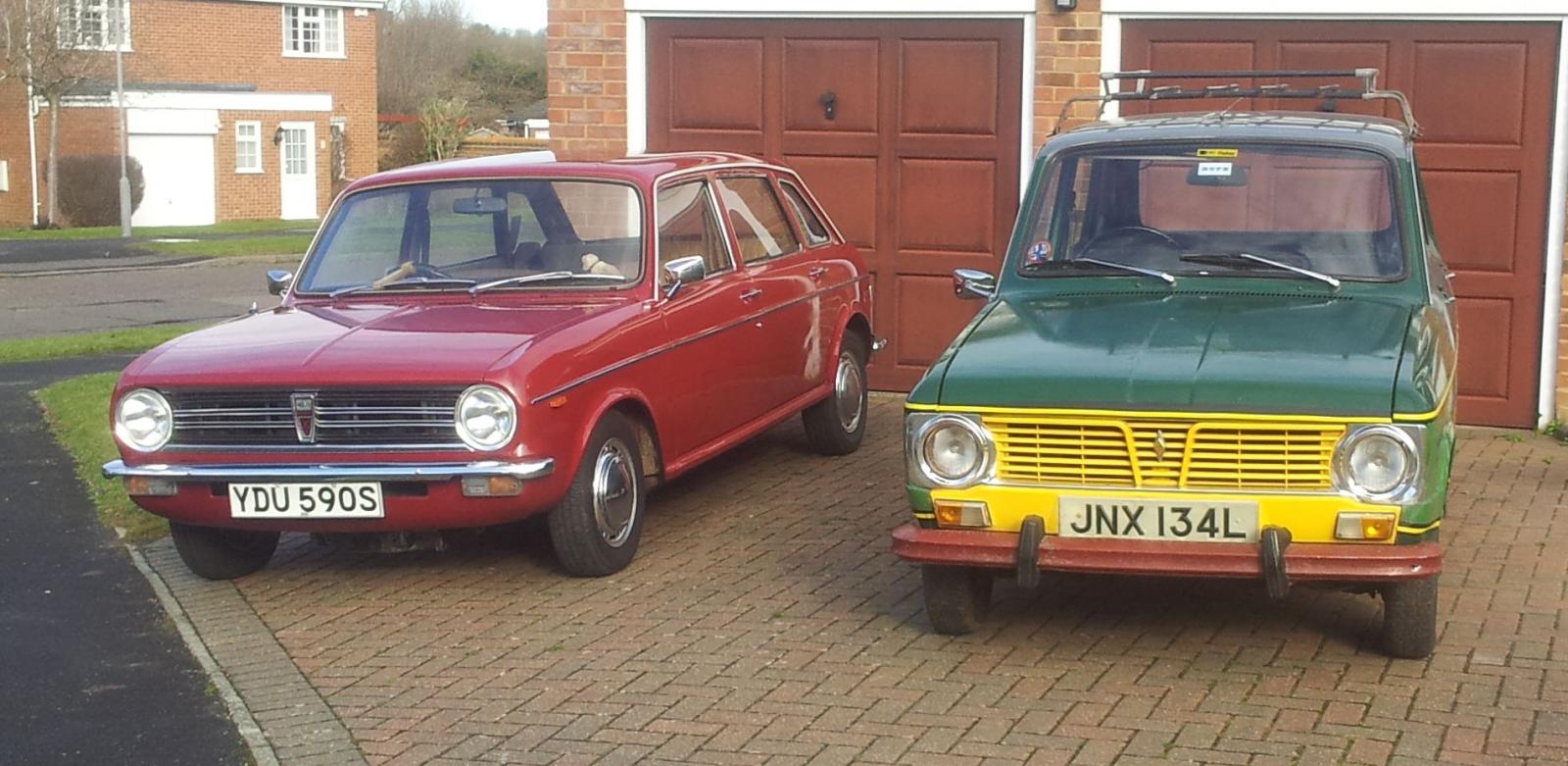

So it turned out the wheel bearing had been delivered to a neighbour and he brought it over the other night. It's been fitted and this happened - outside for the first time since August. Still doesn't run but the brakes work and it's looking good. Anyone recognise the hubcaps?
The year is 1978, right?
No one had brick paving in 1978.
Still liking the paint scheme on the R6!
Much as I like period authenticity I think replacing all the block paving with concrete slabs or (god forbid) gravel just for a photoshoot is a step too far. :-D

That colour scheme is so utterly shit and random, it somhow becomes utterly brilliant. If it were mine im not sure i could allow myself to change it, even if it would definitely improve it. Its fantastic.
