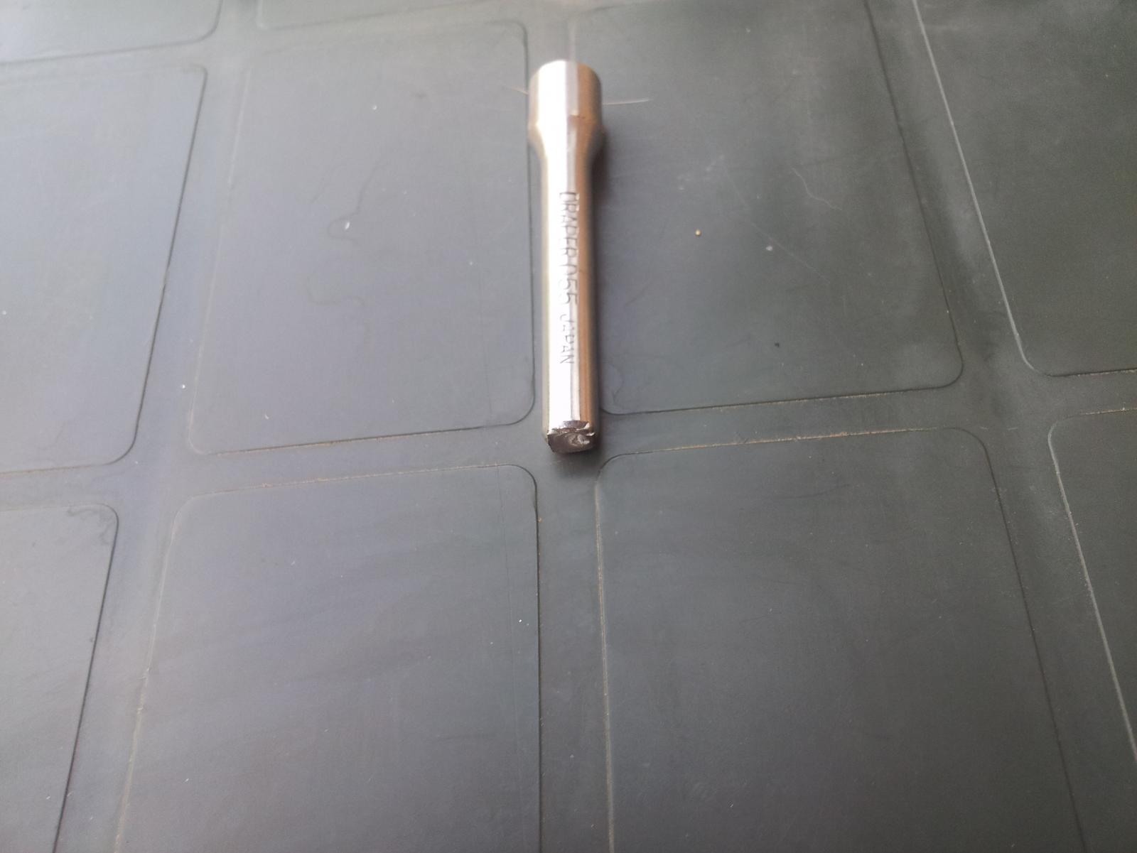

Have you sorted out a special tool yet? I ask as I've acquired a surplus 14mm socket and could bodge it onto an extension with the electric pritstick and post it to you in the interests of this thread continuing to offer forum winnage..
Thank you for your kind offer but, more importantly, for resurrecting this thread and reminding me how remiss I have been with the Bob project. I was astounded to see that the last update was in May, over three months ago.
The enthusiasm for this has been at rock bottom for a while now and I have been trying to ignore it, despite tripping over it every time I go into the garage.
Unfortunately a standard 14mm 3/8" or 1/2" drive socket will not fit as the clearance above the bolts between the rockers is only about 11mm, but as a result of you pricking my conscience, I remembered that I had ordered a 1/4" drive 14mm socket, which is waisted down just above the hex recess.

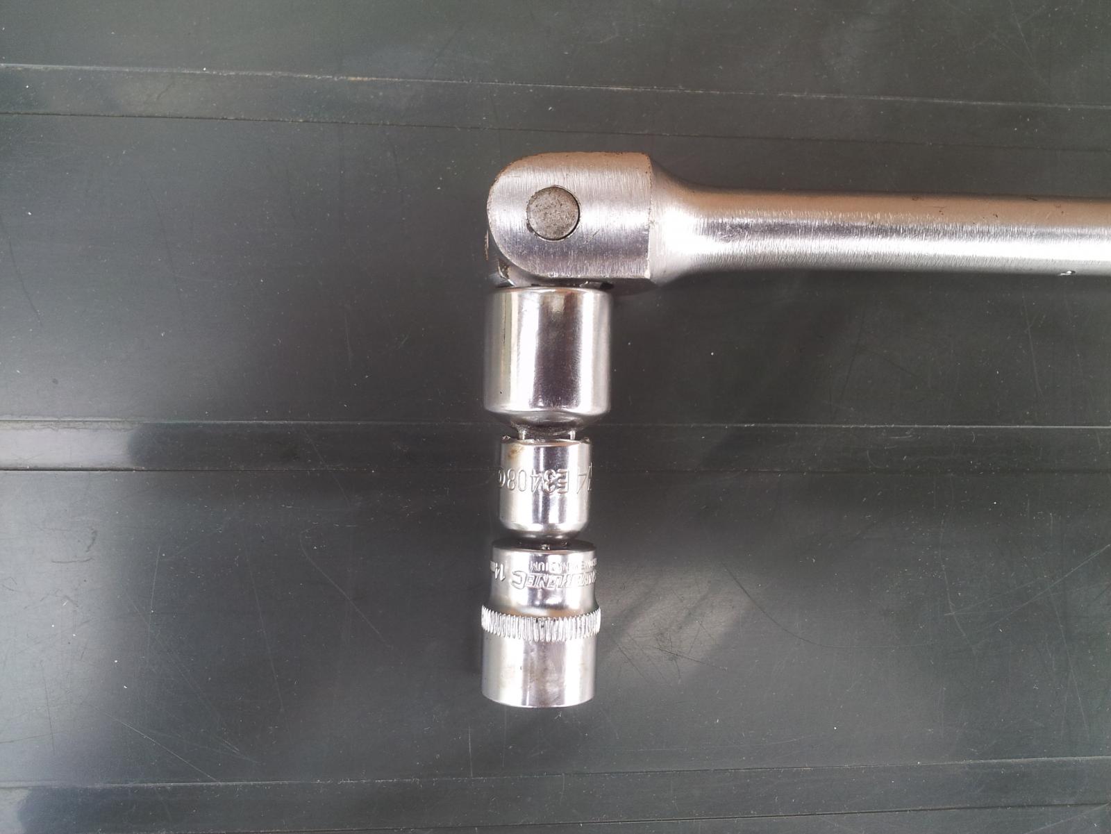

This afternoon I dug it out and managed to persuade it onto one of the bolts. First I tried a short 1/4" drive extension:
Not the desired outcome!
Draper extension just snapped off the 1/4" square end.
So I tried again:
This time: 1/4" drive waisted socket into 1/4" to 3/8" adaptor into 3/8" to 1/2" adaptor into 1/2" drive resistance-is-useless breaker bar.
Success!
Thought something was going to break but eventually, with a very loud crack, the bolt came undone.

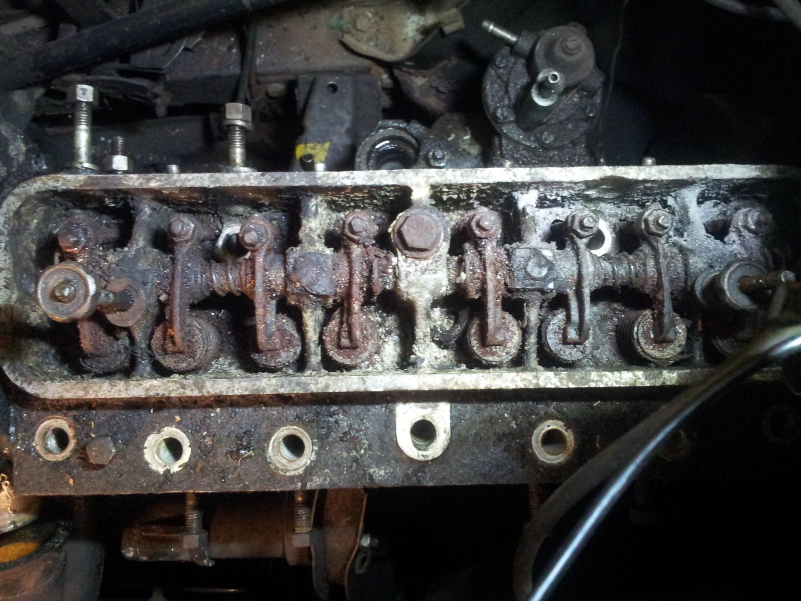

On to the next one. This time the socket would not fit in under the rocker arms. I think this was because of their position. Over the first bolt one valve was open and one closed, hence the rocker arms were at different heights, but over the second bolt both valves were closed, hence the rocker arms were both at the same height.
Judicious use of a grinding stone in a Dremel soon saw a couple of millimetres ground off the inside of the head casting in the appropriate place (visible top right of photo below) and CRACK! the second bolt was also undone.
Job done, you would think, but not entirely.
The bolts could now only be undone a couple of turns with the socket before it jammed on the underside of the rocker arms and could not be removed. So more fiddling required with long-nosed pliers and fingers on the (now loose) bolts. But eventually all the head bolts are out. YAY!
Close up of one of the head bolt holes showing the ample* space* for access:

Dunno what's been going on inside that cylinder head over the years, but that looks pretty fucked. Rather you than me!
