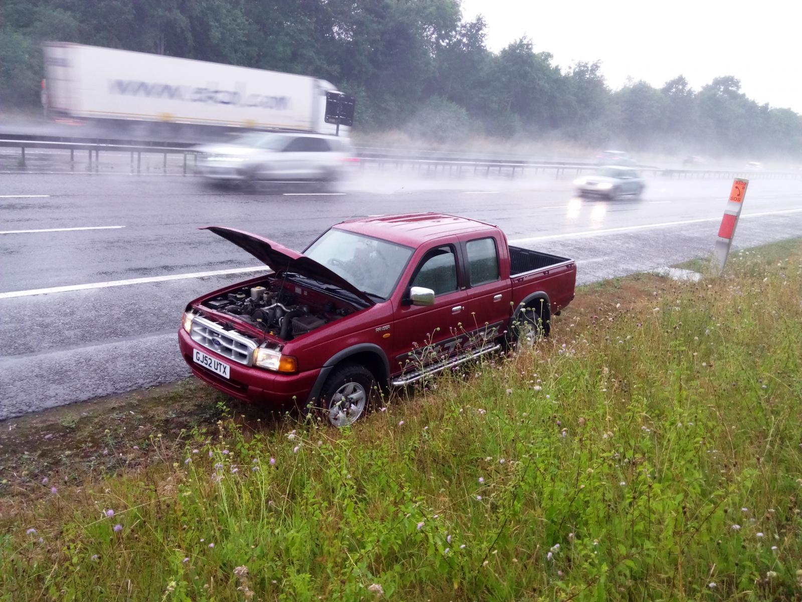

Dave's collection fail.
It's shat out on the M5. I'm in frankley services between j3 and j4.
Bummer.
Traffic was savage and the temp went into the red and started chuffing coolant out the overflow. If I keep it at 50 mph or less it's ok but as soon as I speed up or climb a hill the temp shoots up. Probable head gasket.
If anyone has ideas I am all ears. I have uk RAC cover but what they going to do? Tow it to Aberdeen?
I can probably nurse it onwards from here as long as I keep speed down. I can't sit here forever anyway due to the 2 hour time limit.
Help.

Might be as well to call the rac in case it's something they can maybe fix like a non running fan out stuck stat.

Oh shit. Wish I was close enough to help. Possible it's boiled and got an airlock - let it cool, raise expansion tank (if it has one) and refill slowly, find out what's caused it to cook - if it's got an electric fan, hotwire it?

This happened to me in my old Cav SRi once, when I was about 150 miles from home. My solution was to fill up as many containers as I could find with water & continue on my way, keeping the speed down as much as possible & topping up with water when necessary. I then fixed the HGF at my leisure once I'd got it home.

It's only doing a couple of miles before overheating again. I limped it as far as I could be assed and am now waiting for the rac.
Great picture! where are you now?
M40 southbound milepost 130.3.
"we will send a flatbed."

That's a bugger & it looks quite tidy too.
Aye its literally perfect for me in every way. Apart from the obvious.
I bumped it up the embankment a bit. Sitting by a piss-wet motorway in the dark is a definite 0/10 would not recommend.
