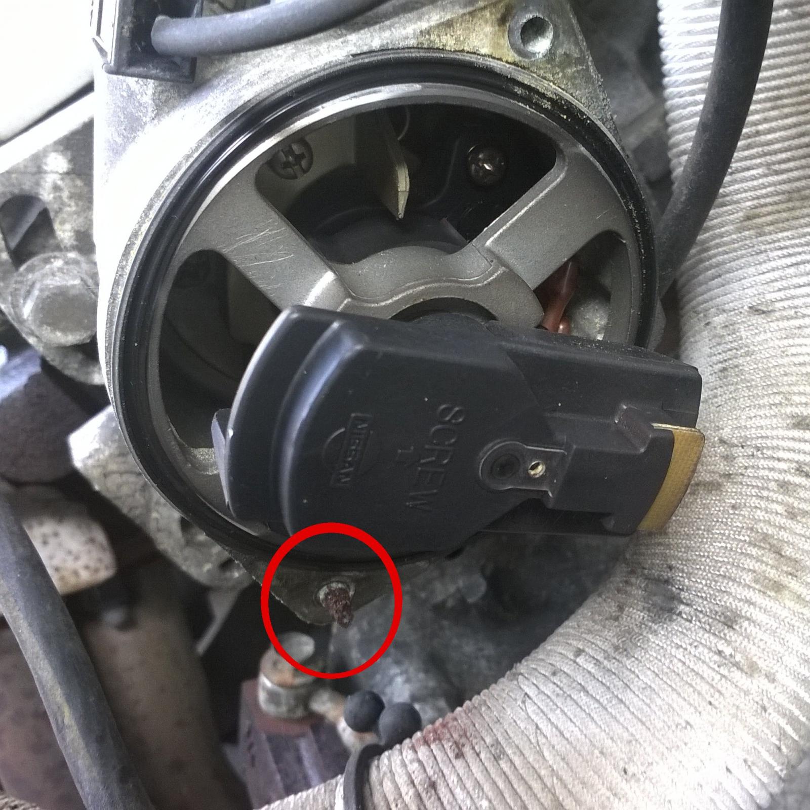

I also had a dizzy fixing snappage moment when putting a new cap on my Bluebird, solved with a zip-tie for the moment, will get the dizzy off when I do the timing belt.
Yup. Think I'll be tying it in place for now. Once I can face touching it again. I think I've at least established that I've got the leads in totally the wrong place.

Congrats for getting it running.
What was the issue, timing / distributor woes?
Having got the dizzy cap off (and breaking it in the process), I was able to re-establish where cylinder 1 was meant to be firing. Then, knowing the firing order, it was simple from there. I didn't capture the first fire on video sadly (as there have been SO many failed attempts! I may have faked it for the next video...) but it was remarkable. A short burst of starter and it just fired beautifully into life. My excitement was not faked.
The dizzy is currently held on with garden twine, and the thermostat housing needs replacing, but this is still important progress.
