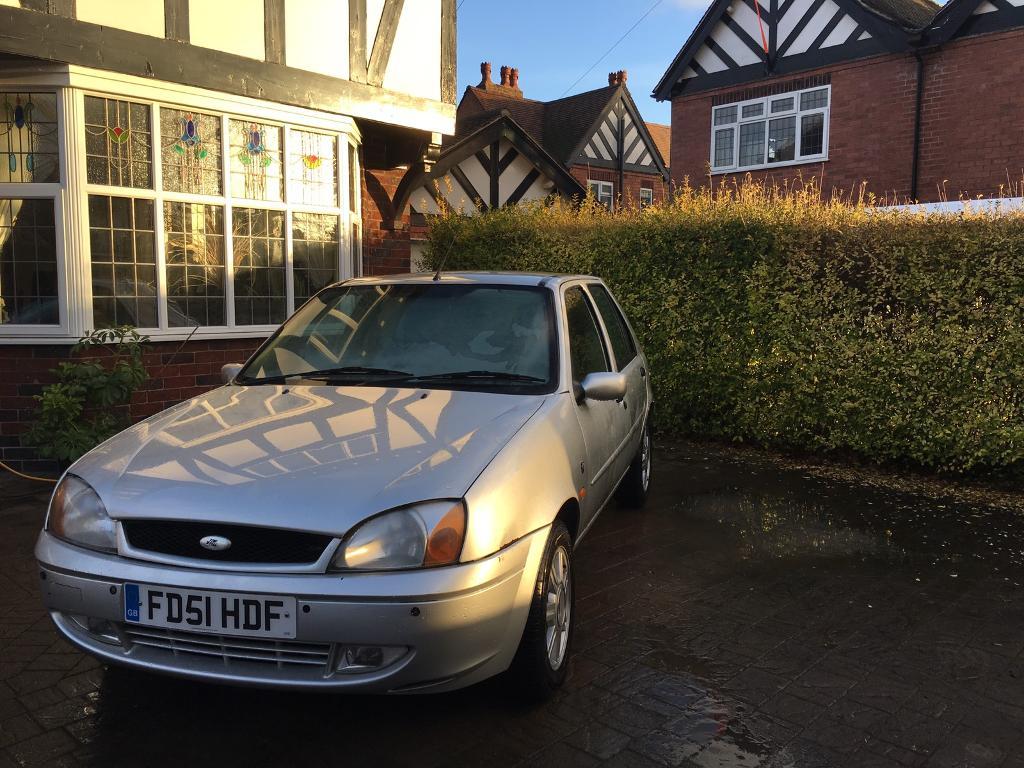

Just been and picked this up. Sorry I'm using the sellers pics as its flippin dark!!!!
Verdict is, unexcitingly, that its as you would expect a £300 fiesta to be. On the updise it seems to drive spot on and has a lot more vim than Mrs Crabs 54-plate Fiesta 1.4. No horrible clonks or grinds and it zips along very nicely! ON the downside, the EML is on, and the wooden-fronted CD player doesnt seem to work, it just says '97.9 FM' on the screen and none of the buttons elicit any response so i cant even put a code in. Does that mean its jiggered? Also the rear wiper doesnt seem to work. And the arse end feels a bit floaty, I wonder if the shockers are a bit tired or something.
However it seems like its capable of running me back and forth to work for a while till my back cries 'enough' (the seats have approximately 0 lower back support). I struggle to imagine myself spending a lot of time migging new rear arches into it but who knows, I might take a shine to it after a few hundred miles. I can certainly see the appeal of it though and kind of wish I had spent a bit more like £600 for a really nice one!!!! I will rustle up some decent pics when i get a chance.
Nice one, looks pretty tidy.  The rear wiper often stops working, either a bad earth to the bootlid/through the hinges or the motor is seized solid as water can accumulate in them.  Possibly both.

I know rear axle bushes on the KA's are a common failure I imagine these are the same. That might explain your loose back end.  They're a bit of a bastard to change apparently the last one I saw had them cut open with a 1mm disc, bushes changed then welded closed!

Well done Mr B - i'm sure you will work your magic. Rear axle as stated is more than likely the rear bushes.

We had a later one & the radio refused to speak to any of the buttons. Several soakings in contact cleaner got some life back into it.

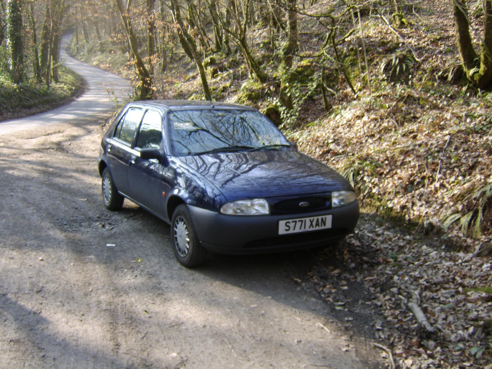

Must have been a very late mk4 then. I've got a pic somewhere, hang on
These are mk4 no?
Sad face in 95, edge face in 99. Mk5 then in 2002.
MK5 innit bruv
The sad face fiesta was the MK4
36637A6900000578-3695697-image-a-17_1468
MK5 innit bruv
Ah its Wikipedia lies. Saying that, given the amount of similarities it really should be mk4.5.
In some woods in devon
Passed an mot in 2013 then nothing since. Rip!
