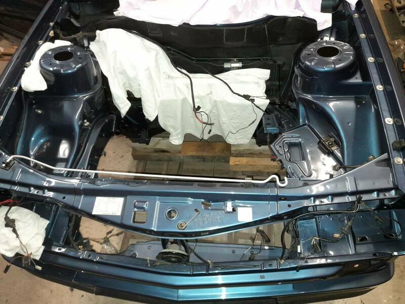

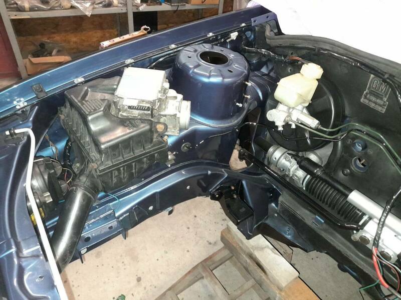

Still waiting for 8mm fuel pipe, so cracked on with stuff up front. The wiring loom was pulled through the bulkhead.
I got it all roughly in position to remind me what goes where. The plan is to clean it all and re wrap where necessary before securing it in position.

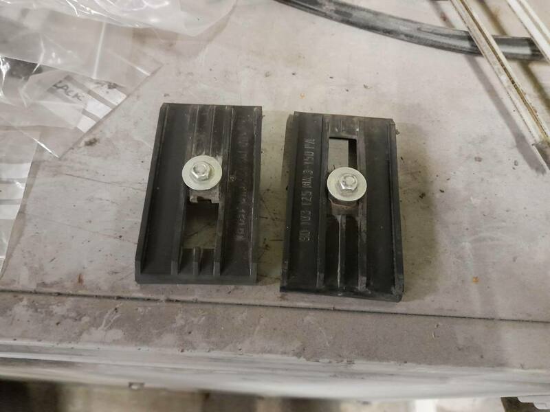

Fitted the rubber isolation blocks that the air box sits on - I found these on Ebay, size wise they're spot on.

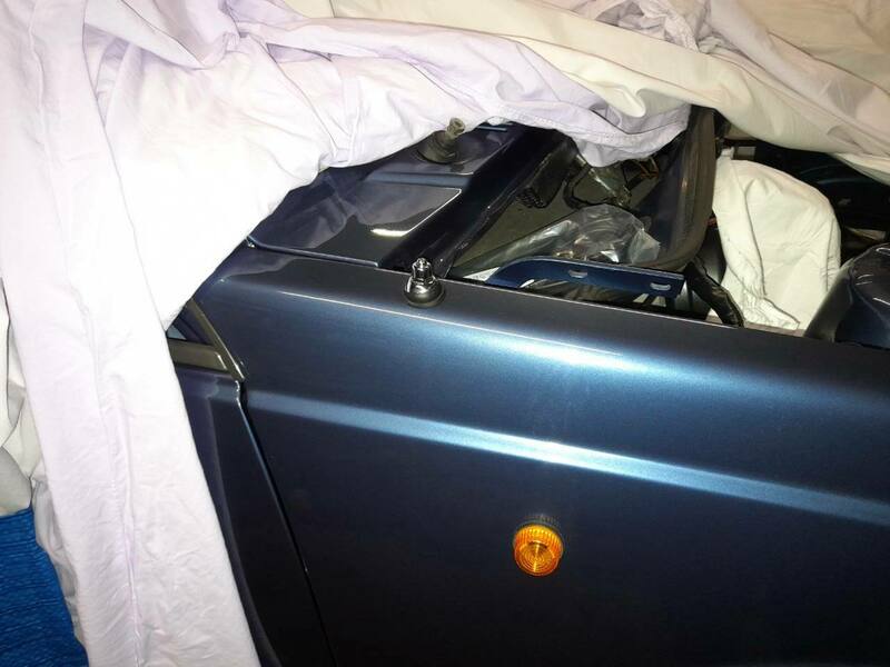

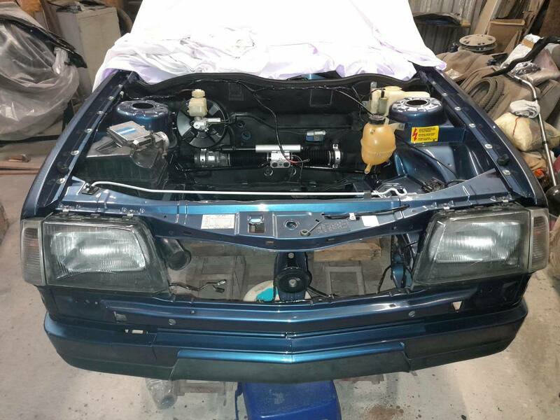

Before fettling the wiring loom, I decided to clean the headlights so they're ready to go back on. Seen below after the majority of the crud was removed with a cloth and panel wipe.
Popped one in to marvel at the annoying gap between the top of the indicator and the wing that all mk2 cavs have.
Loom fettling tomorrow.   :)
Loom now fitted and clipped into position. Assorted furniture put in to remind me how the loom goes.
Air box needs a good clean before it gets fitted permanently.

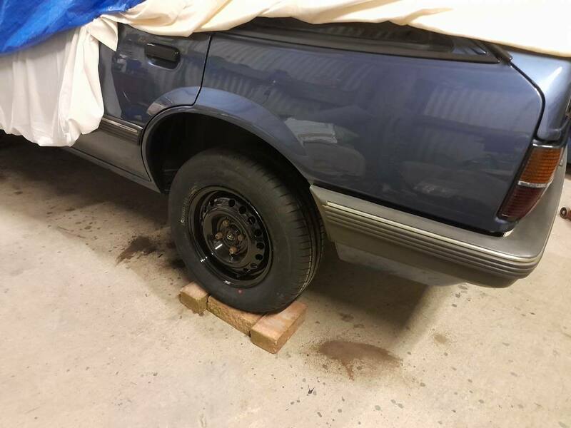

Had a look round the back end to make sure it's still there - not had the cover off for a while!

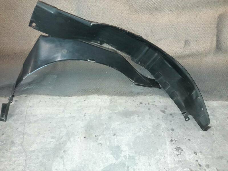

I could fit the arch liners. After a good scrub up,
they went back on. I'd forgotten to drill a new hole in the offside inner wing when I repaired it a long time ago, but it was easy to do with the liner in place to show me where the hole needed to go.

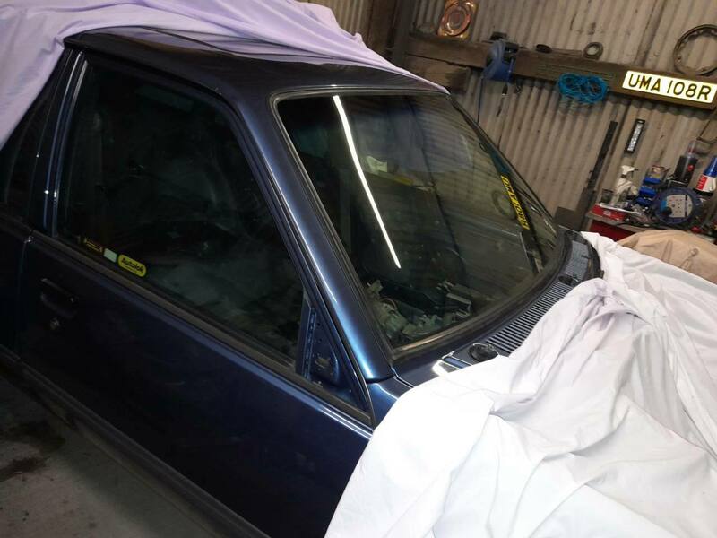

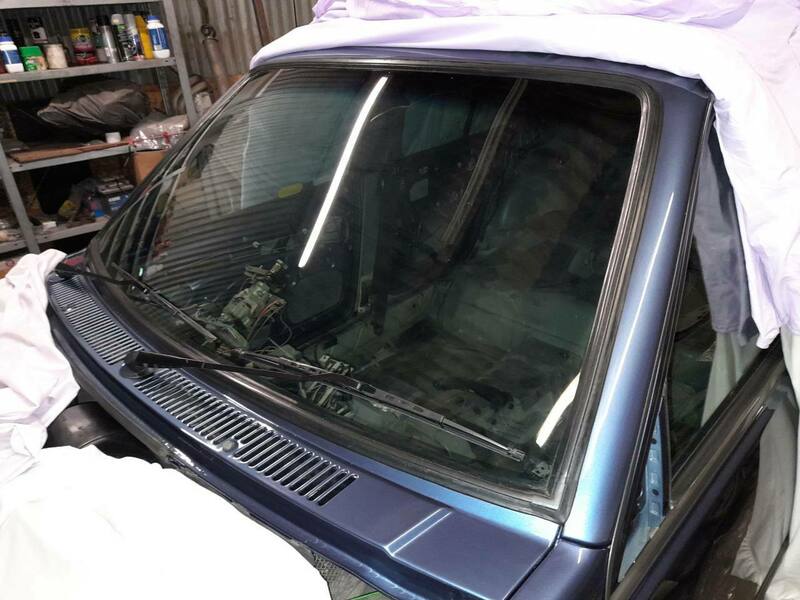

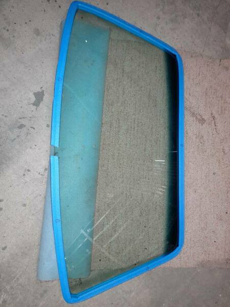

Pilkington delivered my new screen today,
It was flung in and fitted in a few minutes - I'm getting pretty good at doing this on my own now!
I'll apply some arbormast sealant and fit the trims over the weekend hopefully.   :)

On 10/22/2021 at 7:44 AM, 4wheeledstool said:
not as gappy as original mk2 cavalier headlamps with the bevelled headlamps, i bought the trims as shown in the picture (not of my car) from a CD model in the scrapyard

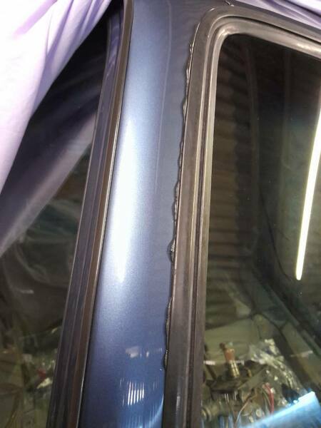

Arbormast sealant pumped into the screen rubber.
Once the trim went in, a load of it splurged out as expected.
After the mess was cleaned up, the wipers went back on to complete the job.

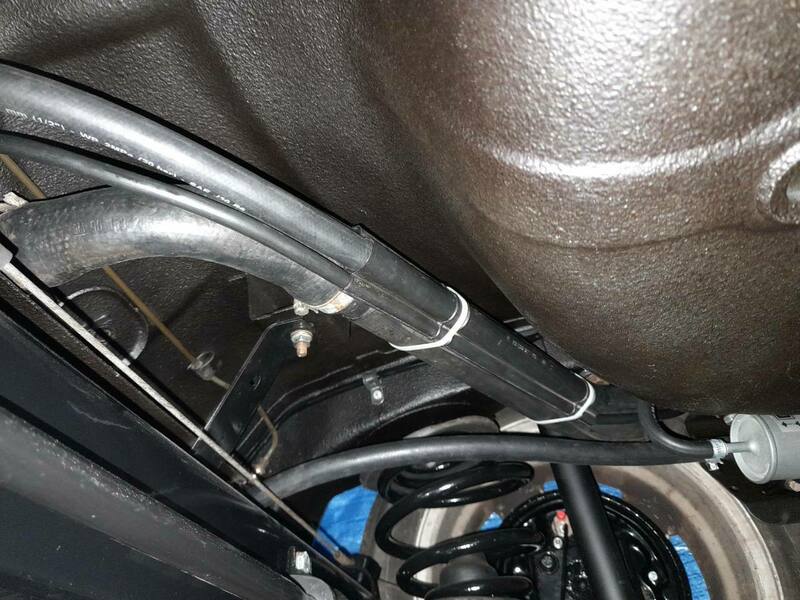

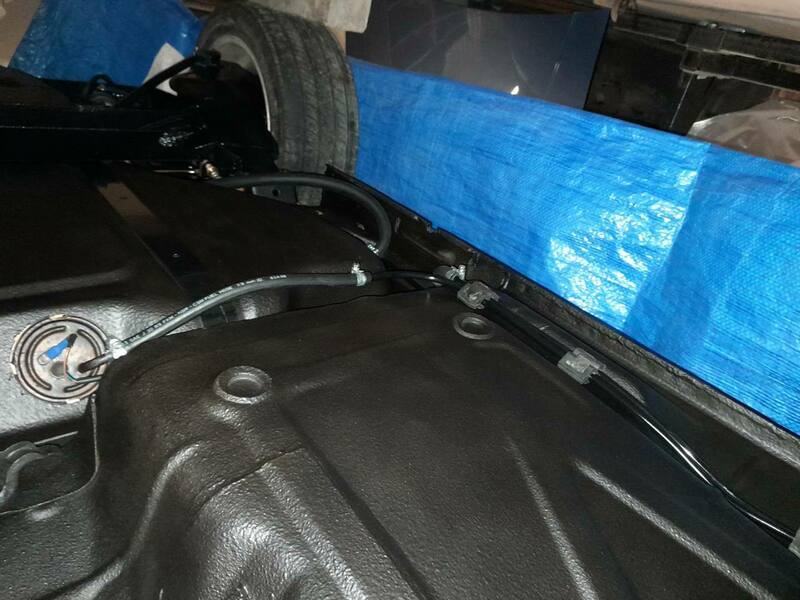

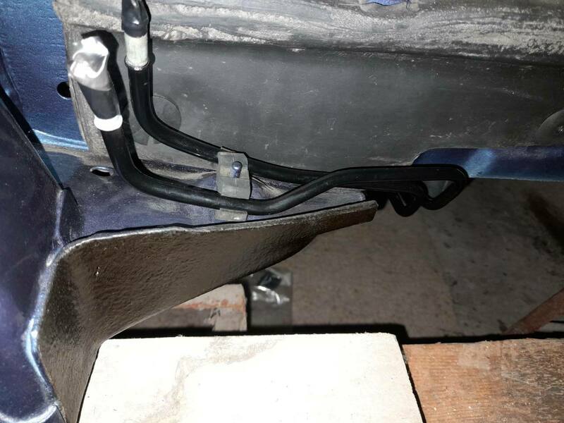

The 8mm fuel pipe arrived on Wednesday,
so made a start on finishing off the fuel system. I only got as far as fitting the fuel pump along with associated gubbins, then connecting the fuel filter to the metal fuel pipe on the chassis leg before my time was up.
I should hopefully get back on it on Sunday and finish all the fuel pipes off. Then I can drop the back wheels on the deck and get the motor ready to go back in.  :)

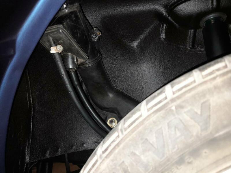

Fuel filler apparatus now reinstated.  Threading the pipes through the plastic conduit arrangement was a bit of a faff.
It's all gotten a bit busier under there.
Fuel lines all buttoned up now,
To the rear, (still need to clip the tank to pump line to the chassis leg)
Up front.
Once I've checked everything over under here, I can get the motor back in.   :)

Whilst getting the front bumper cleaned up ready to go back on, I thought I'd try the grill on.
It fits OK, but the little rubber grommets that support it on the body have disintegrated. May have to get creative here as I've not been able to find any on Ebay.
The bumper to wing brackets cleaned up pretty well, just need to fit the new chrome trim to the bumper and it can go back on.

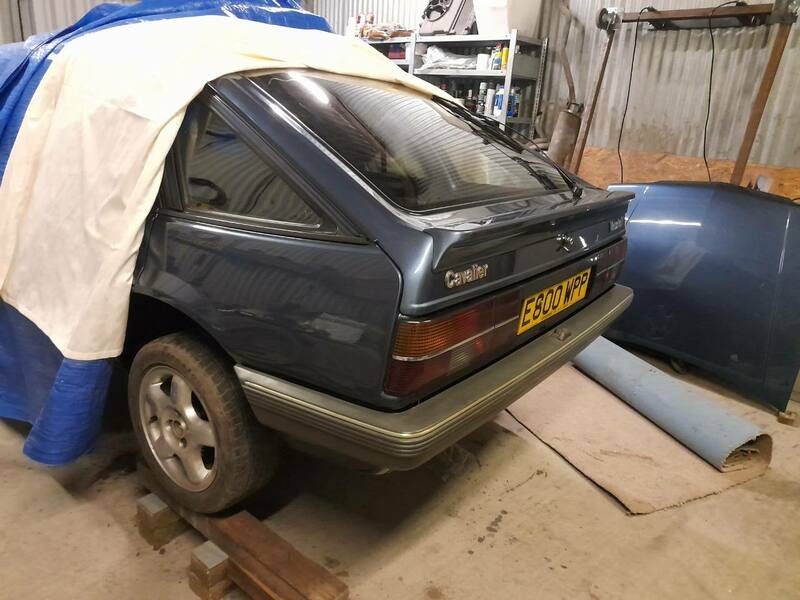

Put it's own wheels on out back, then proceeded to drop the back end down from this height,
to something a little less precarious.
Should hopefully get the front end raised up, and the engine and gearbox back in over the weekend.    :)

The windscreen.  Is this a rubber sealed screen, or is it a bonded screen where you have added rubber seal sealant under the bonded screen rubber seal?  I've often thought that would be a good idea - I have an Astra which had a new bonded screen fitted and the fitter didn't do it that well - I suspect it isn't easy - and the rubber seal is decidedly loose.

The screen is an old fashioned rubber seal type. It was filled with goop at the factory (same as the mk1) so I figured that it must have been necessary. Both cars had pristine screen frames, so it must have kept the water out pretty well.

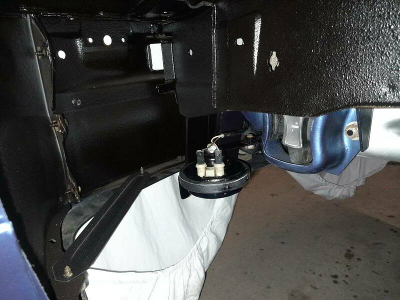

The engine mounts were all tightened up first, then a few smal under bonnet items went on before the radiator, fan and coolant hoses all went back where they belong.
I was a bit too crippled to get underneath and continue connecting up pipes and wires, so I chose the far easier job of fitting the secondary horn to the nearside front gearbox mount next.

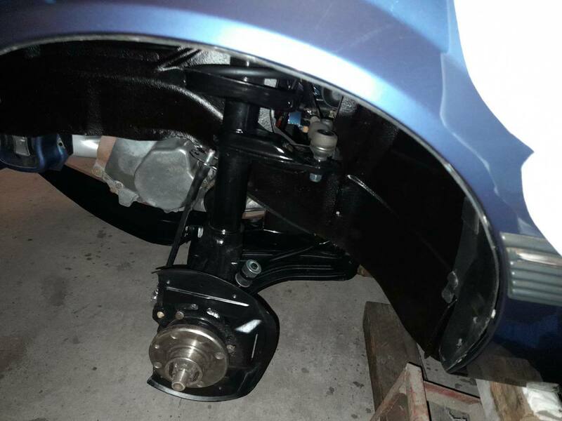

I've left the re-fitting of the engine loom for now, and got on with getting the front suspension back together. It's been sat on the four bolts which hold the centre of the sub frame arms to the chassis, so first I had to move the axle stands from there to the jacking points at the front of the sills. Once that was done, the anti roll bar was bolted on.
With that in position, the sub frame arms could go back on, closely followed by the wishbone.
Once I'd fitted the anti roll bar links, time had run out.

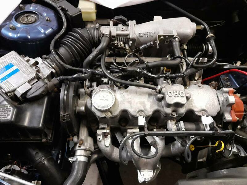

Time has been scarce this week, but I still managed to get a few odd jobs done. The clutch and speedo cables have gone back on, as has the engine loom.
I finally got round to chucking on the oil filter - it's been sat in a box for two years patiently waiting.
I torqued up the front suspension fasteners, then checked all the wiring was in the right place before running out of time.
Once the exhaust, brakes and wheels are fitted, it should be ready for firing up.   :)

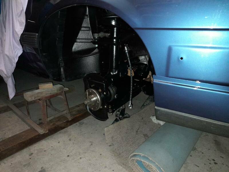

Luck was on my side today, difficult chores ended up being easy ones, so I got a couple of hours in the shed.
I checked that the caliper sliders still slid, and that the pistons were still mobile (it's been a while since my DIY refurb). All in order, so they went on with the new discs...
new pads and fitting kit...
and new caliper bolt covers.
After repeating on the other side,
I got to have a drive in a couple of my other heaps before teatime.   :)
