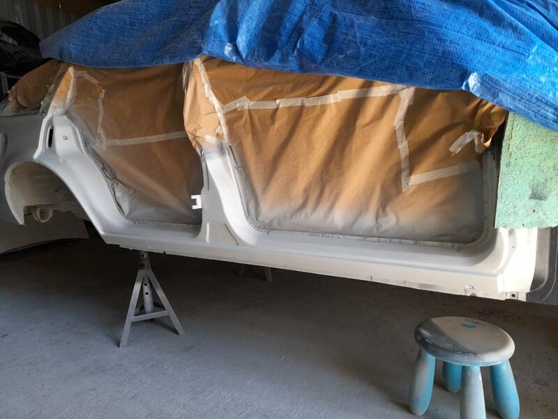

Cavalier mk2 - another blue giffermobile.
Offside was finished off today.
The nearside was given its final rub up as far as the rear quarter.

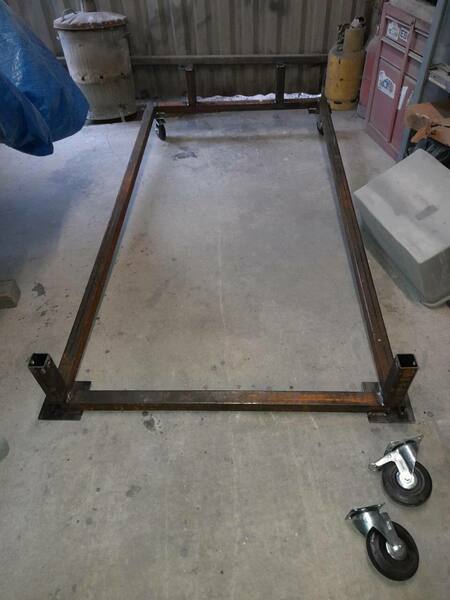

The dolly has been fabricated,  just need to shorten the uprights a little, then bolt the wheels on and the shell will be mobile.  :)

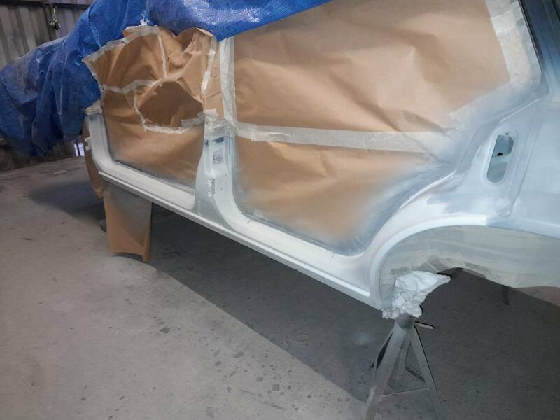

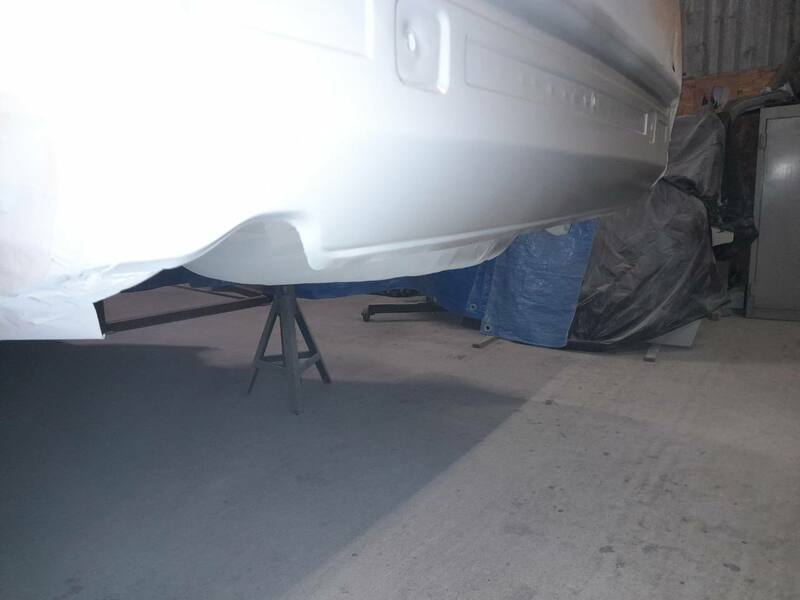

Nearside rear quarter finished off this week.
Identified some low spots in the rear valance, they were given a thin skim of fine filler.
Then rubbed and primed again.

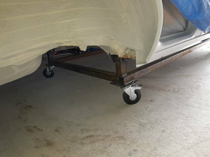

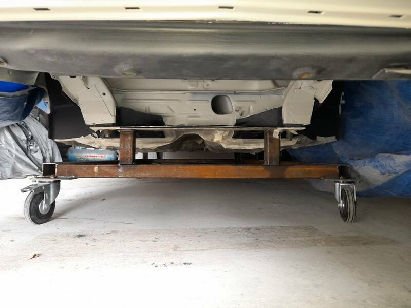

The dolly was shortened and bolted on today, surprisingly it fitted absolutely perfectly - wasn't expecting that!
After that was done, good tidy up and vacuum session happened - it was incredibly dusty in the shed.

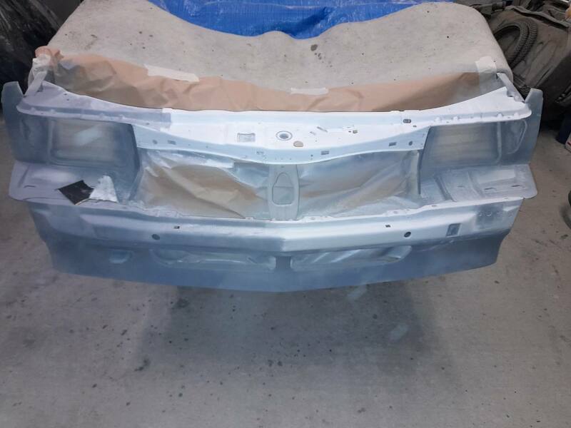

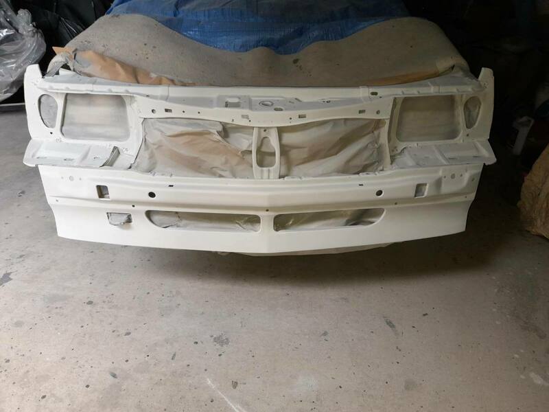

Front panels got a few skims of filler here and there to tidy up some of the welds, then it all got a good rub in preparation for another coat of epoxy primer.
I thought it was probably a good idea to finish masking off the inner wings before throwing any paint about -
This used up my available time, so I'll have to get stuck in on my way home from work in the coming week.

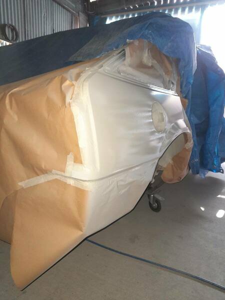

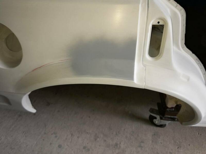

Before getting stuck in to the engine bay, I thought I'd better try fitting the doors to make sure the arches line up right. The nearside was spot on, but the offside  was a bit off.
It looks like I put the arch profile a little low at the front of the quarter panel. It was only 2 or 3 mm out, but it would have bugged the hell out of me if I didn't correct it, so that's what I did next.
The front of the arch was re-shaped with a little filler, then blocked into the correct shape.
When satisfied it all lined up, I splashed a bit of grey primer on it while I get round to re epoxying the quarter panel.

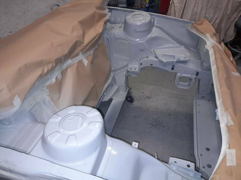

Been doing a bit of rubbing in here on the way home from work.
Extremely bored of paint preparation now - fortunately it should be ready to go over to the paint bloke by the end of the month.  :)
After more than enough rubbing, it was all thoroughly cleaned and masked up.
And after another coat of epoxy primer.

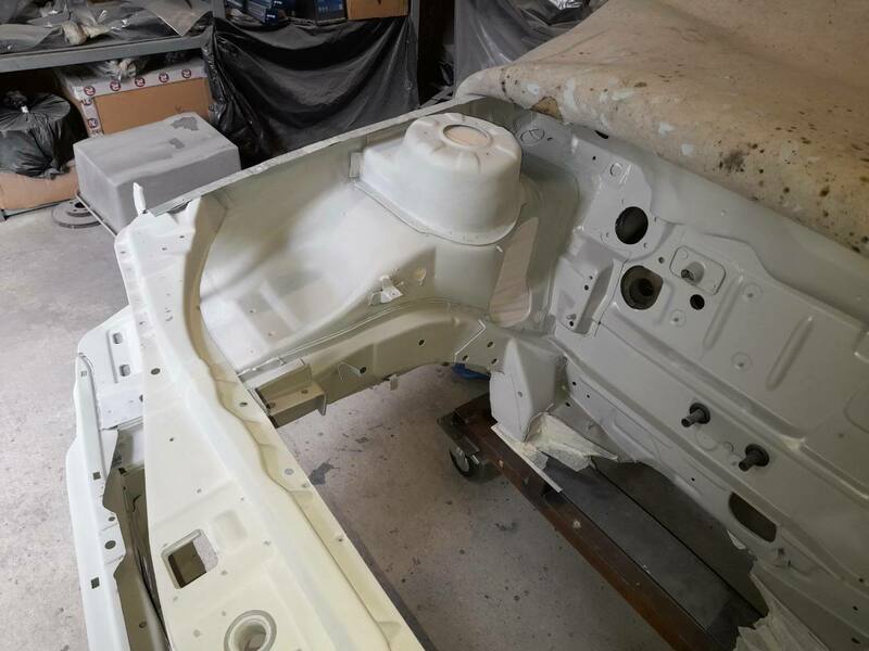

After playing with doors + umming and ahhing for a while, I got a bit of guide coat on in the engine bay, then made a start on rubbing it again.
It's been a bit warmer than is comfortable in the shed of late, but I still managed to get a bit of rubbing done. The offside is mostly done.
Got started with the nearside turret, and ran out of time.
Should get back on it over the weekend.  :)
First job of the day, the heater blower/ scuttle area was cleaned up. After all the muck was removed, it looked fresh, so this area will be masked off and left as is.
Nearside of engine bay now rubbed out.
Just the bottom half of the bulkhead left to rub now.
Should get that finished up one evening in the week.  :)
