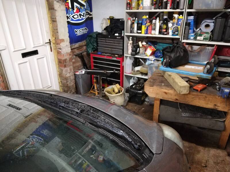

First things first, I had to feng shui the garage to fit the Jazz in. A combination of a small garage and too much shite meant this was challenging.
Eventually a suitable workspace was created

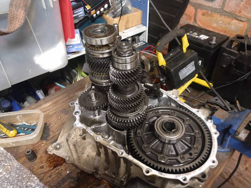

I found a couple of great youtube guides on stripping the box and replacing the bearings. I could go into this with a bit more confidence havingĀ the MR2 diff swap under my belt. Linkage,Ā  detent balls and reverse switchĀ removed and then casing bolts undone.
There's a circlip in the casing that needs opened up to let the casing comes off, a pair of cicrclip pliers and a zip tie were employed
And here she is
The bearing I need to replace is the input bearing, the one that is furthest from the camera in this pic. It's the one closest to the clutch.
To get to this you need to lift the gears out carefully.
Ā
This revealed the source of the noise.
Ā
Aye, that'll be fucked then.
I removed the diff thenĀ drifted the bearing and oil seal out as a new one was included in the kit I'd bought. I then drifted the new seal and bearing in.
The gearbox has a magnet inside it to catch any stray swarf. Safe to say this one had earned its keep...
The kit I bought had the bearing for the opposite end of that shaft too. Mine wasn't too bad but I replaced it anyway.
I obviously cleaned the inside of the gearbox to remove all the stray metal. It wasn't too bad but a lot had came out with the gearbox oil.

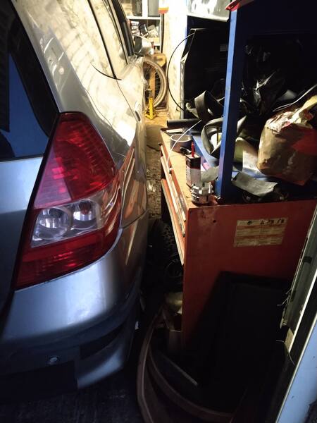

Here's how tight it was in the garage.

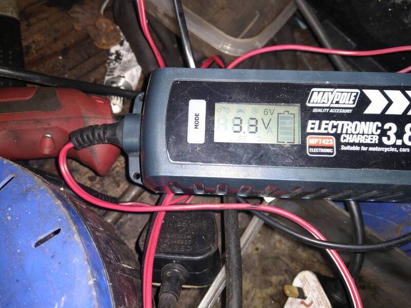

Dunan helpfully* volunteered my services to have a look at it. I went to it on Saturday but it was as dead as a dodo. I took the battery off to charge it and blew the tyres up to make it look less abandoned.
I've never seen a battery so flat!
Last night after i finished swearing at the Octavia I stuck the battery back on the Jeep and fired it up. It ran OKish but there's an occasional misfire when holding the revs about 1500-2000rpm.
