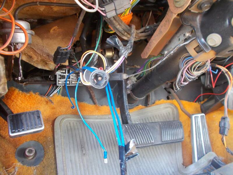

Today Oi arv bin mostly crawling around under the dash, removing (and, you'll be pleased to know, subsequently refitting) the underdash trim panel.  For why, Keats, for why?*   Why, in order to lubricate the switch variously known as the Neutral Safety Switch or the Starter Inhibitor Switch.  With no guidance from my Cadillac service manual, I deduced that it was most likely attached to the steering column, as is the shifter; most likely in close proximity.  The shifter itself has been feeling a bit stiff lately, and after the successes of yesterday, I reckoned that dousing it in WD40 or similar could do no harm and very possibly a lot of good.
So here's the view with the trim removed.  You can see the column coming in from the right of shot.  Over on the left edge, the reservoir-ish thing appears to control the parking-brake release.  So, I reasoned that the switch must be just by the collar that moves with the shifter, and gave it some liberal lubing.  I also lubed the parking-brake release, because that gets little use anyway.  I was joined by Tom, who has the red Polo breadvan I posted yesterday, and he helped me find the source of the power-steering leak which has been there from day one.  So, with the car suitably lubed-up and, crucially, starting, we went for a little cruise, stopping at Tony's ( @bicycle repairman ) but his curtains were closed (what, at nearly noon?), so we just turned round and went home.  Tomorrow I'll see about the mirror, and give starting another try, after the car's had a 24-hour rest.  The driver's door now works, at least!  And the window goes up and down so much better, it's really got yesterday what it needed.

Your starter inhibitor switch is this complicated looking turd strapped to the column. It also does your reversing lights.
Go look up "DeOxit D100 Spray", is not cheap but it can be put into switches with old plastics and brass and such and really does help, even on high current contacts. It's a fair bit better than WD-40 at cleaning dirty contacts. It's good for fussy fuses too.

Aha!  So that's where it is!  Thank you Phil!  I might have another roll around under there tomorrow.

From what I can see it's meant to be indexed and held in position by a tang- first thing check it's not loose. I'm betting it'll be tight and the issue is just with poor contacts in the switch itself.

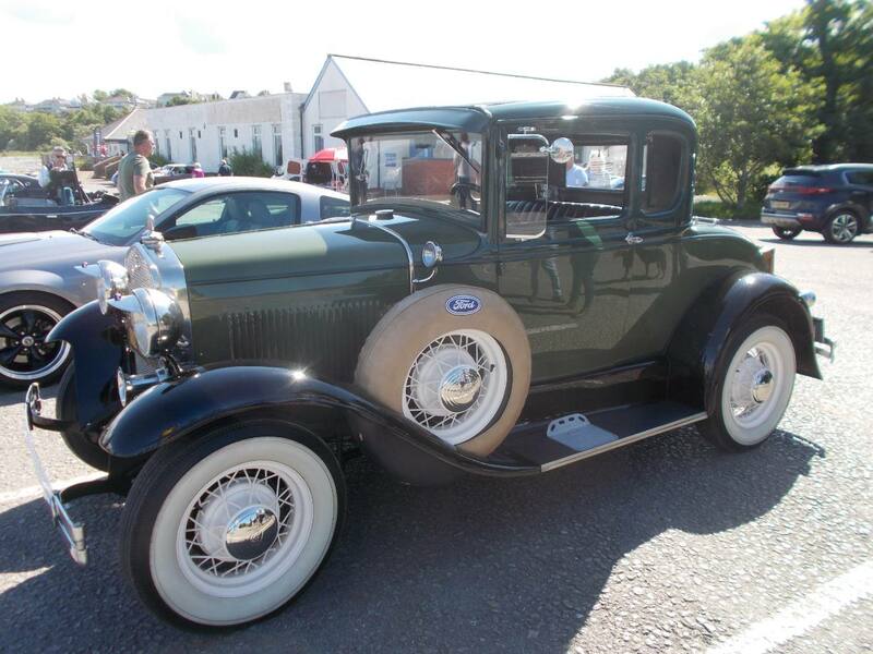

And then this arrived!
I mean, wow, right?  1928 Ford Model A five-window coupe.  The stuff of dreams for every Californian rodder, except we already had four glorious rods on site.  But wait...
