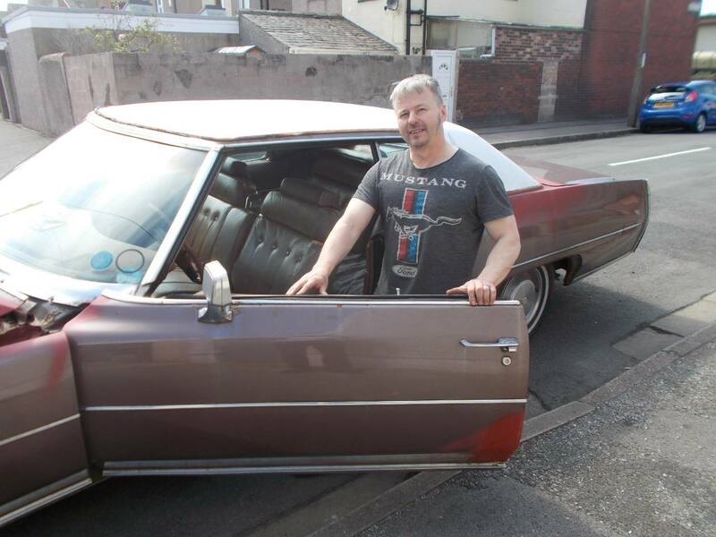

Why is this here and not in my Spotting thread?  Well some weeks ago I took my dog over to the beach for a walkie, and I found this nearby.  Today I did the same trip, and had my camera with me, so I stopped.  The owner was sitting out front enjoying the sun; obviously I introduced myself (owner of a shabby brown Cadillac, you will have seen it around...) and he was, as most of us are, delighted to meet another Yank owner.  So we were chatting, I outlined Huggy's starting issues, and he said he was going to meet his mate Ray within the hour, I should come along.  Naturally I said I would.
When I got home, I thought on a whim that I should try and start Huggy, because obviously it would be the right thing to do.  After a spot of wrestling with the shifter, he started, so I went over to Ray's, where Huggy and I were welcomed as old friends.    Much amusement was had when I slid over the seat to get out!  Inside a couple of minutes both Ray and Jason (the Chevy owner) had wrestled the door enough to get it open and gave it some very liberal applications of WD and similar fluids.  It now works more or less as it should.  We deduced that whatever lubrication had been inside the door had congealed, which was stopping the mechanism from working.  Further lubricant was applied to the window runners before the door cards were refitted, which in itself was a bit of a game.
Here's Ray taking the credit.  When the time came to leave, Huggy naturally didn't want to start.  I went through the routine with the shifter a couple of times, until Jason reached in through the open window and grabbed the lever while I was turning the key.  It worked.  We concluded that the inhibitor switch would be mounted on the column somewhere and would likely benefit from a dose of WD of its own.  That will probably happen tomorrow, and I'll report back of course.  But oh boy I did enjoy cruising the mean streets again!
