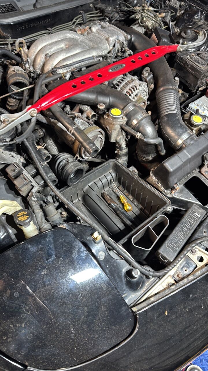

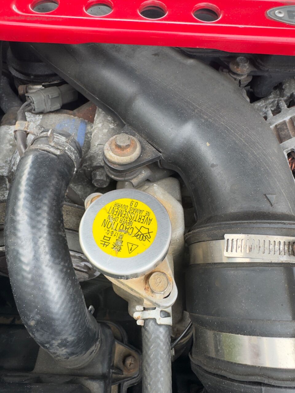

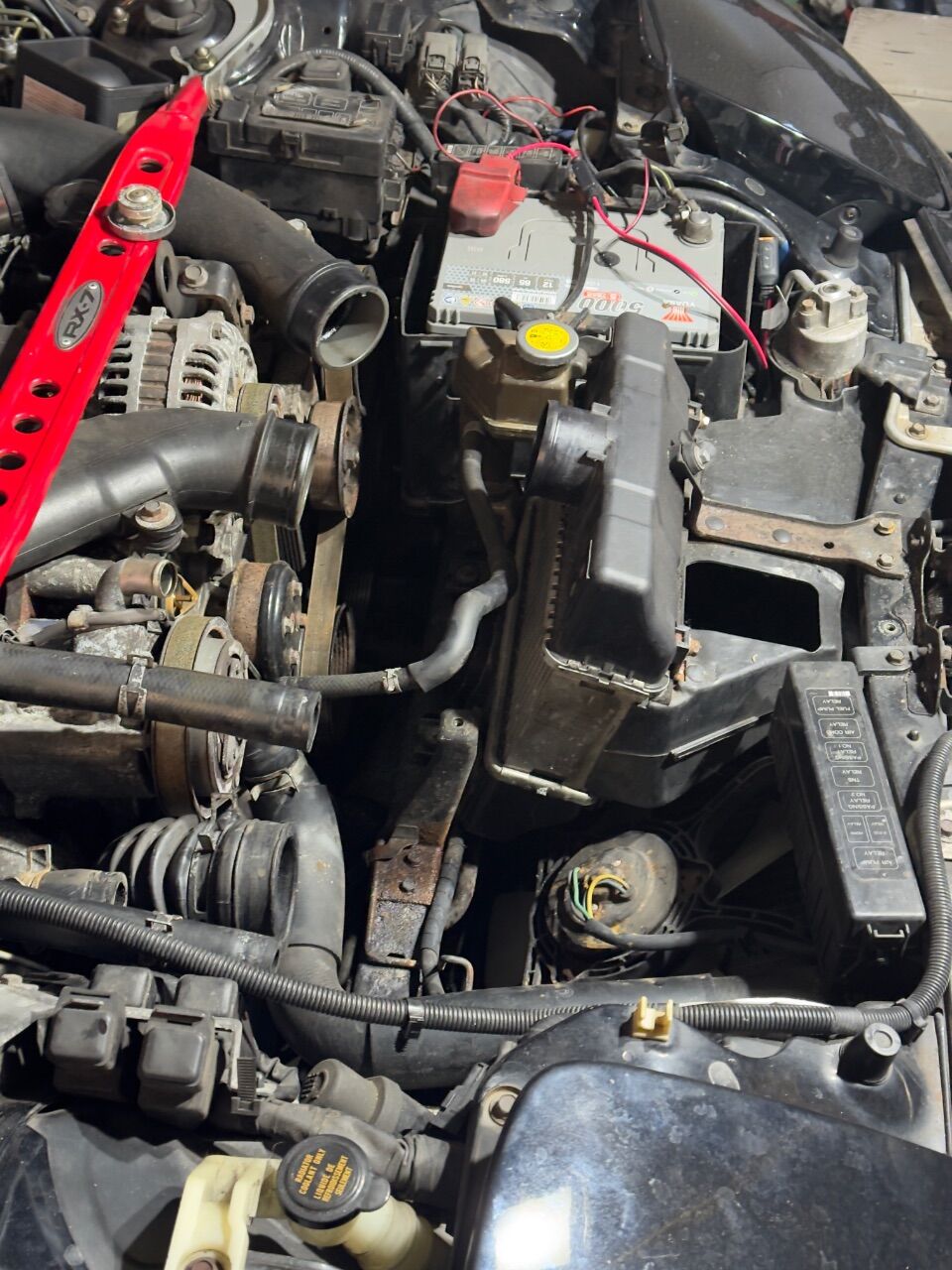

Coolant level sensor was araldited in.
Much swearing, housing off, destroy sensor, find threads obliterated, search for right tool.
Manage to cut 1.5 instead of 1.25 but it's plastic threaded plug and at this stage I don't care.
It seems to be staying in and secure.

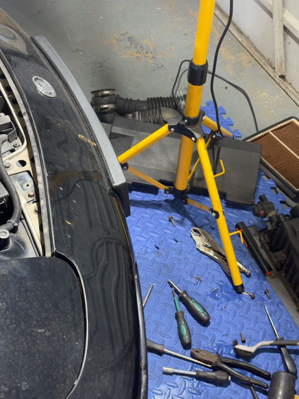

I hate, hate, hate the five hoses of doom with spring clips on the airbox. Hate. Who the hell designs things like this?!
*burrrrrp*

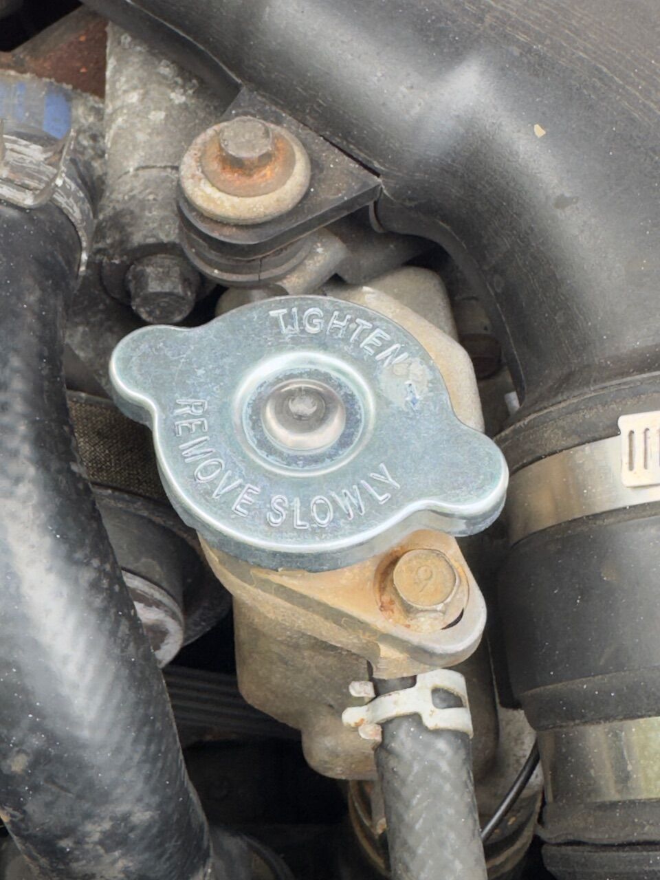

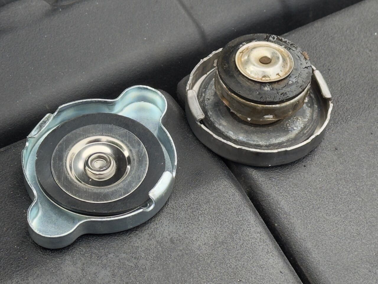

There are a lot of bubbles in this as it warms up, but I think it's still clearing blockages and crap. Getting it properly flushed and filled will be good, but I really wish I could just buy a new radiator and all the hoses. It would be wise anyway.
I suspect having two pressure caps doesn't help, it's supposed to have a blank cap at the higher filler point.
That's like a Daihatsu Hijet/Piaggio Porter. Advice for them is jack the front up & fill from height. Blank or sprung cap shouldn't make much difference as second cap. Can you get the rad re-cored?

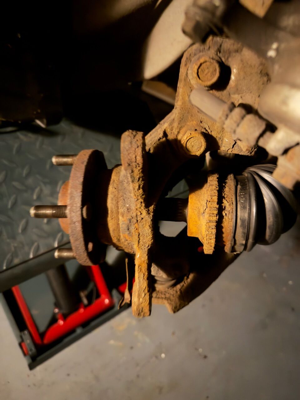

But first, I need to accept that these wheelbearings are old school and that hub ain't coming apart unless I take the knuckle off.

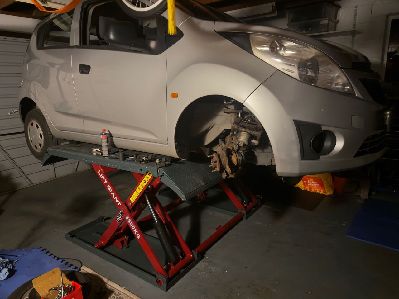

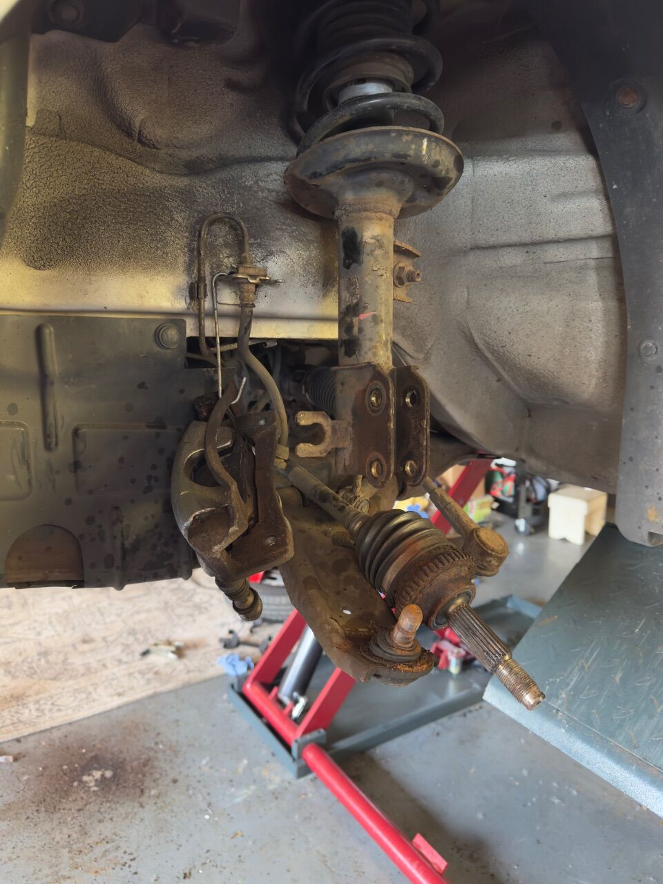

Removed the other knuckle - also with ABS sensor still attached because every attempt to drill and use an extractor failed. How can the bolt be made of something so resistant to being drilled into, but also clearly rounded off the flats in the hex head at any attempt to undo?!
Dropped them off at the local garage and said "please". I am not buying a hydraulic press just for one press-in bearing change.
I can't believe that with Corsa and Yaris and many other GM-Daihatsu-etc. adjacent models all sharing this same basic knuckle and hub (if not swappable, almost certainly emerging from the same OEM) there aren't readily available fully loaded knuckles.
And as always, Google and "products" is total red-herring central showing what looks like what I want, just  part number, and totally unrelated to the search result.

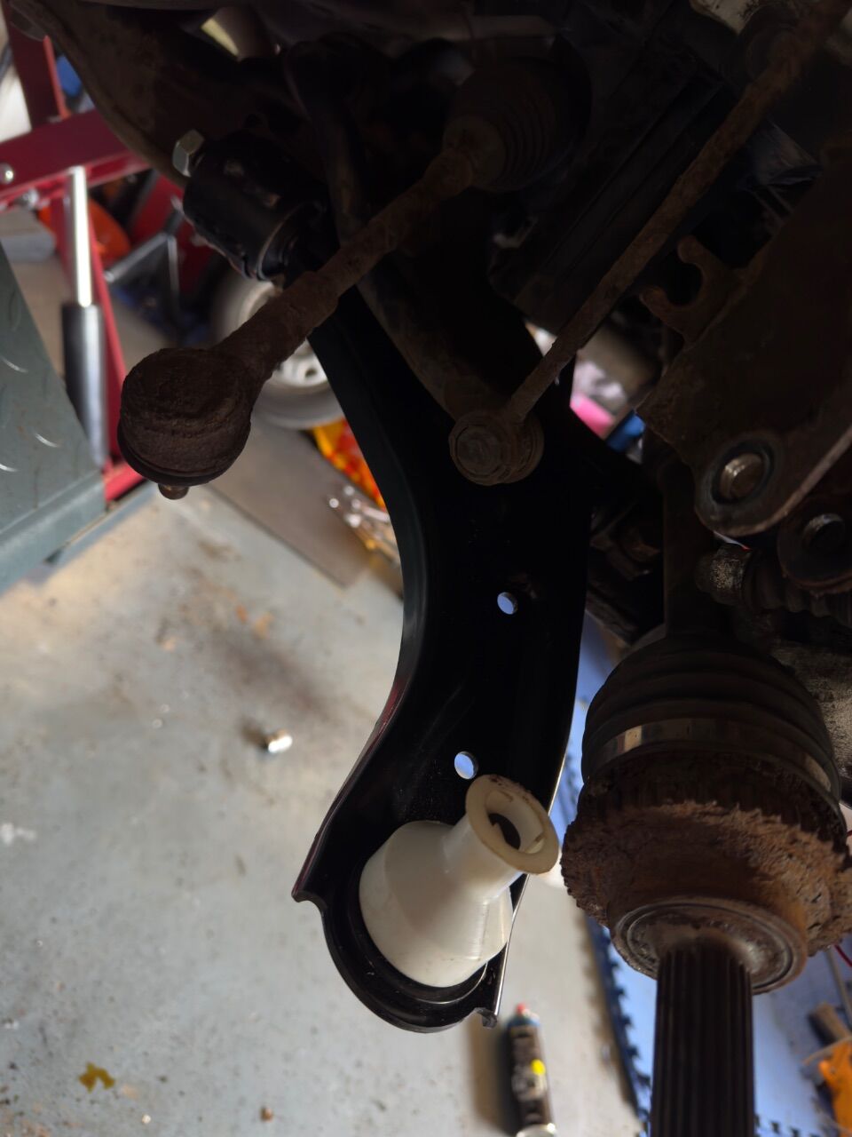

The battery tray had to come out to get the other ABS sensor connector.

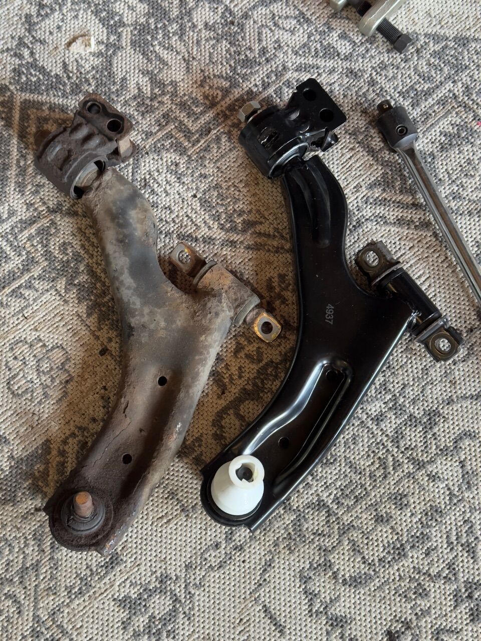

On the upside, it is getting two new control arms and strut top bearings since I've done all the work anyway and the fork for getting the balljoint off damaged a grease boot.
Aaaaargh...
Bloody online parts suppliers! I thought the two bearing setup looked odd.
Single assembly type ordered - don't know how I'll fit it.
These were pretty...
...armless...
...to swap.

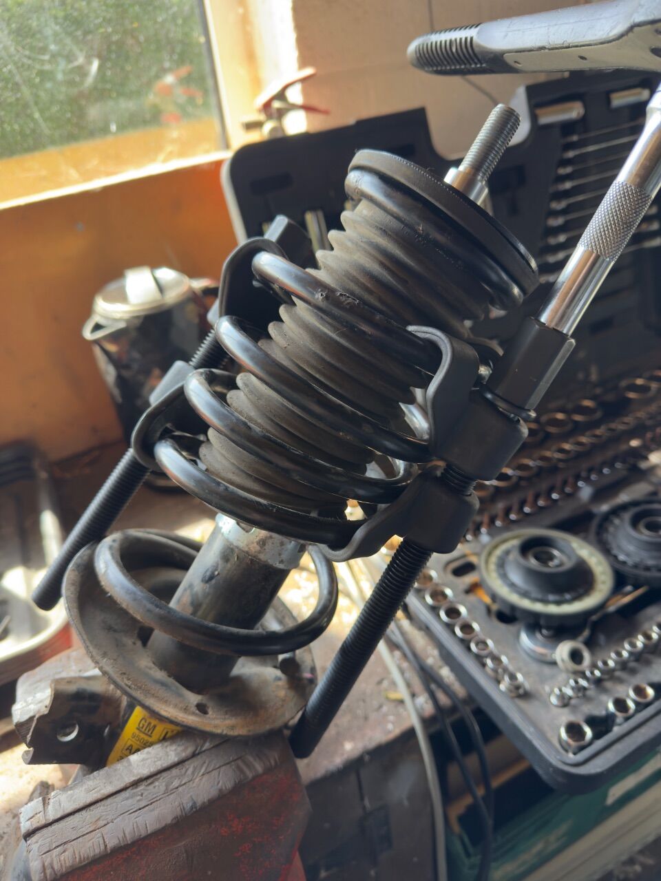

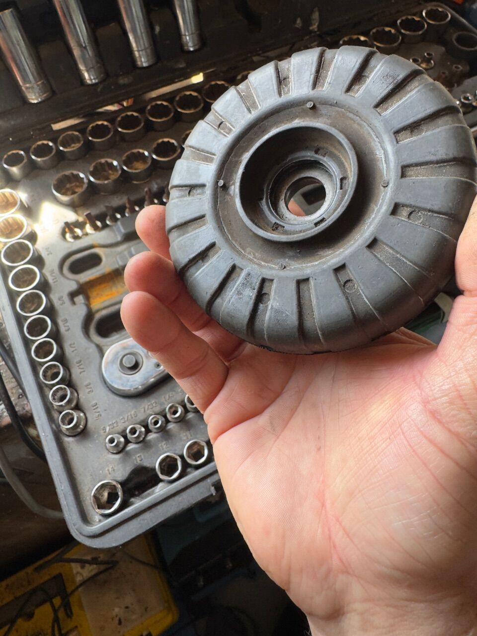

Top mounts next. Ugh.
I'd rather be finishing this:

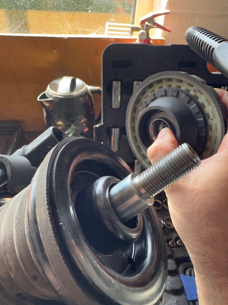

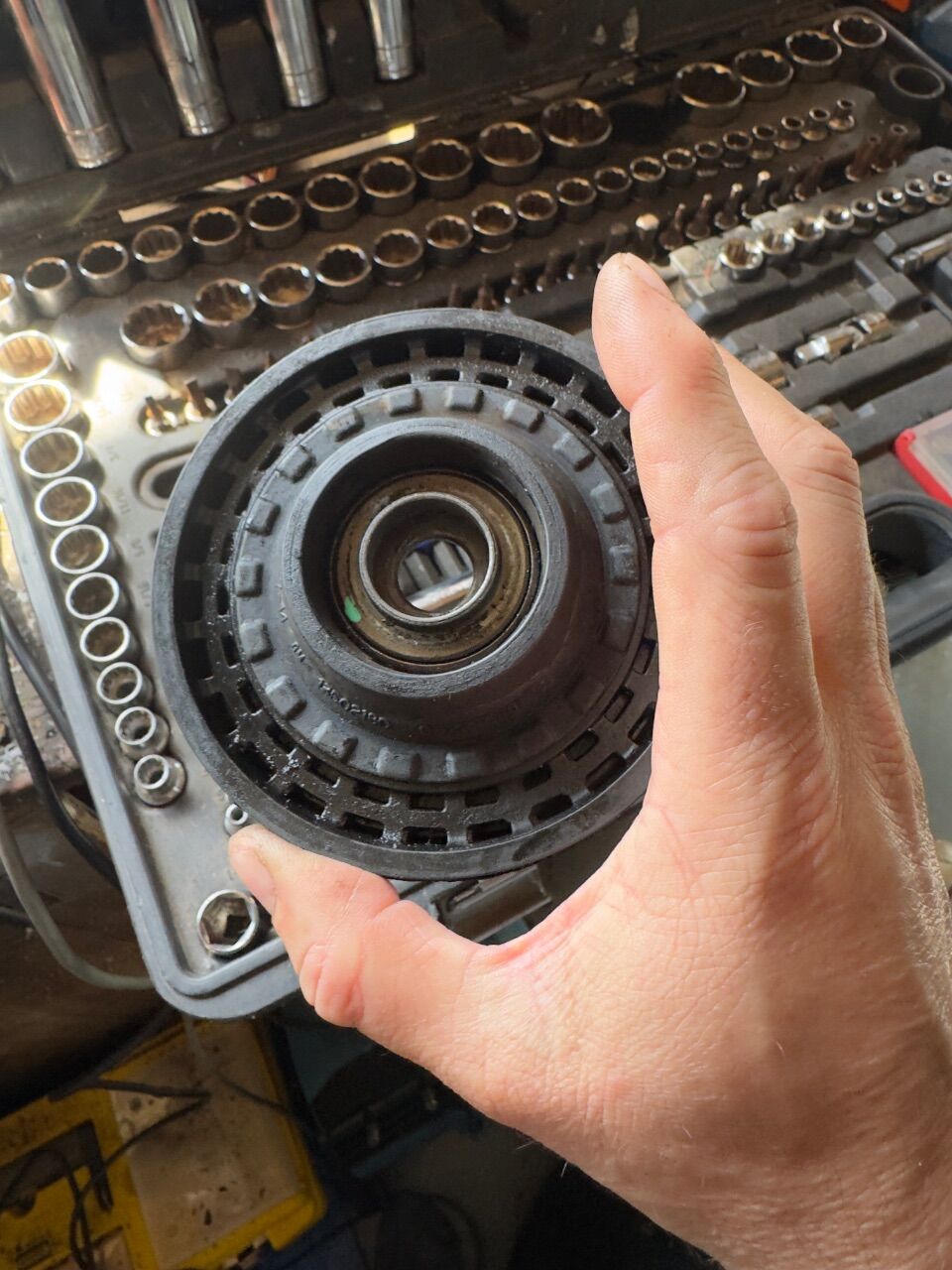

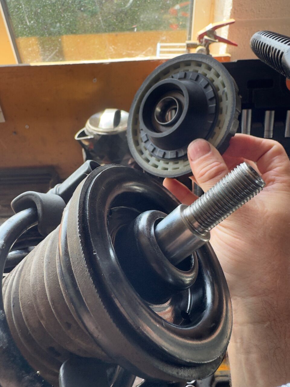

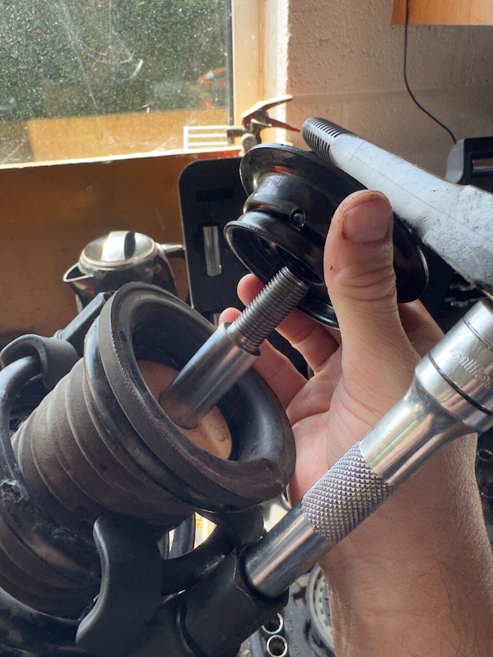

I am confused...

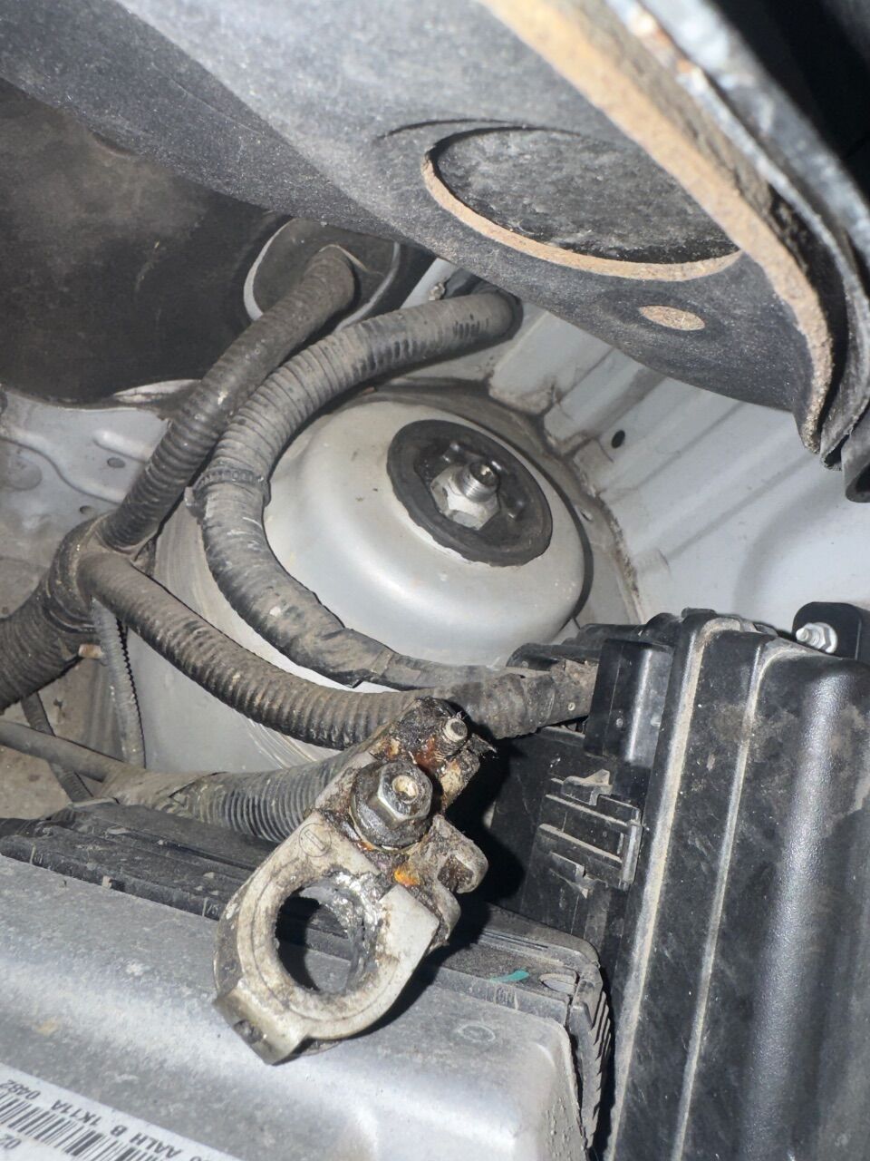

I put new top mounts on because the old ones were squeaking...
This metal cup is the top of spring support, and goes against the bearing in the mount
This is the mount, and the curved "hat" on the metal support rests on the bearing...
This part of the bearing, spins. This makes sense.
This part does not. So far the rubber cup sits in the inner wing, the metal piece turns with the damper shaft, spring and strut, Makes sense.

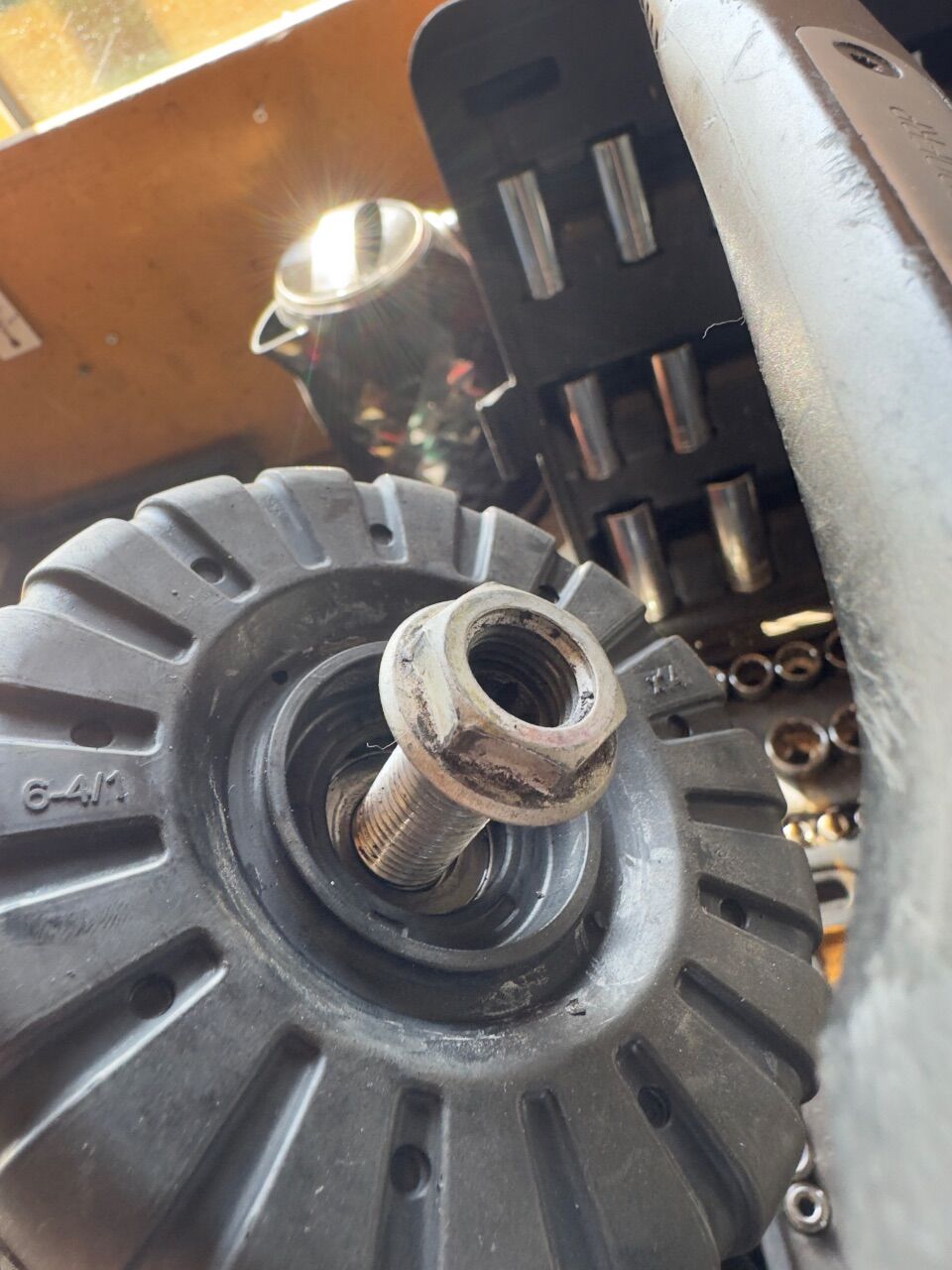

Here is the nut to hold it together. It cannot go anywhere else. It goes on the shaft of the damper /after/ the non-turning part of the bearing. It clamps the rubber mount to the damper shaft.
The assembly then does not turn. How could it?
But the old parts are GM stamped and configured the same way.
Inner race turns
rubber piece sits on a bit that doesn't turn.
To my mind the bearing should be clamped at the bottom so the bearing and everything below it can turn around the rubber upper mounting, with the rubber & metal disc not shown, that secure the strut in the body, "floating" above the strut to allow that and dropping when the suspension travel is exhausted.
But as designed it just all seems to bind up?
What am I missing? Is there some magic when the weight is on it that makes it all work?

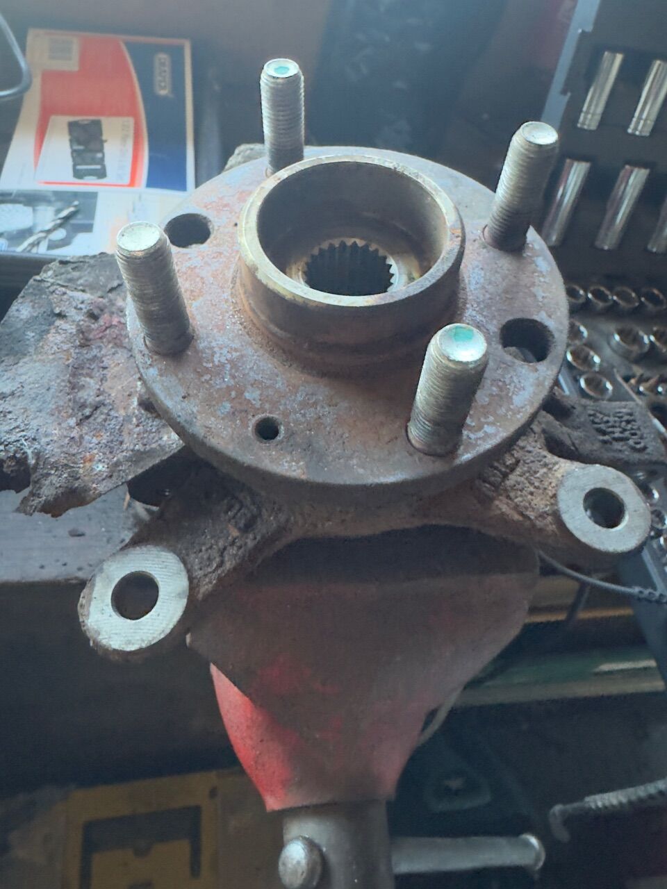

I am going to smash this Spark with a very big hammer, just because buying parts has become such a nightmare and it's fighting any attempt to be clever.

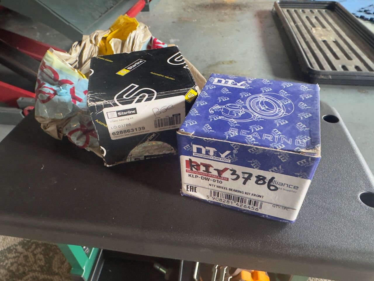

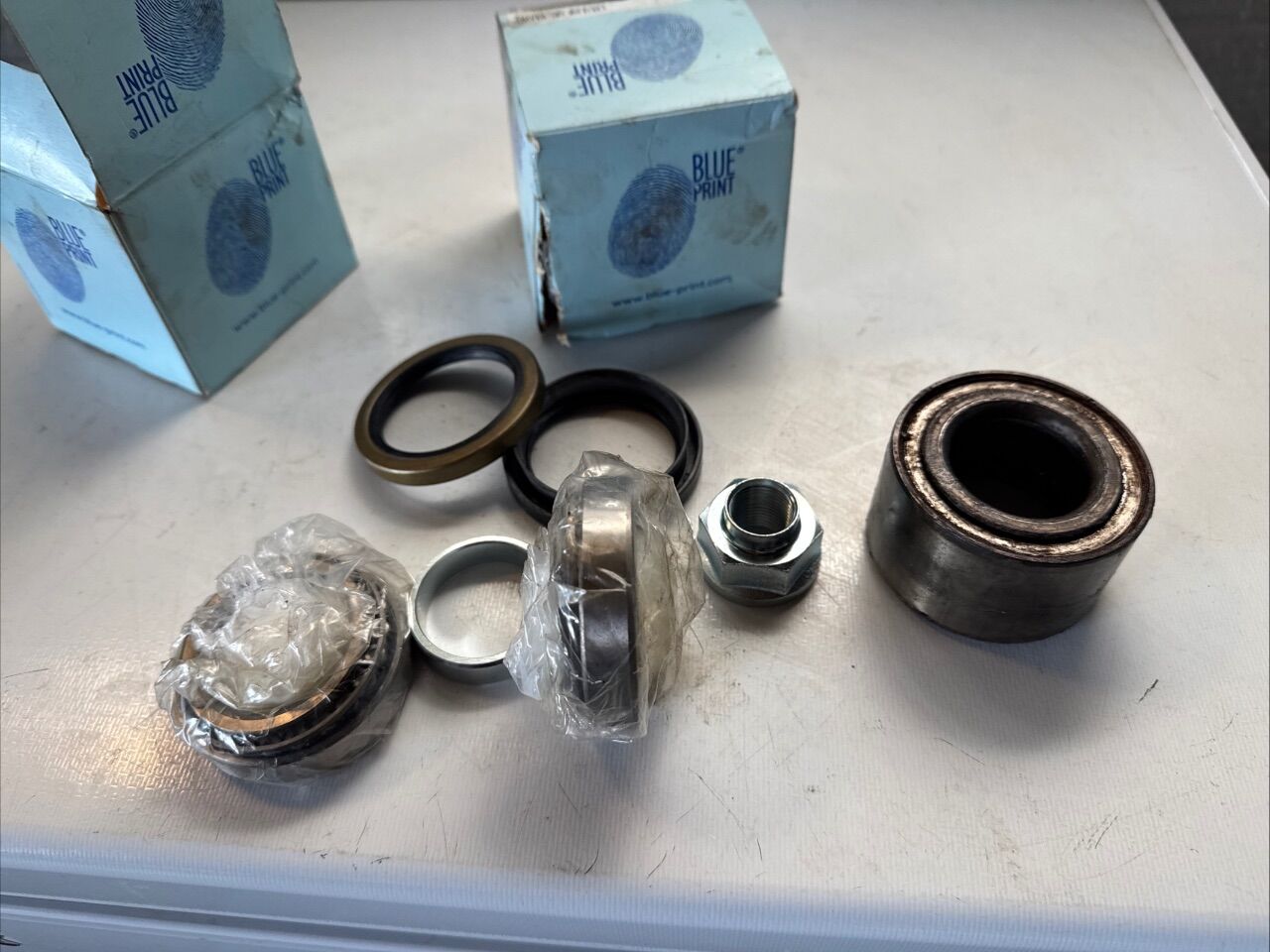

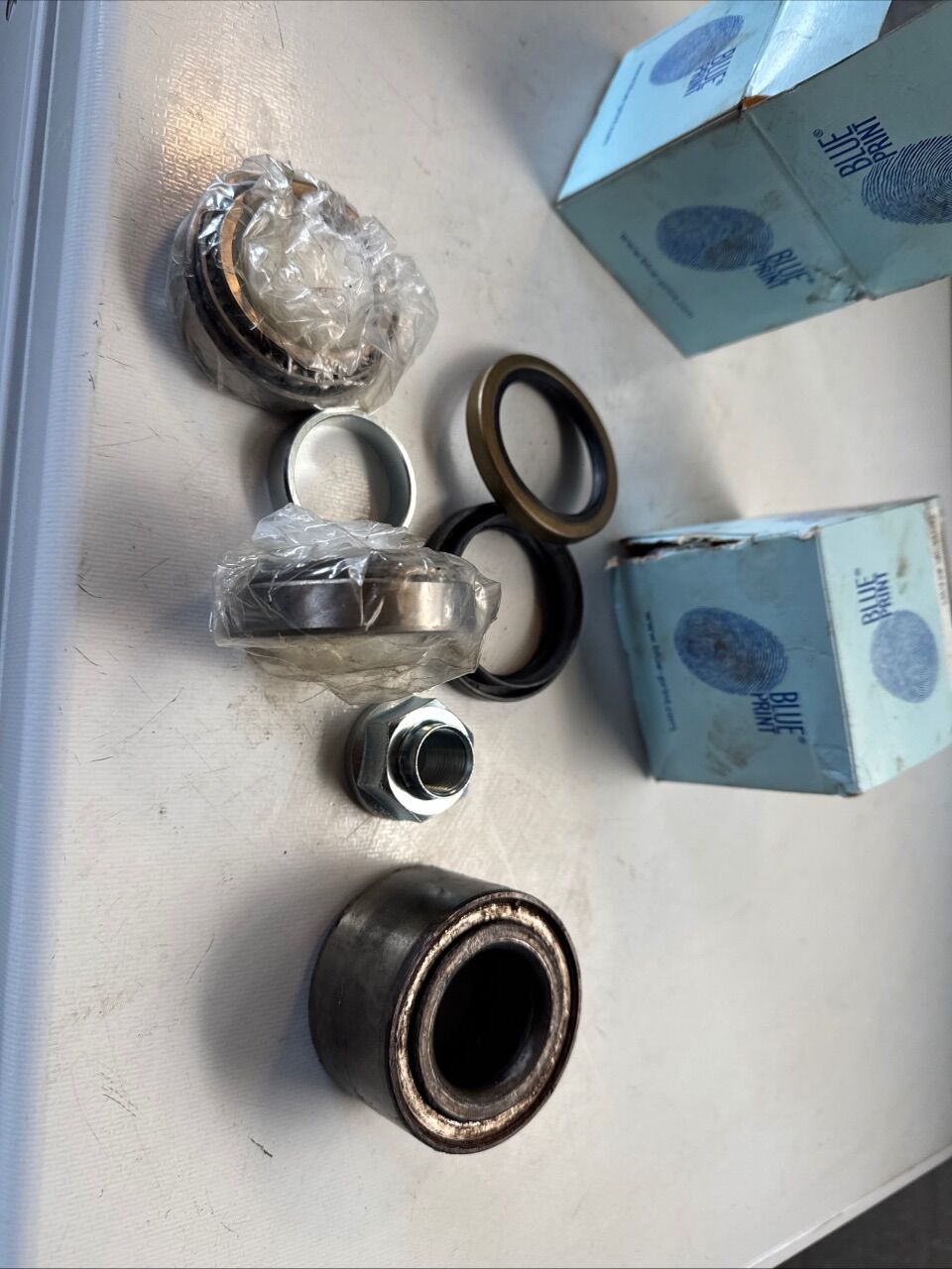

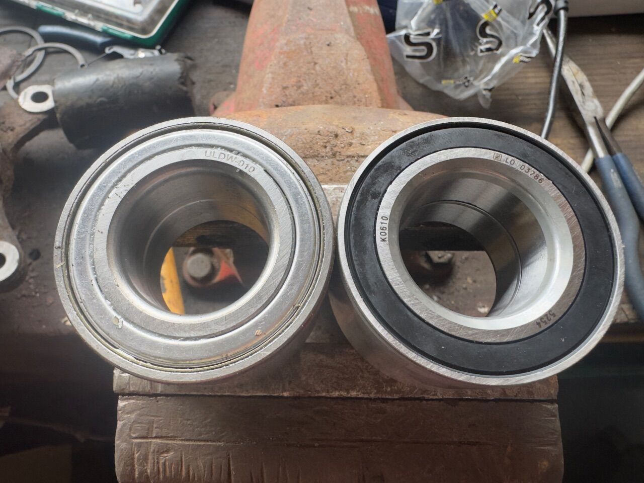

1: wheelbearing goes.
2: order wheelbearing based on age, model etc.
They show up quickly but are Gen 2 for "um... maybe newer ones or maybe a Matiz" so back they go, but after the garage has been given the knuckles to press out the hub.

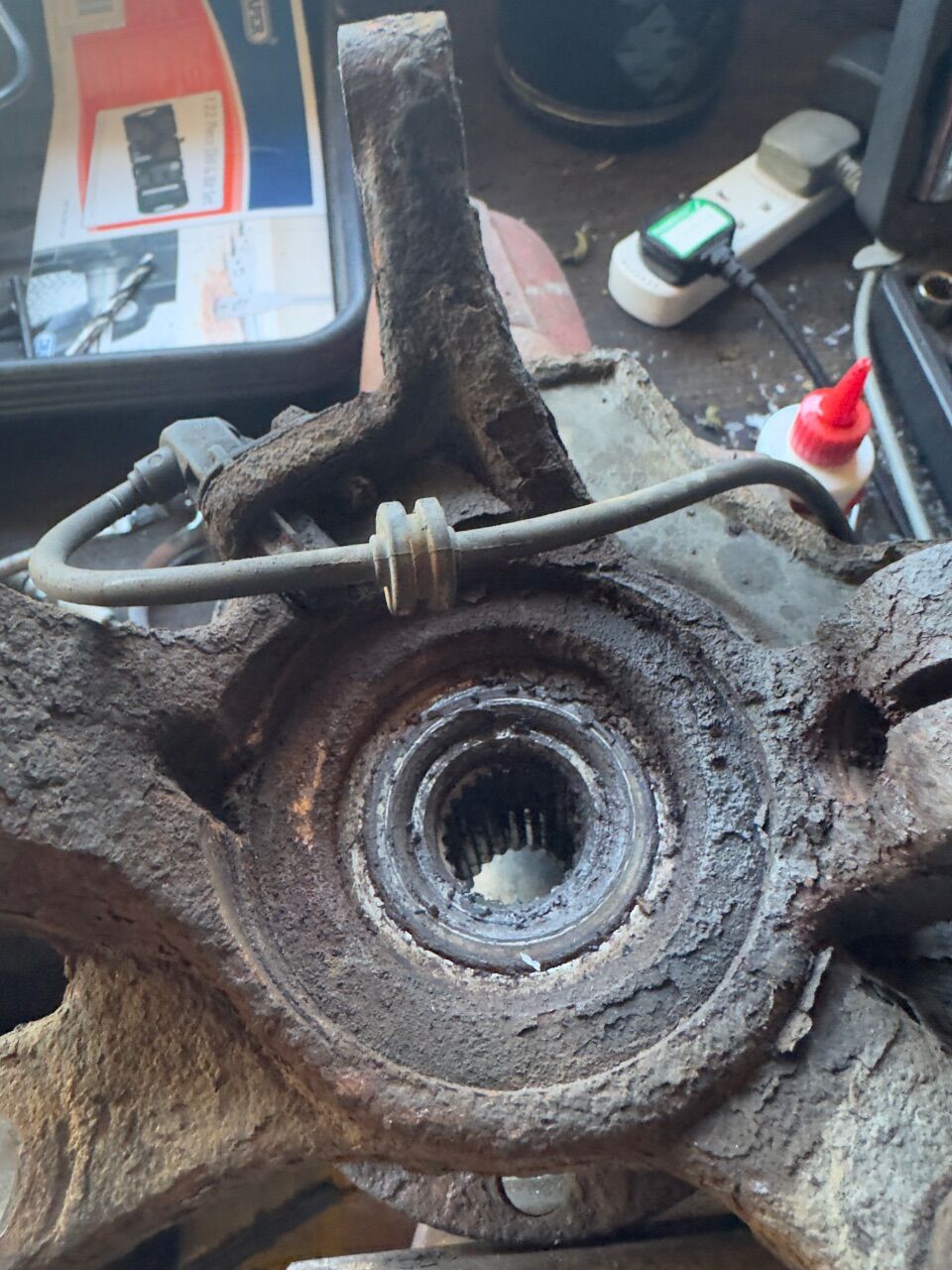

3: the process of pressing out the hub wrecks the disk backing plates, the screws are basically stubs of rust.
The ABS sensors are also still attached and the socket-headed screws are made of "instant internally rounded but can't be drilled for shit".
4: I order new Gen 1 bearings. Seller says next day. Hah. That's almost a week.
5: and they're two different brands.
6: and I have no way of pressing the bastards in.

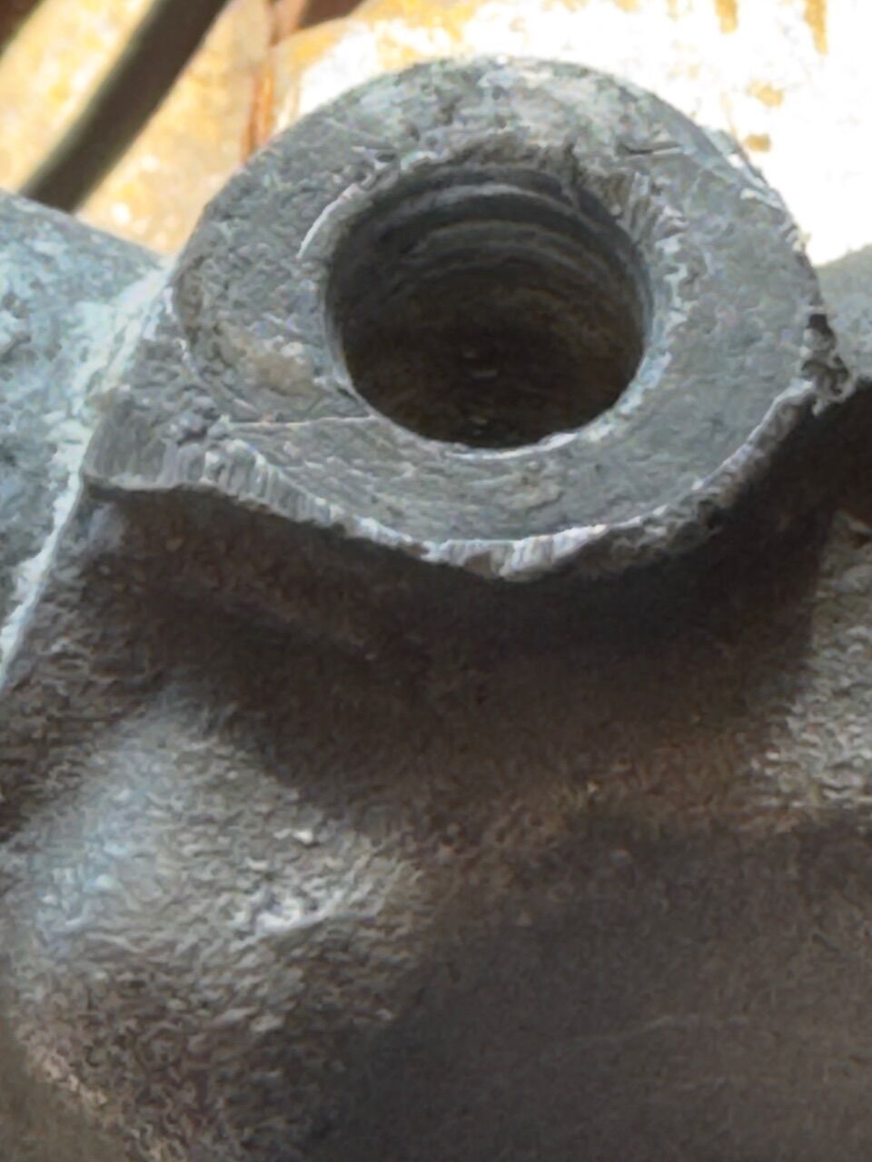

7: but first I want to fix the backing plates. Buy a new set of cobalt bits. Drill one. Extract. Textbook.
8: next one breaks the extractor.
9: the ABS lug breaks the end off the drill bit.
10: The extractor bits are now 2x the price.
11: I scream like Franka Potente wanting to win at the roulette table and decide to order new knuckles.

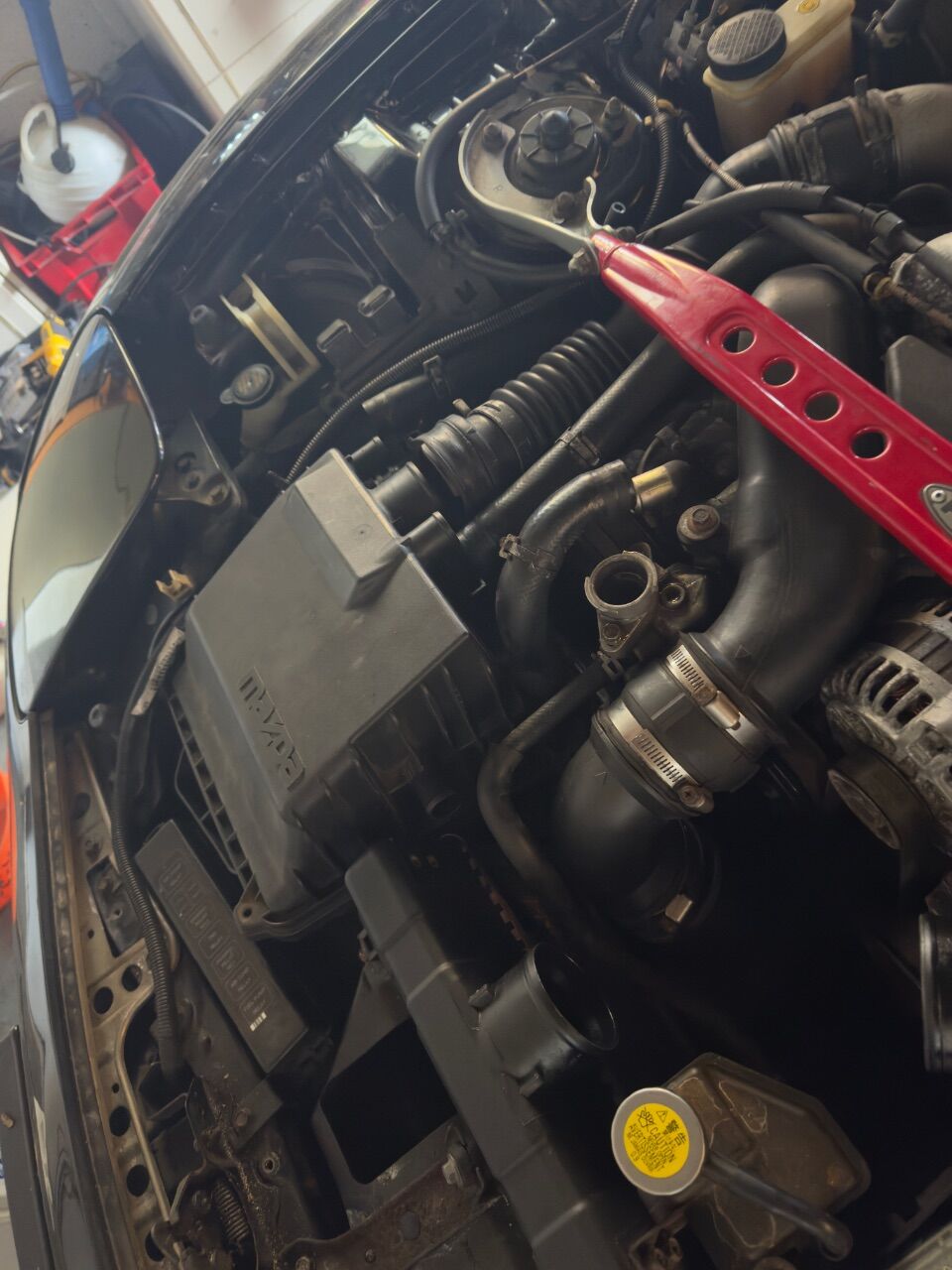

Someone made an error in the past.
Correct one, degas tank, do not remove.
Filler point?
That ain't right.
Now it should bleed properly rather than airlocking too easily.
Distilled water and running a few times seems to be clearing the mixed-coolant jelly.
A few traces, but it looks clear jelly now rather than orange.
It's just so utterly infuriating being unable to easily fix this crusty mess of a hub.

It's a nightmare I know, but I'm glad I'm not the only one who's been finding this with what should be fairly normal parts lately.  I was seriously starting to think it was just me.
The 82528492836 different wrappers of Autodoc is something that absolutely drives me up the bloody wall - especially when I KNOW that their catalogue is wrong and the part they think will fit won't.

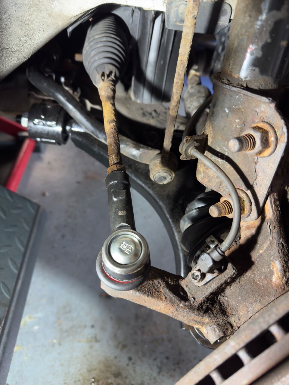

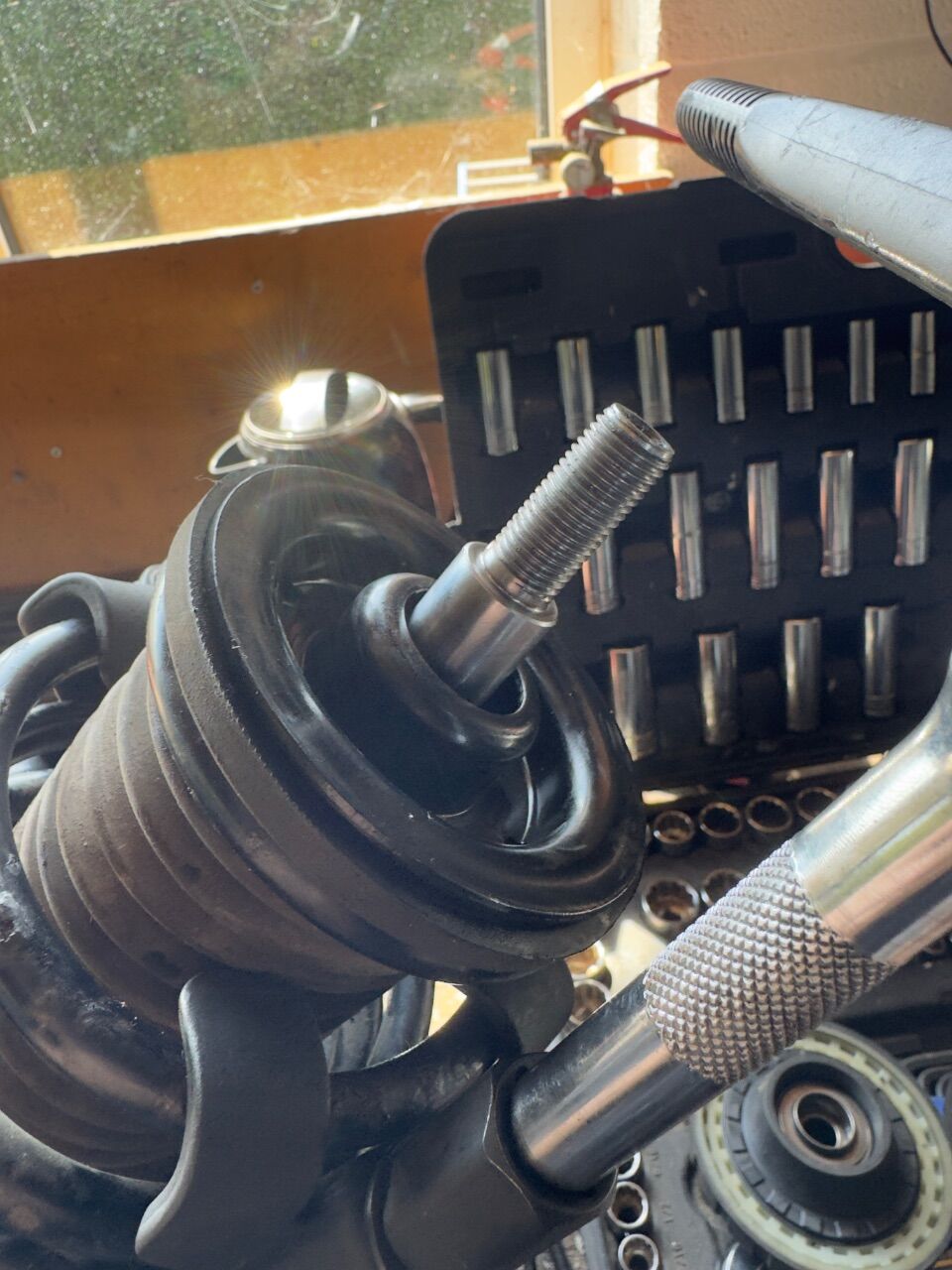

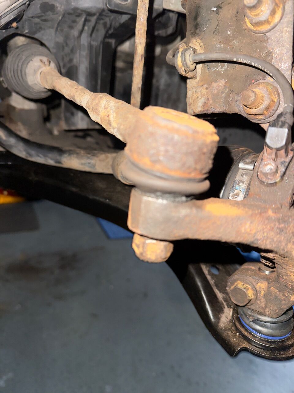

Done...
But this was a bastard. I broke one of those things that pushes down with a claw that's supposed to push bolts up out of something in my attempts to "get the taper to seat".
Dreading the inevitable.
But damned if the local motor factor didn't turn out to be the best choice - new Febi ends, £17 each, not in stock but "we'll have them in the afternoon".
So removing the nut was fine because I just held it with pliers.
And the factors recommended I stop buying WD40 and buy something good instead. It worked.
(My shoulders hate me).
A tip from @ruffgeezer was very much appreciated!
And 50Nm later...
Now I need alignment, but it's driving very differently with light steering, not so much thudding and sounding 'injured' by potholes, and no wheelbearing noise!
New control arms, bearings, top mounts and tie rod ends I think squeak in below £200 for the lot and if I had a bearing press and hadn't gone down the rabbit hole of wanting to fix the brake dust shield and ABS sensor rusted-in nonsense it would have been a day, not over a week of annoyance.
And the cheap brake calipers from Amazon, still clean, still working well. Cleaned and regreased the brake sliders anyway.
