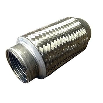

On the down-side the exhaust downpipe is split. It looks like there isnt enough flex in the exhaust rubbers to accomodate engine movement so I have ordered one of these universal flexi joins which I will weld into place to allow a bit of flex.

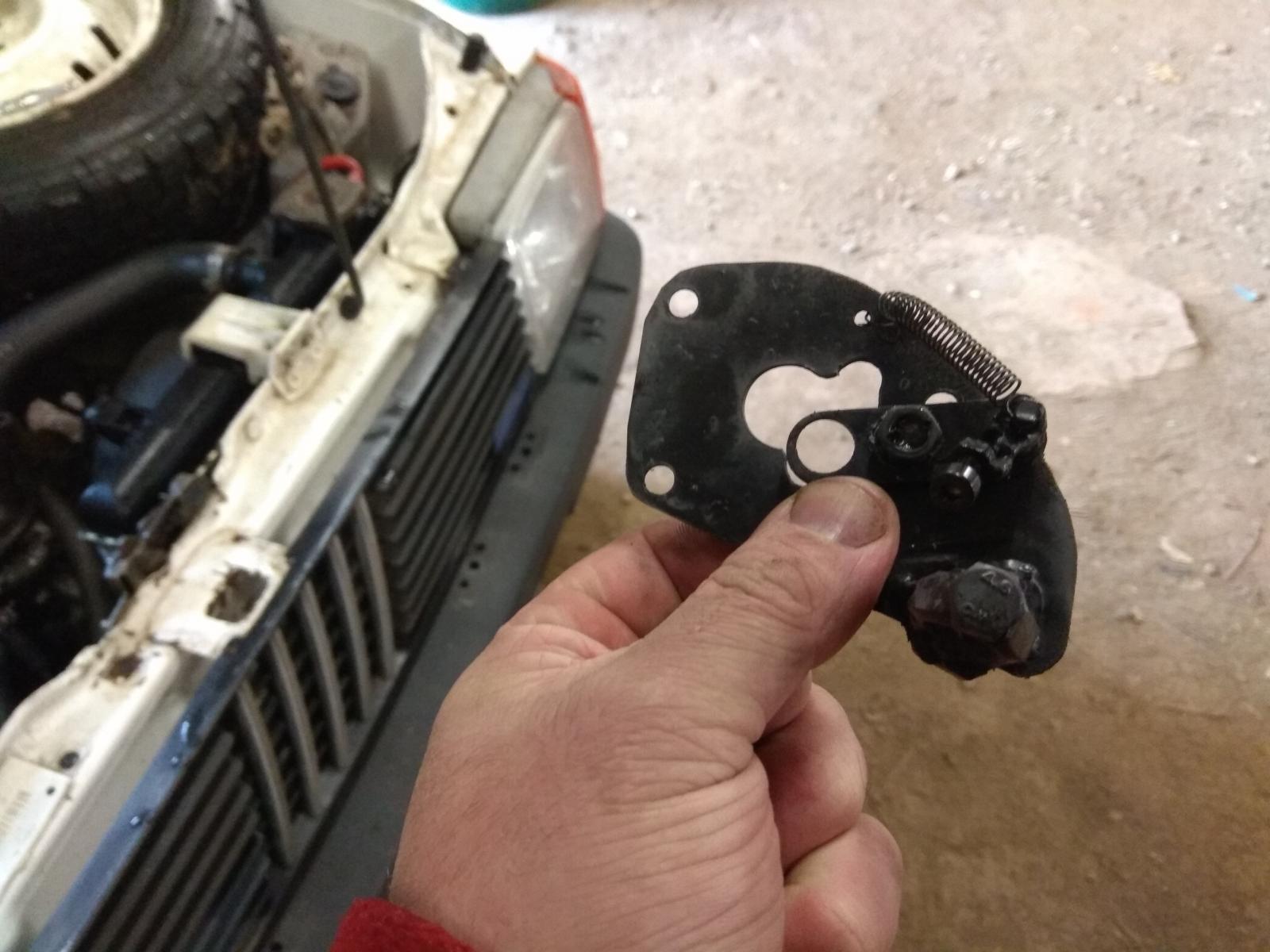

This thing was always a hassle to start....it would grind over for ages and after 3 or 4 attempts would fire once... this was the clue that starting was imminent and the next turn it would start up and run for 5 seconds then cut out, then restart and idle ok.
This was due to the automatic choke being dogshit. I have two of them, and they are as bad as each other.
Its a spiral bi-metallic strip that should expand and contract with temperature changes and should move a lever on the carburetor accordingly. Both seem to have not enough travel though and while they are easy to adjust, without the proper range of movement its pointless....either when cold it would give full choke but when warmed up not open it fully, leaving it running rich and idling at 2000rpm, or fully open when hot but not closing fully when cold giving bad starting.

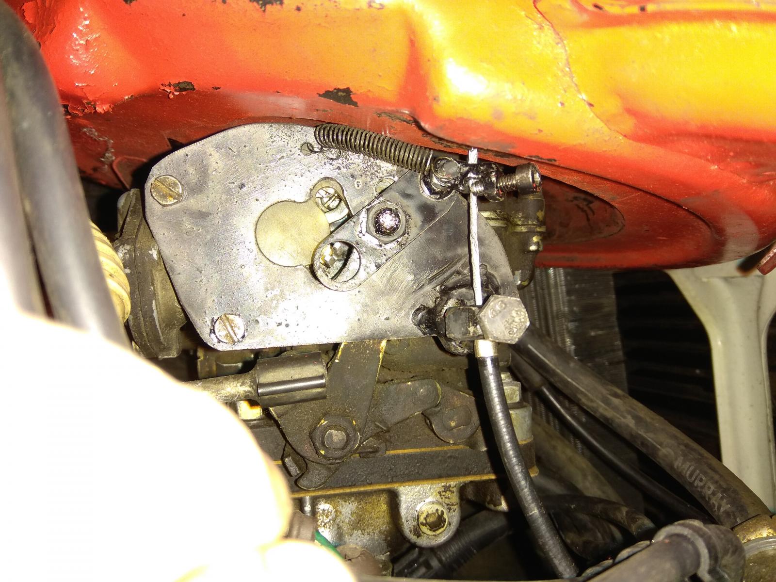

I decided to sack it off and fit a manual choke, which proved to be a significantly bigger job than planned....Yeah, just make a wee plate that bolts to the carb and fix the cable to the lever......lol, what a twat of a job.
Firstly, I bought a manual choke cable from Amazon, which wasnt great quality, the main problem being that it didnt lock in any position. I solved this by slightly crushing the outer tube to give a bit of resistance to the inner part so it would stay where I left it.
I wanted it to bolt on in place of the auto choke and allow it to go back to standard if it didnt work so I made this adaptor plate....
Which proved to be a massive headache, as my plan of fixing the cable direct to the choke lever meant there would be about 5mm of travel for the choke knob and there was probably that much slop in the cable so it just wasnt working. I had to make a lever that gave enough travel to fully open and close the choke flap and give a reasonable length of travel at the knob end [insert joke here].
Here it is in place....
And a wee vid of it in action....
Much better.
impressive engineering Mr Numbers, and nice to see you back posting interesting and informative material
That's a neat way to return. Can't even call that bodging really! Proper engineering.

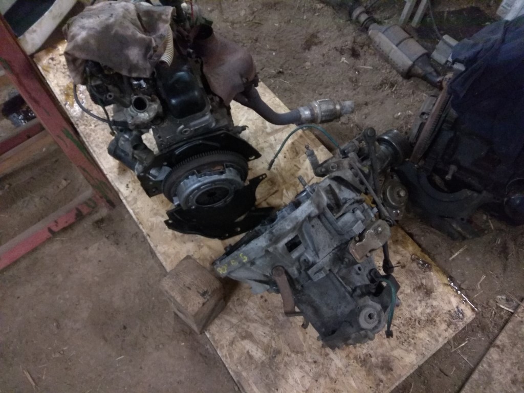

Following the purchase, collection and dismantling of the cinquecento as written here....
http://autoshite.com/topic/30772-daves-cinquecento-brutally-raped/

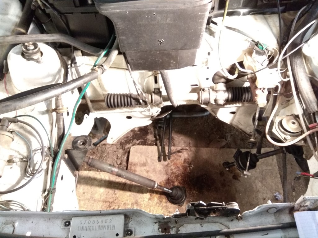

I thought I better make a start at putting it into the Panda, so i cleared a space in the garage and the Panda assumed the position....
I dismantled the exhaust, driveshafts, propshaft and lower suspension arms then dropped complete engine and box out the bottom, which went quickly and easily - its not seen much action since it was put together, so no problems were encountered.
And thats about all I did. I will need to order up a few bits n bobs before putting the new motor in, so its likely to be a while before anything else gets done.

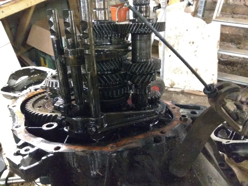

In the meantime I wanted to have a peek at the gearbox. Ever since I built the Panda up it has made a rapid clunking noise in reverse coming from the gearbox. It only does it in reverse, both under power and in gear with clutch down and freely rolling - everything else has been eliminated and my thought process led to an internal gearbox fault. Long term readers may remember I obtained this car as a bare shell and pile of bits from my idiot brother in law who literally bought it, drove it back to the farm and took it to bits. He couldnt remember if it did this clunking then, but that was years ago now, and I dont see how anything I have done could have damaged the box.
With the box off and on the floor, if I select reverse and turn the input shaft by hand there is a definite faint clunk from inside the box....Im thinking a tooth is chipped on one of the reverse gears.
 Replacement box? dunno....will it get worse? dunno....do i do a lot of high speed reversing and up steep hills? not really, no.....could i just live with it? possibly.
Then I wondered about the cinquecento box....obviously its different in that it doesnt have the rear output for the propshaft, but it looks very similar otherwise. I decided to open it up and see whats what as it would be getting scrapped anyway. I know little about gearboxes - especially front wheel drive stuff, so it would be a learning experience and possibly I could rob some parts from it to repair the Panda box.
Started off in the usual manner...
And after a brief period of time....

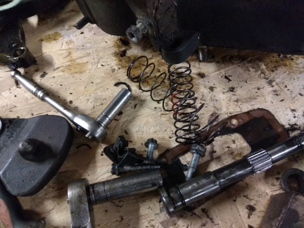

bolts and levers and things...
boingy things and splined bit....
I know roughly where they came from....
cogs n shit....
oh my....
Yeah, thats...nah, yeah, nah thats fucked mate. Well it certainly is now anyway.
In the last pic, near the bottom of the gear clusters is a pair of straight-cut cogs, where all the others are helicoidal. These are the reverse gears and they dont actually mesh together...cant be seen in the photo but there is a gap of about 10mm. Behind them and lower down is a third straight-cut gear. When reverse is selected this is lifted up and acts as an idler gear between the two others - this is what reverses the direction of drive. I would postulate that one of these three is damaged inside the pandas box.
Sure - I could get these out and separated from the clusters, but would they be the same as the Panda parts? fucked if I know and fucked if i know how to find out, and more importantly, could I do this all again with the Pandas box and get it back together without any boingy bits and stuff left over? not sure, tbqh.
Probably best just leave it well alone, eh?

My Fiat 500ish Autobianchi had the broken tooth problem - on reverse and 1st gear, first using the same straight cut gears as reverse. No syncromesh.
I helped Dad do a gearbox rebuild on Mum's Anglia van.
1st, 2nd, BANG. Had to remove the propshaft to tow the bastard back. It never moved again.
Gearbox work is for the brave and skilled I reckon.
From what I gather and I stand to be corrected by more knowledgeable types, the forward gears are permanantly meshed at all times, but free to spin on the shaft - its the selector forks that slide different splined sections into contact to lock one of the gears to the shaft giving drive, the others just merrily spinning but not doing anything.
