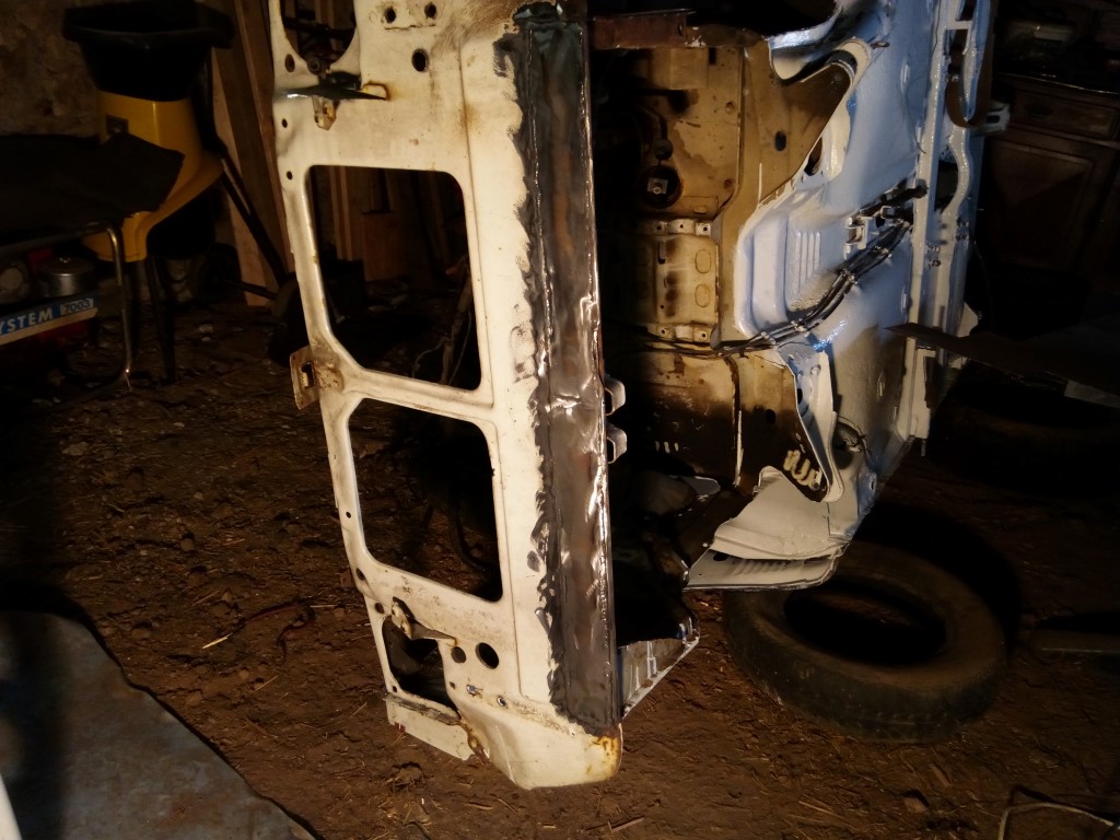

More welding this morning.

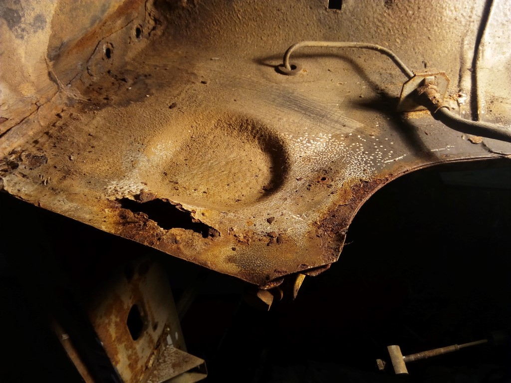

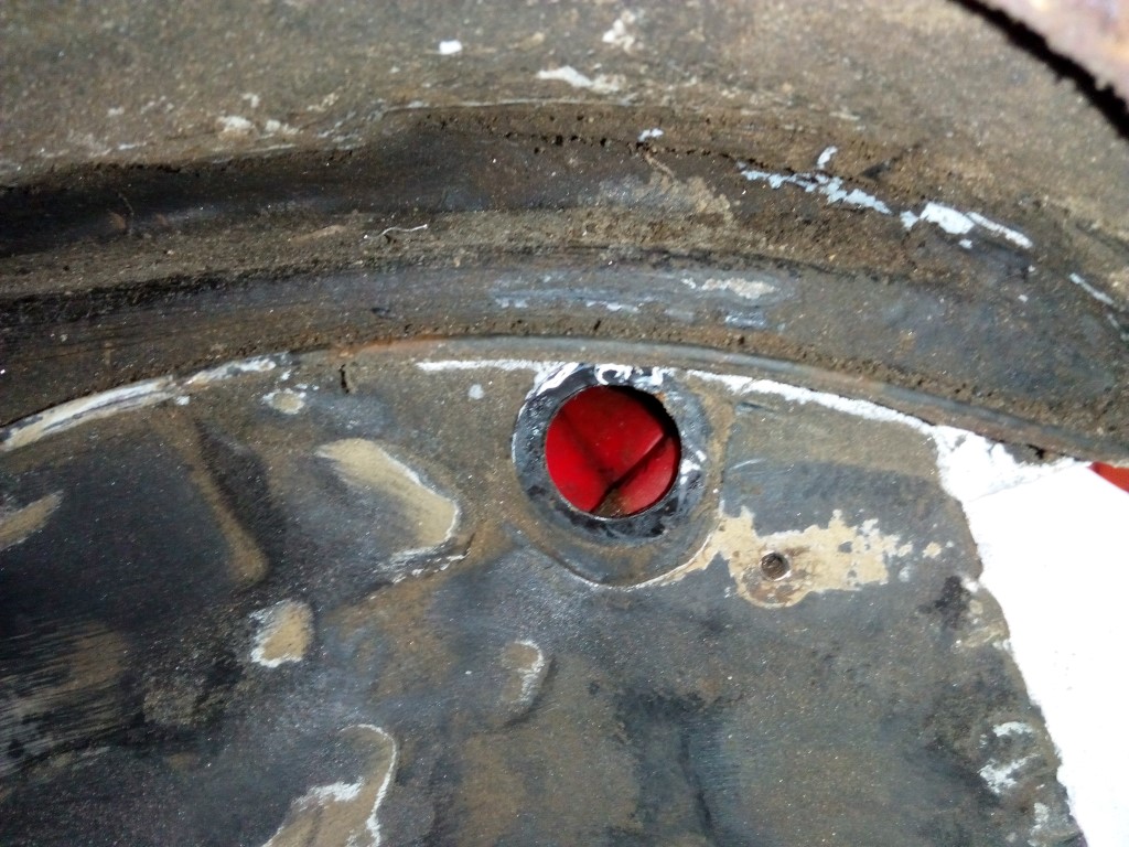

This inner wing needed work. I cut off the face, re-welded the captive nut on the inside then put a new skin on.
I then cut off the bulge along the front valence as it was pretty crispy along 2/3 of its length. I just lashed a flat sheet in its place. Its under the bumper out of sight and will be covered in stone-chip so no need for prettyness.

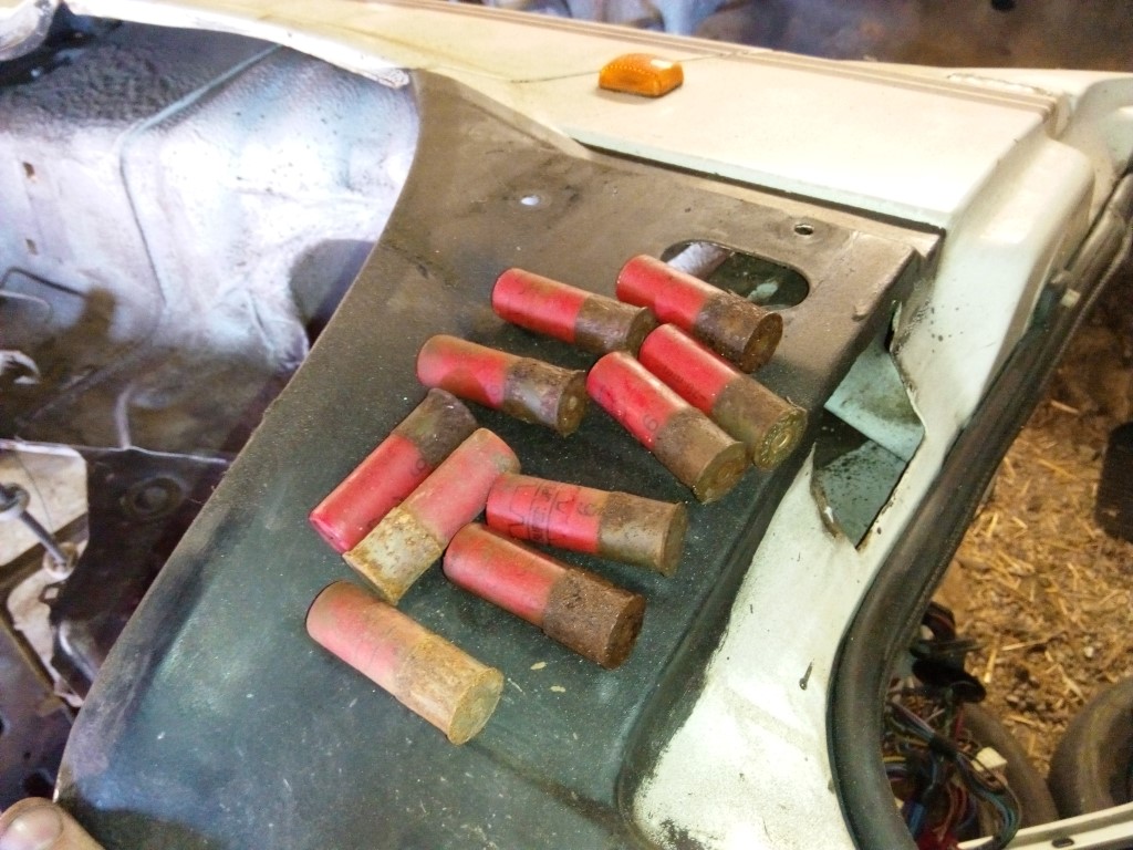

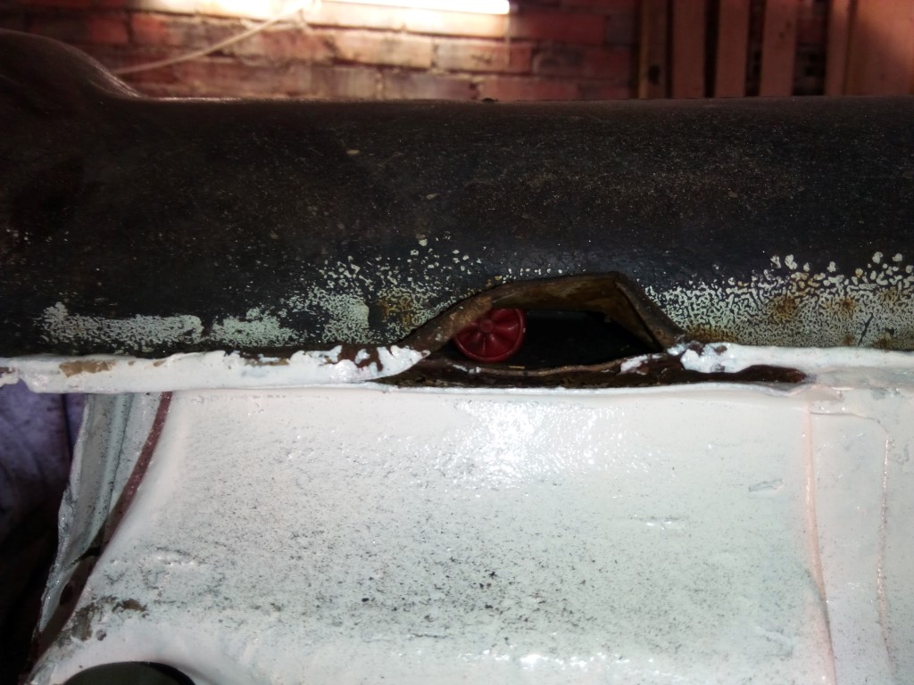

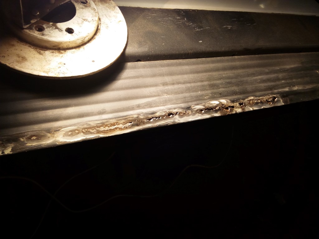

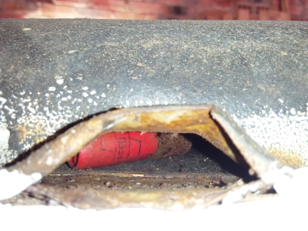

The other sill needed a little spot of welding here and there at the ends which I was happily plodding away with when I noticed something....
whats that?
Looks like a.....surely not?
Yep.

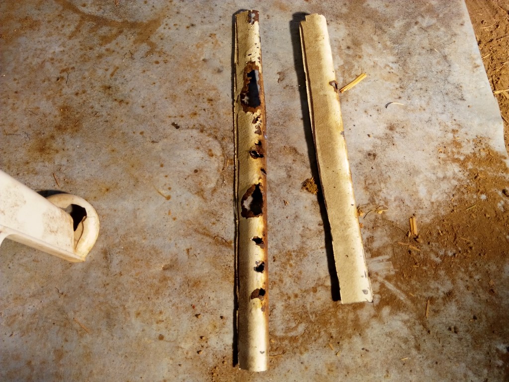

Through the grommit in the end, there are loads of them...

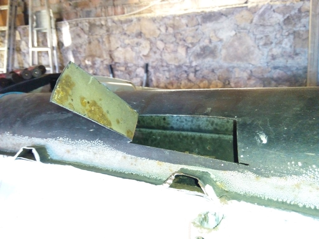

kinda dangerous when welding nearby, I would think. So I cut a hole...
And found quite a lot...
along with the soggy remains of their cardboard box. It looks like the previous owner was a hunting fan and dropped a box of shells down one of the holes in the boot, probably where the seatbelt mechanism sits.
:roll:
That would have been an unpleasant surprise with them enjoying the heat!
The other sill needed a little spot of welding here and there at the ends which I was happily plodding away with when I heard a massive bang and shat myself....

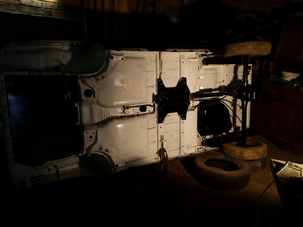

Its nice to start putting things back after a big dismantling. Pez tank, prop shaft and support, rear axle, brake line and handbrake cable re-fitted.
Looks nice.
The rear axle isnt fully on as I am still waiting for the gear shift gaiter and leaf spring shackle bushes I ordered from PastaBay.

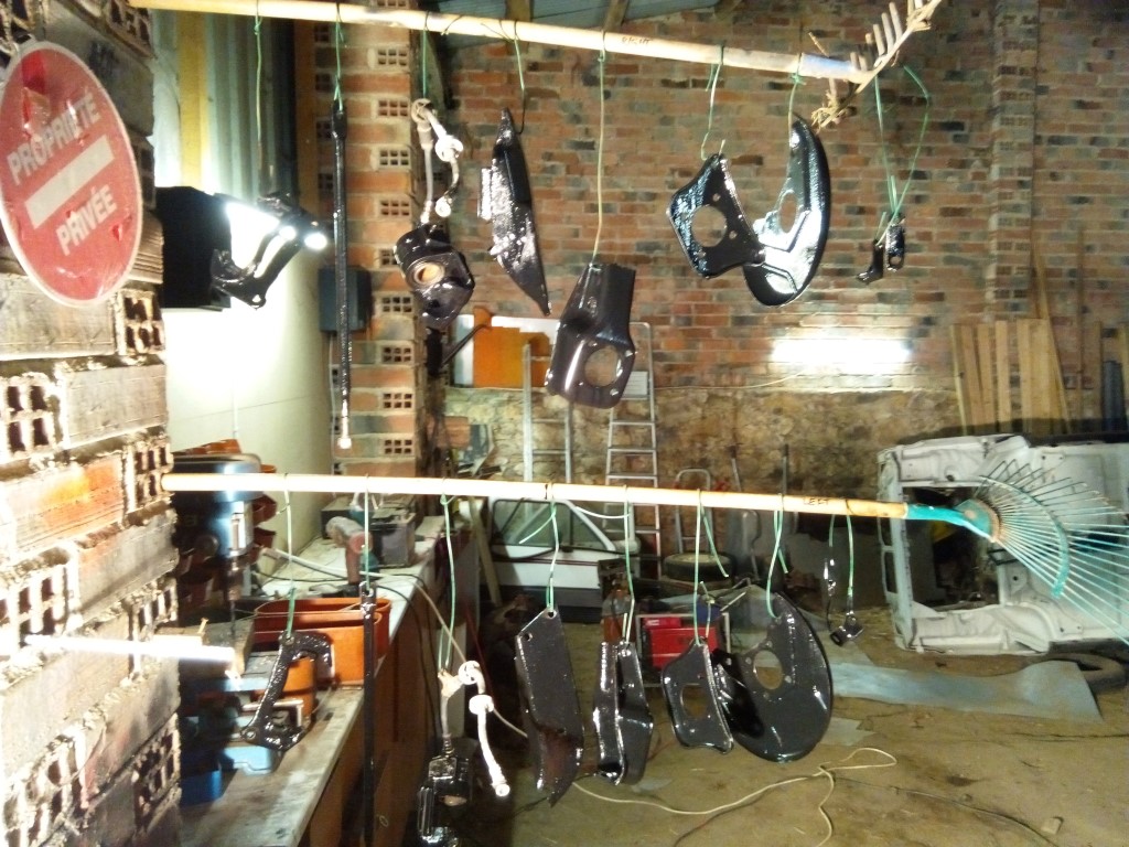

I then stripped down, cleaned and painted the bits I need to re-use from the front suspension....various brackets and stuff.
The calipers were strange - neither piston would slide back in at all, even with a proper tool to wind them in. I unscrewed the flexis and a grease gun fitting is the same thread pattern so screwed one in and filled the gun with brake fluid. It took a fair bit of pumping, then it suddenly popped and moved out, and could then be pushed back in quite easily. I took the pistons out and there was no corrosion on them so I assume the seals must have dried out a bit and stuck. Anyway, seem to be working now.
Some painted bits....

Back home I turned the shell back onto its wheels and I got this bit of scuttle trimmed down and welded in and theoretically thats the welding finished.

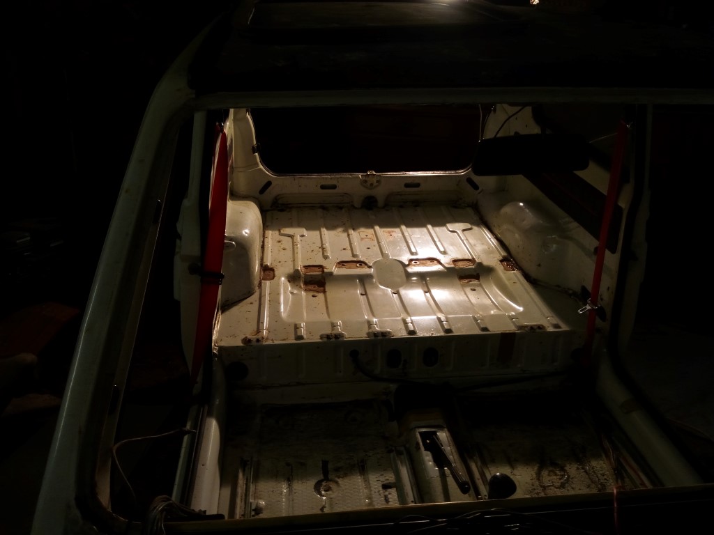

The boot and rear seat area came up nicely. I never tried too hard on the front floorpans as they will be covered in carpet again, so Ijust gave it a good hoover and quick wipe over.

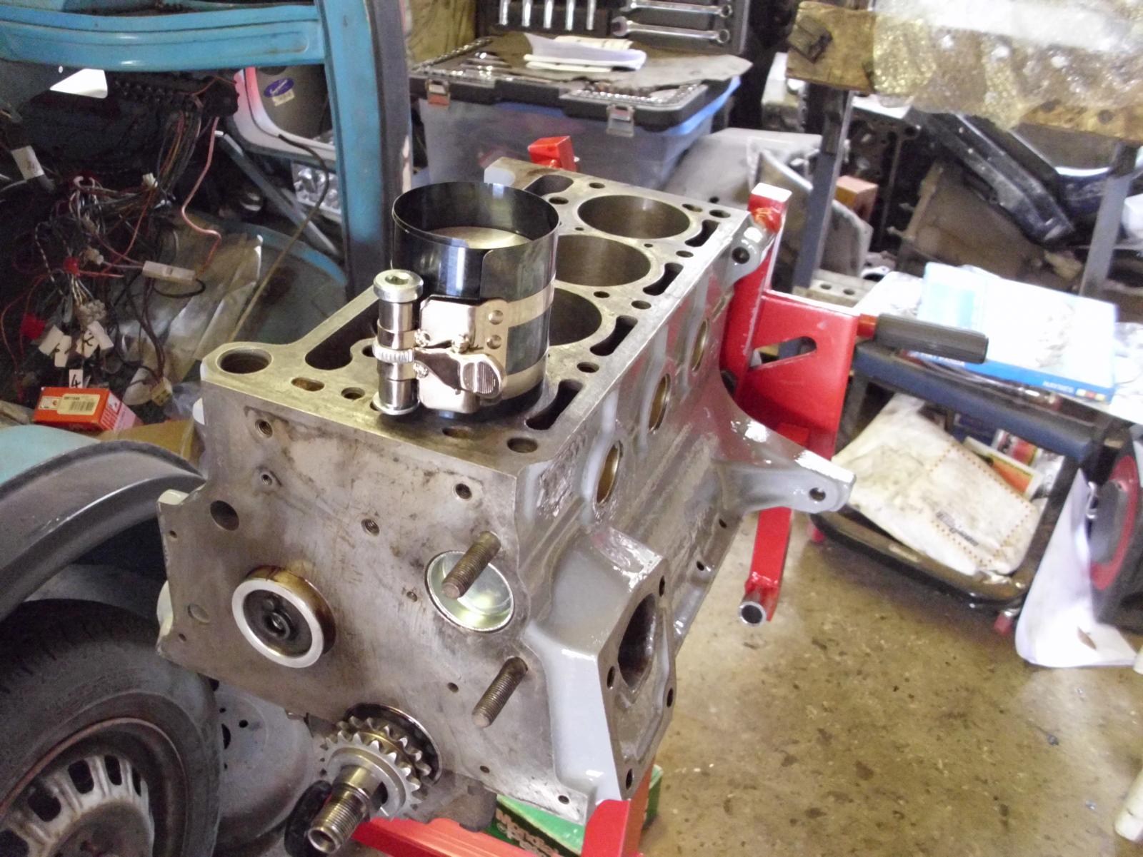

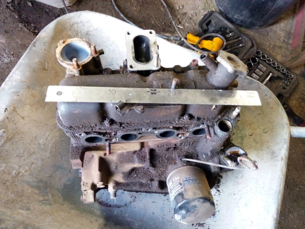

I then set about the engine bay, which was really minging with thickly caked on oily goop. I had hoped it would clean ok and not need painted, but there were a lot of scratches and various bits of missing paint including a lot under the battery location probably due to acid spills so I scraped it all, degreased it and painted the lot. Would have been neater to remove the master cylinder and brake lines, but meh....im lazy and this isnt a concours competition.
I then removed the extra bits from the engine and set about cleaning it up. this is probably the smallest 4 cylinder motor I have seen - thats a 35cm ruler across the rocker cover.
Snowing? perfect time to set up the jetwash and soak myself with oily splashback and kill off a circle of grass with petrol.
It has come up ok. I am drying myself in front of the fire and waiting for the engine to dry and I will probably paint it black.

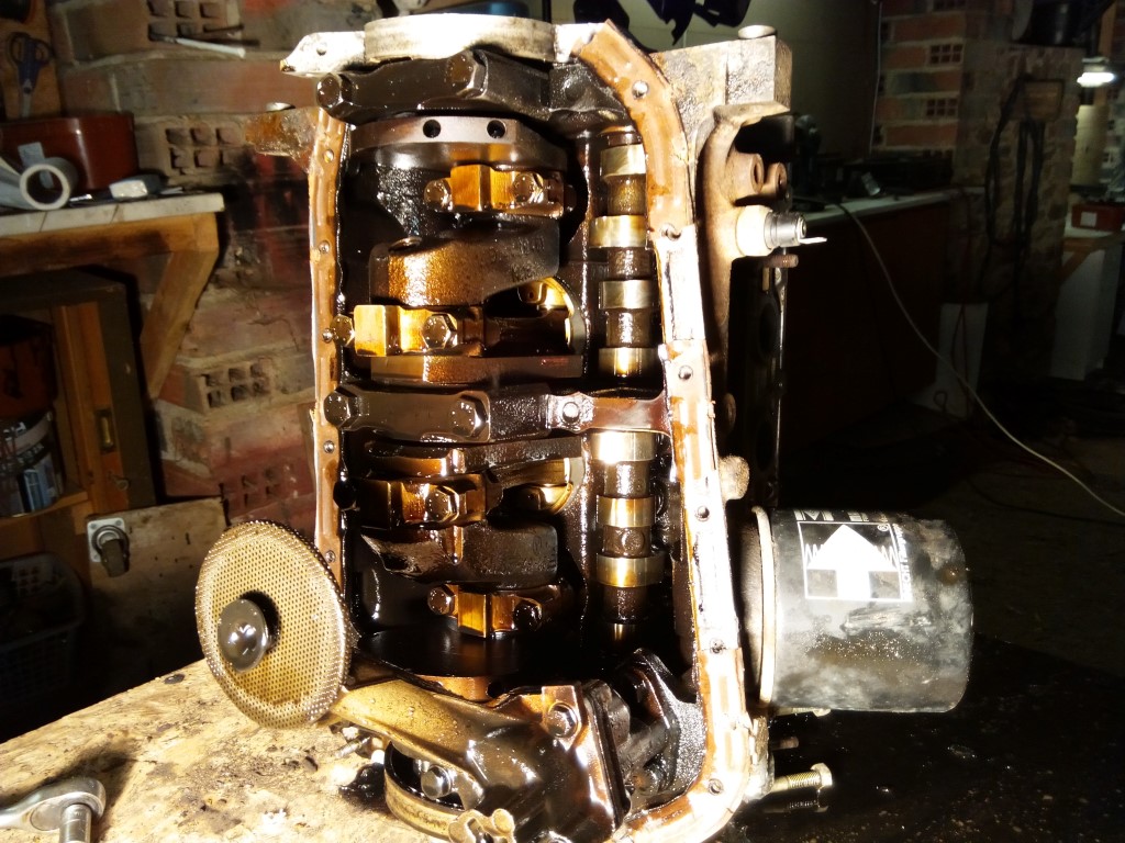

I took the rocker cover off the engine and it was thick with nasty black sludge....I guess the poor Panda hadnt had an oil change for a while, so I decided to take the sump off while I had it on the bench to clean it out.
Inside the sump was clean enough, but it came with some bonus parts....
A broken circlip and a random bit of metal. The only circlips I can easily see are on the rocker shaft and they are present and correct so I will have to assume this one was lost during a previous job on the engine and just left.
I got the crank oil seals out. I will check that site you listed Vin, and see whats what. if not I can probably find stuff locally at a bearings and seals place - they seem to be fairly standard sizes.

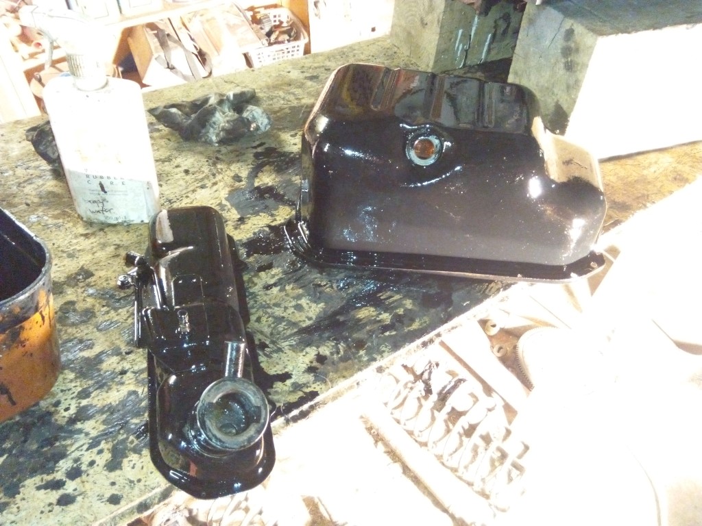

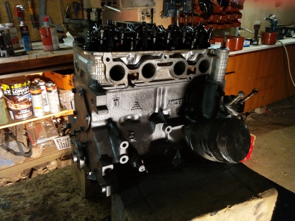

Gave the block a quick skoosh of high temp paint - I only had anthracite to hand so thats what it got.
I did the sump and rocker cover in normal black, which shouldnt get too hot.
(needs another coat of paint)

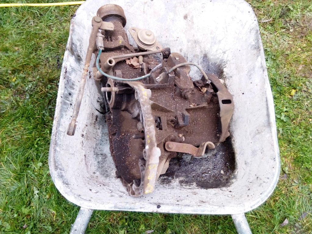

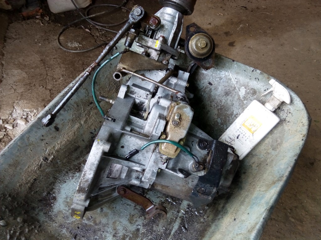

I then jetwashed the gearbox.
Its got a scrapyard yellow paint pen date on it, so must have been changed in the past.

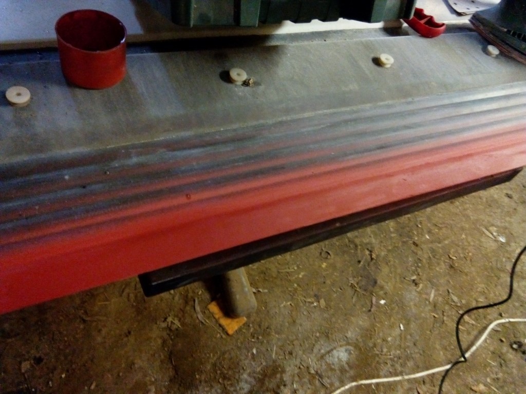

I took the rotary wire brush to the bottom of the rusty door. Its got a lot of holes along its length but just the outer skin so not catastrophic.
Buffed it down and hit it with rust killer.
Skim of wob.
Sanded it down with my palm sander as it doesnt have to be perfect, then hit it with a squirt of red oxide.

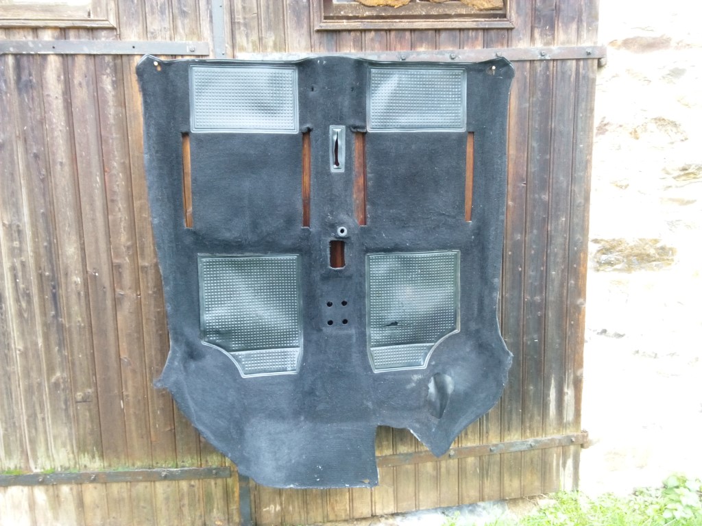

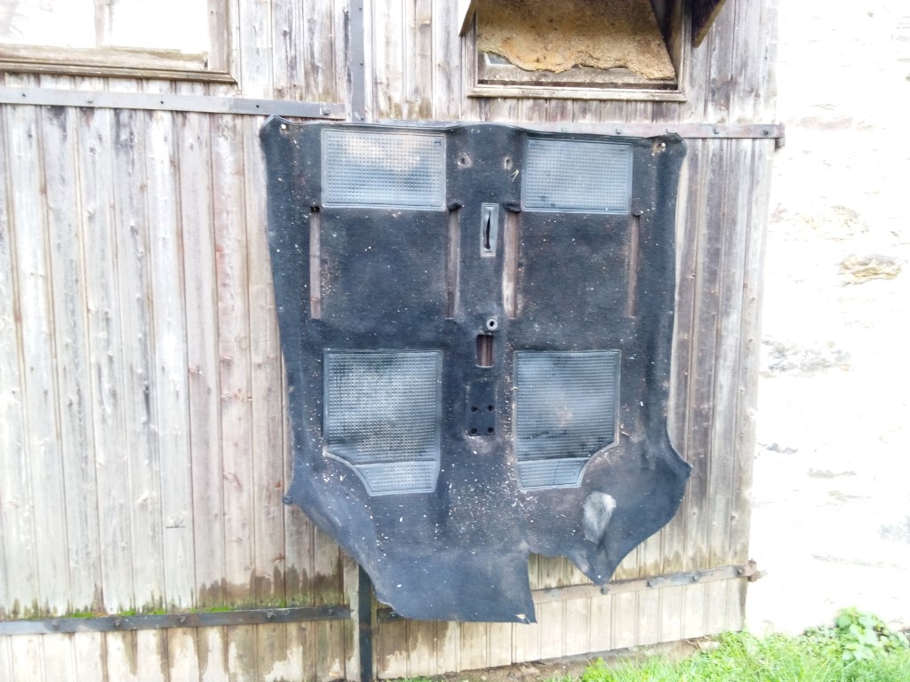

I then set about cleaning the carpet.
Step 1 - nail it to the garage door.
Step 2. Jetwash the fuck out of it then use the wetvac. Repeat.
Step 3, Wrestle it into the kitchen and prop it up in front of the wood stove. The joys of being single.....

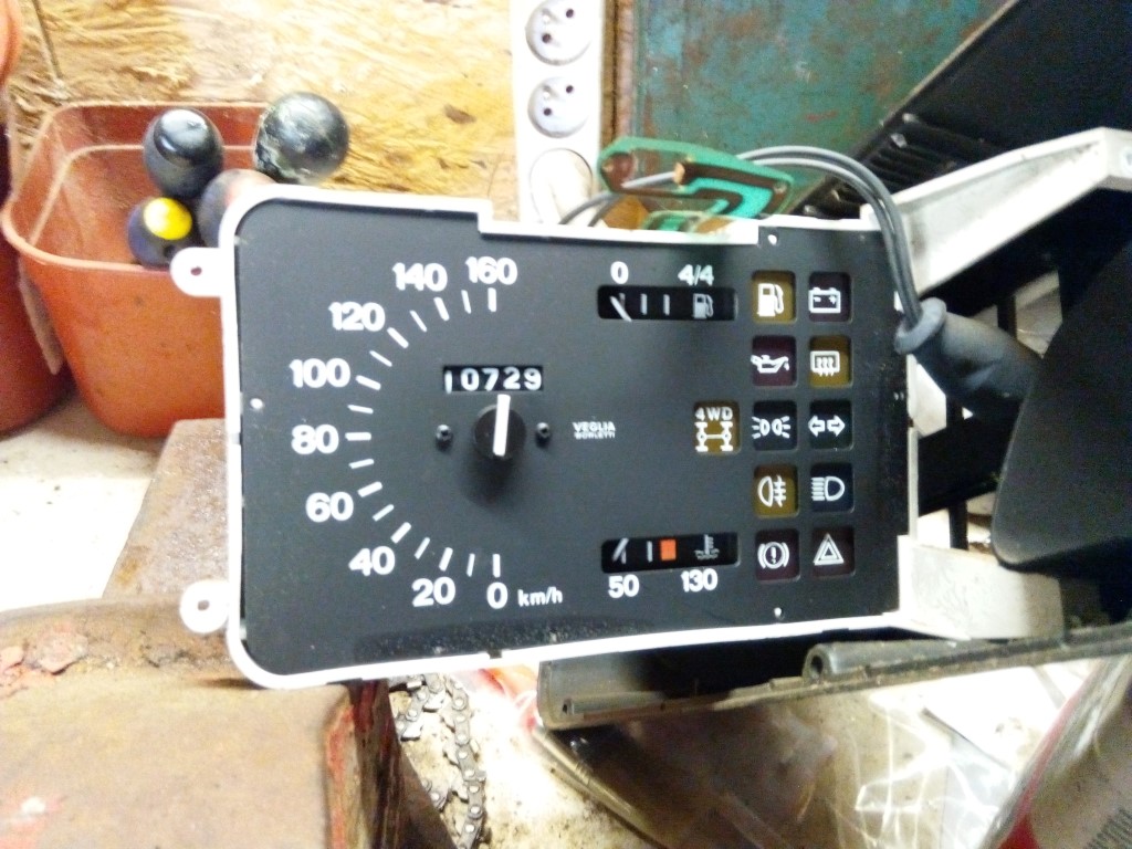

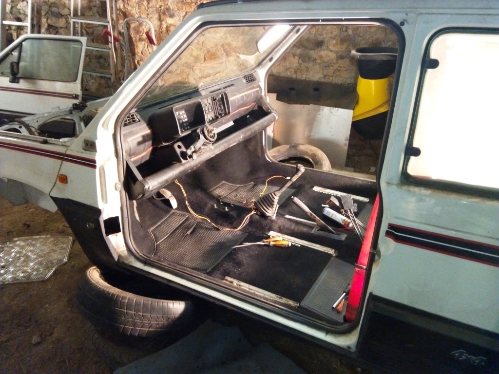

I then set about putting the interior back together, but before I fitted the instruments I took the clocks apart; not for a haircut but due to a sticky speedo needle. It had warped and was jamming on the perspex cover so it never dropped below 40kph, so I went to ever so gently bend....*snap*....fuck.
I spray painted a bit of plastic white and hot-glued it to the hub. Looks pikey as fuck but will do for now.
Soundproofing in, carpet in, dash on. The dash is a hammock type of thing fixed to the bulkhead and the lower dash rail and just hangs loosely. The dash doesnt site very well, it has either shrunk or is rumpled up so it doesnt reach the end caps.

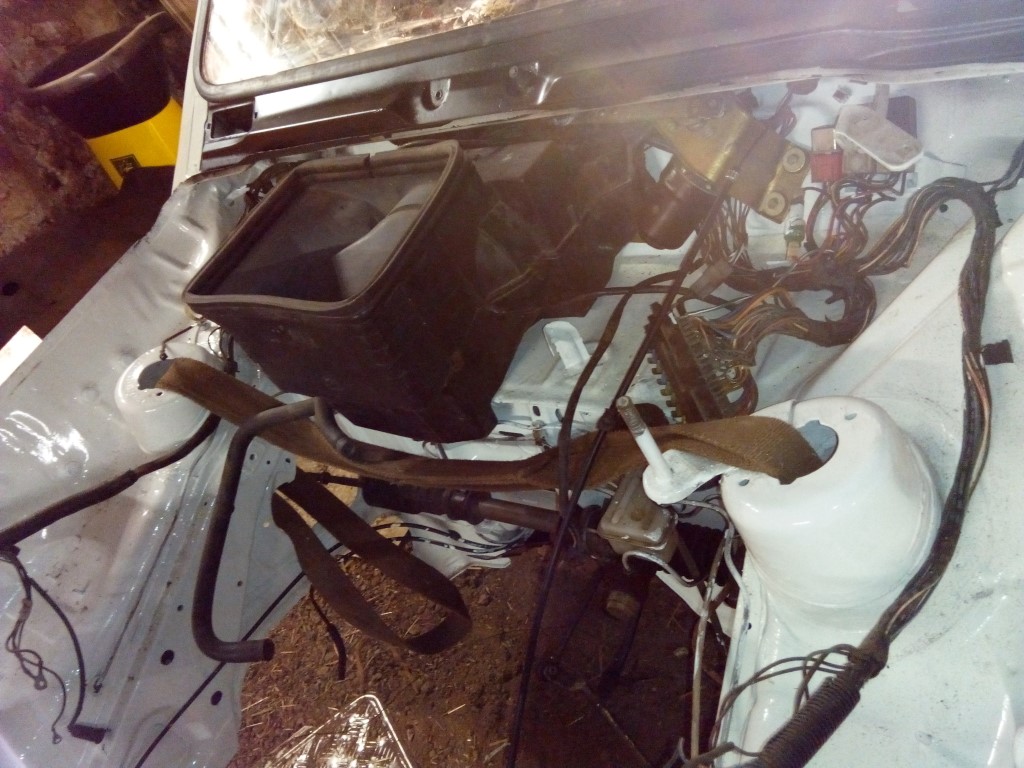

Under the bonnet I got the heater box in, wiper motor and a few other wee bits.
I got the new windscreen in without incident too.
