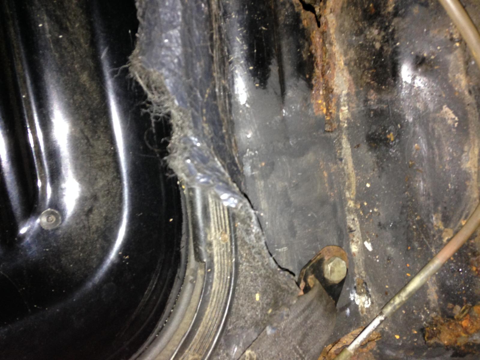

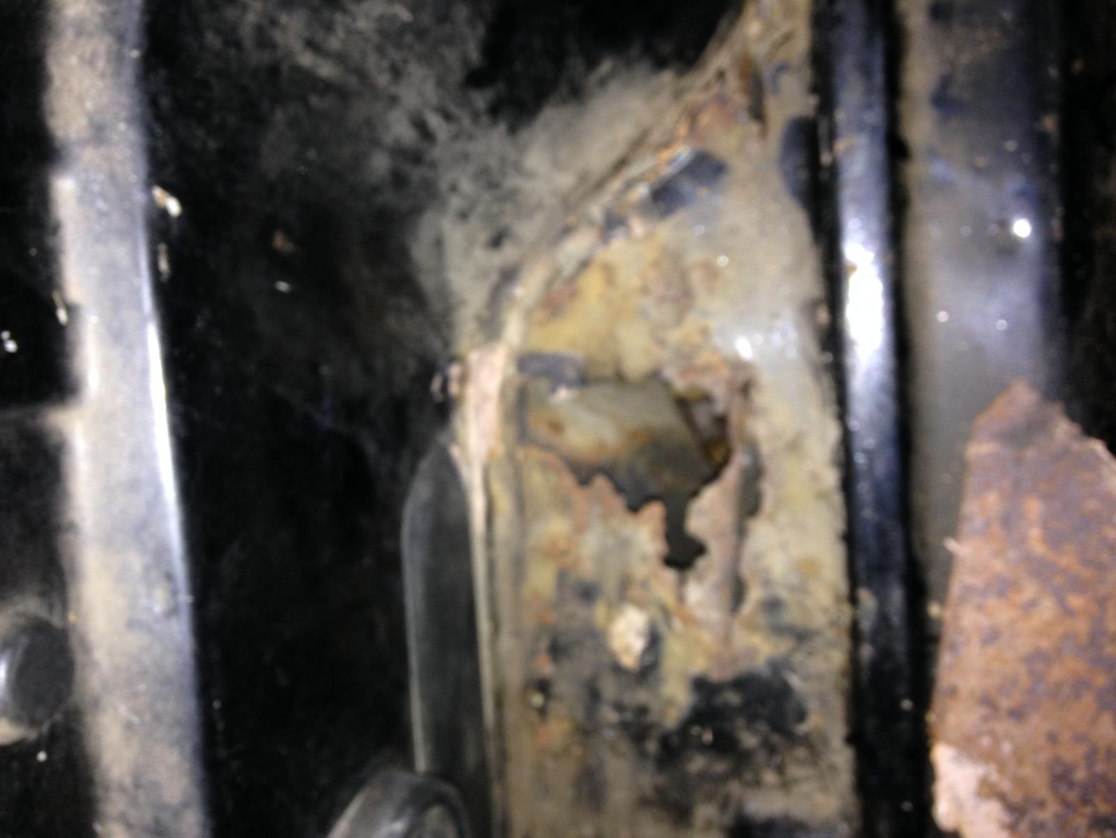

I wanted to start work on this today, you know start cutting out the rust but rain has stopped play. There is a lot of rust, realistically this should probably not see the road again, the rust is pretty bad.
look how the floor is not connected to well anything.
ok, this is not pretty and it's not had any mention of rust in the last several MOT's so there can't be much more, right? oh look this looks like it's been 'repaired' before, a quick clean and lick of paint  should see it right again.
er, hang on it seems it's just been stuck on with a bit of body filler..
leaving this massive hole! where you can see outside.
plus other various repairs over the years and it's disheartening, especially as I can't weld! oh yeah I have a mig welder that I got a year or so back but that's as far as my skillz go, I have a few of the necessary tools!
I really want to get the car on the road and really don't mind having a crack at the job, Maybe one for the stupid question thread, with my welding skill would it be acceptable to just cut the rot out and plate on top of the good metal, nuch like the repair done on this pic by previous owner? by the seatbelt mount.
My opinion (FWIW) is that you can plate over but the weld still has to be continuous. Other people and your MOT tester may not share this opinion.
Ooh a Panda 'Dance' - Mk2 (Apr 86 on) bodyshell and suspension but with the earlier 903cc pushrod motor...
It's a shame, but that looks like all the usual panda rot spots have been affected...
Good luck with it, whatever you decide to do...
1 - Learn to weld
2 - Fix car
3 - well, there is no 3.
This is a good chance to learn a useful skill. While its possible to teach yourself MIG, an hour or two of instruction from someone who knows will help hugely, if you know somebody nearby.
Im not really visualising where the stuck on bit was, but the floor and inner sill rot isnt too bad going by the photos. Some flat steel and patience will see it right. You could do it either way....cut the rot right out and but-weld in patches that sit flush - this is harder for a novice, or you can cut out the rot and fit a larger patch over the top. Either way will need continuous welds all the way round for the MOT man, but the second way is easier. Its not likely to be a concourse restoration anyway, so I wouldnt worry too much. If your welding is solid, seam sealer and paint can hide a lot of cosmetic sins.
A hole you can cover with your hand isn't massive. Get on with it lad, you could weld round that before your tea goes cold!

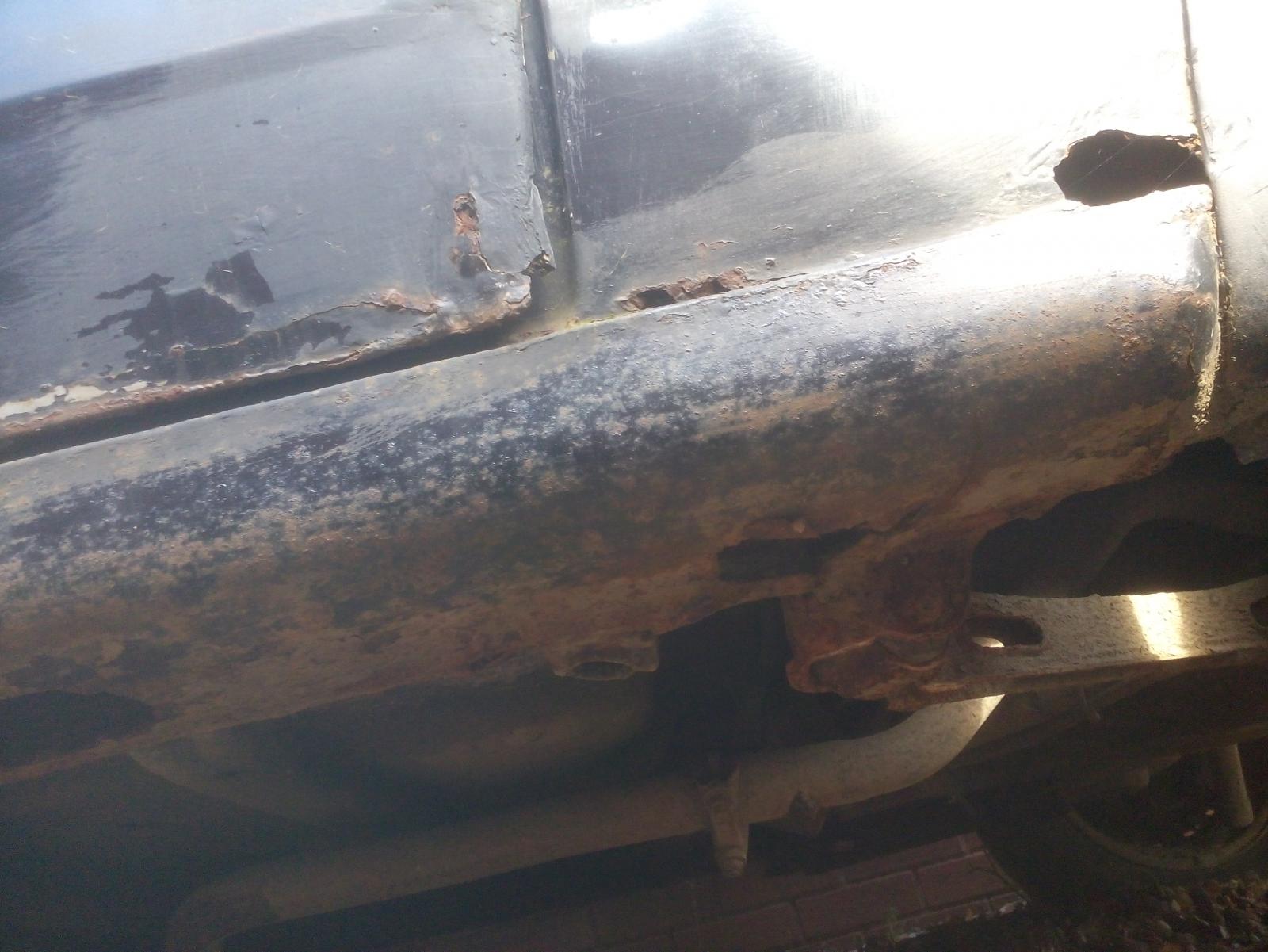

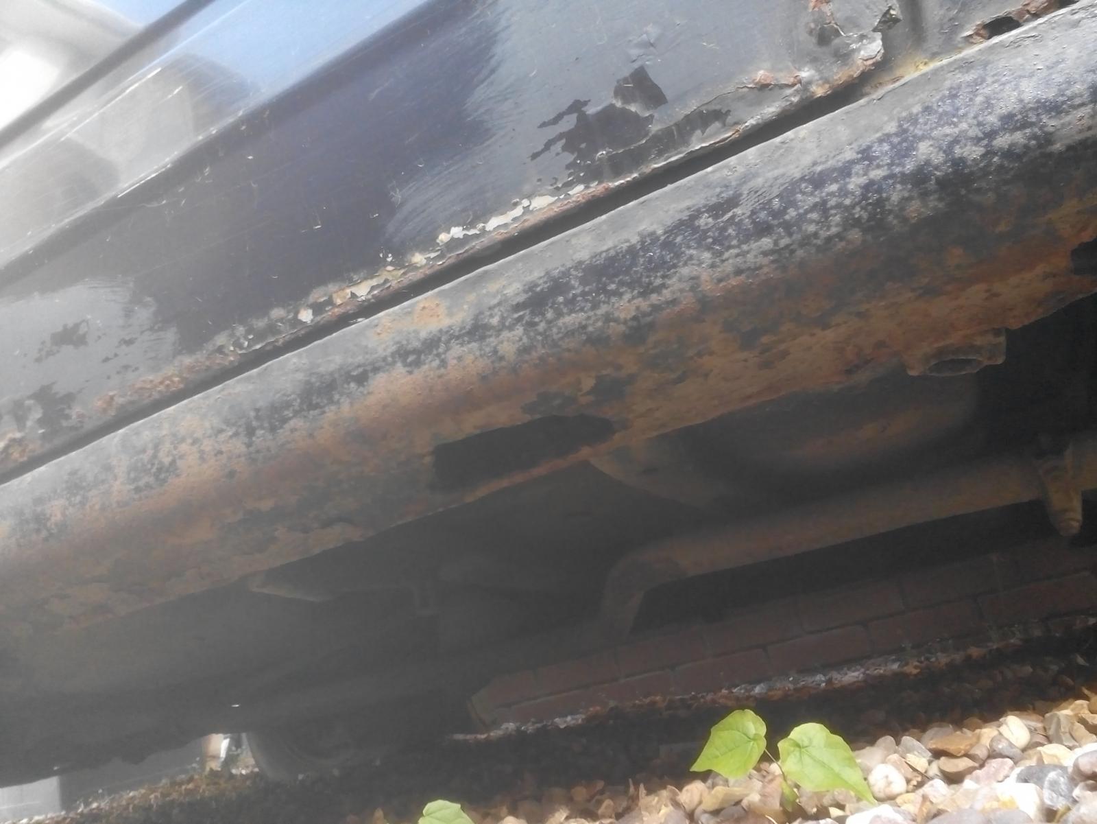

Sun was out yesterday, so I decided I'd bang a couple of pics of the panda up for spares on a facebook page, a few replies but no bites. unsurprisingly?
yesterday I'd have sold it for £100 quid, today I feel like I should invest some time and money into the old girl, both of which I'm lacking!
pics of the one side, I cant get to the other side as my neighbours have built a 6ft wall, I assume it's much like this side, fucked.
so anyone fancy a welding project? tea, biscuits and possibly cake provided.. ha.
Was the 6ft wall built in response to the arrival of this lovely car ? Have you sourced any repair panels ?
