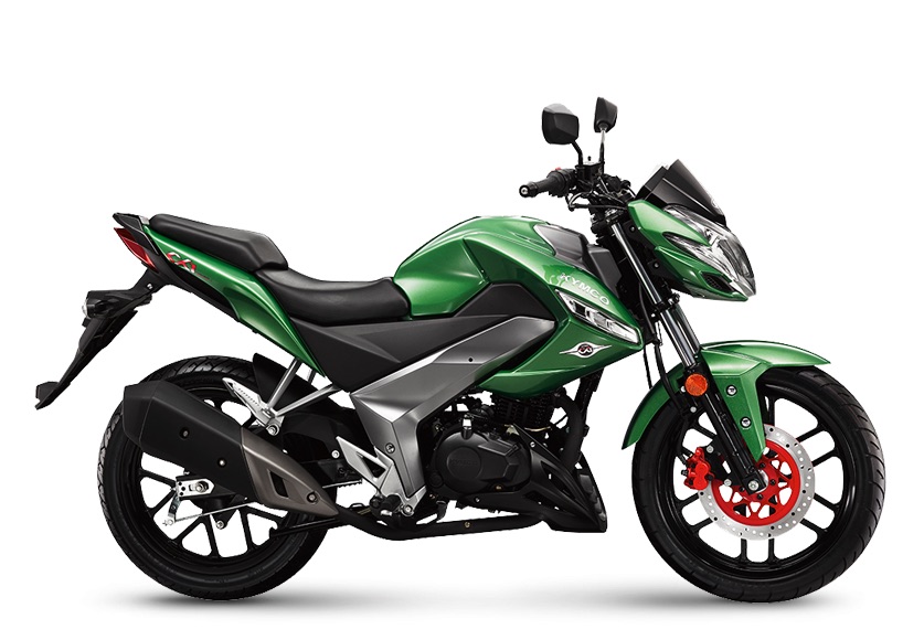

Have a look at Kymco bikes. They are Taiwanese and they seem to have got the hang of this "build quality" mullarkey. I believe BMW use their smaller capacity engines so must be fairly decent.
Their prices are low because peeps assume they are Chinese. But of the Chinese bikes (which won't be a joke in five years time) I think the Lexmoto previously suggested is a good bet.
I quite like the Kymco CK1 125 - two grand brand new!
When I was in Corfu last year all the quad bikes and mopeds that are for rental were made by kymco, so part availability should not be too bad i would have thought, and I guess they must be reliable and able to take some punishment if they are renting em out, I know the quad bike I rented took some hammer.
Now there's a coincidence I was about to say the same about Kymco and would also add SYM - both Taiwanese but painted with the all Chinese bikes are crap brush. They are not Chinese nor crap. This brush is so wide that it also paints Daelim and Hyosung who are South Korean and even better. Hyosung are one of the biggest sub contractors for the Japanese bike makers - in particular making many parts for Suzuki.

Not sure Kymco will want to publicise the fact that they make small engines for BMW due to the notorious hot starting (or should that be not starting) problems they suffer from.
But to repeat both are far better than the Chinese stuff.
