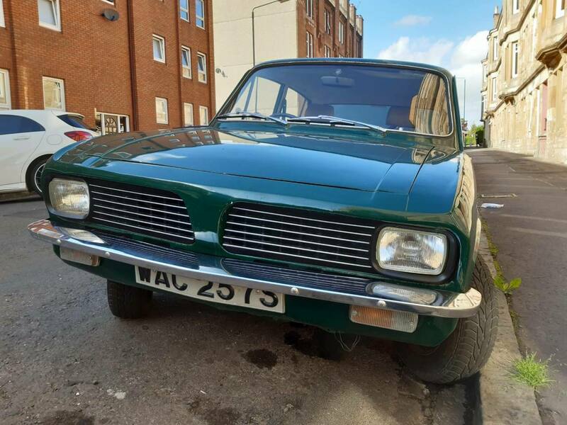

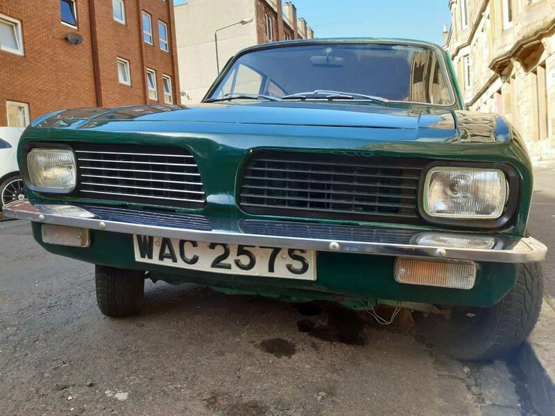

Silver Sharpie grille restoration.
300052604_433026332184414_8982968959440052451_n.thumb.jpg.1ec6dd6e1b8b4216a86b53e17139361a.jpg
To celebrate my neighbour reversed into the car while parking. I was digging stuff out of the boot at the time, she dashed off inside without saying owt. No damage, the joys of keeping a car on a public street...

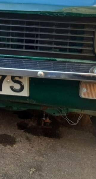

I thought I'd spotted something here
Screenshot_2022-08-22-19-13-45-23_965bbf4d18d205f782c6b8409c5773a4.thumb.jpg.47af3badb87b742a460dae3f29e4c857.jpg
Looks like someone's moved in and setup a small offshore rig under the engine
