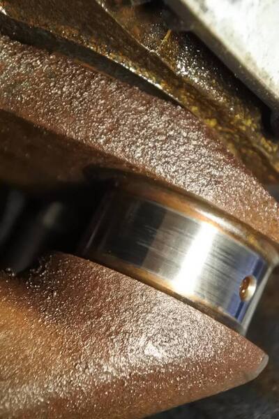

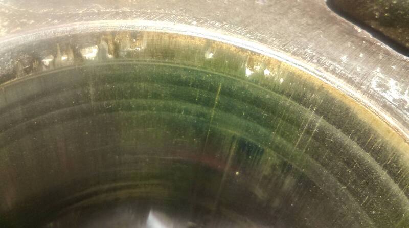

I took the sump off engine no.1 and pulled a piston. Nothing looks horrendously fucky.
People who've pulled an engine apart before feel free to comment and let me know otherwise. Regardless, I've run out of money big time, so if it'll run it'll be going in the car largely as is...

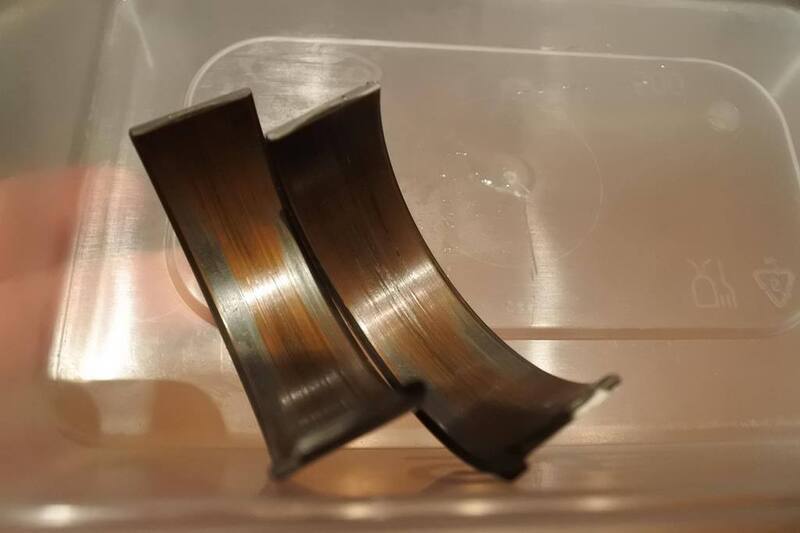

So what do the the actual bearings and crank surface look like? These pics seem to show a con rod with no shells in......and the back of the shells that are still on the crank?
Something like this:

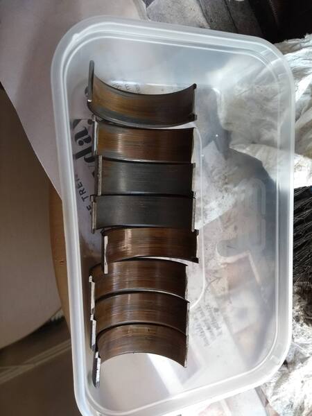

Verdict - Bearings well worn, crank scored and needs to be reground. I reckon something abrasive has gotten in there somehow. Bearings don't say anything on them to suggest they are anything other than the stock size so I doubt it's been ground before.
Current plan is reassemble and drop in car, unsure if I should even bother checking the other bearings given I can't afford to replace them regardless... New bearings are a waste of money as the crank is already scored badly enough that it'll just eat through them, I can't afford a regrind, or the bearings, or food. There is zero noticeable vertical play in either the big or small ends so I reckon the engine will go without catastrophic failure. In real terms the car only needs to do one round trip for welding of about 100 miles and can then be retired for the occasional plod around town locally to stop it from seizing up.
Save yourself the effort! Putting those shells back in on that crank will result in no oil pressure and a wrecked engine. The chances of completing 100 miles are virtually none, especially as it has been apart so will need to re-bed in, taking off more metal. If you cannot afford to do it now, either lay it up until you can or, sad as it is, sell it.

Those bearings have had it.  There's absolutely no point in putting it back together to only have to do it again in twenty miles time.
It *might* have spotted on for a while longer like that had it not been apart, but I'd be very surprised having been disturbed if you'd ever even get the oil light out on the first start up.
Save up until you can afford at the very least a set of shells, or stick a wanted ad in the appropriate section here...enough folks work on these engines someone might have bits laying around they'd be willing to give you or sell cheap.
If it's this or food though, I agree with Saabnut.  Blind stubborn optimism can go a long way(and featured heavily in my early days of motoring), but it has its limits.  It seems to me that the time to take a step back and consider what the sensible way forward here is.  Trying to keep multiple creaky classics running with the time, space, working area and money you seem to have available just now to me seems like a recipe for a mental breakdown.  Worth noting that breathing the fumes from decades old engine oil 24/7 really isn't good for you either...

My issue with fitting shells is that they'll be sacrificial given the scoring on the crank. If I'm doing the shells I'd be as well getting that reground and gaining them some longevity. I love half arsing things as much as the next man but even I have my limits.
Of course once that junction is reached you're into proper rebuild territory and the game of "if I'm doing X I really should do Y" begins. After work tonight I'll pull all the pistons and get the crank out.
thats it mate, if the big end shells are shagged then the mains are probably too, plus these engines never did mega miles, 60k for a rebuild back then was average.... plus the days of getting bits are long gone at cheap prices

Now I've seen a close up of the shells and crank the difference in what you can see is night and day, which is a shame as the rest of the engine looks useable. Just to get the car mobile it will be fine reassembling as is, but it really won't last long; I'd guess 1000 miles tops in the current state.
Bottom end shells and thrust washers aren't as expensive as I would have expected - depending on part number - around £75-100 for the total bottom end from Rimmers but that doesn't include any regrind costs of the crank journals.

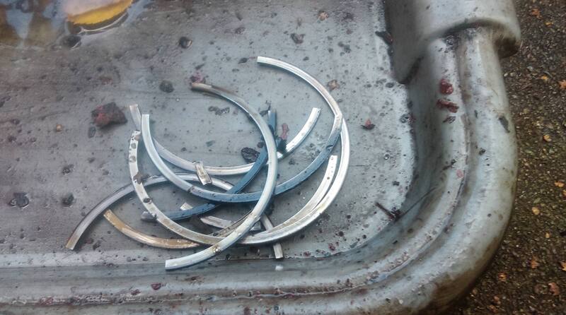

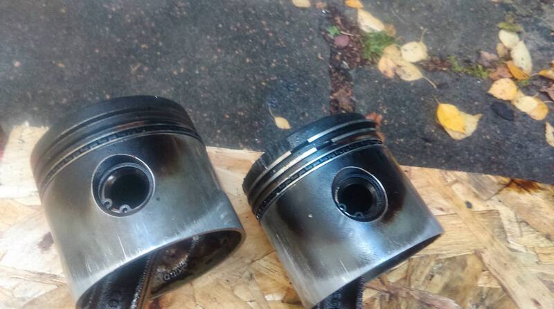

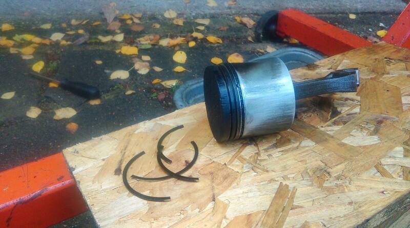

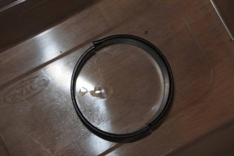

Sort of echoing the above and being a serial Triumph bodger this is what I found last time I took mine apart. I was getting a small misfire at low revs but it still went well once you were up and running. I found no 3 cylinder had much less compression than the others. This might be why. IMAG0166.thumb.jpg.9b4aad7950ec8d575a93519e0a6cc1fc.jpg
But it wasn't just no3. After pulling all the pistons out I was left with these. IMAG0167.thumb.jpg.6e110f8498187d97296520c28ab9dcf2.jpg
The top of no3 piston and cylinder both had damage at the top IMAG0174.thumb.jpg.47ee67a6897a5af89b2b13ab41216684.jpgIMAG0171.thumb.jpg.9c863e3daf1baa0a93e1ab62d3b2f8a8.jpg
But as it was above the piston ring line it didn't matter.
I ended up with a rebore and new plus 30 pistons but even with all the broken rings the engine was still running quite happily once you wound it up a bit.

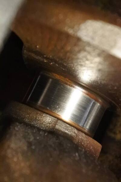

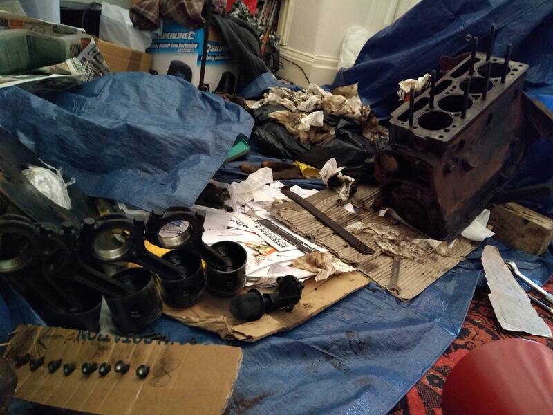

Whipped the piston out last night.
No.2 apparently missed the memo on badly wearing. It's the only crank surface which is nice and smooth.

Ouch at those shells! Worse than the 1100 engine. Are they originals or oversized?
What state is the inside of the oil pump like?
Can't see any markings suggesting they're oversize.

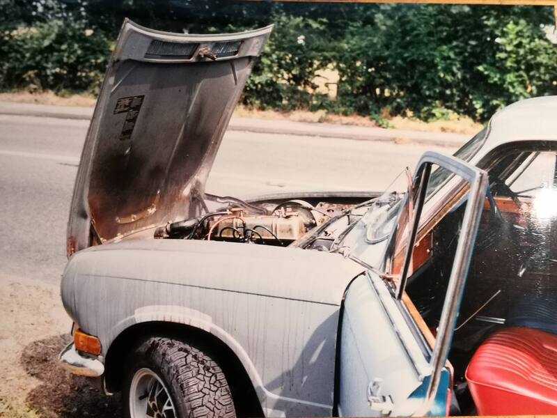

By the way, not entirely unrelated, this is what OMGHGF looks like on a Triumph 1300.
Not the same issues as yours but it had to be recovered home. This was 1994 but I have just found this picture whilst looking for something entirely different.
