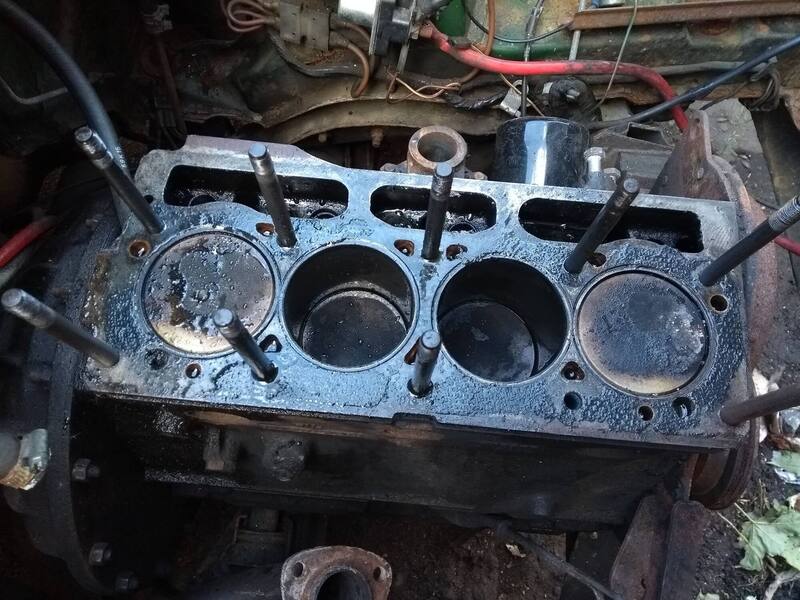

I then took advantage of the nice weather to remove the cylinder head on engine no.0...

Removing the head was the only real pain. It was stuck fast to the block, mullering it with a rubber mallet had no effect, heaving on it while standing in the engine bay just lifted the whole car up... Eventually I got angry and found a paint scraper...

Destruction of the gasket coupled with standing in the engine bay and heaving finally got the head off. The observant amongst you will notice a missing valve spring, I accidentally caught it with the rubber mallet and sent it to the stratosphere...

Wee bit of carbon build up on the exhaust valves then, understandable given the obscene oil consumption...
The main issue however is this:
As much as I'd like to claim variable piston timing is the new VTEC I suspect the fact no.3 is out of sync with everything else and the associated clunking suggests a complete lack of big end bearing and a mullered crank. The engine still turns freely amusingly enough, everything is still connected, just not quite as tightly as you'd like...
Now I have to decide on a course of action. Ideally engine no.1 needs a proper rebuild before getting swapped into the car, handy to do while it's not actually in the car. However the reality is I have no money for that, there is also the fact the car has now been sitting for the best part of the year and I'm increasingly worried it's going to be towed as abandoned or neighbours are going to get angry as parking space is getting more and more limited. I really want to get it movable asap so I can do the urgent welding it needs.
Currently I'm thinking of doing a quick and dirty hone of the bores and keeping the stock pistons and rings, re-lapping the valves and stripping the bottom end swapping out the big end and main bearings for new stock sized ones if required. The rocker assembly, missing/bent studs, dizzy, manifolds, carb, water pump etc can all be salvaged from engine no.0.
That'll get me what? 10-20k miles of half decent engine? For me that's going to be 3-5 years or motoring, by which time I'd like to think I'll have a better job, hopefully a driveway, perhaps even a garage in which to do a proper rebuild...

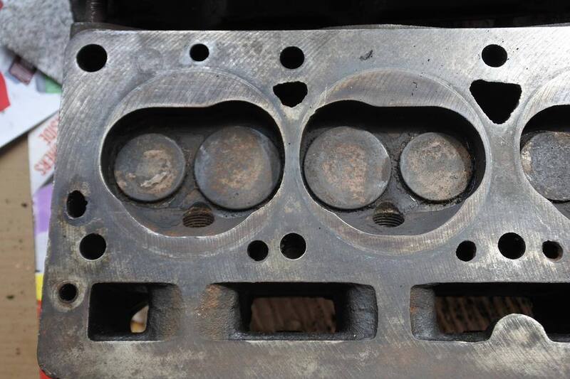

Head No.0
Head No.1
Initial thoughts:
The original head has damage around cylinder on.2, valves are sitting much deeper in the head than on the other one, valve springs are indented in the head by a considerable amount (normal?). Pretty sure it's never been machined before.
The new head has a coolant pipe coming out the top where the original doesn't (do Spitty's shift their coolant in a slightly altered manner?), valves sit higher in the head, coolant passages are unevenly shaped. Looks like it's been skimmed at least once, possibly the reason the coolant passages are weird if the nice edges have been skimmed off?

both need a good clean, de-carbon and the valves ground in... if either is unleaded then great, if not trip to bayron classic engineering for new guides and seats
