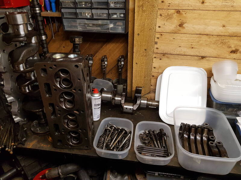

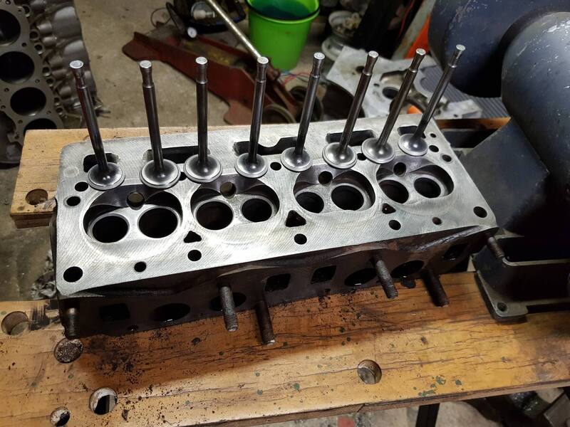

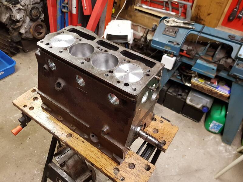

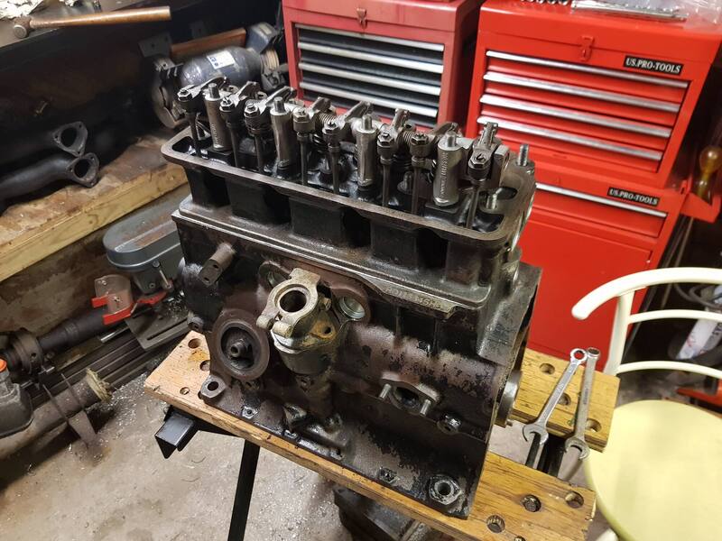

Yes, I built a new engine, and by I built an engine I mean I had a man build an engine for me, and that man was @Jikovron
Essentially the bedroom based is entirely rebuild-able for not all the monies and I still fully intend to do such, but it isn't currently practical to do so given my lack of facilities - That is is now going into long term storage (either under my bed or in the basement I'm not supposed to use). Mr @Jikovron saw a 1300fwd motor local to himself for much cheaps and asked if I'd like to purchase it, so I did.
Now, there was some worry about the fwd engine not being compatible with the rwd running gear but we've done a few measurements and comparisons between the engine he has and the ones I have (especially with regards the crankshaft) and have yet to find any evidence that it won't fit, even the dipstick position for rwd cars was still present in the block, just plugged. This engine also has the added bonus of being a pre-rationalisation engine with a better bottom end, so the decision was made to build this one.
Now, I've not been present for the build and @Jikovron has all the details but so far the engine has had a re-bore, new pistons, skimmed head, re-ground crank, new bottom end/small end/main bearings, new thrust washers, new tappets, timing chain and tensioner, new seals and core plugs, oil gallery plugs were removed and the galleries cleaned. The remainder of the work is fitting the Dolomite specific bits and putting it in the car. Needless to say I now owe him a respectable amount of money (although less than either of us thought), and endless gratitude.
Now I just need to get said engine from near Chesterfield to Glasgow. Doesn't need to be any time particularly soon although I'd like to get it in the car come Spring. Anybody travelling this way with a free boot? ;) I'd go down and get it myself but by the time you factor in fuel costs and time it is pretty much cheaper to have is sent by Shiply, not to mention if I took the Acclaim the weight would be a killer. So I figured I'd ask here on he off chance one of you fancy popping by for a cup of tea!
TL;DR - I had an engine built that might fit the car I need it for. Anybody want to move it several hundred miles?

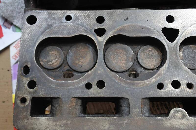

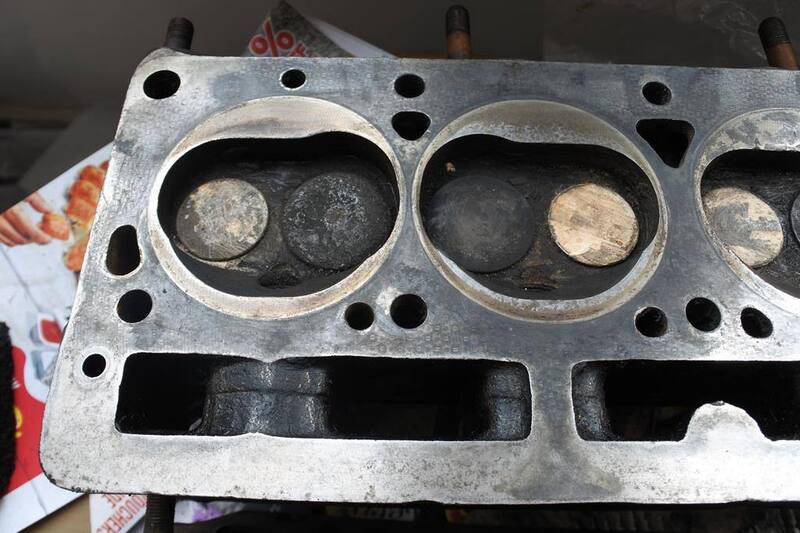

Having had a closer look at the skimmed head, are the corners nearest the camera (circled in red) supposed to curve downwards like that? Could they be a potential leak spot later on?
6 minutes ago, SiC said:
Is that not just from the curvature of the camera lens?
I'm not seeing curvature anywhere else on the head, so is it the lens?
It's not a optical illusion ,nor is it curved upwards lol.
it's where the raised inlet/exhaust boss meets the  HG face so it flares outwards.
Can confirm, the two heads I have here are the same to varying extents, they just catch the light oddly.

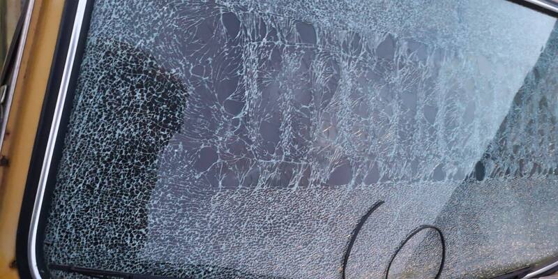

I was half arsedly pondering various plans for 1850 repatriation yesterday. Today I got a text "frost shattered the windscreen last night"
Naturally. That'll be the rot in the screen surround I should think...
I wonder if that is how my Dolomite screen cracked previously? I know it has because there was broken glass down the dash and the windscreen has a tax disc holder with National Windscreens on. Afaik replacements are available off the shelf.
Could be. The 1850 had a toughened screen from an earlier car because it had an MOT fail chip in the original laminated one when I bought it and I just fitted whatever I could get my hands on and they don't have much forgiveness in them for pressure.
Certainly back then the word from the TDC was that the supply of new screens had run out about a year before, not sure if the situation has changed since.
