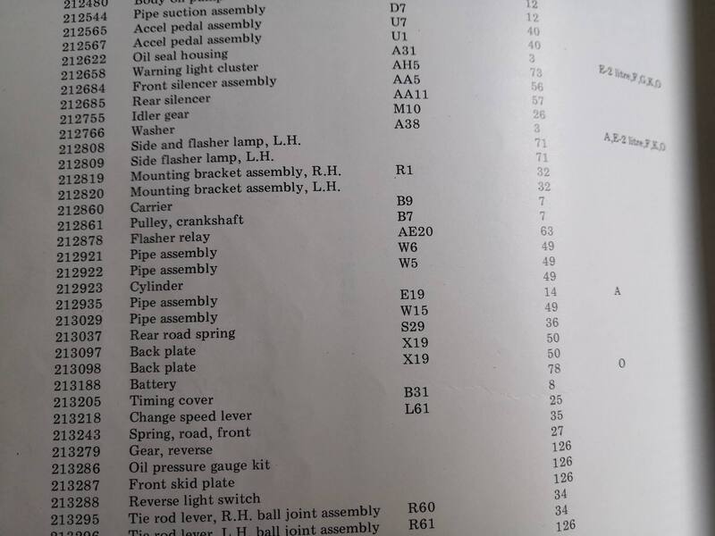

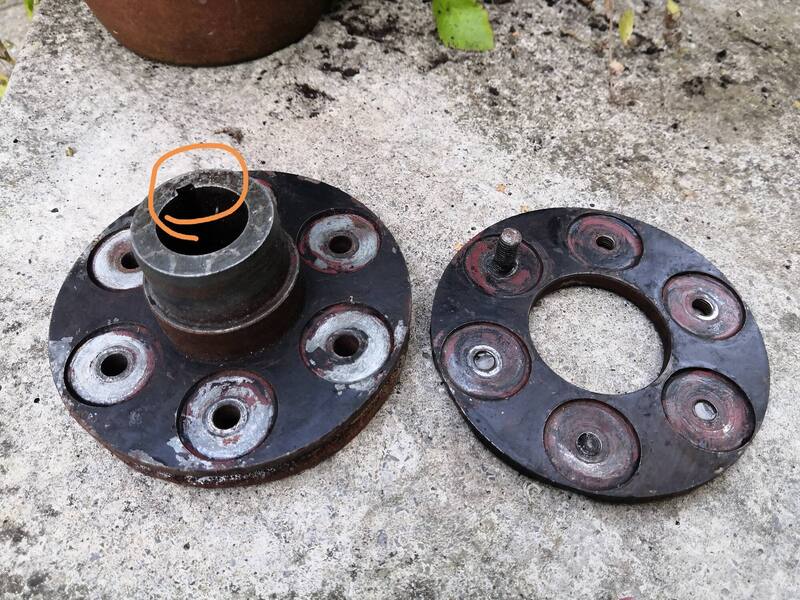

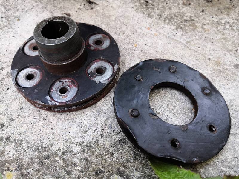

Yoss Posted July 20, 2020 Posted July 20, 2020 This is a 1300 front pulley I have knocking about in my garage. The other bit is the bit that sits behind the starter ring then you put the six bolts in and clamp the lot together. But you'll notice on this one there are the stumps of four bolts still in it. That happened going up the M3, fortunately very close to J4A so I was able to get off and pull up somewhere safe (I didn't actually know what it was at that point, it just started to make a hell of a racket). If the other two had broken it would have been goodbye radiator. I'm convinced this happened because I put poly bushes in and they were slightly too large and too hard. The rubber ones were shot and I was slightly surprised that the poly bushes were even available as the FWD cars aren't well catered for. Needless to say I had another plate in my spares and went back to the rubber bushes. Why have I kept the knackered one? Who knows? But the point I'm rambling up to is that you can see the bit that slips in to the oil seal and a slightly wider section that the other plate sits over. I don't see why you can't just use the pulley on its own. I'm not familiar with Heralds but I looked up the timing cover in my book. So it's part number 213205. If I then look that up in the numerical index (the book has both numerical and alphabetical indexes) it shows that it is unique to the 1300. Those letters in the far right column indicate if the part was used on any other vehicle. You can see an O and an A and some more at the top. The code letters seem fairly random but this is they. I think my book predates the Herald 13/60. There's also no mention of the Mk3 Spitfire here either and I know my engine, a TC, is the same spec as that. Then it occurred to me that it may be a different part number because of the timing marks. The 1300 has a bit of metal tacked on the timing cover that lines up with a nick in the starter ring carrier. So I see no reason why you can't use the front pulley on it's own as it is. Even if you use the Herald timing cover you won't have any timing marks on the FWD pulley although this keyway is at TDC I wouldn't worry about this too much anyway if it's a decent engine. Just turn the distributor until it runs OK then advance it a bit at a time, go for a drive, do it again until it starts pinking the retard it slightly. EDIT : Sorry, going a bit off topic here but I just noticed part number 213287 in the picture above is a front skid plate! This book is great, has all options and variations for export markets but I didn't know it had rally spec stuff in as well. I'm now off to look at page 126. sdkrc, dome, davehedgehog31 and 6 others 9

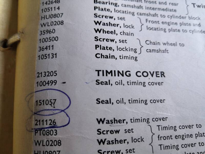

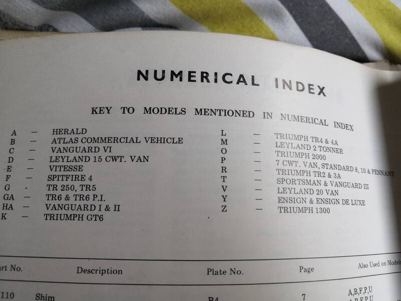

captain_70s Posted July 20, 2020 Author Posted July 20, 2020 I don't have the timing cover from the 1300fwd! It should be identical other than timing mark to the one on the 12/50 lump though, I shall be attempting to free it from the engine tomorrow... With that liberated we should be able to put it together, only thing I'll have to do is acquire new pulleys for the water pump and alternator as the crank pulley for the older cars is smaller than a Dolly one so they'll spin at the wrong speed. We were initially discussing taking the two pulleys to a machine shop and having the fuckers machined to fit, it'll get done one way or another! ? Stanky, Christine, jaypee and 2 others 4 1
