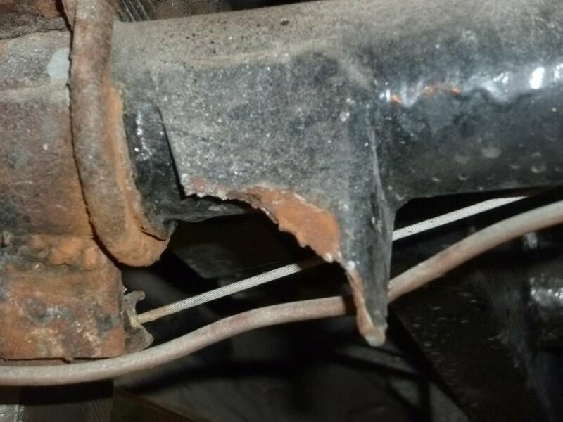

2 things, most urgent is one shock mount has broken off the Kittens rear axle, rust I think, other needs checking,  Second, seat frame broken.
Are you bringing it up on a trailer?
I drove my Mk3 Escort van all the way back from central France with a broken rear shock mount once.  That was the second silliest drive back from France I ever did, after the Saab 9000 Turbo which lost its brakes on the Paris périphérique and somehow still made it back to Norwich without crashing into anything.
(Wouldn't do it nowadays mind, this was 20 odd years ago when I was young and stupid(er).)
No, driving. It is ok if I am careful.

There is a place near me that can do it, they have a lift, which will be better than ramps, so I will go and see what they say. I will also contact the Kitten side of the Reliant register to see if its a usual thing, and what they do.
Good idea! Having  a suitably equipped workshop on hand should make it easier and quicker to resolve the problem.

Pics of the broken mount, and one of the other, still ok.  Both handbrake cable pivots looks a bit rough as well.  Until I find what professionals might say, I will probably remove it for sale, until I am satisfied with it.  I also need another drivers seat. It has 2 passenger seats, the one in the drivers place broke.
