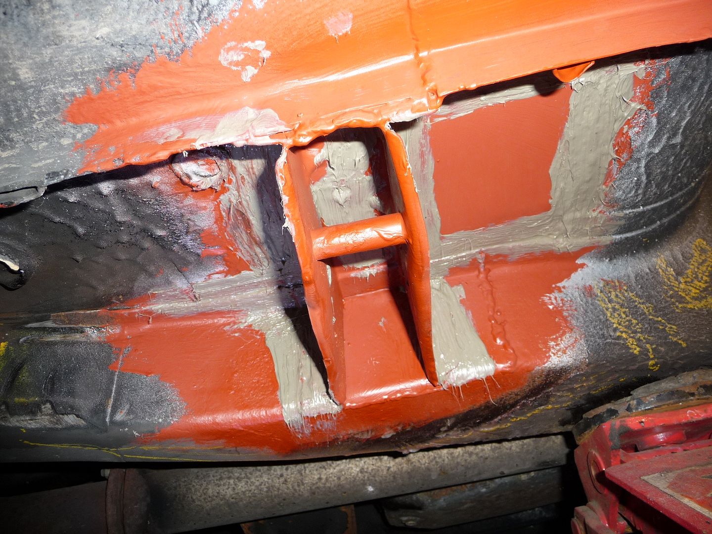

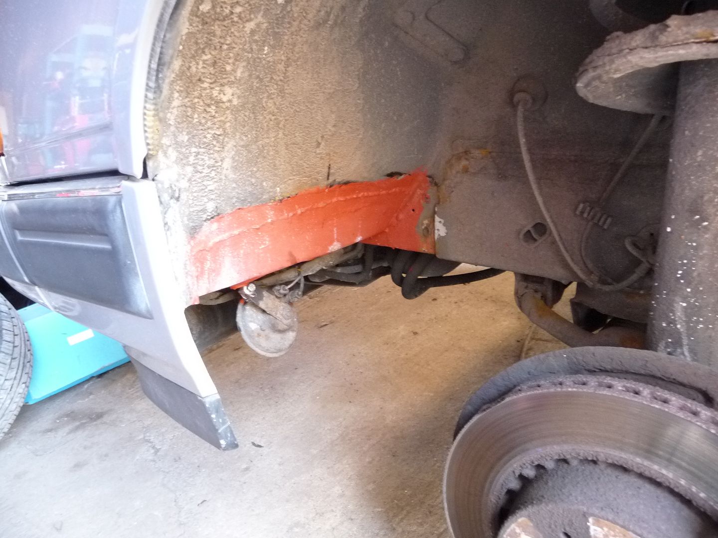

I chopped out one side of the outrigger, patched the chassis leg then stitched the chopped-out piece of outrigger back in

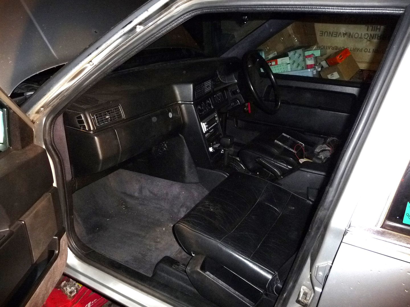

INterior back in
Other side was quite a bit worse, ended up taking the outrigger right off and taking it to work to put in the blast cabinet
Didn't take a lot of photos, as I was too 'on it'
getting ready to refit the outrigger
Done, turned out really well this bit
Not bad eh?
I have put all the interior back in, but it'll have to come out again if i want to fix the droopy headlining (I do).

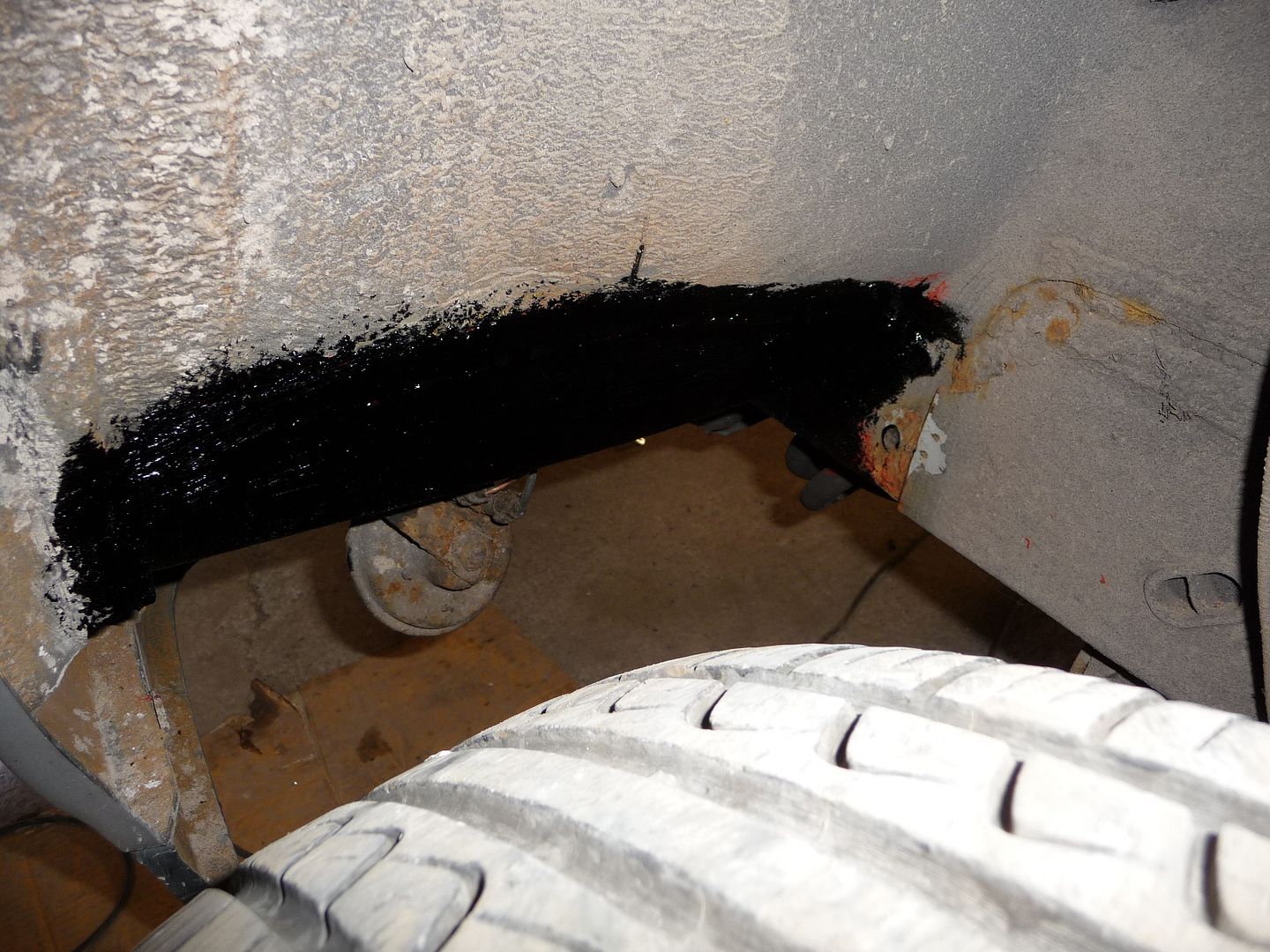

Lol, You got red lead on the battery terminals
2/11 for painting skillorz
478866/10 for Vulva saving. We salute your services to Shite Mr B
Looks a good job there.
My old saloon had gone in the same places, so I did exactly the same as what you've just done. Mine had gone on the opposite side to the battery aswell, under the air filter box.
I painted my battery tray area with many layers of thick stonechip paint then put a battery acid neutralising pad under the battery to stop it rotting again.
Some top class remedial work there. Is it just me or does the battery tray now resemble the face of a bear?
That's top work. I've never seen one go on the floor like that.
Loving the tangerine paint.
That shade of Orange is the Driftworks trademark shade. +💪for being anti scene in RWD.
More GREAT WORK Mr B...Like Philomena Cunk I'm quite taken by your 'tangerine paint'...take it it is red lead or somesuch. Paint info required please... :)

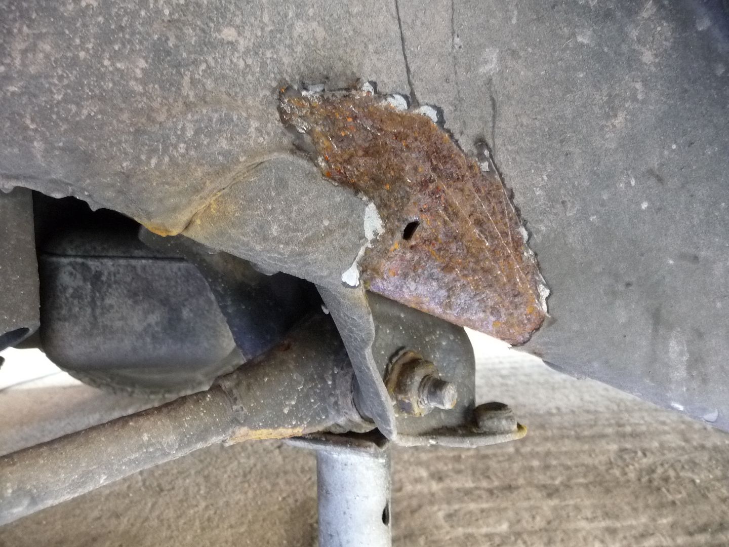

Yo! Been working on this today after it passed its MOT t'other day. first of all, I undersealed the welded bits:

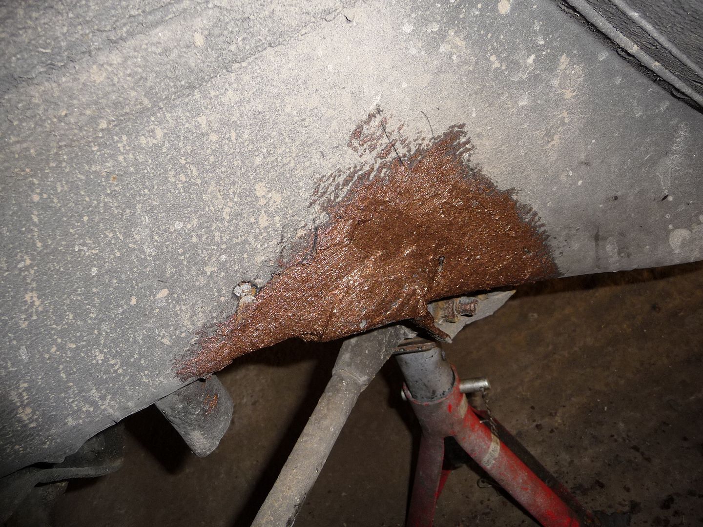

Classy job. While I was on I saw a 'swelling' on the chassis leg, so I had a pick at it:
..... Le sigh. Ah well I've just passed the flippin test, I'll chuck some copper grease on it and have a look at it another day:

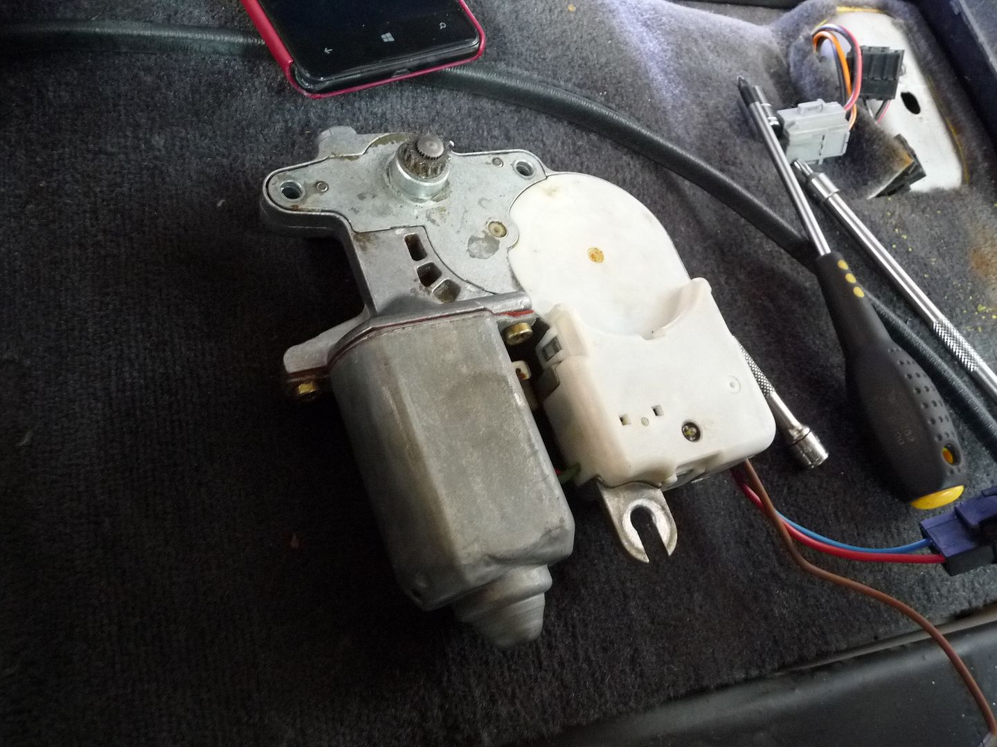

Concerning the sunroof, the motor seems to be buggered:
The sunroof opens and shuts oK manually, and the motor clicks, but it just doesnt do owt. I have opened up the motor and it seems to be seized, the armature is unable to turn the gears for some reason, although the gears turn manually with a screwdriver in the override thingy. Anyway I concluded that its knackered. Any SVM'ists have one of these in their spares pile? E-CASH WAITING

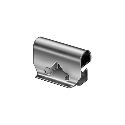

A massive bodge but would bicycle spokes work as reinforcement?  You could staple/ fibreglass them to the back or use something like this
to hold them to the edge where it's bending.
The main worry would be rust stains coming through.

I have a sunroof motor for an 850. I also have Volvo parts catalogues from 1975 to 2013 so I can find out if they are the same. Free to good home if it is.
Another vote for fibre glass resin here.
I think an 850 sunroof motor is different sadly, all the ones on eBay are different to mine
