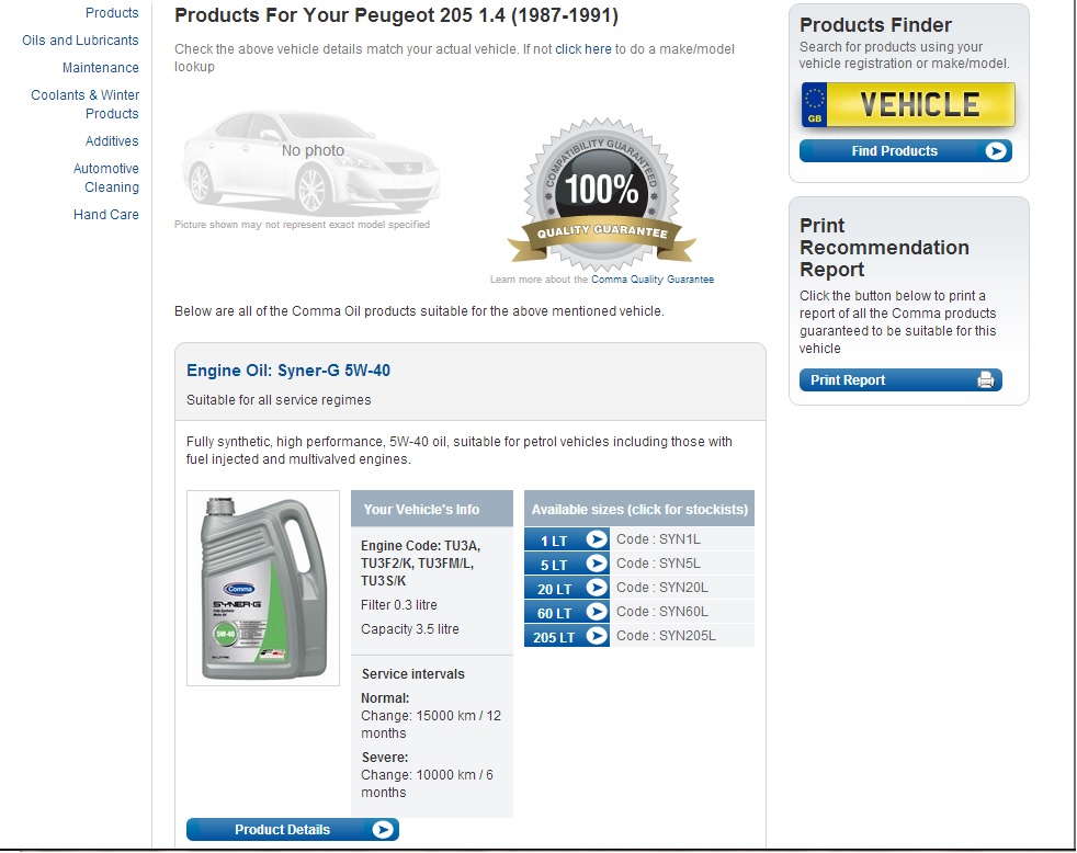

5w40 was recomended by halfords/europarts. Spose it serves me right for trusting them.

To be fair Comma do list 5w40 for it which would be what they went by, it's too thin for something like that.
I agree with everything said about the 5w40 not being right.  It's a fully synthetic oil, surely too thin for an 80s engine.  Incidentally, I ran your reg. through the Castrol oil selector WIZARDRY and it recommends 10w40... which is exactly what I'd go for.  Lots cheaper too!

10.40 3 places list as that  - only halfords list it as 5.40 - old mans 5 series eats that why put it in a 10 year older shopping car (no offence)
