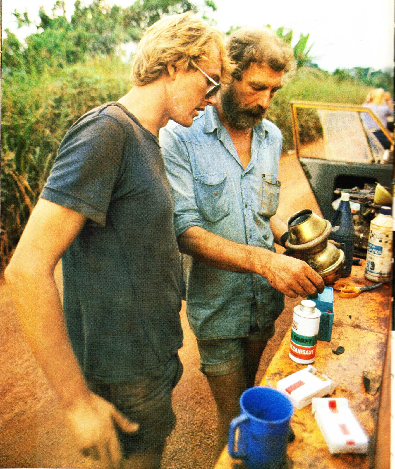

Asimo Posted December 8, 2014 Posted December 8, 2014 From the Africar book: bush repair of a Hydragas unit with a split diaphragm using puncture repair materials. The Tony Best referred to below was the Hydragas suspension engineer who assisted with the Africars' suspension design. The repair was a success and lasted the rest of the trip. KruJoe, scruff, Lacquer Peel and 2 others 5
