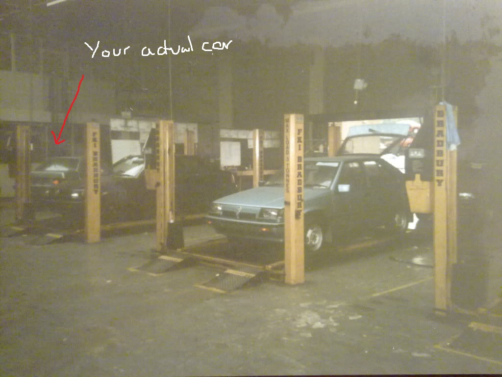

Anglevan Posted July 22, 2013 Posted July 22, 2013 great purchase / save.I have the shitsubishi lancer version of this which I love driving. And doubt I would ever sell it unless somat major went wrong. As dull as they come but still enjoy the drive. I had a gold Lancer that used to belong to MikeD of this parish which is coming up for sale again (yes I might buy it back)If you need any spares let me know as a lot are interchangeable.
Jikovron Posted July 22, 2013 Author Posted July 22, 2013 haha nice one on the proton heaven picture ^^^^ and indeed the kind words , i suspect i may require a rear beam and pez cam driven pump however ive not properly looked at the rot properly yet as its really difficult to jack up and gain enough to get a full sight on the thin/rotten trailing arm etc seems like there is nothing strong eough to jack off and the wheels dissapear into the archs if lifting via the suspension arms
