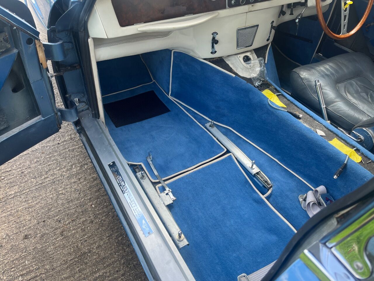

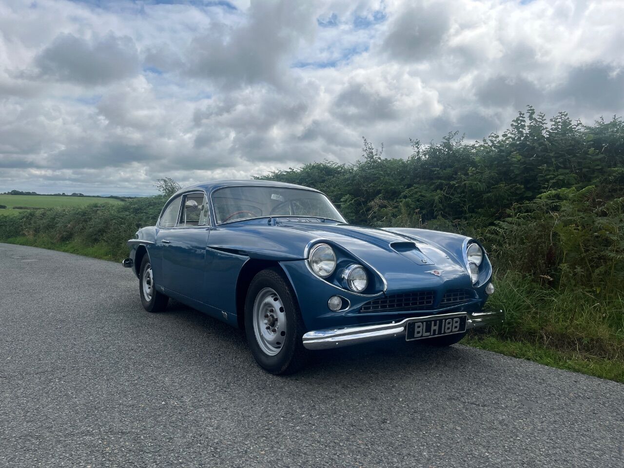

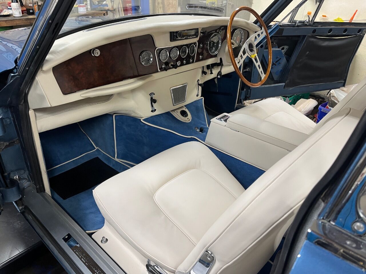

Heres the first car a CV8 that came in for just a bit of tidying up and a few mechanical repairs and is now almost finished.IMG_3457.jpeg.6c60b94691dad0401026dbef1426e0f3.jpeg
IMG_3456.jpeg.899319e53f9d3bfb09a83c46a654bed9.jpegIMG_3446.jpeg.633acc67de0d5f8eb97b43fe384b41b5.jpegIMG_3498.jpeg.4d5ae6534da6216eac4f0ed00746749a.jpeg
The CV8 looks fabulous. Proper aggressive looking hard bast*rd look about them. V cool.

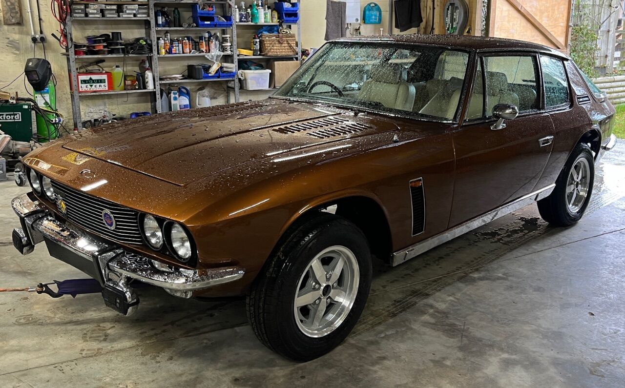

Next up is a lovely MK 3 Interceptor in one of my favourite colours, the car was partially restored elsewhere with the bodywork and paint completed then the owner took the car back and fitted all the external trim, quite a lot of the interior and various bits and the car was delivered to me to finish still mounted on a temporary jig to roll it about with a loose rebuilt engine and gearbox.IMG_3705.jpeg.bfd3fbd6bafe73e0b6376d3231452583.jpegNow the problem was I dont like crawling about on the floor as my knees and back are not what they used to be and the 2 post ramp has my FF on it with partially rebuilt suspension and the jig it came on was too narrow to fit on the 4 post ramp, so I spent a day getting it on the ramp so I could fit the suspension and get it rolling properly again.

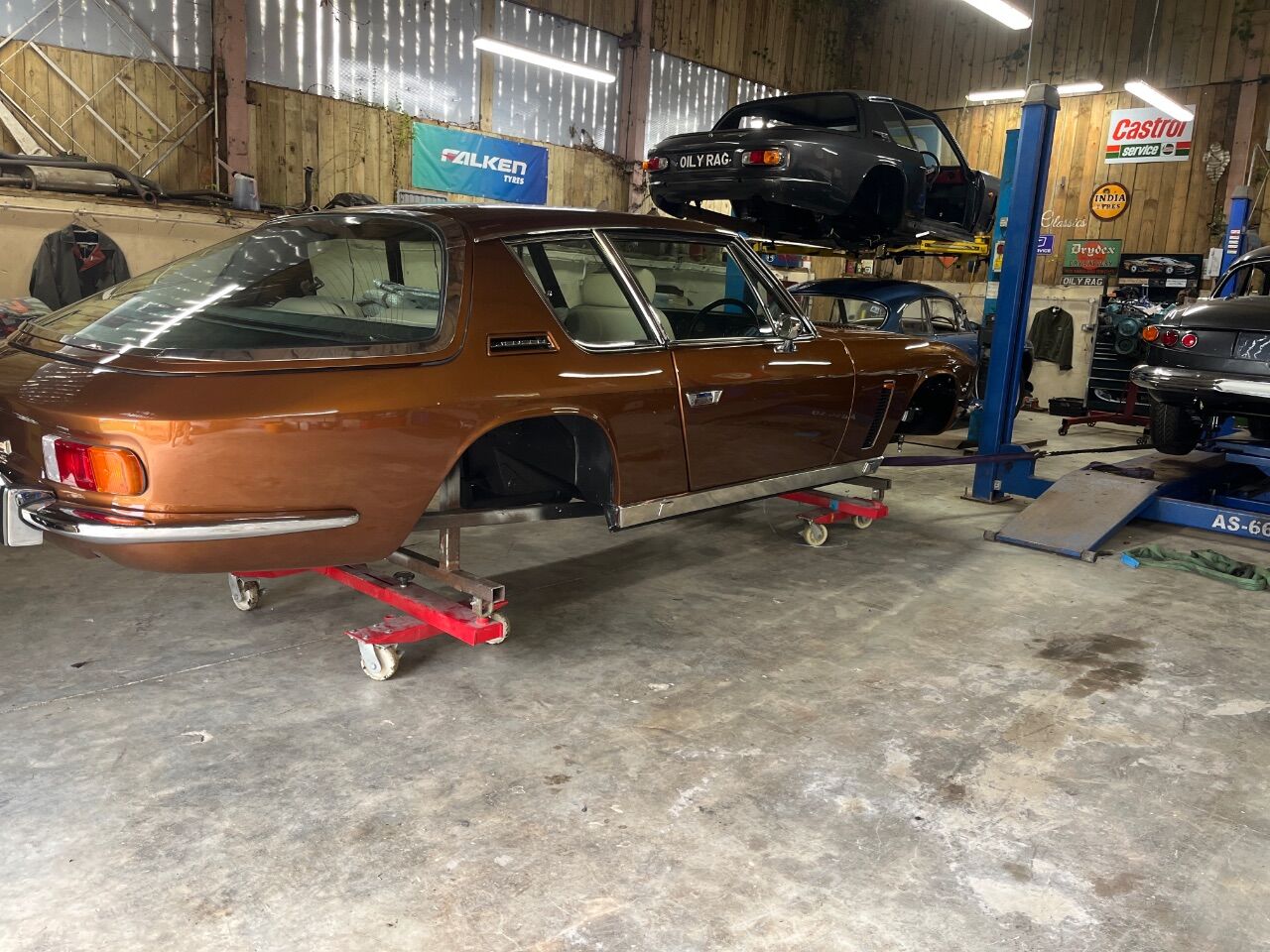

IMG_3827.jpeg.f209e3d9707371052fbeb4ef1bce8da8.jpegHere it is with all new and refurbished parts supplied with the car, a very enjoyable job for me as somebody else has done all the dirty work leaving me all the fun part. Unfortunately as is usually the case when somebody else strips down a car there were no records of what shims went where to at least give a baseline setting for the front suspension and there was powdercoating on many surfaces that needed to be carefully removed.

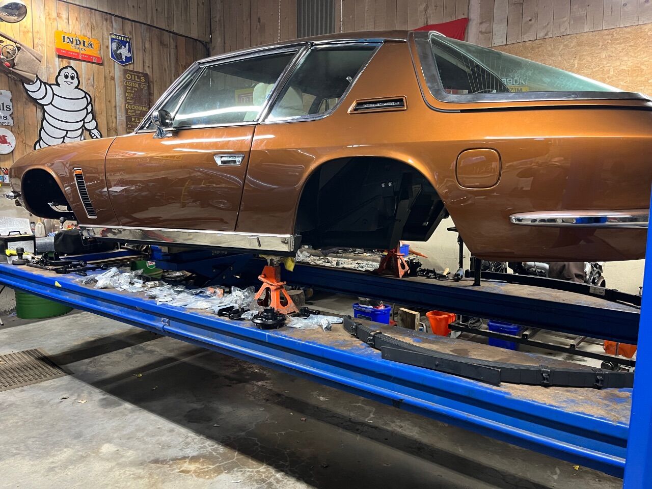

IMG_3858.jpeg.72b04038ab461eed5780db49dd23ef45.jpegIMG_3860.jpeg.6dd1c64c094134f1a7ecb0c6f2473f88.jpegNow looking much better on its wheels although still sat high due to no engine and gearbox plus many other parts.
Next job on this is getting the engine bay finished, theres a lot to do on an Interceptor before the engine can go in, brake pipes are much easier, the bulkhead needs to be built up insulated and the covered with heatshield (this job alone is around 40 hours work).
I think the Mk3 is the one that apeals to me most, and that colour is lush!

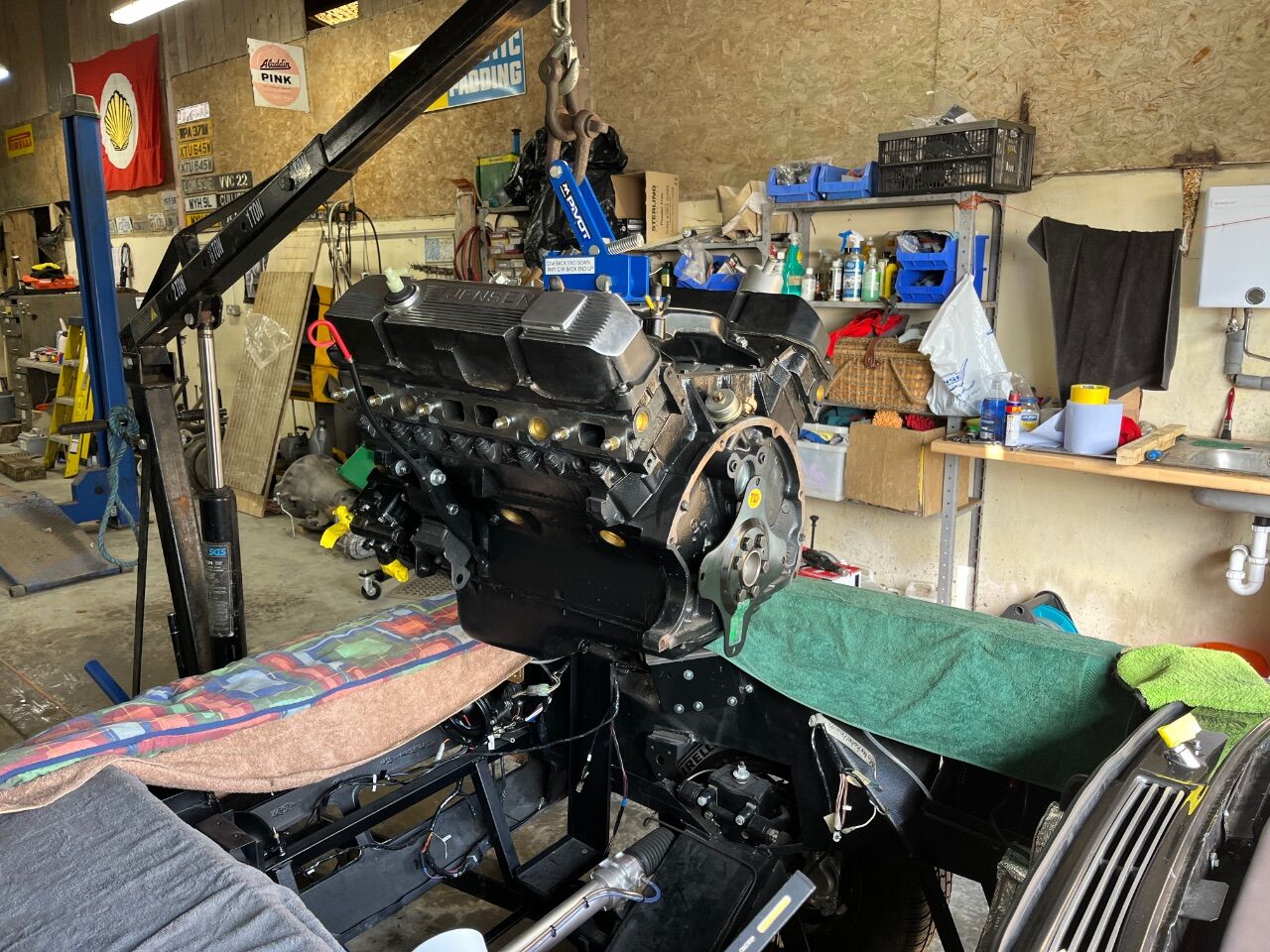

A fairly standard engine crane which is fine with engine only although near the limit when engine and g/box.
I prefer to take them out as 1 unit if both need to come out but put them back in separately as its much easier and less chance of damaging anything. It always makes me laugh when you see 4/5 people fitting an engine on tv restoration shows when I do it on my own with a big V8. The trick is not the crane but the lifting/levelling bracket I bought which is designed for these engines and bolts down to all the different manifolds, it has an easy levelling system and doesnt get in the way like those cheap ones with the chains. It usually takes me 15 minutes once everything is set up to carefully lift the engine over the front of the car and get it on its 2 engine mounts with a couple of bots in the gearbox so everything is safe, I could probably do it in much less time but take it easy so nothing gets damaged.
Heres one going in a convertable.
IMG_3084.jpeg.a35fd5fce42447717b0db07f98c158e4.jpegIMG_3087.jpeg.f89c143a52ad26e274a16baee6d5e890.jpeg
