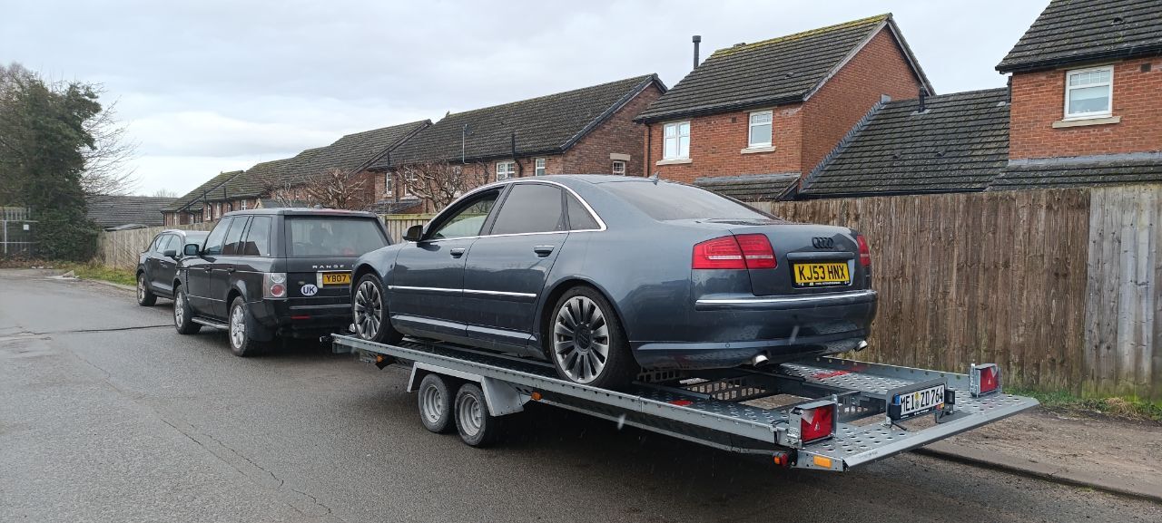

May I present you, the 2003 Audi A8 4.0 TDI, the most powerful Biturbo V8 Diesel in any production car at the time!
All bought from a dodgy Carlisle industrial estate for a mere £600!
It's rough but runs! On the way back now, more when I'm home!

It's the one that was posted in the low cost big liability thread the other day. Considering the taillights are worth almost what I paid for the entire car it wasn't going to hang around for long. Someone else was already on the way last week and then just vanished, so as usual, be a semi decent human being and people are happy to work with you. Today was the first day I could pop over.

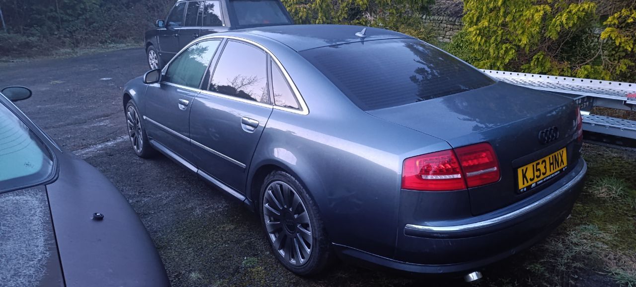

And we are back. First impression of this top-spec A8: rough but ready! I'll take it for a quick test drive later but it might be worth saving this one. Airbag light and fob battery warning on the dash but that's it. The stuck display will be its biggest issue and it might need a strut in the back. It's filthy and worn inside at 200k, it just once again shows in what an amazing condition the forum bike A8 is in at 230k+. Stories of two completely different owners.

However, naturally there are issues. And no, the front bumper might not have to come off (although a headlight adjustment error might say otherwise). So if it drives well and looks fairly tidy, a few scuffs and blacked out trim pieces aside, what does it need?
This shouldn't happen while you drive! There are some severe electrical issues that crash most systems over and over right now. The battery terminals are on tight so that's not the problem. There seem to be voltage problems though so either the battery is knackered (unlikely, my S8 doesn't behave this way), there's an earth issue, possibly from a water leak inside (carpets seem dry) or the alternator is on its last leg. At 211k miles (not 185 as advertised) I wouldn't be surprised at all if that was the last straw for the last owner. Also what the hell happened to these wheels? Someone actually painted them this way...
