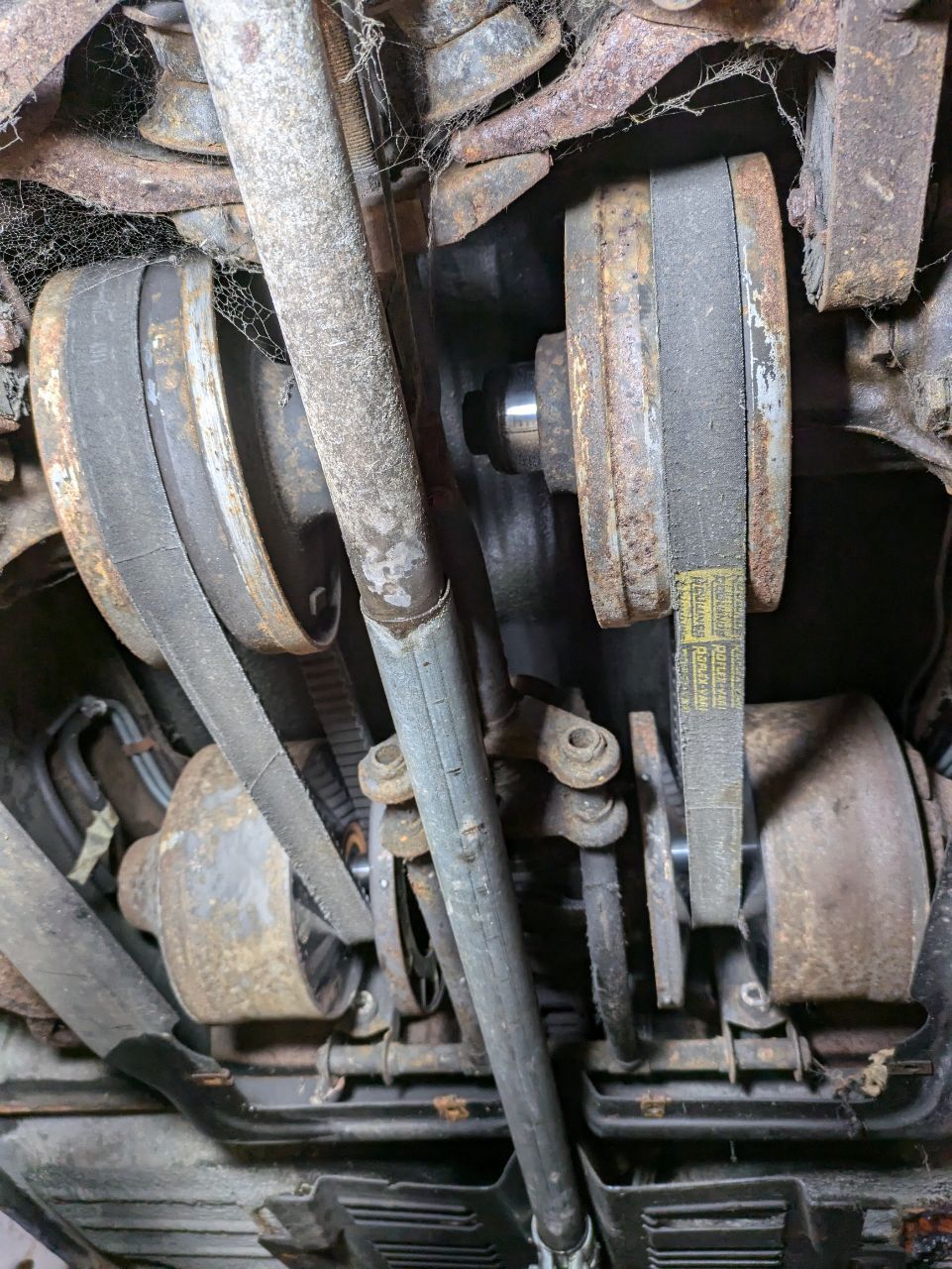

RobT Posted November 9, 2025 Author Posted November 9, 2025 It arrived as a runner but the brakes are terrifying and it refused to idle. A half arsed tune of the Solex carb got it running better, then the front brakes were tackled. Four drums to do ffs. I replaced the NSF flexi but the ones I bought are a bit too long for my liking, so will approach that again at some point. At least it works for now. Classic Mini brakes which is handy. The rears currently work on the handbrake, but to do a proper job on them the vario belts need to come off first. Makes sense so they can be adjusted up correctly. Hopefully doing the fronts will make it safe enough for a drive around the block, but I'm not at that stage yet. danthecapriman, Marshall2810, auntiemaryscanary and 20 others 23

Asimo Posted November 9, 2025 Posted November 9, 2025 58 minutes ago, Matty said: see how that cvt box It is definitely a CVT, but it's not in a 'box! RayMK, loserone, CreepingJesus and 1 other 2 2
Matty Posted November 9, 2025 Posted November 9, 2025 6 minutes ago, Asimo said: It is definitely a CVT, but it's not in a 'box! Bloody pedant 🤣. Fascinating system though. I think i understand the basics just about but the mechanics in their entirety not so much. Ill do more reading! Edit Looking at that subframe assembly and its input spline, am i right @Asimo in assuming that Dafs are front longitudinal rear drive?

RobT Posted November 10, 2025 Author Posted November 10, 2025 5 hours ago, Fabergé Greggs said: Precisely 👍. There’s also a solenoid in the engine compartment that diverts the inlet manifold vacuum depending on the brake switch being on/off. A super simple and robust system when working properly, though quite revvy. Thanks, it's all a learning curve but one I'm enjoying. The fact it's simple and accessible helps a lot. I slackened the belts off as they were making unpleasant noises, but now I've done that it's entirely possible they'll slip. Could be why a previous owner tightened them up so much. I've been trying to keep costs down but maybe new ones are on the cards after all. I'll see how the first road test goes. andrew e, danthecapriman, Matty and 3 others 6

LightBulbFun Posted November 10, 2025 Posted November 10, 2025 lovely purchase! I do like these old DAF's then again air cooled flat twin with CVT system, well as seen below I might be slightly bias 2 hours ago, RobT said: I slackened the belts off as they were making unpleasant noises, but now I've done that it's entirely possible they'll slip. Could be why a previous owner tightened them up so much. I've been trying to keep costs down but maybe new ones are on the cards after all. I'll see how the first road test goes. I will say if you dont know how old your CVT belt(s) are/what condition they are in, I would just preemptively replace them, dont just keep putting it off until it shreds itself just *after* a junction on the M25, ask me how I know LOL along similar lines check the pulley faces that none have become rusty or pitted such that they might shred the belt (tho in that regard it might be worth doing some local miles on the old belts to clean up any surface tarnishing etc before sticking the new belts on) auntiemaryscanary, CreepingJesus, tooSavvy and 1 other 4
High Jetter Posted November 10, 2025 Posted November 10, 2025 4 hours ago, RobT said: Thanks, it's all a learning curve but one I'm enjoying. The fact it's simple and accessible helps a lot. I slackened the belts off as they were making unpleasant noises, but now I've done that it's entirely possible they'll slip. Could be why a previous owner tightened them up so much. I've been trying to keep costs down but maybe new ones are on the cards after all. I'll see how the first road test goes. I know very little about the belts on those bar a rough idea of how the system works. I'd say those belts don't look in their first flush of youth though - as I see LBF has mentioned too. I'd be getting spares, in any case. auntiemaryscanary 1
Sigmund Fraud Posted November 10, 2025 Posted November 10, 2025 Agreed with the fellow 'shitters above that the belts don't look like they have much life left in them. Having said that, one of the advantages of the early variomatics is that even if one belt snaps, the car will still get you home using the remaining belt (giving you one-wheel-drive !) RobT, vtec-e, D.E and 2 others 4 1

RobT Posted November 11, 2025 Author Posted November 11, 2025 7 hours ago, LightBulbFun said: along similar lines check the pulley faces that none have become rusty or pitted such that they might shred the belt (tho in that regard it might be worth doing some local miles on the old belts to clean up any surface tarnishing etc before sticking the new belts on) The faces do have some rust patches near the outer edges, so that's also my thinking before I put new belts on. I'll only be doing local circuits for a while anyway, as there's no doubt loads of things wrong with it that aren't apparent yet. LightBulbFun 1
yes oui si Posted November 11, 2025 Posted November 11, 2025 3 hours ago, Sigmund Fraud said: Having said that, one of the advantages of the early variomatics is that even if one belt snaps, the car will still get you home using the remaining belt (giving you one-wheel-drive !) I'm woefully ignorant of the intricacies of the Variomatic setup, but this is really interesting. I appreciate that these don't have huge amounts of power so won't be doing mad skidz yo, but is having one belt per side the equivalent of having a conventional open diff? Is there a DAF version of an LSD where the sides are connected in some way?

dollywobbler Posted November 11, 2025 Posted November 11, 2025 7 hours ago, yes oui si said: I'm woefully ignorant of the intricacies of the Variomatic setup, but this is really interesting. I appreciate that these don't have huge amounts of power so won't be doing mad skidz yo, but is having one belt per side the equivalent of having a conventional open diff? Is there a DAF version of an LSD where the sides are connected in some way? Both rear wheels are entirely independent so effectively act like a limited slip. If one wheel slips, the other side still gets power. tooSavvy, yes oui si and Sigmund Fraud 1 2
Sigmund Fraud Posted November 11, 2025 Posted November 11, 2025 9 hours ago, yes oui si said: I'm woefully ignorant of the intricacies of the Variomatic setup, but this is really interesting. I appreciate that these don't have huge amounts of power so won't be doing mad skidz yo, but is having one belt per side the equivalent of having a conventional open diff? Is there a DAF version of an LSD where the sides are connected in some way? To elaborate on @dollywobbler 's answer above, the early variomatic (used in swing axle cars) did not have a differential at all. The system relied on pulley movement and belt slippage to allow the driven wheels to have different speeds when turning. The later version (used in DeDion axle cars) did have a conventional, open differential which made things much smoother in tight turns. yes oui si, Joey spud and RobT 2 1
