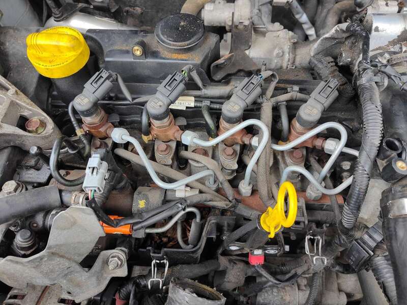

I have just done one last job though, make the engine more naked. It's tiny once all the plastic is off 😂

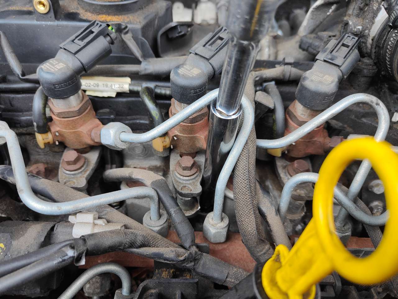

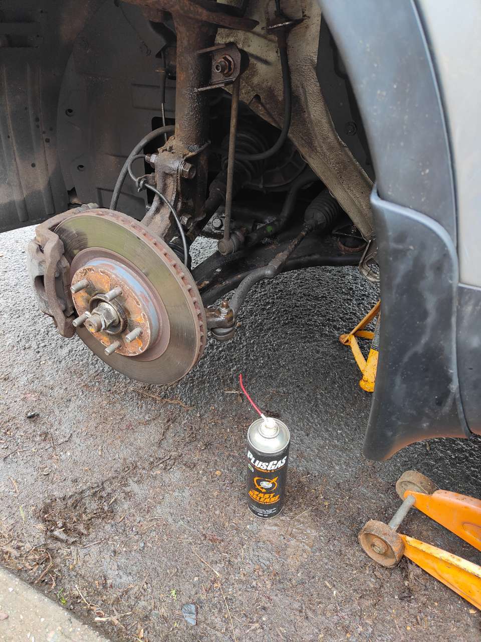

I can see the glow plugs. I squirted some plus gas down into each of the recesses to soak, then for a laugh (starting at the drivers/belt side) popped the wire off and tried my socket. Mostly to see if it would fit but... A small grunt on 1 and 2 later and they did start to loosen. I left them be bar that though.
The big issue is my socket won't fit into the 3rd and 3th one! The injector fuel pipes are in the way and stop the socket going square onto the head of the plug, do I have to move those or os there a thinner socket I could buy? Their 10mm I know now at least.
Going to run the car without the cover on for a bit either way. It might blow all the leaves out that are trapped under the edges.

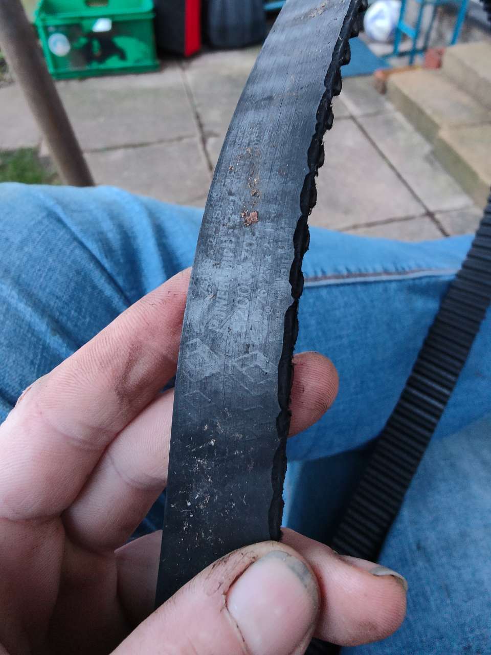

Someone on the qashqai Facebook group mentioned that Gates is the oem.for that engine... I fished the cambelt out of the bin and lo and behold, a Renault badge 😂
Could this, coupled with the one piece gasket I had to snap in two be a big clue to this potentially being the original cambelt stuff? Otherwise it needs decent odds that it was done properly at a dealer once 😂😬
Ignore the dirt in it, it's been in the bin... Wonder if I'll find any oem markings on the waterpump and tensioner 🤔

Re Glow Plugs - I bought a deep 1/4 socket and small extension for them and got them all out and in without hassle or moving much else.
Good to know, thanks! I was going to try a different style of socket I think

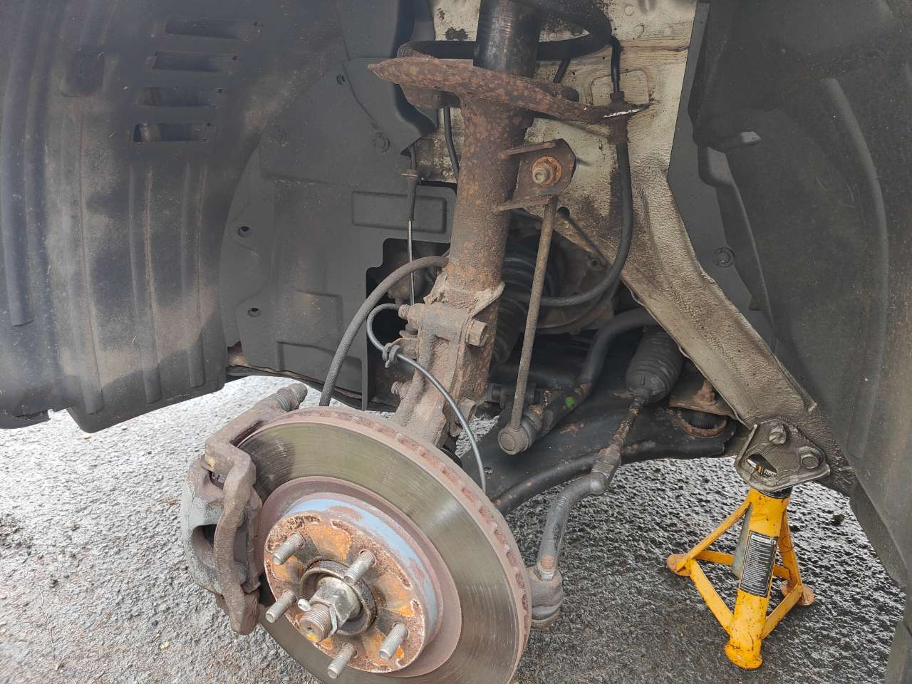

I'm on the passenger side today, not to really do anything, but have a poke about. Annoyingly nothing this side is split or broken or noticeably loose (no play in this track rod end like the drivers side)
Lower ball joint boot isn't split

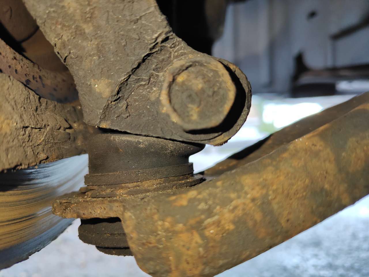

Rear bush of the arm isn't cracked a bit like the other side. It's all quite clean. However, the bottom arm, track rod end and droplink will all be replaced anyway with the drivers side, so I got the wire brush and plus gas out and got all the big main bolts moved and re-tightened

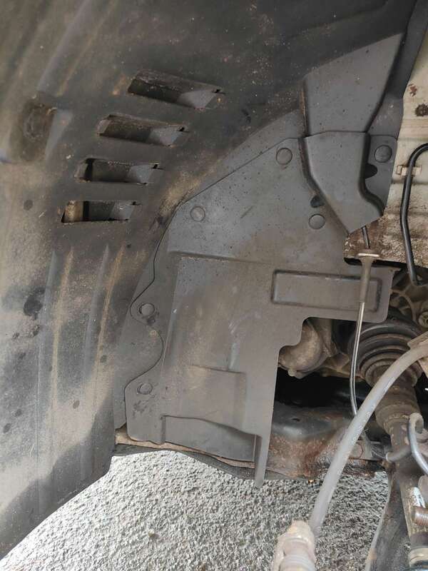

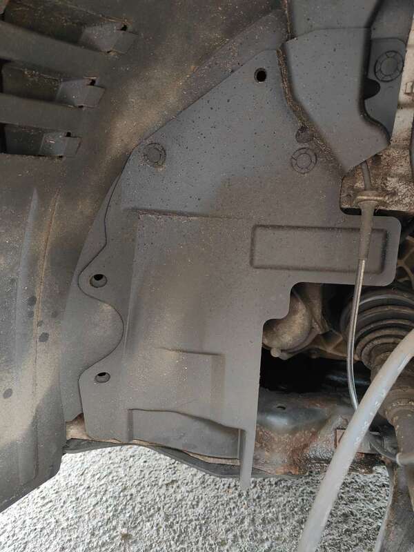

After that, I was curious as to how much shit might be built up behind the tons of plastic this car has, so popped the mud flap off and it's nice and clean! Must drain well which bodes nicely for the rest of it 🤞

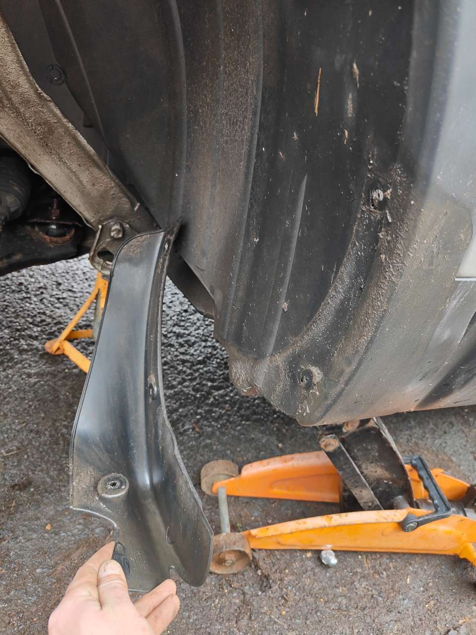

I then noticed that all but 3 of the fixings on this inner arch liner were missing. The original clips are shit, I need buy 100 of the size from my multi pack I've been using.
I replaced all of them which might have been stupid as I've probably got to have this back off to top the gearbox oil up after doing the driver side driveshaft 🙄

Glancing at the rear arms, I think once the front suspension is tidied up my attention with krust needs to go to the back in the spring 😂 No holes I've poked through yet though 🤞

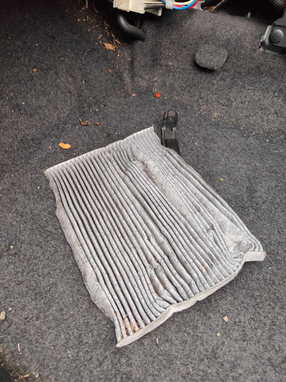

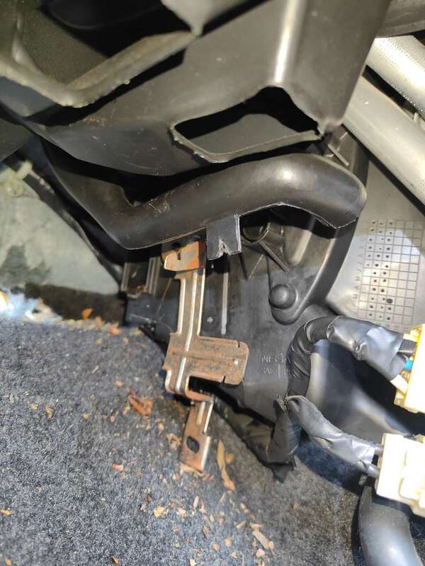

After that, I enquired about the cabin filter, which with a wiring connector unplugged wasn't the worst I've ever tried to access 🤷
It's very clogged and fucked though, so for now I've just not refitted it. Air speed through the vents is much improved. Will chuck a new one back in soon. This made a mess however

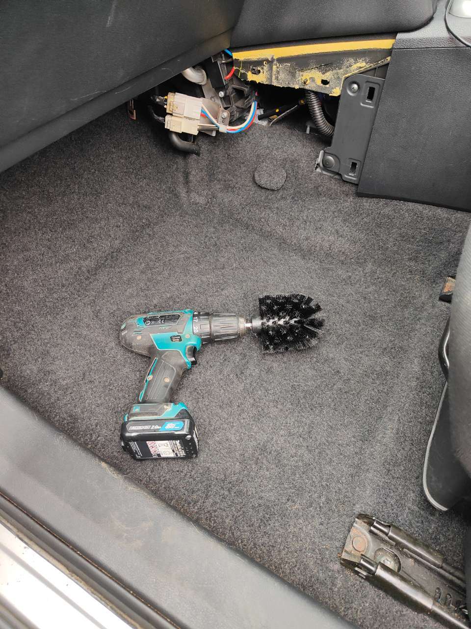

And I got the vacuum and drill brush out

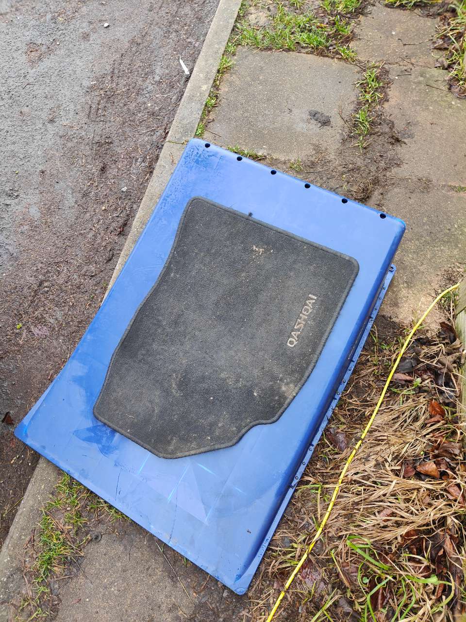

Charlie's scooter ramp made an excellent clean base for me to vacuum the mats off on too
Pissing around with the drivers seat I found a knob that gives me some lumbar support too 🥳 Will try that out and see if I don't need my clip on one.

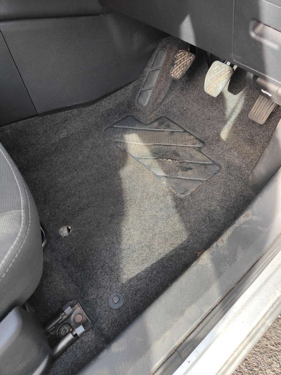

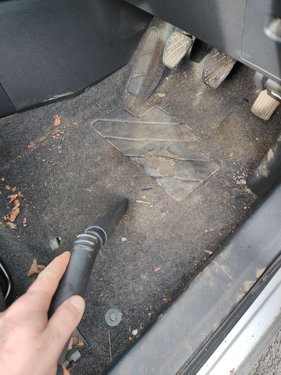

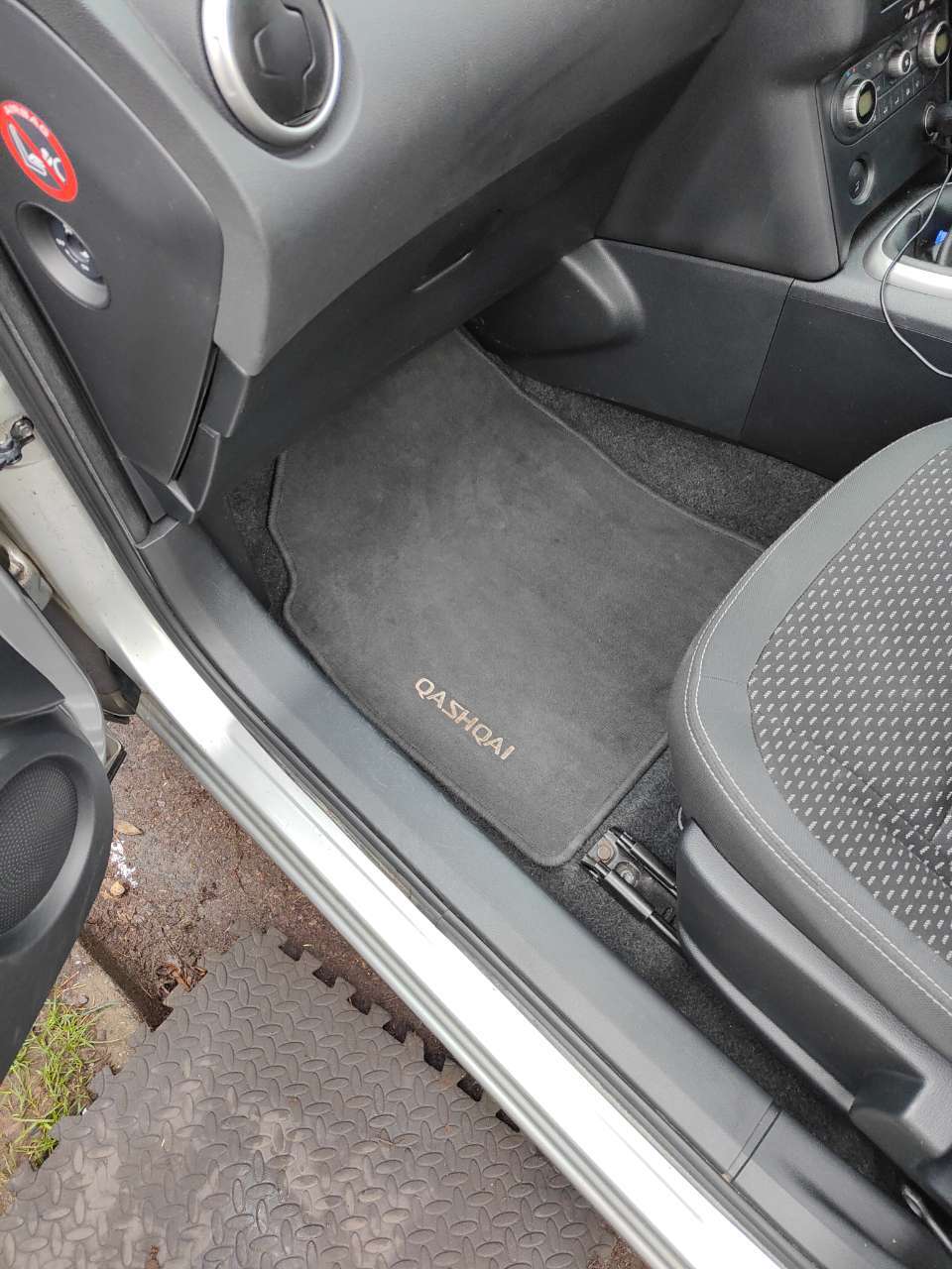

I vacuumed, dry brushed, re vacuumed and wiped down every surface and the headlining. It all came up rather wellIMG20250222111147.thumb.jpg.a7ce388c83d7c96054b16c5f6859acc0.jpg

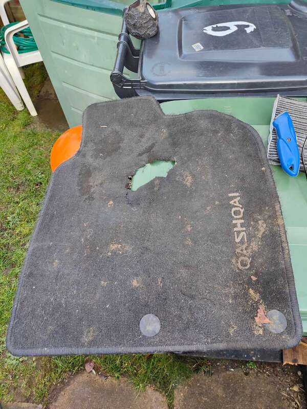

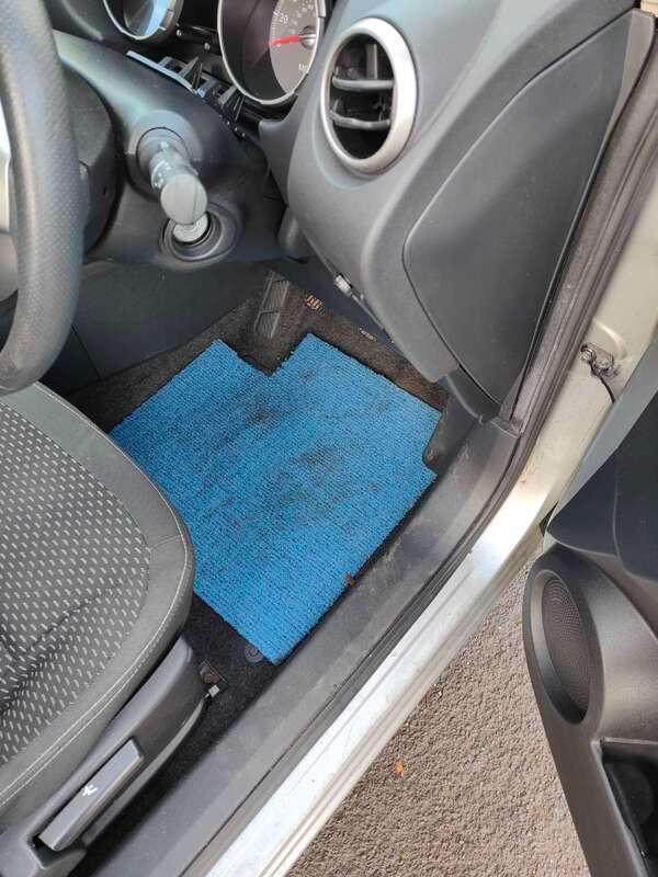

The drivers mat was fully fucked. Big hole that I kept catching my foot in so it got slung in the back on the 2nd trip out (getting shit everywhere) so I fashioned a new one from a carpet tile
Seems ok, will see if it moves about any more than this did

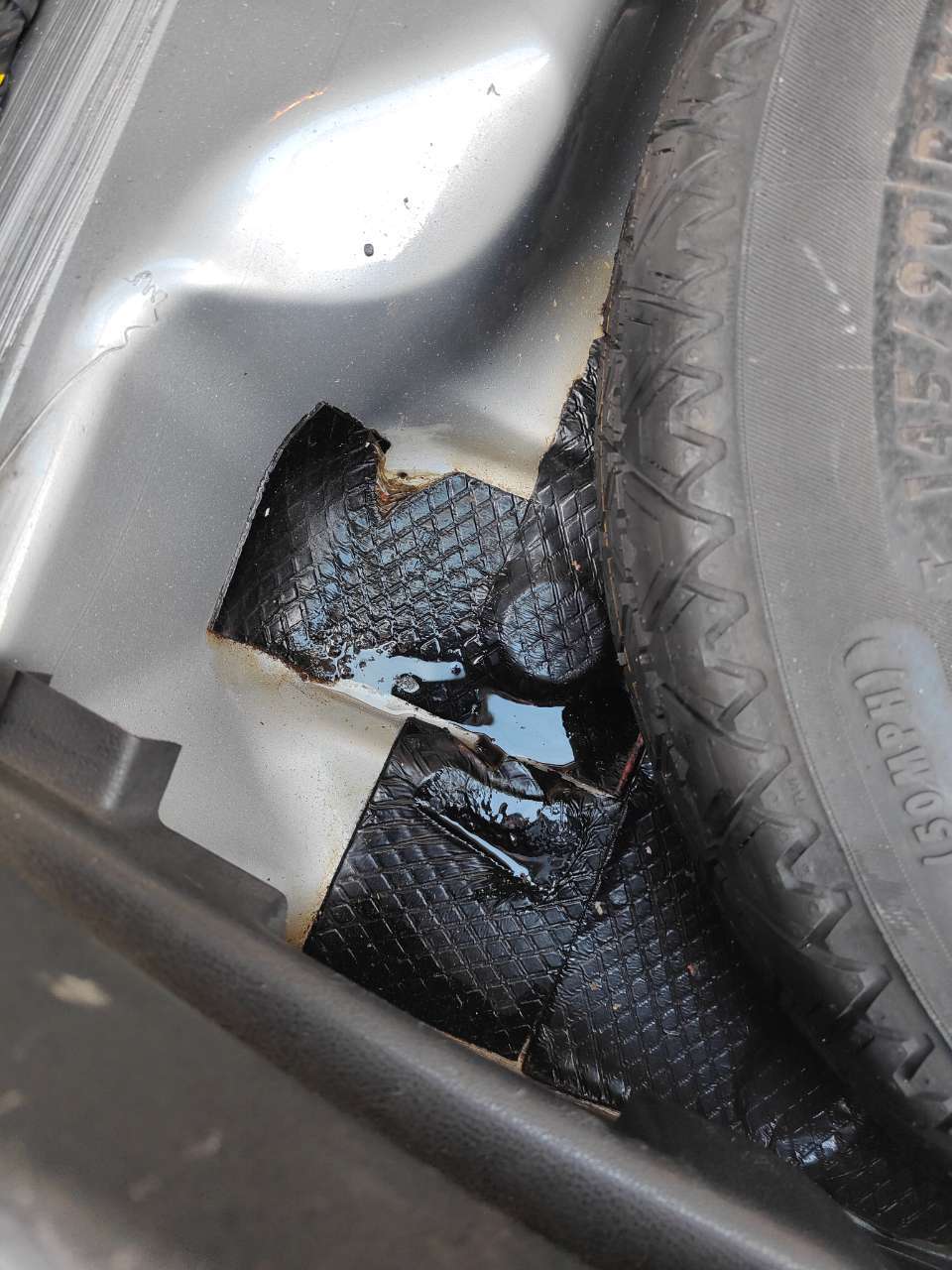

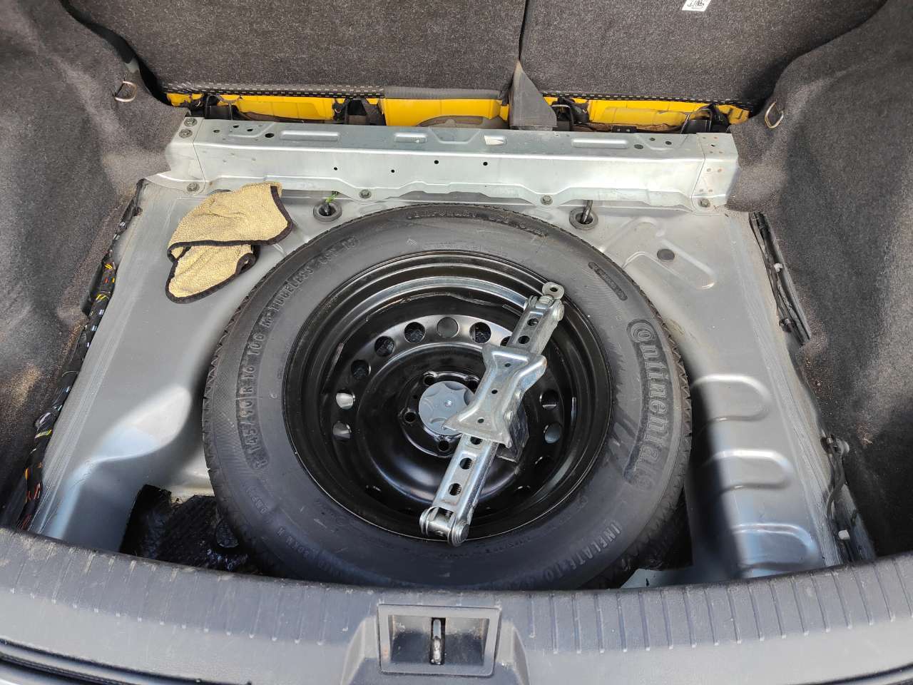

I worked all around the car and ended up in the boot. There is a small moisture ingress issue I see.
I had all the inserts and plastic stuff out and gave everything a good wipe down and vacuum, and found tons of dog hair!
Happy with that! Not alot to do now until I order some parts and get the front end sorted out, and some tracking to put the wheel back on straight (and I've got to change both tre's)

@Jim Bell don't look at the heinous crime to floor mats that has been committed!
I've driven to my mums now and it didn't move about or get caught at all 👌
New floor mat is excellent! Didn't move at all. Went up to my mums, then we went for a drive out and a coffee then I came home. They all fit in the car well, there's tons of room behind me too which is fab. In the Xsara even Charlie struggled behind me.

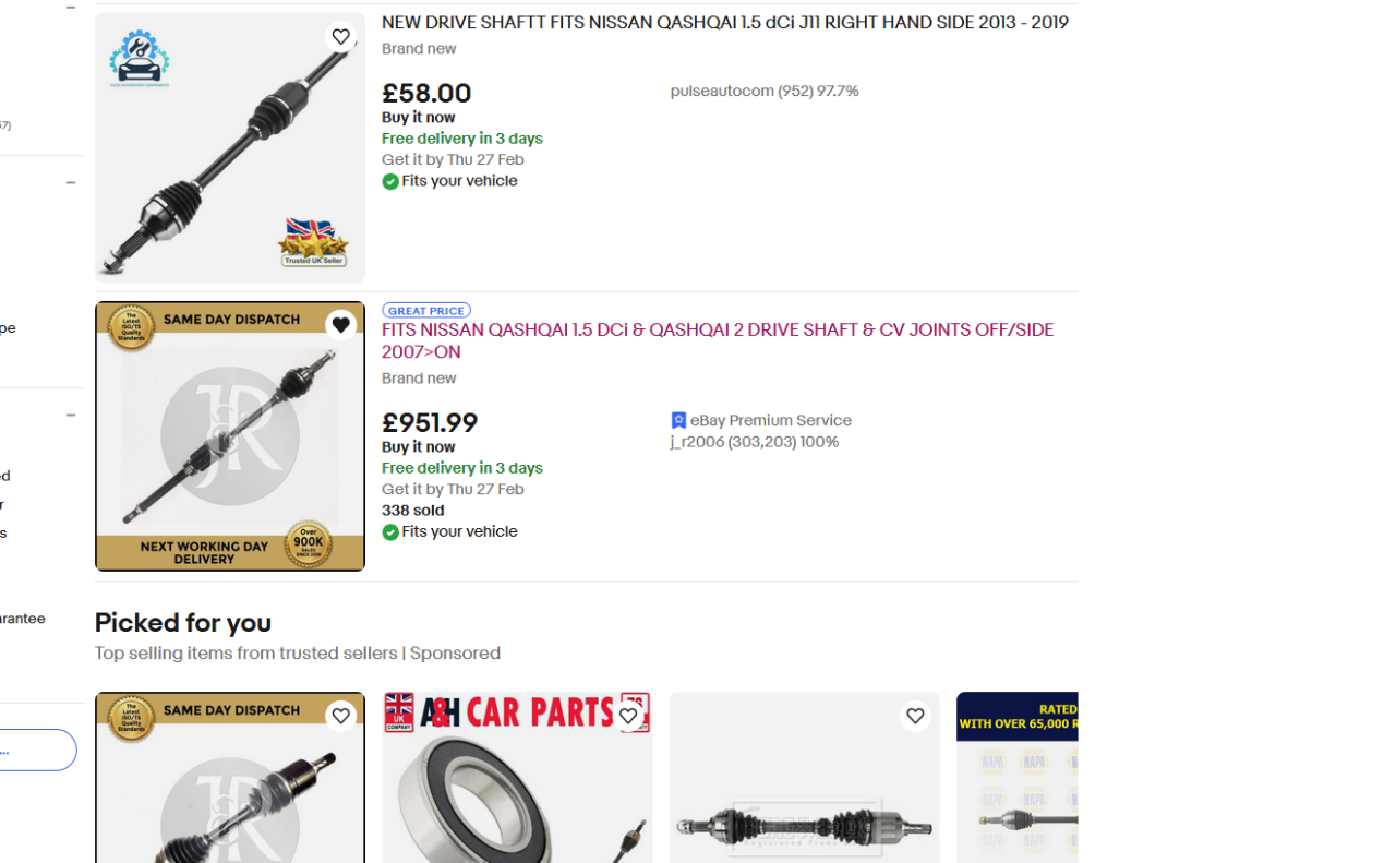

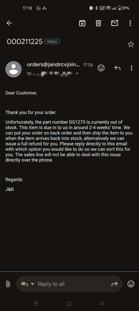

I think J&R's ebay store has run out of stock... All of a sudden my £51 driveshaft in my basket went to £900+
This spooked me a bit.  Still plenty of cheaper options around, but this is the 2nd time I've had several people all give the same advice for the part, I can't ignore that. So I spent £95 directly with J&R on one
TIme will tell if they have no stock at all anywhere or if it's just ebay oddness but I'm not having them suddenly go out of stock nationwide just when I want to fix my car! The rest of the suspension parts havent increased in cost so they can wait until weds still (youtube money day today, my main payday is weds, I'm borrowing from peter to pay paul here but needs must!)
On the plus side removing the driveshaft from my eay basket knocks the cost down a little bit 👌

I was partly expecting this email, that explains the wholesale ebay price increase
Screenshot_2025-02-24-17-18-37-95_e307a3f9df9f380ebaf106e1dc980bb6.thumb.jpg.f091de1d2f145482bf46d80843d70fc0.jpg
I'm half thinking now, I'll ask them kindly for a refund, then I can change the driveshaft without needing to get the tracking done can't I? Just pop the joints apart to get the lower arm out of the hub and change the shaft... Might just do everything bar the driveshaft now, then next month when they have stock and hopefully the cheaper ebay prices come back, buy one then at the cheaper price?
Otherwise there are other £100 options about... But I could put it off a month, i dont think the driveshaft is causing any of the steering wobble or knocks itself

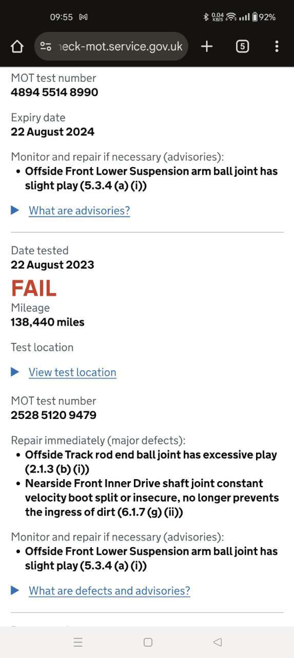

10 minutes ago, Noel Tidybeard said:

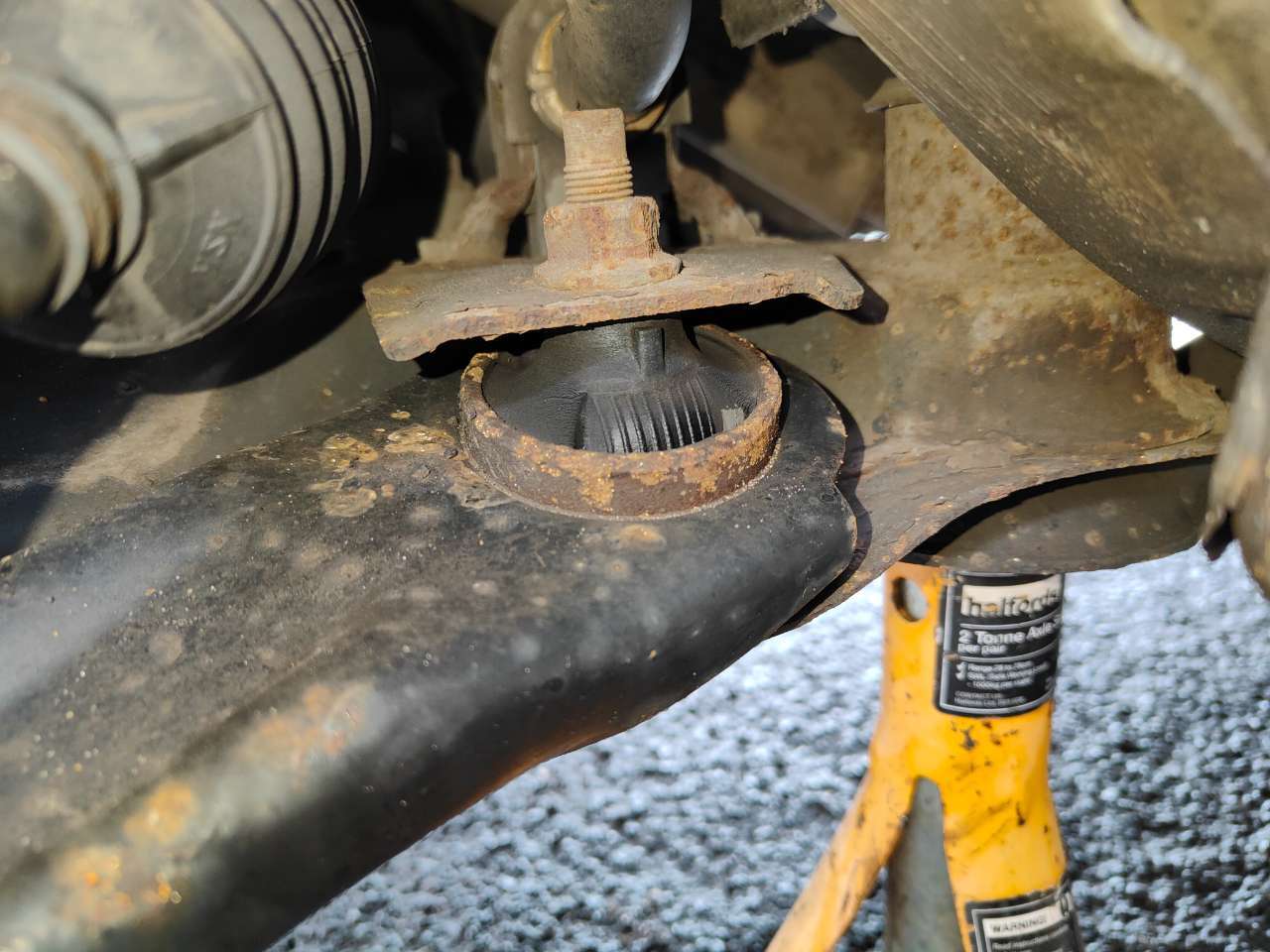

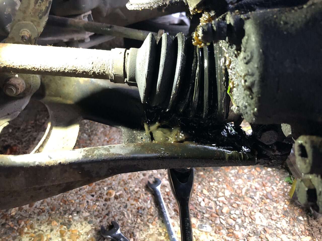

Technically yes, that's all I think it is but I don't know (bar it not being split in Sept 2024)the condition of the joint inside now... And it's the inner boot, not the outer which I think means the shaft has to come out anyway to get it changed
From all I've heard over the years about fitting cv boots it put me off enough to just want to lob a whole new shaft on. Open to looking into it though, it's not getting done this month regardless.

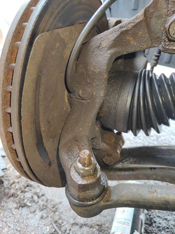

Hang on, this inner cv boot might actually be quite easy...
Just watched this video
The whole joint dismantles it seems, one circlip to remove and the end come off revealing a nice simple shaft...

A split boot might work on an inner joint as there’s less movement. But they’re a bit shit to say the least! If it’s a minor tear then a smear of RTV should keep it from getting worse for a bit.
No it's a massive split. No fixing it. But I'm more resolved to just put a cheap boot on it now I've realised it's fairly easy.
I could potentially do it without removing the inner part from the gearbox at all and not loose any fluid but I was going to excuse that as a 150k partial gearbox fluid change into the bargain, and removing the whole thing and working on it in the garden sounds easier in the long run. Will have to take a gamble on the actual joint being OK inside, might peek into it and check it doesnt look gritty and shitty
I have done inboard cv boots using stretch boots before, you still put them on from the outboard end and then send it all the way up the shaft. It can be a bit of a bastard getting them over the harmonic balancer, depending on if it’s fitted and the size of it.
Ive done them by splitting the inboard end in situ before as well, it’s just a fucker if/when the rollers and spider fall out.
I replaced the outer CV boot on the Clio recently, that had a huge split which must have happened between feb last year and when I found it in November.
It wasn’t clicking or exhibiting any other symptoms of mechanical sadness, so I cleaned it and put fresh grease in then chucked a boot on. If it does fail later down the line then it’ll get a cv joint or driveshaft at that time.
@beko1987 I wouldn’t be stressing over replacing the whole shaft if the cv joint isn’t running rough, I’d just be throwing a £5 boot at it and kicking the can down the street. Other opinions on the correct approach are probably available however, and YMMV etc. etc.
Thanks! I'm going to just to the rubber I think. On this driveshaft, the rollers are staked onto the bearing bit that gets removed, so even easier, nothing* should fall apart. I've got to buy a kit with the grease and clamps as I don't have those lying around, but it should indeed kick the can down the road nicely!
Mine must have split moderately recently, probably Christmas time? The grease is still fairly fresh and gooey all over the subframe. Plus being on the drivers side and mildly behind the undertray it gets less road water onto it hopefully.
Looking again at the mot it probably had the passenger side one done a few years ago

And the arms as they don't look awful and old, but the drivers side ball joint boot is gone and the arms are cheap so 🤷
(probably why their only lasting a year or so...)
