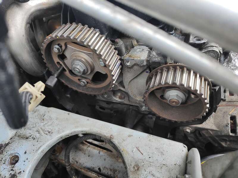

Today is cambelt day!
I've been out and found the last locking pin location under the starter motor, fired the car up and let it idle for a bit so it'll start more easily later, sprayed plus gas over the lower engine mount I also need to remove, and getting the kids sorted so I can leave them for a while until mum gets here and having one final coffee before getting started!
It's not raining yet 🤞
When you tighten the crank pulley - only do the initial torque ( 100nm maybe ? ) using the timing pin to lock the crank while you use a torque wrench .
If you use the pin when you do the angle tightening bit you could bend it / break it and cause yourself a world of pain .
Just mark the bolt head with a pen and use the ugga dugga to do the 90/180 degrees it needs . You can still leave the pin in for this as you aren’t applying so much force as if you were using a breaker bar

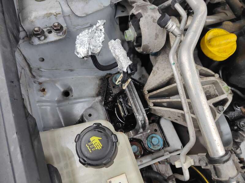

I've not got special blanking plugs so used tin foil on the fuel pipe connectors
I've got every engine mount bolt cracked off now, and once the crank bolt is off I'll get the engine supported and off with the mounts and we begin 😬
Dumb question but the longer of the 3 timing pins I have is for the crank right? Then the 2 other same sized ones are for the shafts up top... That's how it seems in my head, I'll find out soon!

Some manufacturers (like Honda) specifically advise against using an impact driver for angle tightening of crank bolts.
But the torque required is such that even the longest breaker bar known to man isn't enough. So I also use the trusty Milwaukee. I may have hesitated if I was working on a McLaren F1, but for daily shitters it works just fine.

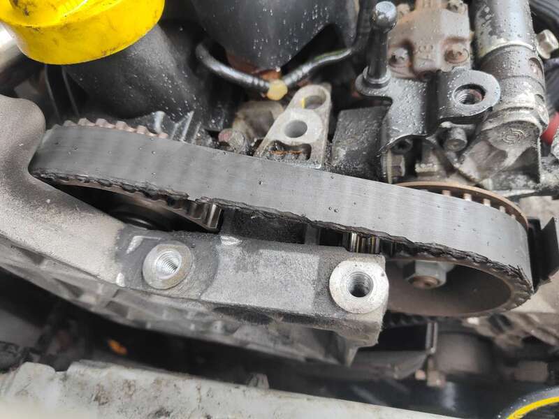

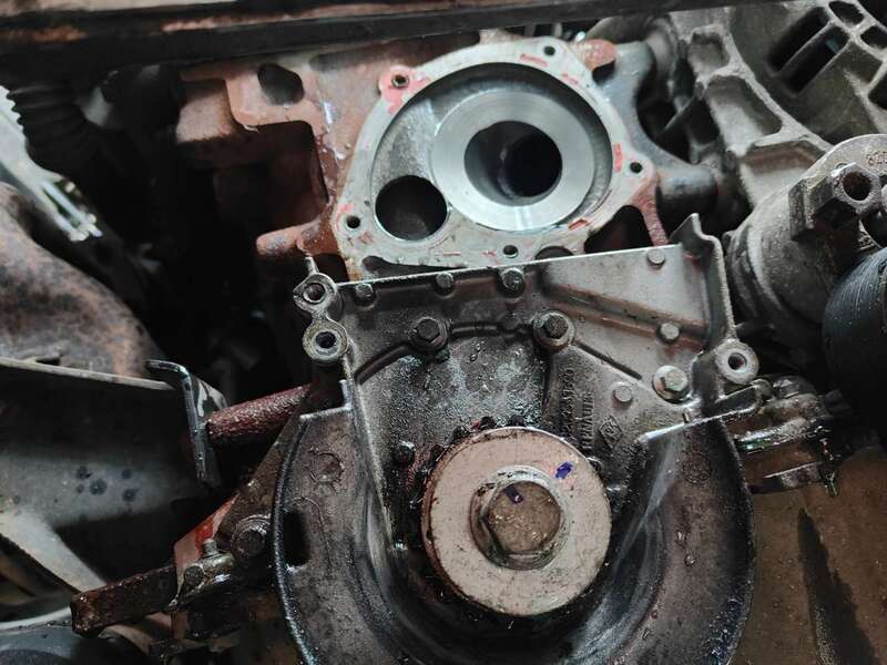

New belt and waterpump and rear plastic bracket are fitted, seems tensioned fine, just done many engine rotations!
Coffee and a rolly then carry on going back together
It's going fairly well. Technically I'm done, the car is back together. But I've killed the battery trying to start it both cold and not properly primed so I'm waiting for my mate to come round with a jump. Turns over fine on the starter motor though and was just starting to cough when I got the relay click of death.
Have a smattering of photos until I do a proper write up. The old belt was a gates belt 😂 The waterpump gasket was a one piece with the lower oil pan too which means that might have been original? I gave it a thin smear of sealant on either side of the gasket.
Job done! Car still runs, doesn't sound any better or worse so 🤷

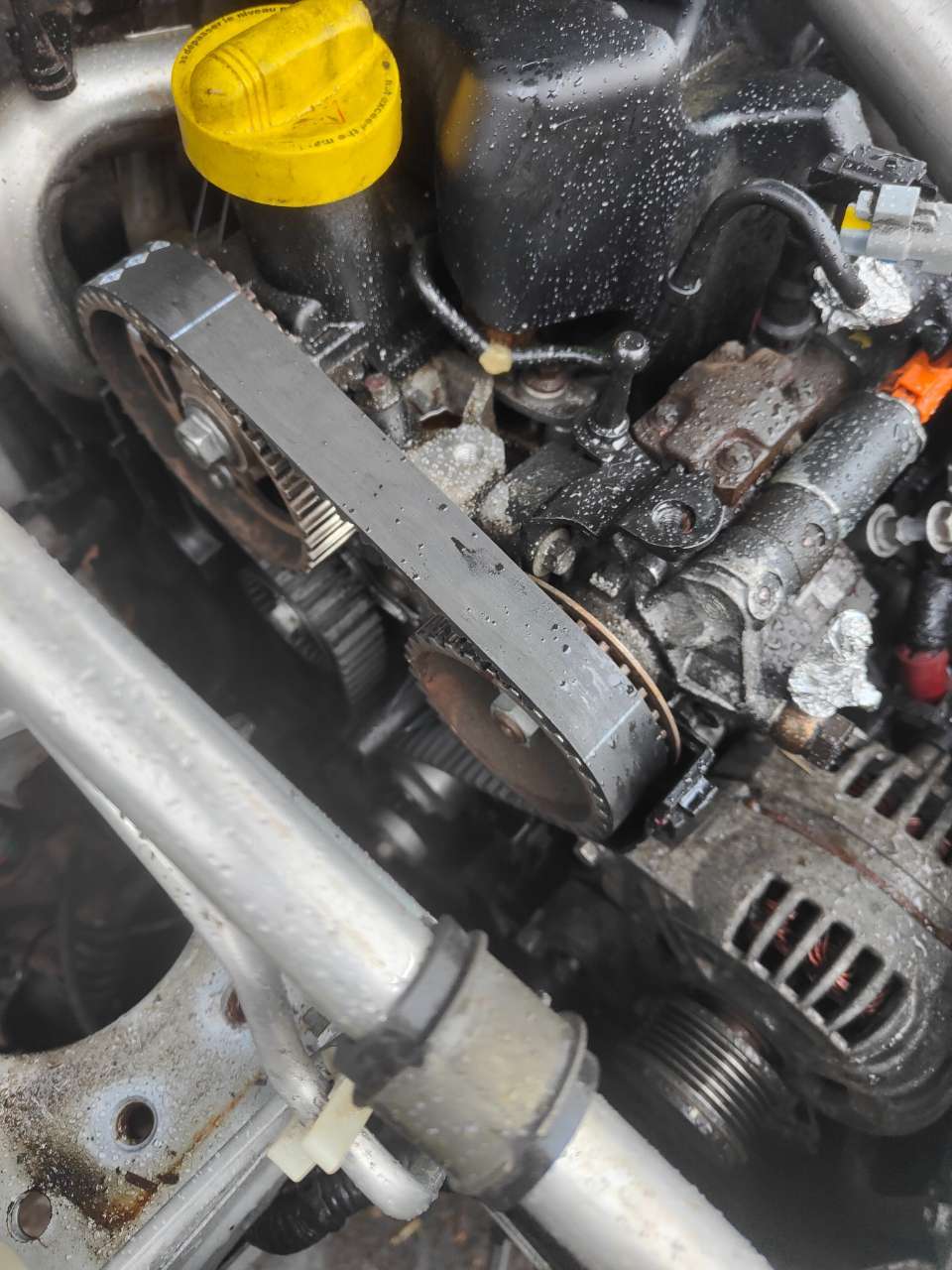

Belt went back on, tensioner on, locking pins removed and many manual turns done! Everything reassembled, I had my stepdad sit on the brakes with the car in gear and did the crank bolt up fucking tight (no fancy impact gun here...) and then it really started raining hard 😂

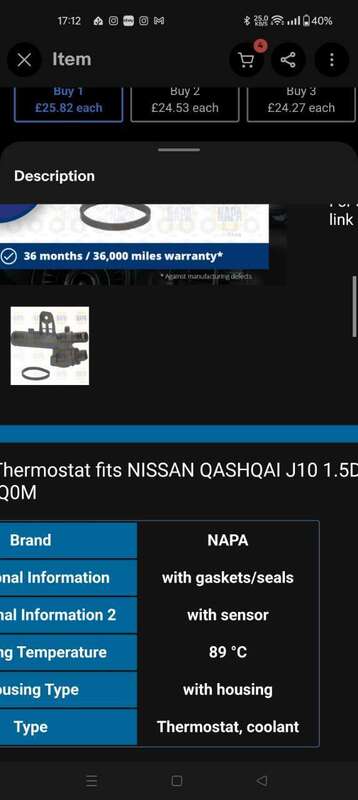

Thanks! I've already got the thermostat, I spent no expense and got this one from ebay. Says 89 degrees
Screenshot_2025-02-15-17-12-19-46_260528048de7f2f358f0056f785be619.thumb.jpg.db68ed502b4a5cfb301beb988ee71dd3.jpg

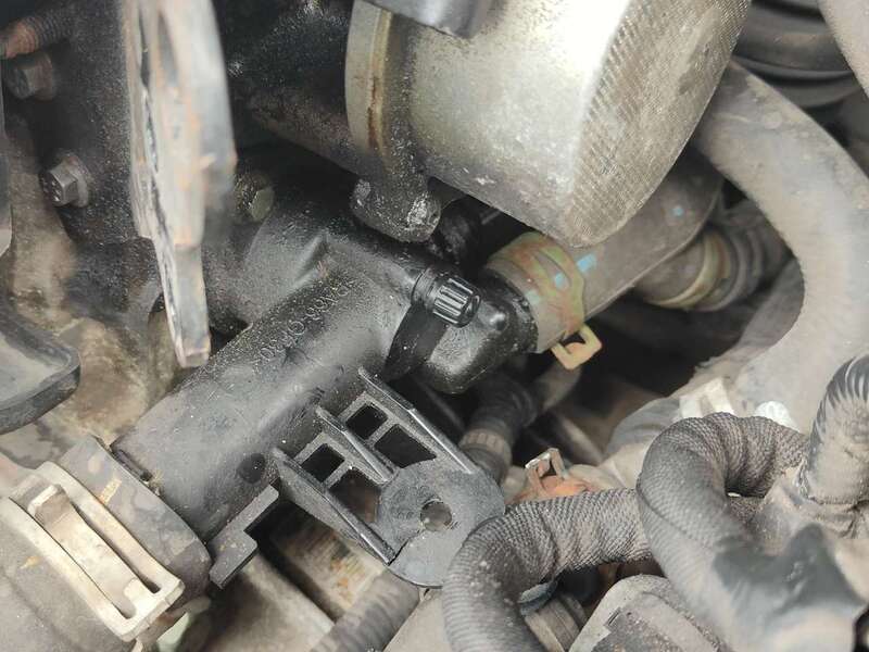

Thermostat done!
With some mild bracketry removed
As well as the battery access was decent
Poor thing is covered in oil from whatever above it is firing it out, but removed ok
No temp printed on it
The block looks good, not corroded or etc which is nice
New stat on, with all the pipe clamps pointing a nice way for removal next time I took a sensor off and cleaned it
Then popped the big oily pipe off and cleaned it's mating surface and refitted it incase that helps
