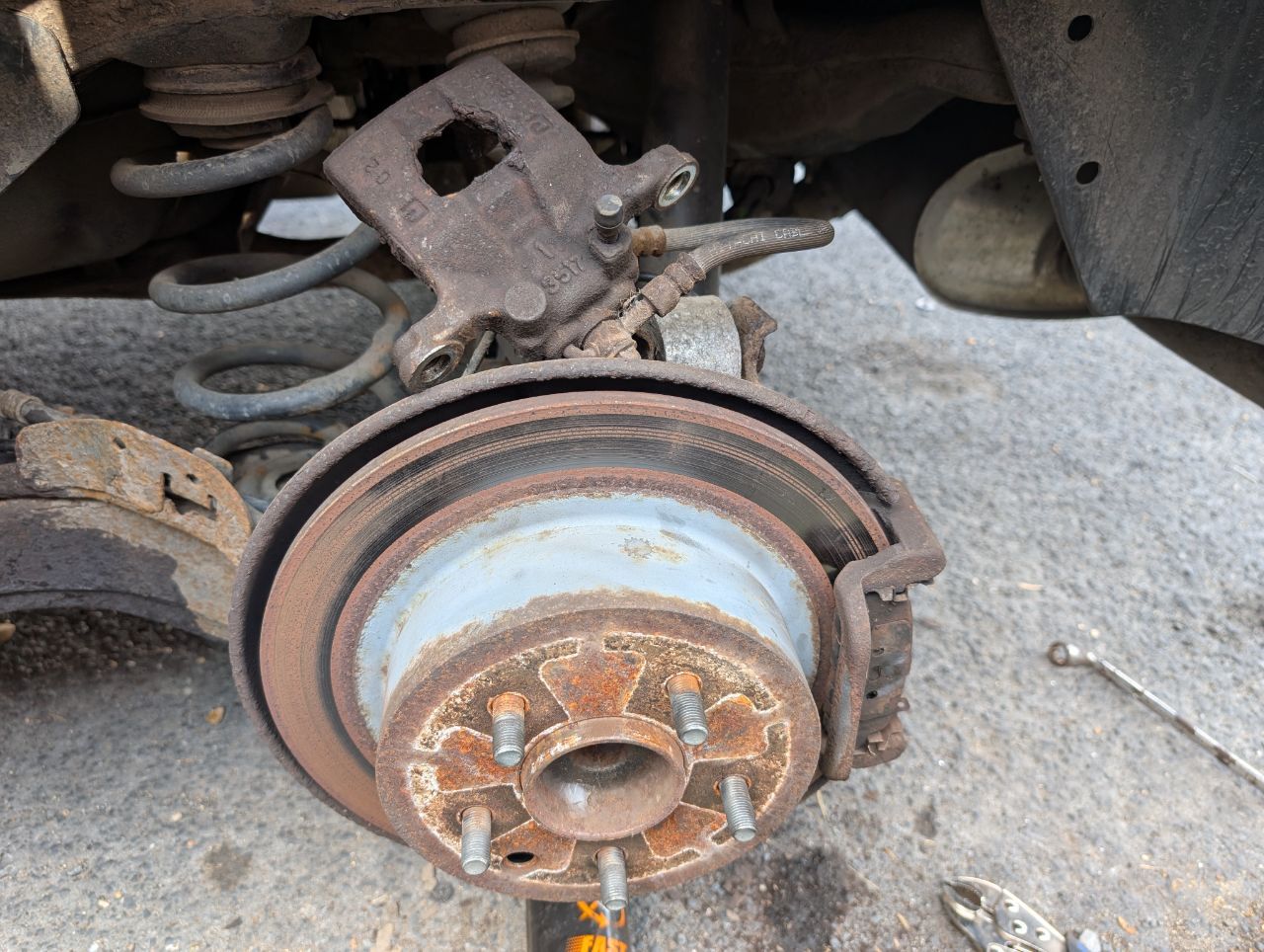

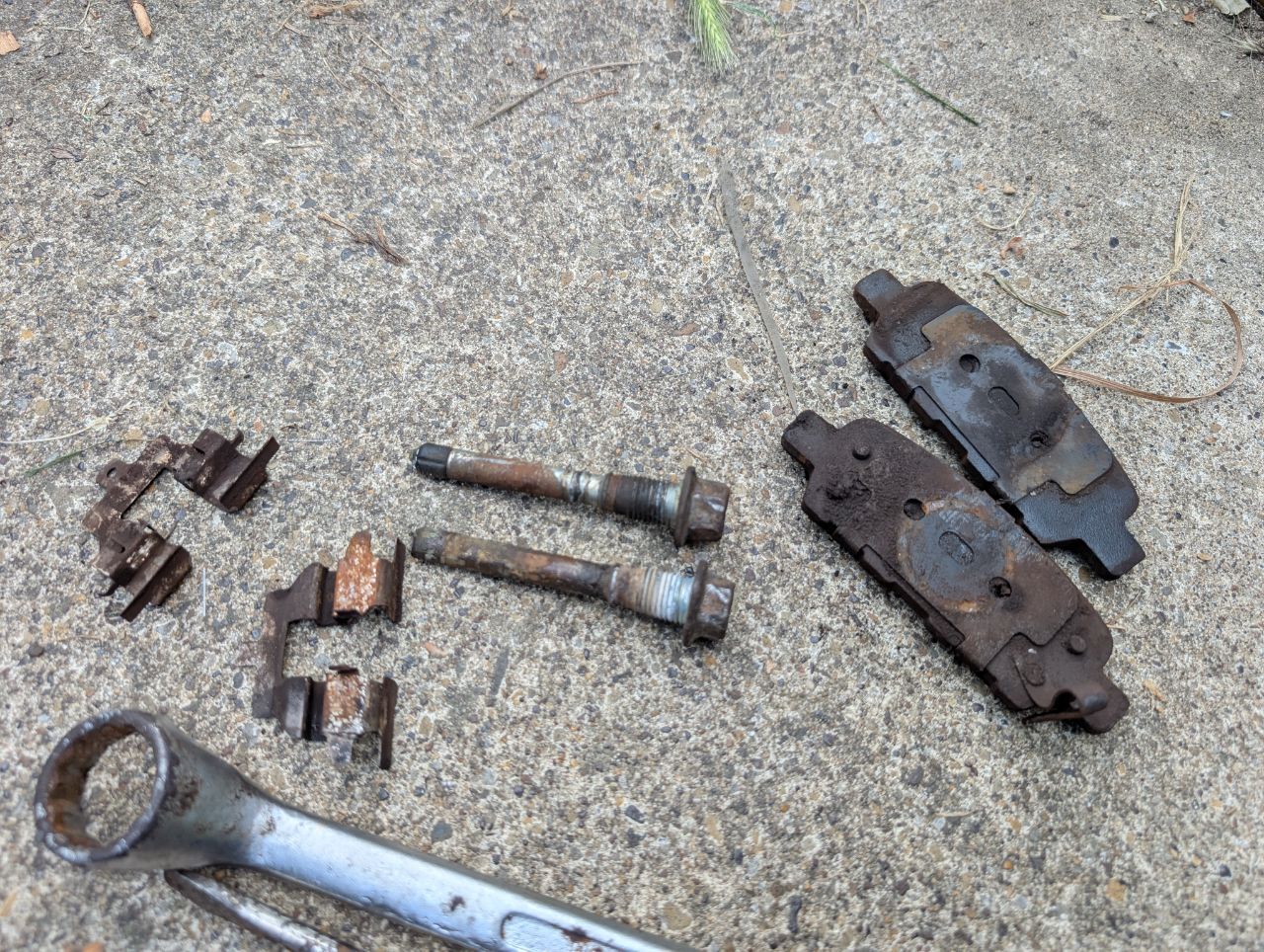

First off, I removed and promptly poked into the hub the handbrake adjuster cover. The handbrake is drums on this, running inside rhe brake disc. I gave it 2 turns downwards, and it tested OK from the car. I then fought the bottom pad carrier bolt for 20 minutes
But won eventually. Had to hammer it out of the slider in the end
There's a mega handy caliper shelf on here! The slider pins were a bit dirty
Rear pad was almost worn right out, front had life left
Wafted stuff over the wire wheel
Then refitted, glad I bought these pads the other month now!
I then had 5 minutes with a wire brush and screwdriver all over the rear arm that's usually hidden behind the wheel
And brushed/poured over rust converter on the whole thing!
Flipped the car round so the other side isn't on the road and once I've had a drink and cooled down it'll be copy+paste on the drivers side.
That was also the 4th and last wheel I've had off the car 🎊

Thanks! I don't think it's had any maintenance, preventative or otherwise for a while... On the driver's side
the bottom bolt came out fine, it was the top ones turn to need a good hammering to come out. Being the top though I almost could have ignored it and just changed the pads...
Pads weren't so worn  but the sliders were at stuck. Note the prescense of a rubber bit on the end of one here... I think this stuck in the passenger side and didn't come out... Hopefully the brake clean then fresh grease the pin got refitted with made it slide back onto the pin 🤞🤷
Question, is not having a brake backing plate an mot fail? This was held on with 3 spots of rust 😬
Did more slooshing incase it helps, it probably won't...
Brakes seem to work fine, the handbrake isn't pulling on one side (as obviously) now, so when I next drive it (which could be next week now, I can skive at home Thursday) I'll see if it cleans the rear discs up a tad.

I've owned several moderns (Golf and in fact my Qashqai) with knackered or non existent brake back plates, none of which has ever fazed my MoT man.
Ironically the back plates on my 1985 Astra are in mint condition.
  • Agree 1
Their like cornflakes around the entire car, I've never seen ones so bad on anything else I've owned! The passenger side is held on more securely, hopefully I've solved a little knock now I've ripped the drivers side out. It can't  make the brakes more crusty than they are 👌
Had one of the cars eject the dust shield at speed and it got stuck in the wheel. Funny* sensation, like. Took it to the garage as I had no idea what it was, my mechanic (also MOT tester) just ripped it out. It's been fine since.
I had to replace the rotten dust shields on the back of the Merc but that's because the brake shoe retaining springs hook into them.  Otherwise I never normally bother.
